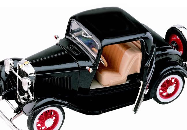

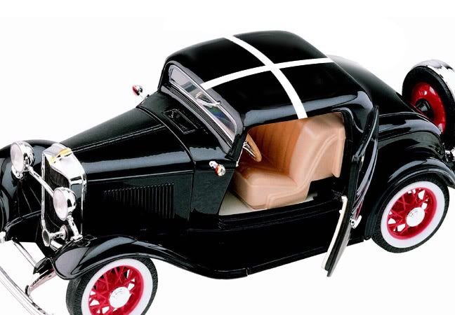

Harry P. Posted April 2, 2008 Posted April 2, 2008 One more thing to remember: Most cars have slanted roof pillars. Therefore, if you cut a section out, the top panel will be too narrow or too short (or both) to fit on the new lower posts. In that case you have to cut the roof panel in half lengthwise and widthwise, and add styrene sheet filler strips, in order to enlarge the top enough so that the cut pillars match up again. BEFORE: AFTER (with filler strips added):

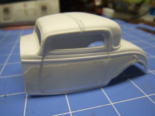

MR BIGGS Posted May 6, 2008 Posted May 6, 2008 (edited) While different style cars require different ways to to it, to get an even cut, what I do is this: I put the cutting wheel adapter in my dremel. A package of cutting stones came with my dremel that remove almost exactly 1mm each. If I want to do a 4" chop (or body section for that matter.), I stack 4 disks on top of each other. This way you mke one cut and remove all the material at once and makes for less filling when you are done. X-2.... That's what I do. It's 1 cut and done. This way you know you got the same cut on both part's, and the body line's up to a ( T ) Here is a little something I chopped the other day. With the stone method this only took under 5 min to get to this point. Edited May 6, 2008 by MR BIGGS

MR BIGGS Posted May 6, 2008 Posted May 6, 2008 (edited) Do you get crisp corners this way??? I never seem to get them with the cutoff discs by dremel. Yes they come out nice. What I do is hold the dermel in one hand and place my hand on the table at an angle. Then I just move the body witch is in the other hand also on the table, I use the table as a slider this way there aint any shaking or slip up's. You also have to take the speed of the blade in to consideration you don’t want it too fast cause it will just start sticking, melting and make the body move all over the place. It has to be a nice speed where it's cutting without melting the plastic. Edited May 6, 2008 by MR BIGGS
