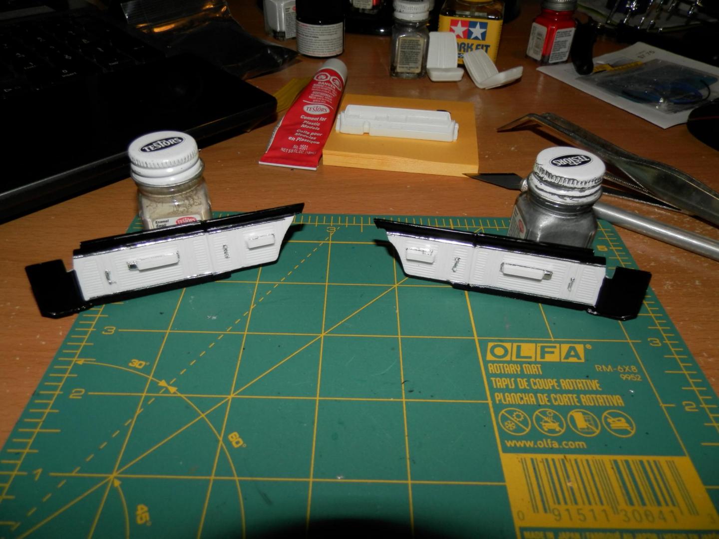

All parts were there as far as I've seen, except a windshield, a quick order from Revell and a new one arrived within two weeks.

The body was in good condition, some flashing to clean up, definitely notice a lot more then newer Revell kits.

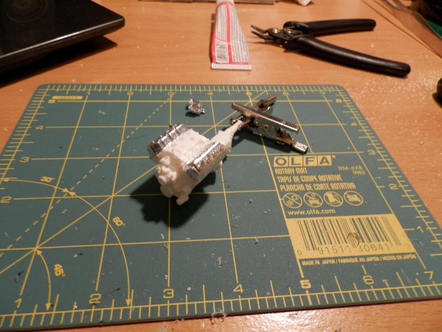

The 426 Hemi went together easily, it was covered in glue and needed some thorough cleanup however.

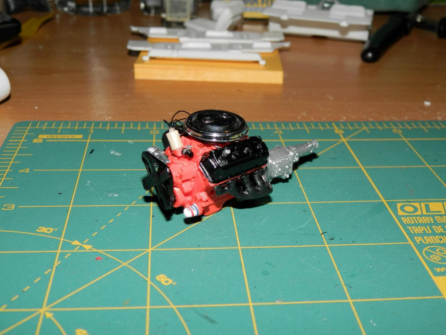

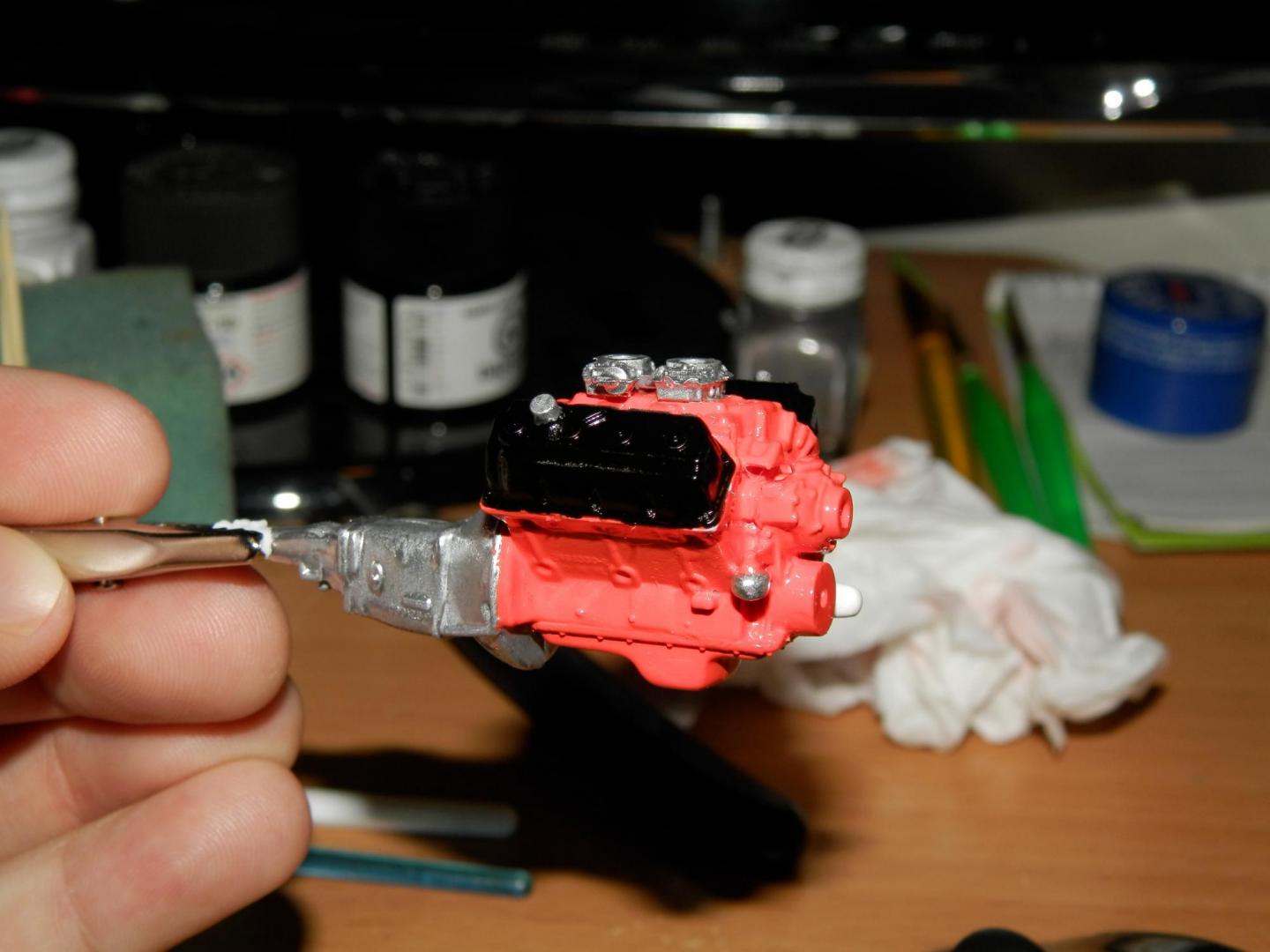

Painted Testor's gloss orange with semi gloss valve covers. I plan on getting a wired distributor cap to install on it.

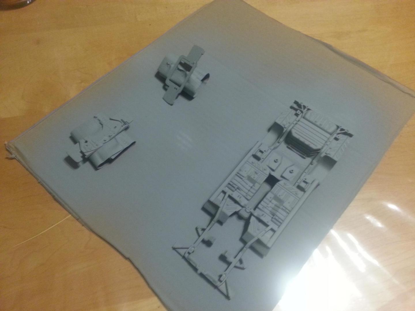

Small update, got the body panels and underbody primered. I used cheap Wal-Mart primer which seems to be working well with previous builds but we will see how the Testor's enamel will bond with it, I think it should work out ok.

Going to let these dry a few days before I wetsand. I have the paint mixed up and waiting, it is Testor's blue metal flake mixed with a half measure of laquer thinner. I painted my 70' Super Bee kit with this mixture and it worked out well so we shall see.

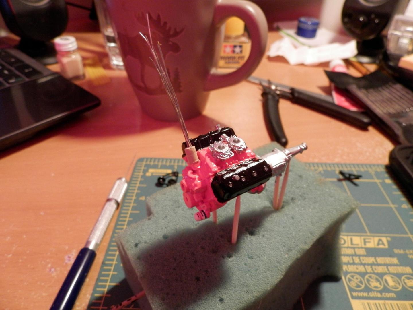

Got some work done these past couple days. I scratch built another distributor and glued it in place, and ran the wires.
P2010001.thumb.JPG.32c1c4d2e4a9e822795d8
I added the final touches to this street Hemi, the Mopar oil filter decal I stole from another kit. Unfortunately I realized the decal sheet is missing from my GTX kit so I don't have a 426 Hemi badge for the air cleaner (even though the one that was meant to come with the GTX kit wasn't the correct decal for 67')
P2020012.thumb.JPG.7c8d6799c83e8fc22e966

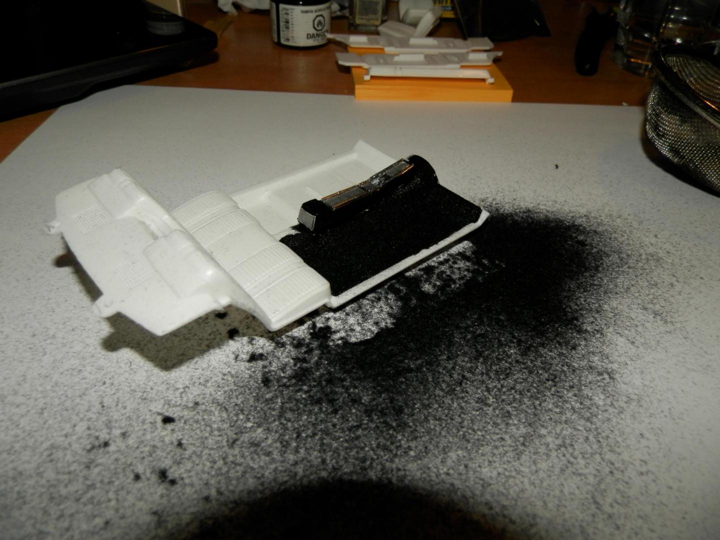

Next I decided to try some flocking in the interior tub, this is a first time for me so it was a bit of a learning curve. I used 1/2 ounce black suede flocking and a strainer to spread it over acrylic paint. I think I'll go with something that drys a little slower next time as it was a little patchy but otherwise looks good.
P2020017.thumb.JPG.eb30209d4fd80da79d49b

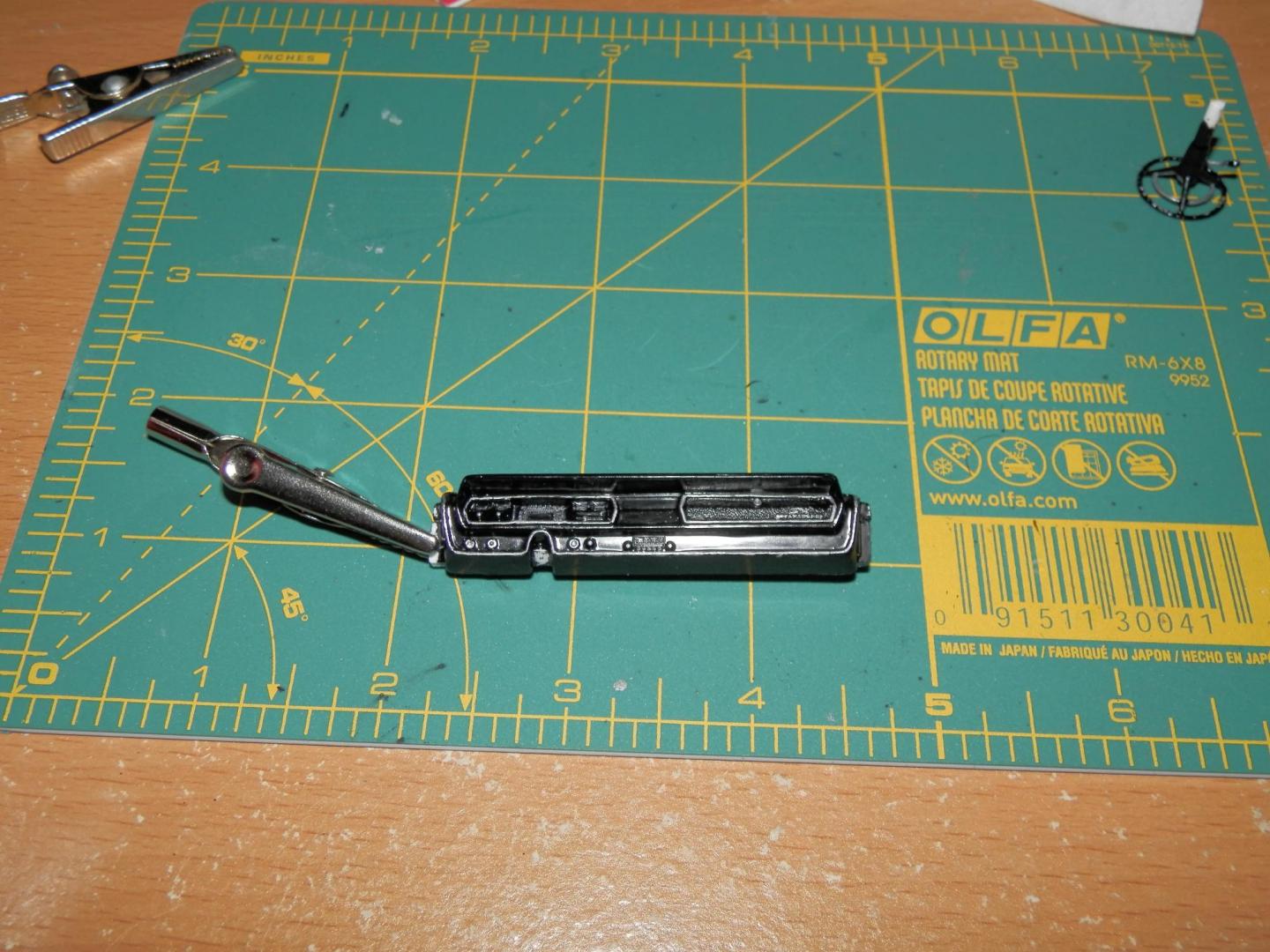

Next I added the factory tachometer as well as the four-speed shifter. I accented the chrome center console with aluminum to make it look a little more like the 1/1 scale cars. P2030023.thumb.JPG.2fdec4da1776d6d2f1b00
This is the first time I've used BMF in the interior, very tedious but I like the result!
P2030025.thumb.JPG.402fbaec2cb8502b239c0

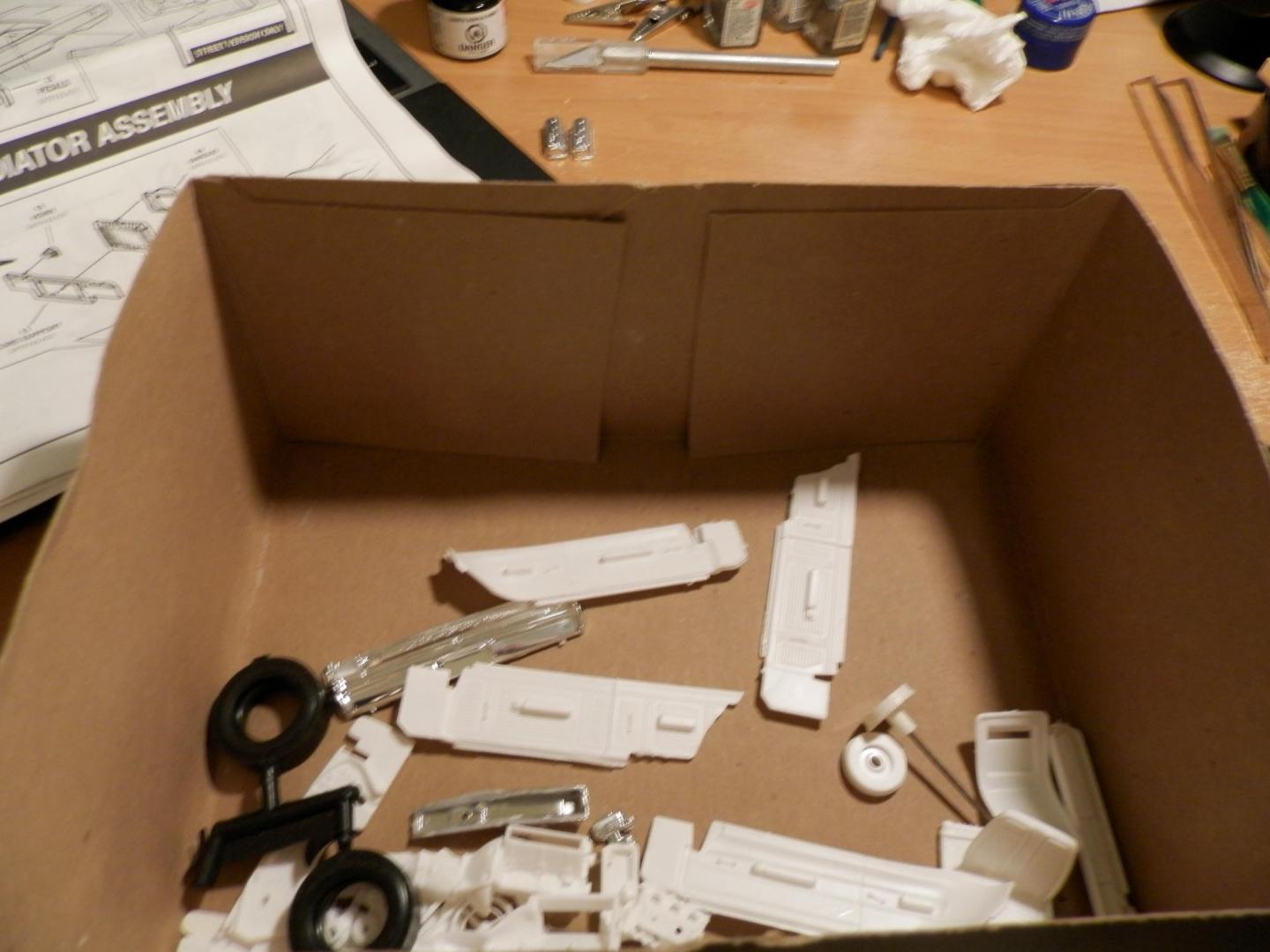

Quick update: I finished the interior, detailed painted the rear seats as accurate as I could, and glued the "GTX" shield above the rear seats .
P2070003.thumb.JPG.9479ed459a56cd564d8a6P2070007.thumb.JPG.a70be0a635f473cf500e8

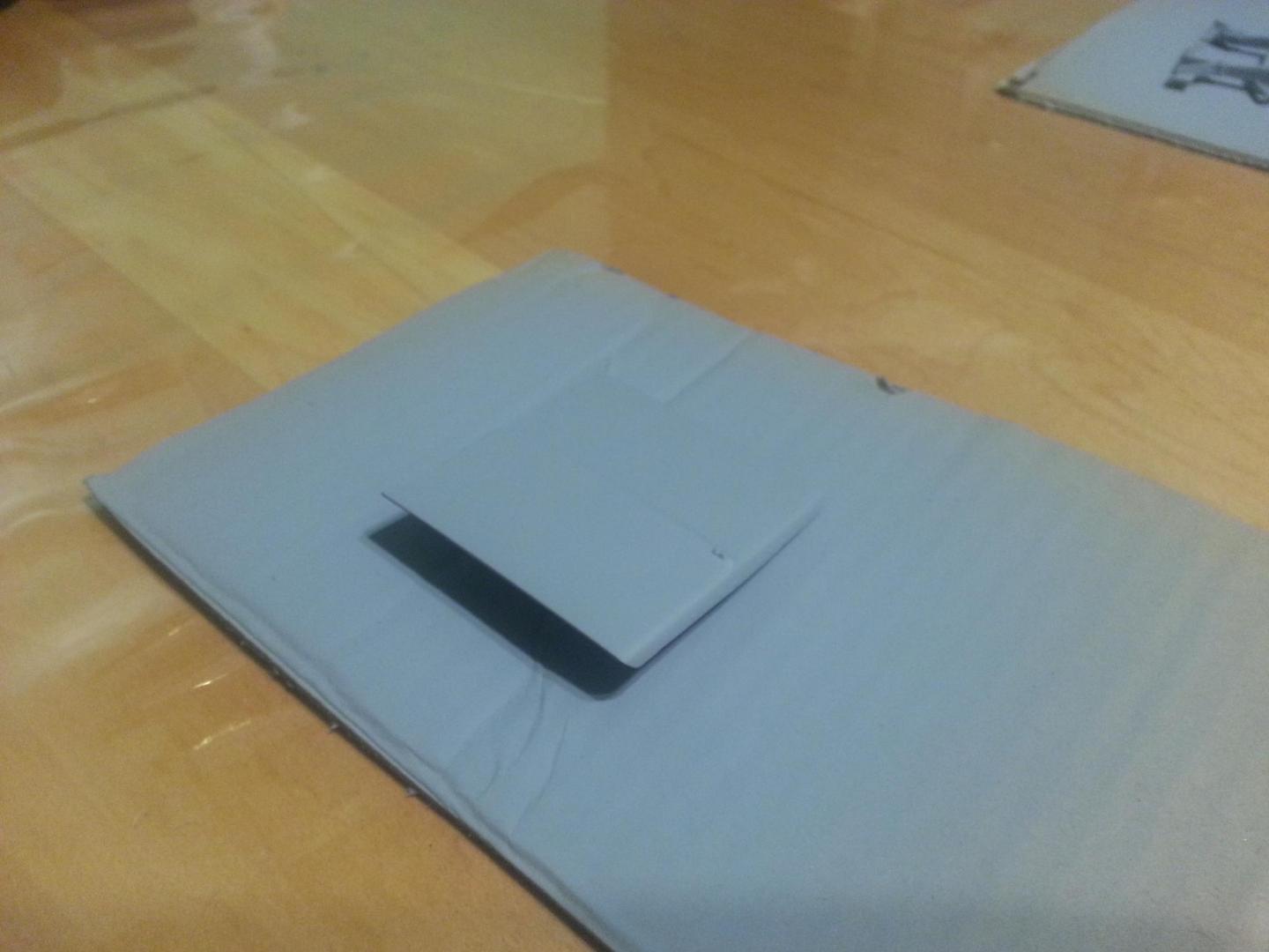

Another update: After I posted the pictures of the hood I realized I forgot to add the hood scoops (a 67' GTX just isn't complete without hood scoops.) so I did some drilling in the hood, and a bit of filling/sanding and got them fitted on.
P2080008.thumb.JPG.5f156ad55d23b334e5692
After they've been fitted, I made a mistake and drilled the hole for the street version scoop (oops), nothing a bit of putty won't fix
P2090011.thumb.JPG.b90d1d6f713369ace4955
Sanded and test fit on the body.P2090016.thumb.JPG.847a2ebccff9989e08dbd

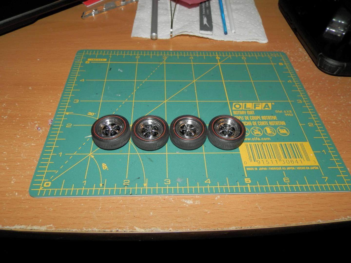

I also got the tires and wheels finished. I decided to go with the Magnum 500 wheels and redline tires where this is meant to be a top-of-the-line GTX. The redlines are decals from the 68' Dart kit, they went on nicely, I was surprised.
P2100018.thumb.JPG.7144fd2ef3ae2bb995ad2
