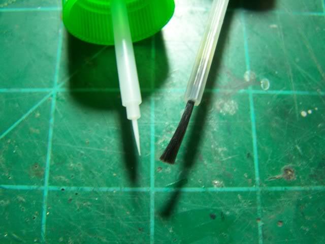

69NovaYenko Posted February 2, 2016 Posted February 2, 2016 (edited) Is Plastruct Inc - Plastic Weld Plastic Solvent Cement still available. My LHS no longer stocks it. And, I`m haveing a challenging time finding it on-line. And, since I`m on the topic how do the others similar plastic cement acetone (CH3)2CO content solvents (Tamiya Extra Thin Cement, Tenax-7R, Ambroid Pro-Weld, Micro-Mark Same Stuff etc.) stack up as far as bonding power and bonding time. A friend loves the thin brush applicator that comes with the Tamiya Extra Thin cement; he says its like a "mini paint brush", unlike the much larger bristle brush that comes with the others solvent type cements. Edited February 3, 2016 by 69NovaYenko
STYRENE-SURFER Posted February 2, 2016 Posted February 2, 2016 Tamiya extra thin cement is what I use, the applicator brush is nice and the bottle is less prone to tip over.

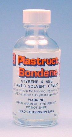

935k3 Posted February 3, 2016 Posted February 3, 2016 (edited) Is Ambroid Pro-Weld still in production??? I am running low and can't find any. thx None of the hobby shops in my area can get it anymore. I have been using Plastruct Bondene and works about the same. I pour it in an old Tamiya Extra Thin Cement because of the great small brush. Tamiya's glue is good but takes a little longer to dry which is a good thing sometimes. Edited February 3, 2016 by 935k3

Dave Van Posted February 3, 2016 Posted February 3, 2016 None of the hobby shops in my area can get it anymore. I have been using Plastruct Bondene and works about the same. I pour it in an old Tamiya Extra Thin Cement because of the great small brush. Tamiya's glue is good but takes a little longer to dry which is a good thing sometimes. I really like the Pro-Weld.....the Plastruct really irritates my nose for some reason. thx

fseva Posted February 3, 2016 Posted February 3, 2016 Is Plastruct Inc - Plastic Weld Plastic Solvent Cement still available. My LHS no longer stocks it. And, I`m haveing a challenging time finding it on-line.And, since I`m on the topic how do the others similar plastic cement acetone (CH3)2CO content solvents (Tamiya Extra Thin Cement, Tenax-7R, Ambroid Pro-Weld, Micro-Mark Same Stuff etc.) stack up as far as bonding power and bonding time.A friend loves the thin brush applicator that comes with the Tamiya Extra Thin cement; he says its like a "mini paint brush", unlike the much larger bristle brush that comes with the others solvent type cements.I have found Tenax the very best of the hobby solvents. The mfr just recently brought the product back out of "retirement".Another great deal is Weld-On 3 which is available in 4oz cans on Amazon. I personally think it works faster than Tenax, and it has become my go-to solvent. However, the metal can it comes in can be a hassle. So, I invested in a metal funnel so that I can pour from the can into the smaller glass bottles I saved... and I also have a brush in one that makes applying WO3 an easy process. (It's one of the larger bristle brushes).
