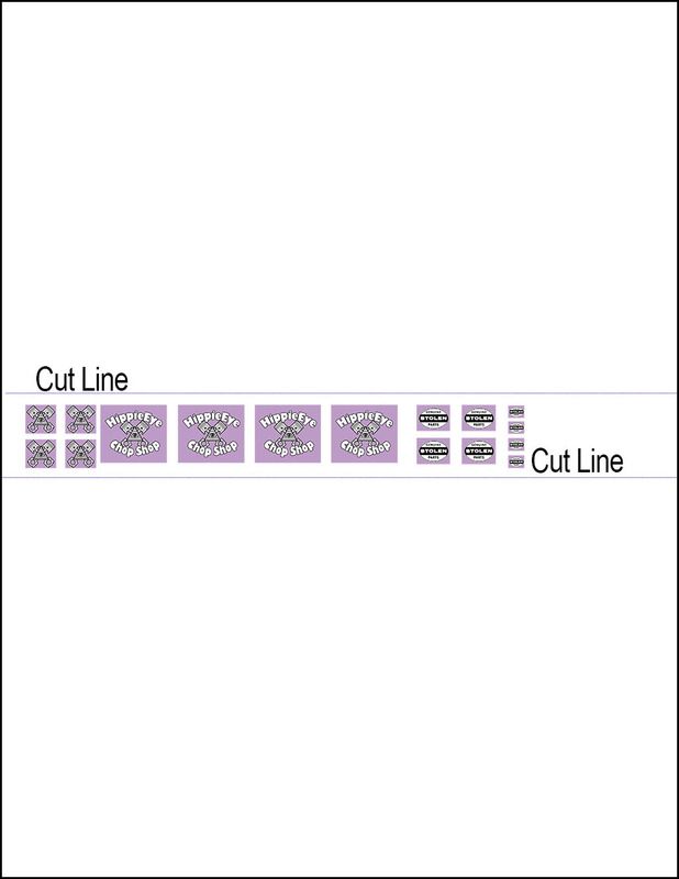

Bernard Kron Posted February 3, 2016 Posted February 3, 2016 Yeah. I used to use the Microcale stuff, applying it with a broad, soft brush. It worked fine. Recently I switched to a craft store clear acrylic in a spray can. Far more even in its coating properties, allowing for a somewhat thinner decal thickness. I suspect your aerosol urethane should work every bit as well. One trick to use in order to conserve decal paper, which can be expensive, is to put a cut line above and below the area that will be printed.Cut your strip of decal and only then spray your sealer coat. This will allow you to gradually use up your sheet of decal paper in a systematic way. In this case I had about 5 inches of vertical height left on my decal stock. After cutting the strip I need I'll still have about 4 inches of paper left to use.
