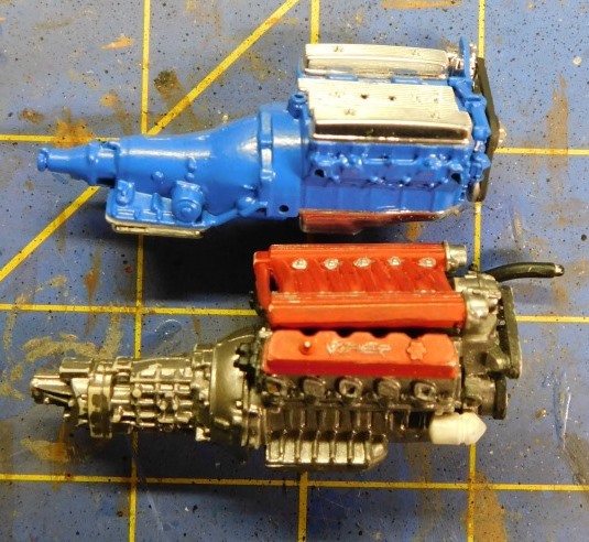

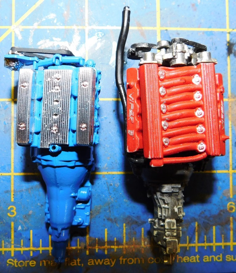

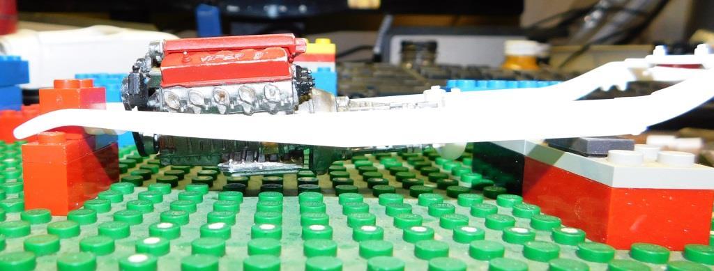

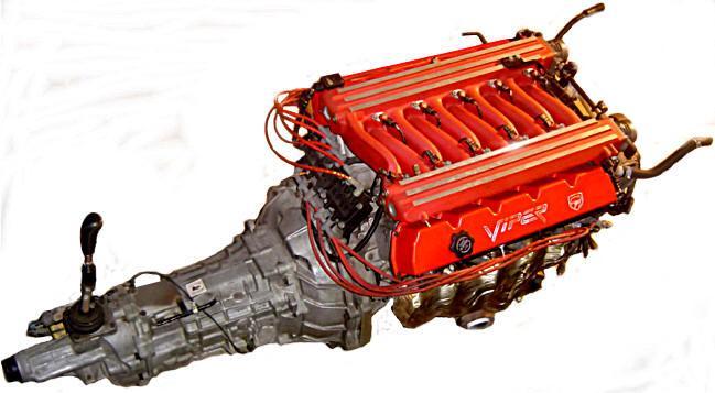

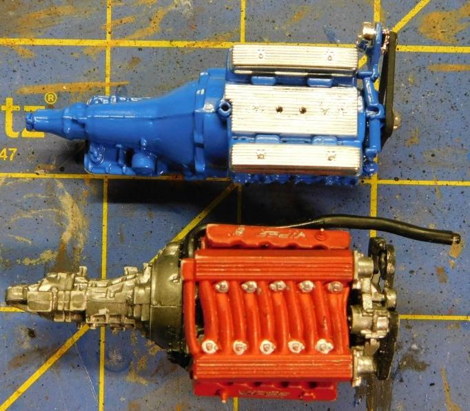

First I have to figure out how much I need to stretch the frame and make modifications to the body if necessary.  I decided to build up the engine that comes with the Revell '29 and measure it against the Viper's V10 and increase the size of the frame to make up the difference.  Much to my surprise the overall engine and transmission of each engine is relatively the same. and the width is about the same on the bottom side (the part between the frame rails) of the engines.
DSCN0072.thumb.jpg.9d0743e33e6884a3d275e
DSCN0074.thumb.jpg.765008f7d4c866a342e36
DSCN0075.thumb.jpg.5123ddbfff81eff9f48c3

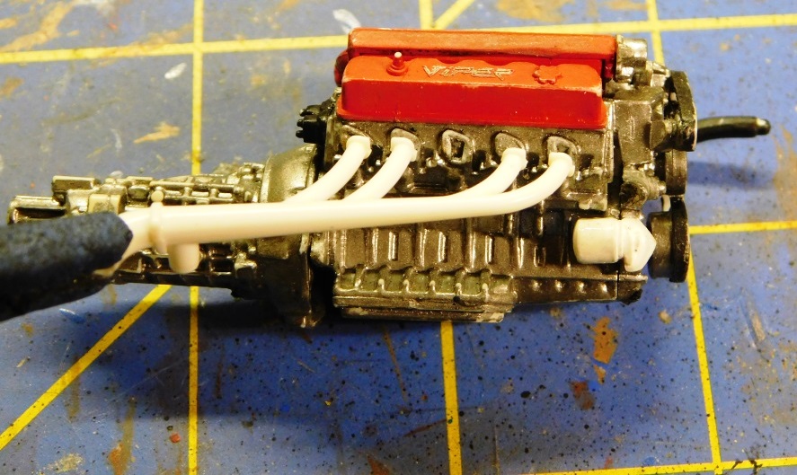

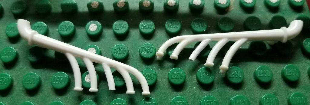

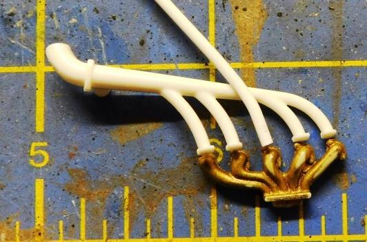

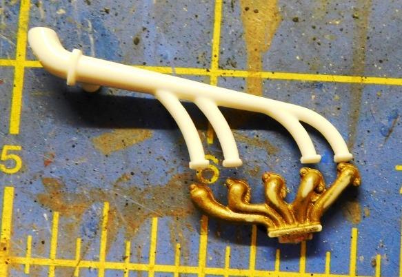

Another pleasant surprise was the exhaust.  I took the manifold off the V10 and placed it next to the manifolds of the '29.  They matched up with the exception of the lack of a 5th pipe.  However as you notice below a properly placed piece of styrene and some scratch building and I have a sweet exhaust for the V10.  The bonus is that the way the '29 manifold sits it appears that I do not need to modify the frame width to fit the exhaust inside it.
DSCN0078.thumb.jpg.dd4c1bcf555c062f7e595
DSCN0079.thumb.jpg.547b2fa6eaf8a373eea5c
DSCN0077.thumb.jpg.6ef00ca3b0bdac30afbf3
One last thing.  I am considering finishing the '29 engine and either using it for another build or a diorama.  However I do not know what type of engine it is, so I can make sure I get it done up correctly.
Thanks.
Thanks.
It's a Buick nailhead. I like your project. Maybe come up with some sort of crazy intake to put like 8 or 10 carbs on it?

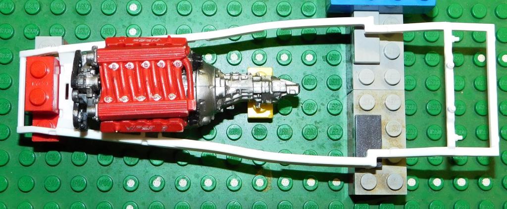

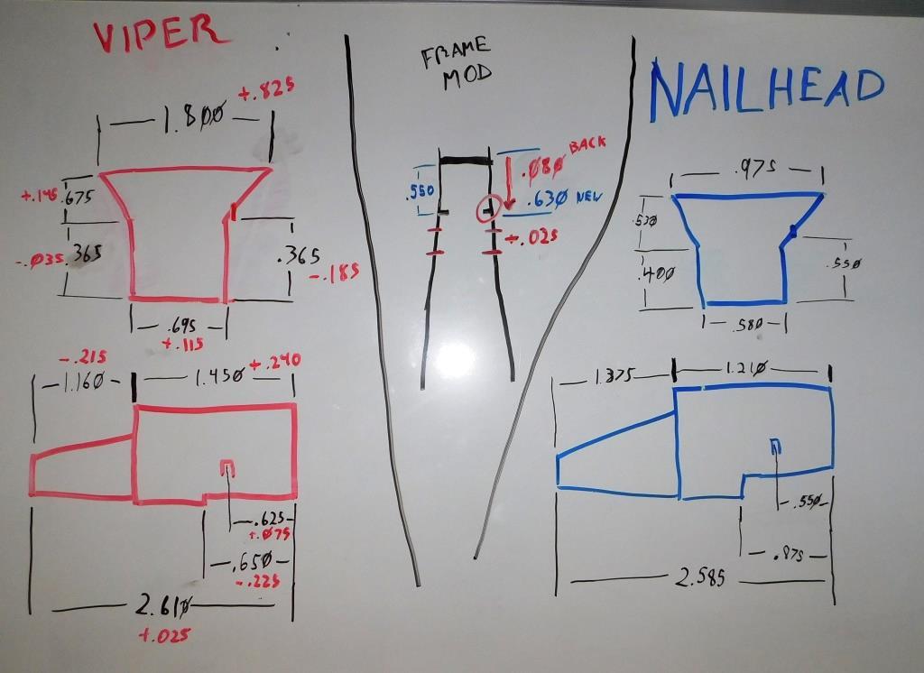

Tonight I started the planning phase of what i need to do to fit the V10 into the frame of the '29.  I took some general measurements of each engine and compared them to come up with how much I need to adjust the frame.  After looking over everything I came to the conclusion that I need to extend the frame about .025 of an inch.  I also need to move the engine mounts back about 0.080 of an inch.  Those two adjustments and I think the larger V10 will fit in the frame.
DSCN0082.thumb.jpg.7b50789f047b1ee509ace

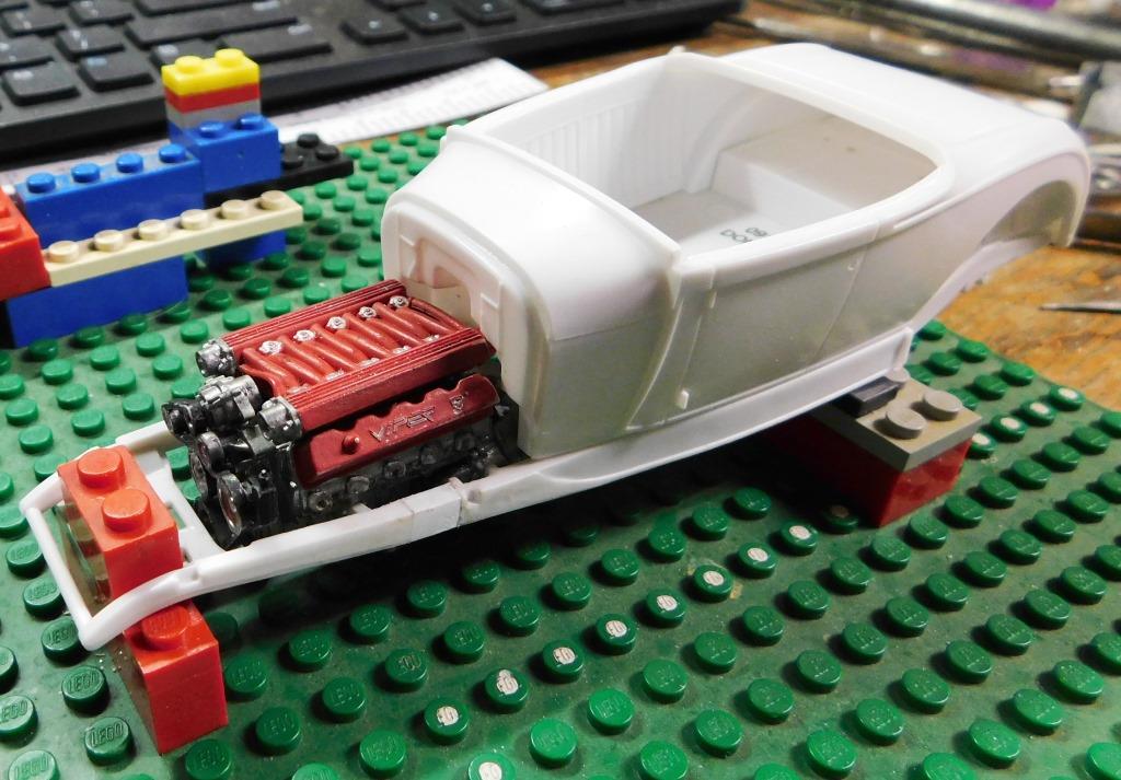

I think this is a great idea. The only fitment problem I see is at the rear of the engine. Not sure how much clearance you have at the firewall, but it looks like the Viper is taller in the firewall area than the Buick. The Viper intake manifold looks like it would stand taller than the Buick distributer would.
Thanks espo, I have been worrying so much about getting it in the frame that i totally forgot about body fit.  The V10 does sit higher in the frame that the Nailhead and I had not worried too much about that since I had no intentions of putting a hood on it.
You might see if the firewall can be pushed back inside the cowl or even notch the cowl to clear. I have seen where some builders are even creating a flat firewall in place of the kit's.

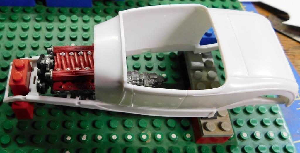

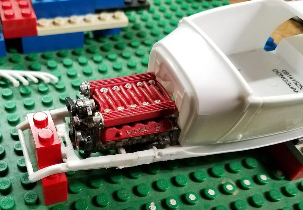

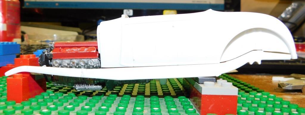

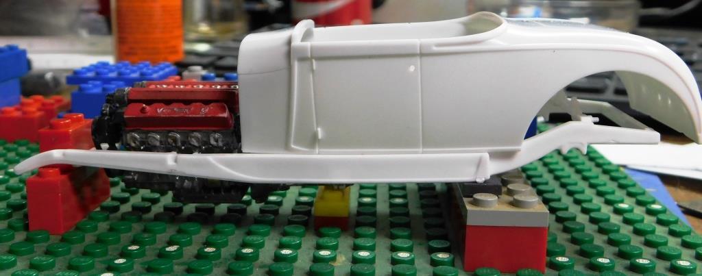

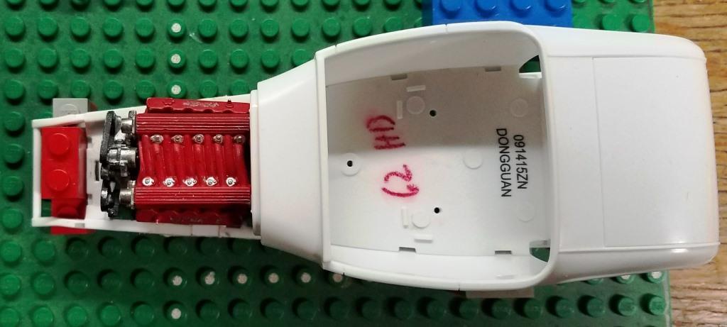

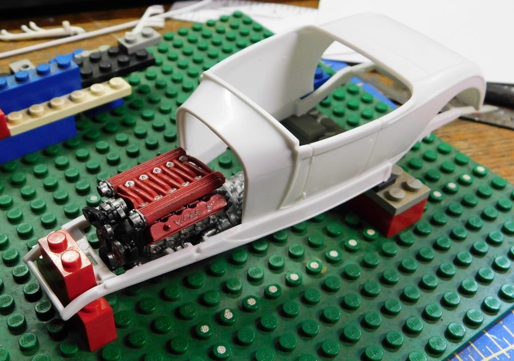

So I worked some more on this one tonight.  I took into account the firewall just as espo suggested.  The good thing is that the firewall is almost vertical so it did not appear to be an issue.  However the transmission hump was.  I took some measurements and began to try and figure out how much I would have to cut out of the hump to fit it all in once I extend the frame.  I did not want to extend the frame too much and put a large gap between the firewall and the back of the engine and was ready to give up till I decided to work on moving the engine mounts.  I realized that the mounts sat on the top side of the frame and angled upward.  I was going to cut them off and move them back approximately 0.080".  As I looked over them and the angle on the side of the engine block, I realized that if I simple cut them off, moved them back the 0.080" and then flipped them over and placed the lower angle of them up.  When I glued them back on I lined them up with the bottom of the frame.  This lowered the engine considerable in the frame and will allow the transmission hump to fit over the transmission with not modification once the frame is stretched 0.025" just behind the engine mounts.

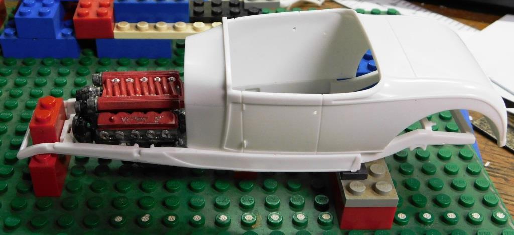

I mocked up the body and engine along with the low profile tires I plan on using.

With the tires.

Interesting project. V10s make good swaps. I have two in big  Dodge trucks. So why not in a Ford?
Agreed. The way I see it, if they can put a small block Chevy in EVERYTHING,  why not a Viper V10? I put one in a Camaro :D.
Nice work on this. Pretty clever use of the Legos. I'll likely shamelessly steal that idea.

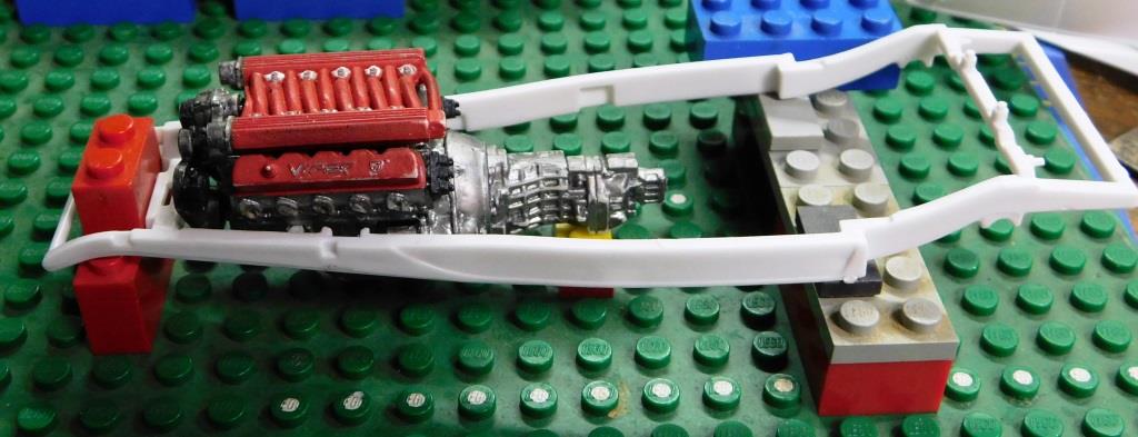

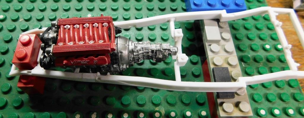

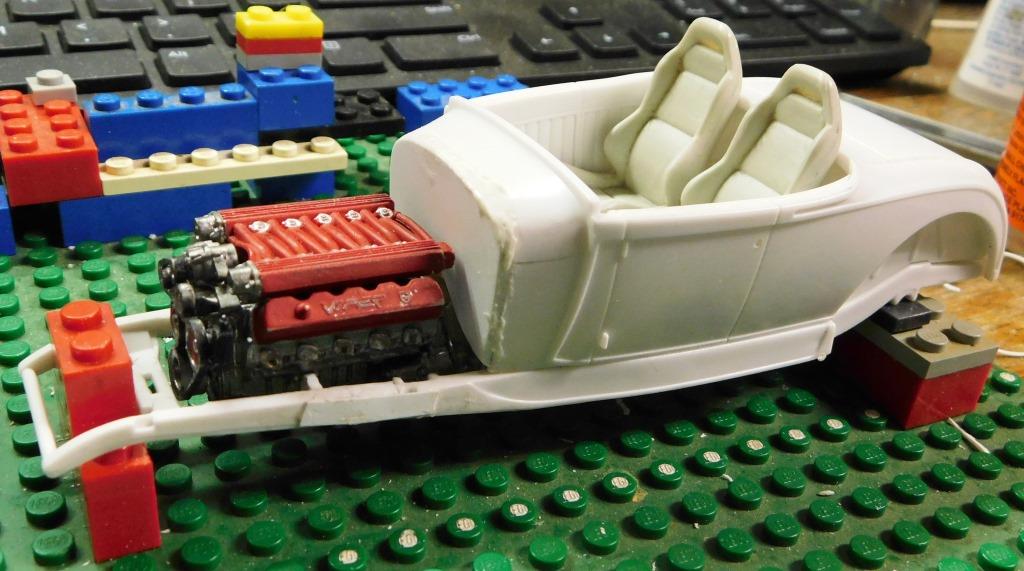

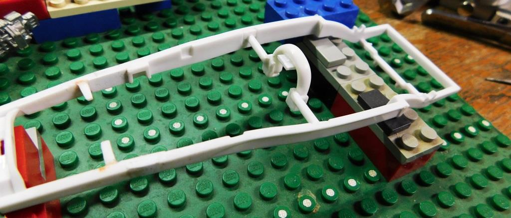

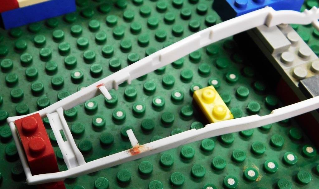

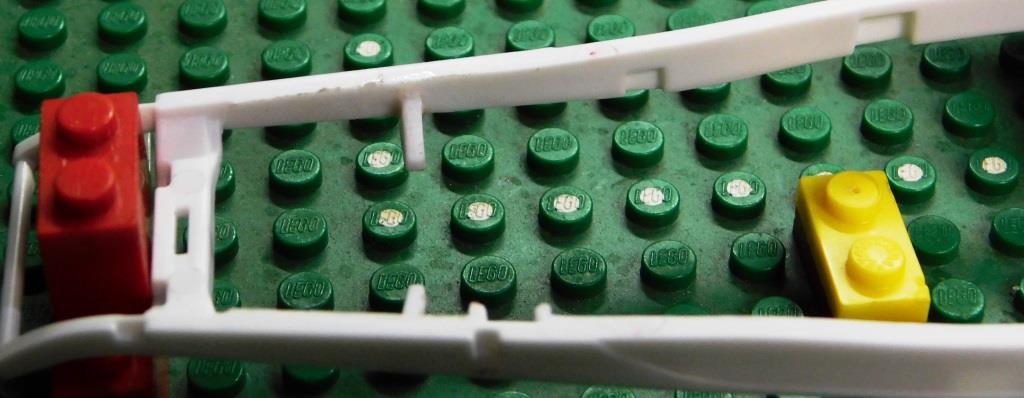

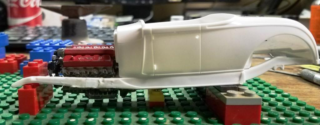

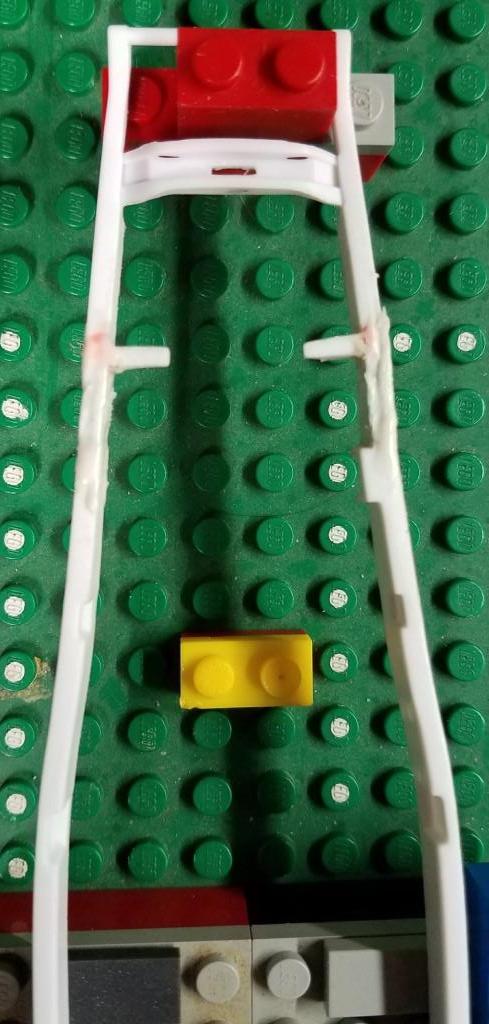

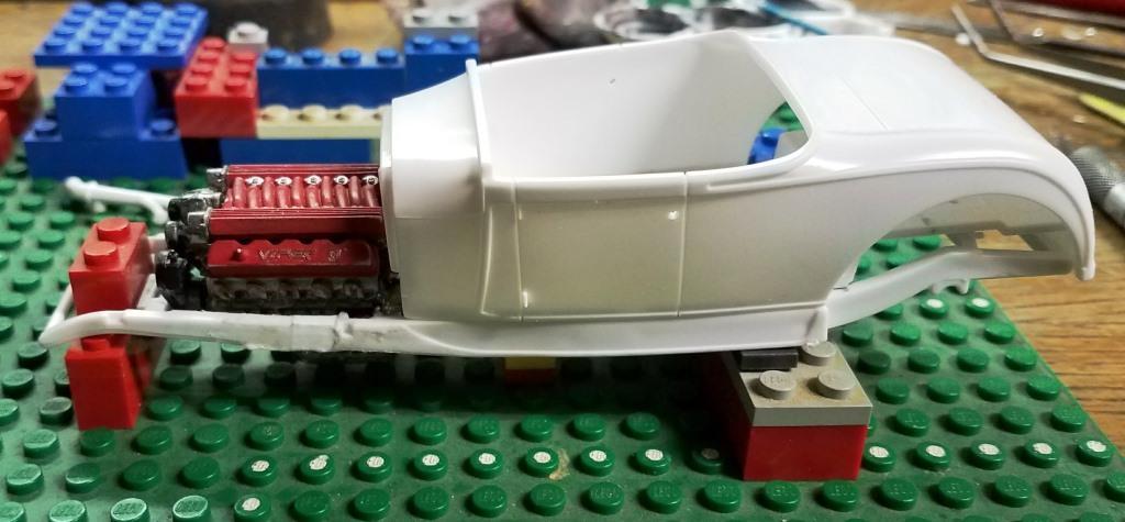

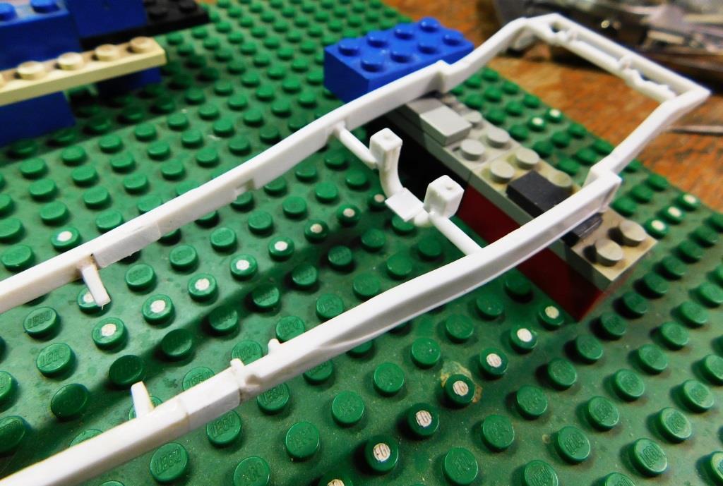

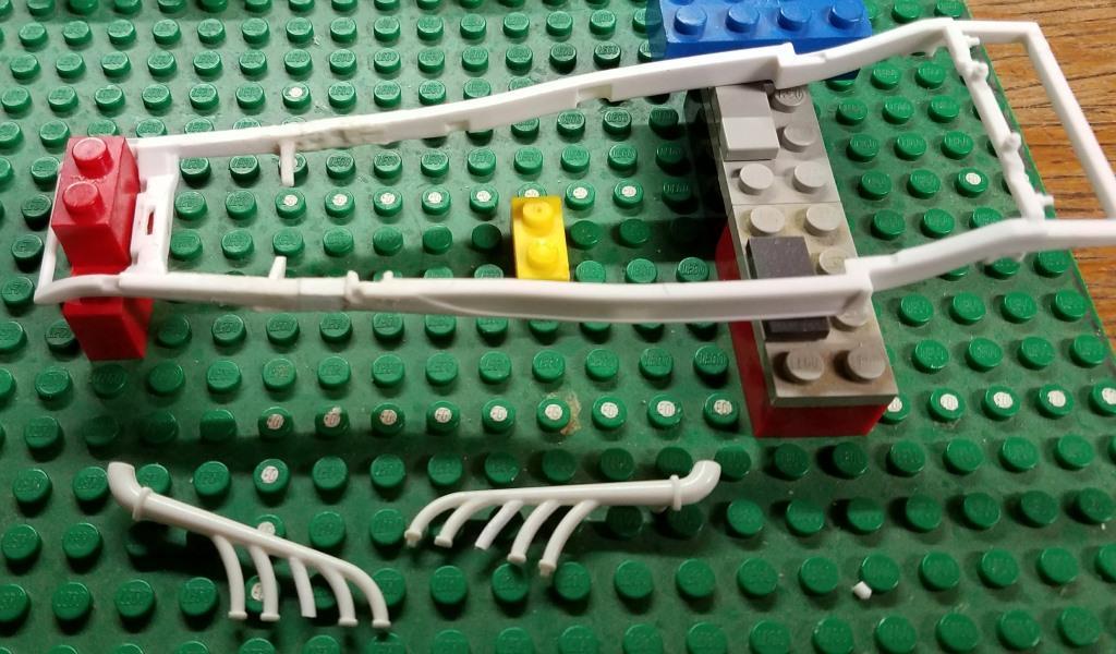

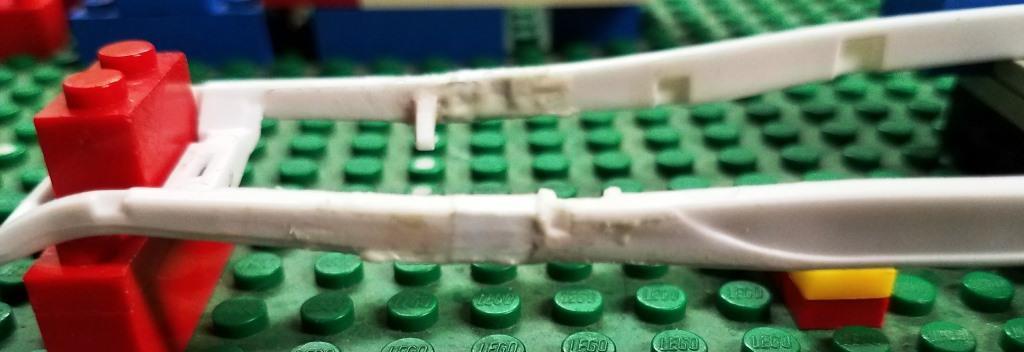

Worked a bit more on the frame this afternoon and this evening.  I cut the frame and put a piece of styrene 0.025" long on each side just behind the engine mounts.  Since I did not have the right size of rectangular styrene I sandwiched three pieces of flat sheets together.  A bit of sanding and some putty and you should not even be able to tell I put them in.
I also added the extra pipe to each header this evening.  Just waiting for the glue to dry, then I will put the flange on it and a bit of sanding.
The next issue I came across this evening was the brace for the back end of the transmission.  The original brace that came with the kit holds the end of the larger transmission too high, which interferes with the bottom of the body.  While not a big deal I just did not want to make a new one from scratch...o'well.
Thanks for looking

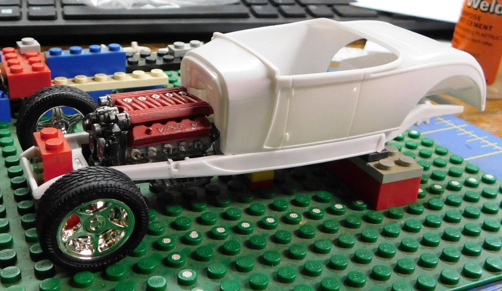

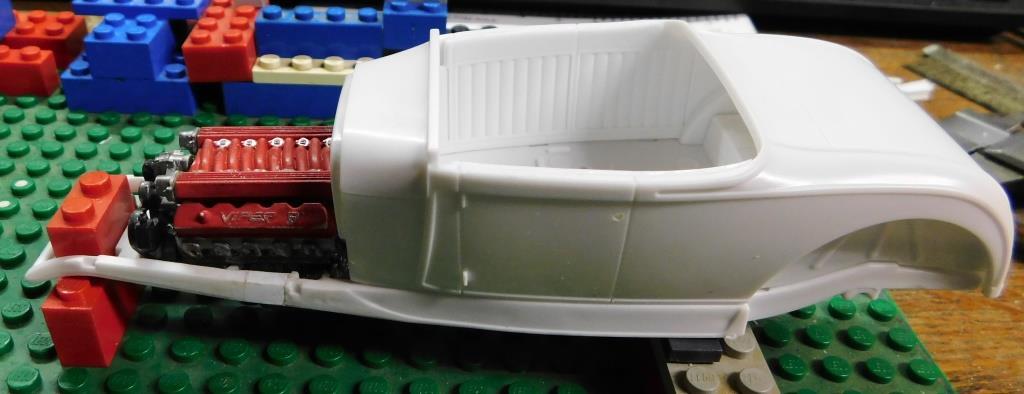

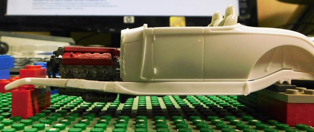

I also mocked up the engine and body to see how they looked against the stretched frame.

Did a bit of work on the frame this evening.  I accidentally broke the frame apart on the one side when washing it before painting.  I glued it back together last night and added some thin pieces of styrene to the inside of the frame for reinforcement.  Tonight I modified the cross brace/transmission support.  I simply cut out the middle and added a curved piece of round styrene.

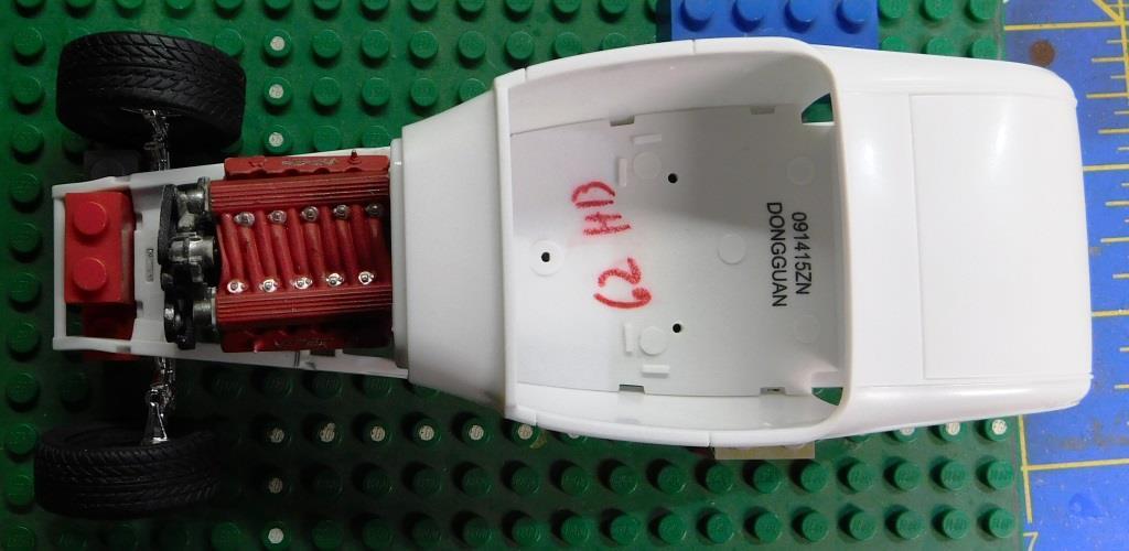

Her are some pictures of what it should look like with the engine and the body.  Talk about building a car around the engine :)

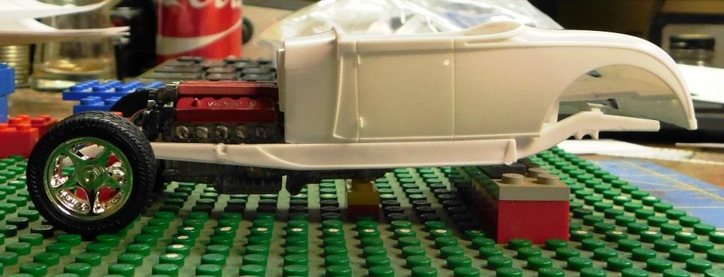

As I looked over what I had done tonight it came to me.  Once I get the axles and wheels I was planning on using on the car the oil pan and transmission bell are too low in the frame and actually looks as if they will keep the wheels off the ground.  Initially I think all I have to do is boost the back end of the transmission up and put some blocks on the rear axle to drop it some.  I hope this "boost" does not make the car look too tall over all, since my original idea was to keep this as low as possible.

Peter, mate, please don't raise the back of the trans and put blocks on the rear end.  Instead, add a few shims on top of your front engine mounts.  Your side view looks to me like that would raise the pan enough to keep the car low to the ground.  I realise you might have to play with the transmission hump and firewall but it will be worth it.  Stance should never be compromised by things like ground clearance!  if it doesn't look good, who will want to ride in it?

Alan,
Thanks for the advice, but I don't know if raising the engine is an option right now.  The overhang on the upper part of the firewall is pretty close right now.  I do not want to really add another bit into the frame and push the body back, that was a pain in the A!!.
So I have made a bit of progress over the past couple of days.  I had to reinforce the frame in the cut location some more.  I added some very thin pieces of styrene on both sides of the frame and will sand them down to blend them in once the glue dries for a day or two.  I also added some styrene to the tops of the engine mounts and raised the transmission mount in a attempt to raise the engine up some more.  This however had and adverse effect on the fit with the firewall.  After numerous attempts at trying to modify the firewall I finally gave up and cut the body back slightly and added a vertical piece of thick styrene and began to blend it in to the body.  Maybe I will put some bare metal foil on the new firewall.

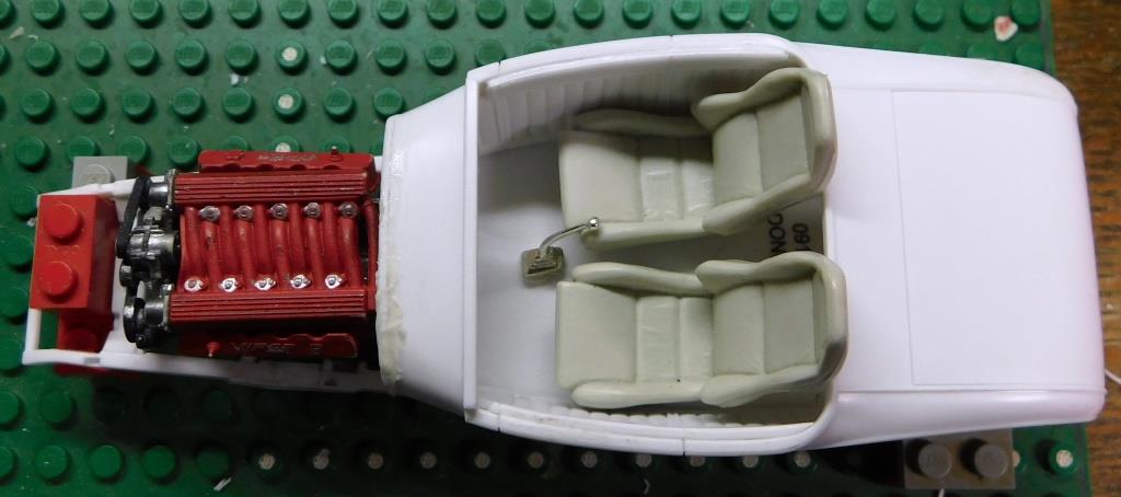

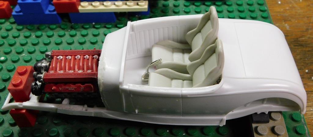

I was pleasantly surprised when I gave the seats out of the Viper a try in the body and they fit.  I was so excited, because I want to use these so bad.  I also mocked up a stick from the junk box and I am liking the look.

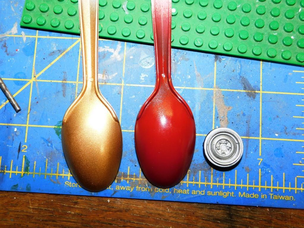

The other thing I worked on was the paint colors.  After some research I discovered that the Iron Man red from the movies is rustoleum colonial red and the gold is a gold metallic I had sitting around.  I put a clear coat on the metallic and it dulled it down a bit making it perfect.  The rims and some other small pieces will be painted flat steel.

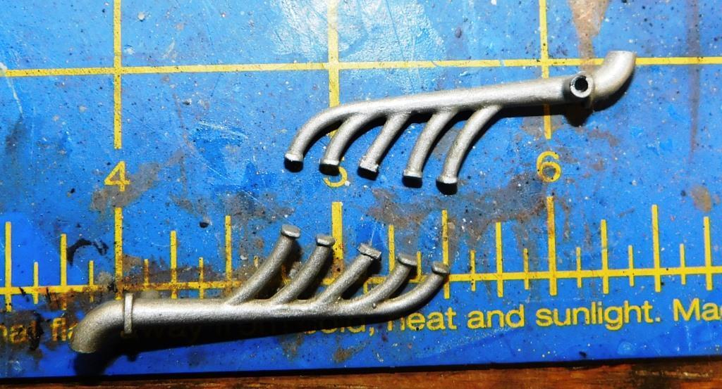

I finally got the headers done.  If you guys remember I took the headers from the '29 and added a piece of styrene to the space in the middle to create another pipe.  I think they look pretty good now that I have them painted with a flat steel color.  I figure I will paint the rest of the exhaust the same color.
DSCN0061.thumb.jpg.36d8df08c9c0e10ecd61b

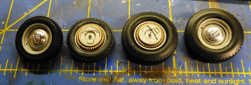

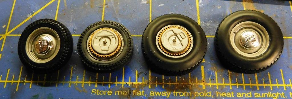

I got the tires and wheels with the brakes painted and together.  I decided that flat steel was the way to go with these too and put the kits moon caps on them.
DSCN0063.thumb.jpg.e902630cea2431ef93d5f

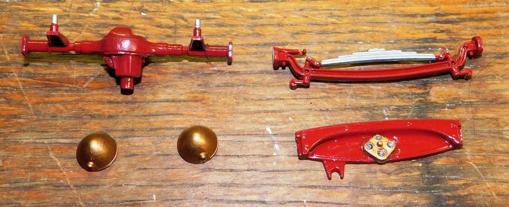

A couple more pieces painted up.  Axles, dashboard and headlights.  The headlights are the gold color that I am going to paint the frame and some other small parts.
DSCN0065.thumb.jpg.a64c6f34ba9691f0abc83

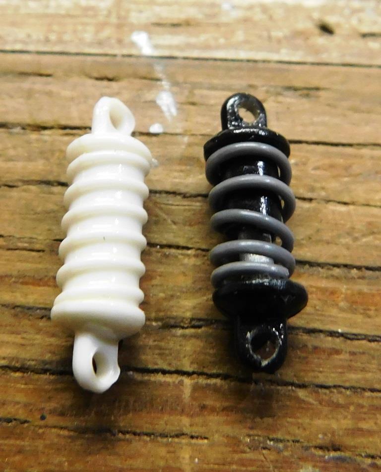

The last thing I got to tonight was one of the rear coil over shocks.  Since these are very visible I wanted to add some detail to them, but I was having difficulty painting up the ones that came with the kit to my liking.  So I decided to simply make some out of rod styrene and wire.  The biggest issue I had was the ends of the shock.  I decided since I would not be using the ones that came with the kit, Cutting off the ends and gluing the styrene rods to them to create each side of the shock.  Then I simple slipped the coiled wire over the larger side and put a small drip of glue on the end of the wire on each end.  After the glue on the wire is dry the shock should have a little bit of adjustment to them so they will fit as good as the originals.  Just need to touch up the paint (did not notice till I was posting picture).
