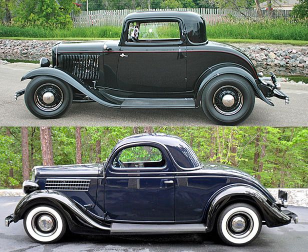

Ace-Garageguy Posted February 25, 2016 Posted February 25, 2016 (edited) 1935 Fords had an even more swept back A pillar, and they had front-hinged doors. Yes, but the front cut-line of the door opening itself is vertical on the '35, not leaning back like the '32 3-window. The '35 uses TWO hinges, in line, on the vertical cut-line. It's very easy to engineer hinges on a vertical cut-line. It's much more difficult to do it on a line that slants, and requires hinge-think that wasn't in general use at the time. For a door to work, ALL the hinge-pins HAVE to be on the same axis. To accomplish this on a leaning-back cut-line would require at least one of the hinges to stick WAY out, or the rear of the door would swing in an odd arc that would make it unnecessarily difficult to engineer it to close properly...and it would look goofy. It's all just geometry. The earlier mention about the B-pillar on the '32 3-window being stronger is spot on. Closed Fords of the early '30s usually used THREE hinges in line on the front-hinged doors to support the weight. Hanging all the weight of the larger door of the 3-window required a stronger pillar to do it, yet still required three hinges in line. Hinge and more-steel-in-the-body design had progressed by '35 to be able to hang the entire door on two hinges easily, but it wasn't until considerably later in the evolution of body design that curved internal hinges capable of dealing with more pronounced body contours became mainstream. Edited February 25, 2016 by Ace-Garageguy
Harry P. Posted February 25, 2016 Posted February 25, 2016 The earlier mention about the B-pillar on the '32 3-window being stronger is spot on. Closed Fords of the early '30s usually used THREE hinges in line on the front-hinged doors to support the weight. Hanging all the weight of the larger door of the 3-window required a stronger pillar to do it, yet still required three hinges in line.'31 Ford convertibles had front-hinged doors. I doubt the weight of the door had anything to do with it. We're not talking about bank vault doors here. What did a '30s-era Ford door weigh? Maybe 50 pounds, if that? The question of front or rear hinged doors had to do with geometry, not a question of structure. If the front of the door was vertical, they could hinge from the front, like the '31. If the leading edge of the door was angled, like on the '32 coupe, they hinged from the vertical rear of the door. Obviously the structural integrity of a '31 convertible was no better than a closed '32, yet the open '31 had front hinged doors. It's all about geometry.
Ace-Garageguy Posted February 25, 2016 Posted February 25, 2016 '31 Ford convertibles had front-hinged doors. I doubt the weight of the door had anything to do with it. We're not talking about bank vault doors here. What did a '30s-era Ford door weigh? Maybe 50 pounds, if that? The question of front or rear hinged doors had to do with geometry, not a question of structure. If the front of the door was vertical, they could hinge from the front, like the '31. If the leading edge of the door was angled, like on the '32 coupe, they hinged from the vertical rear of the door. Obviously the structural integrity of a '31 convertible was no better than a closed '32, yet the open '31 had front hinged doors. It's all about geometry.Sorry, weight is a factor, believe it or not. It ALWAYS is in engineering. A '32 3-window door is considerably heavier than an open Ford door of the period. Remember, I work on these things day-in, day-out. As simple as a 2-hinge roadster door would seem to be, go work on a restoration or collision repair, and see what it takes to get them to operate correctly and close right, without slamming, like they're SUPPOSED to, every time. These old hinges are weak, they sag easily...as designed... and if the pillar they're attached to moves around, you're screwed.Yes, geometry is the predominant factor, but the extra weight of the '32-'33-'34 3-window suicide doors most definitely comes into play.
Ace-Garageguy Posted February 25, 2016 Posted February 25, 2016 They were still being used in the sixties on cars so????????They're still being used on a few cars today, but things like electric interlocks that keep them from being opened while moving greatly reduce the "unsafe" factor.By the way...when we build rods or customs with suicide-doors, it's common now to replace the old one-click latches with 2-click styles that latch partially even if the door isn't completely shut...AND to install either manual or solenoid-operated pins to prevent accidental opening at speed.
Harry P. Posted February 25, 2016 Posted February 25, 2016 Yes, geometry is the predominant factor, but the extra weight of the '32-'33-'34 3-window suicide doors most definitely comes into play.You know better than I do. Like you said, you work on these things in real life. I defer to your expertise.
Ace-Garageguy Posted February 25, 2016 Posted February 25, 2016 (edited) The '32 Ford 5-window only used TWO hinges on the front. Not just me, but Ford's own engineers in 1932 seemed to think the additional weight of the 3-window door was worth another hinge. More weight needs more structure to support it. Edited February 25, 2016 by Ace-Garageguy
Harry P. Posted February 25, 2016 Posted February 25, 2016 The '32 Ford 5-window only used TWO hinges on the front. Not just me, but Ford's own engineers in 1932 seemed to think the additional weight of the 3-window door was worth another hinge. Huh? Why would a 3-window door weigh so much more than a 5-window door that a third hinge would be needed?
Ace-Garageguy Posted February 25, 2016 Posted February 25, 2016 (edited) Huh? Why would a 3-window door weigh so much more than a 5-window door that a third hinge would be needed? Look at profile shots of the two cars side by side. The 3-window door is much larger. Steel is heavy...and this stuff was thick, MUCH thicker than what car doors are stamped from today. The window on the 3W is also considerably larger than the 5W door window. Glass is also heavy. More is heavier. Edited February 25, 2016 by Ace-Garageguy
Harry P. Posted February 25, 2016 Posted February 25, 2016 Ok, boss... But seriously... yeah, I see that. You are correctamundo, sir!

Art Anderson Posted February 25, 2016 Posted February 25, 2016 1935 Fords had an even more swept back A pillar, and they had front-hinged doors. The angle of the A pillar has nothing to do with it. The hinges aren't even attached there. It has to do with the angle of the leading edge of the door. In order for the door to swing open level using barrel hinges (the type that were used in the '20s and '30s), the upper and lower hinge has to be aligned and centered vertically one above the other. As you can see, the angled leading edge of the door on the "32 would make it impractical to hinge from the front, so they were hinged from the rear, where the hinges could be vertically aligned on the straight vertical line of the door opening. On the '35, however, they went with a vertical leading edge on the door, so putting the hinges in front was possible, as the upper and lower hinges could align vertically. It's simply a matter of geometry; nothing to do with body construction or wood framing vs. stamped steel or anything like that. Consider, Harry, that the A-pillar of a car body goes all the way from the body sill to the roof, as do both B and C pillars. The '32 Ford Deluxe Coupe in your top picture shows a straight A pillar, placed at an angle backwards from sill to roof, where the '35 Ford 3-window coupe has an A pillar that is cured at an angle from the beltline to the roof--more modern, and a result of body engineering advances. The David Holls (noted GM stylist from the 50's through the 1980's) book "A Century Of Style" talks at length about the engineering advances in automobile body design and styling--worth the price, if you haven't got a copy. Art
Art Anderson Posted February 25, 2016 Posted February 25, 2016 The '32 Ford 5-window only used TWO hinges on the front. Not just me, but Ford's own engineers in 1932 seemed to think the additional weight of the 3-window door was worth another hinge. More weight needs more structure to support it. One thing to consider: Ford did not produce the 3-window coupe body--that was done by outside supplier Murray Body Company. The 5-window body, on the other hand, was built in Ford's own plant. From the Model A through the 1933-34 Model 40's, Ford cars were produced with bodies by three suppliers: Ford themselves, along with Briggs Body Company and Murray. Art

Ace-Garageguy Posted February 25, 2016 Posted February 25, 2016 (edited) Bottom no-BS line is that there's really no "why" any cars of any period used anything, other than that's what the designers and engineers and management agreed on, for specific reasons peculiar to the vehicle in question, using available technology and then-current engineering practices. Very expensive coachbuilt car, oddly shaped door, difficult to engineer hidden hinges in FRONT... Very expensive coachbuilt car, oddly shaped doors, difficult to engineer hidden hinges in BACK... Edited February 25, 2016 by Ace-Garageguy
