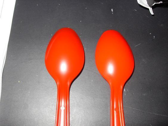

JollySipper Posted April 4, 2016 Author Share Posted April 4, 2016 Finally got a can of the vinyl dye, wanted to show you guys how it looks...... the left spoon was primed, the right one wasn't. It has a deeper color that's hard to get in pics, but in person the primed spoon is a rich ox blood color.......... it also has the sheen that vinyl or leather would have........ Quote Link to comment Share on other sites More sharing options...
gtx6970 Posted April 6, 2016 Share Posted April 6, 2016 Vinyl dyes are hot, designed as such to penetrate vinyl and will most likely attack bare stryene. Quote Link to comment Share on other sites More sharing options...

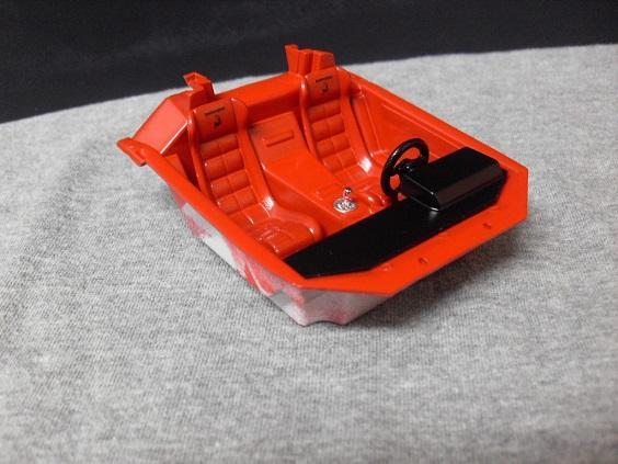

JollySipper Posted April 6, 2016 Author Share Posted April 6, 2016 Thank You for the concern fellas, I've already used it on the interior pieces.... It came out looking pretty good! I'll try to get a pic up soon so you can see it...... Quote Link to comment Share on other sites More sharing options...
JollySipper Posted April 6, 2016 Author Share Posted April 6, 2016 Here's the interior of the Countach I'm working on.................. Quote Link to comment Share on other sites More sharing options...
