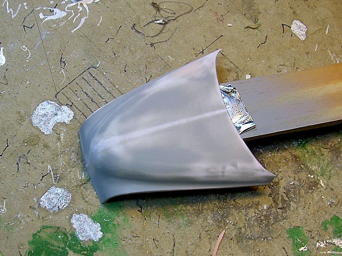

Ace-Garageguy Posted February 25, 2016 Posted February 25, 2016 (edited) Just a couple FYIs, for future reference, based on extensive first-hand experience. When you "sand" the styrene plastic that our models are made of, you invariably break the surface, which is usually somewhat harder and more solvent-resistant than what's under it. So, any solvents in your paint will attack where the surface has been sanded much more aggressively than they will on other areas. Case in point. I removed the raised peak and the emblem from this Revell '50 Olds hood. Naturally, in filing off the raised portions, I went into the softer material beneath it. I lightly scuffed the rest of the hood and started shooting primer. EVERYWHERE the raised details had been removed, the Duplicolor primer I used attacked and crazed the plastic, but it laid down nicely where the surface had just been scuffed. It took several sessions of lightly sanding the crazing out, re-shooting with primer, and re-sanding to get a perfect surface for paint...and a sufficient barrier of primer so that the paint wouldn't attack the underlying plastic again. But patience and practice have their rewards. After allowing the primered hood to dry very thoroughly, I shot a Duplicolor lacquer color over it. No crazing, and the paint slicked out very nice and glossy...in this shot with one coat of clear. This has not been sanded or polished, either. Practice, practice, practice...and patience. Edited May 30, 2016 by Ace-Garageguy

Ace-Garageguy Posted February 25, 2016 Posted February 25, 2016 (edited) Different modelers have different preferences for prepping bare plastic. DON'T bother with the adhesion-promoter. As Longbox55 said, it's made for flexible plastics on real-car bumpers and interiors and is entirely a waste of money on a model. This is what works 100% right for me, every time. Scrub the bare plastic body or part with warm water, an abrasive cleaner like Comet, and an old toothbrush. This will give a nice 'tooth' to the surface for good paint adhesion, and will get in to nooks and crannies you can NOT possibly reach with sandpaper or other means like Scotch-Brite pads. Sandpaper tends to 'dull' or round-off surface details, and you don't have to worry about that with the Comet method. The cleanser will also do a good job of removing surface contaminants like mold-release-lubricants that may be on your new model. Rinse with plenty of water, very thoroughly, and dry. At this point, I take another step some consider to be unnecessary, and I wipe the whole thing down with 70% ISOPROPYL alcohol (cheap, simple rubbing alcohol from the drug or grocery store). It will remove any remaining contaminants, and is excellent insurance against fisheyes. I got in the habit of using the alcohol wipe on full-size aircraft and custom car paint jobs, and it's never let me down yet. I prefer to primer everything, because I find I get a better paint job in the end. The downside to primering is that it's another opportunity for the dreaded 'orange-peel' to creep in, and if it does, it has to be sanded out. Spraying paint over orange-peely primer will look like carp. There are some primers some guys swear by, like Tamiya, that I'm not familiar with enough to recommend...but they say they lay out smooth and slick once you get the hang of using them. That's what you want, if you want to avoid having to sand out 'peel'. I use Duplicolor and SEM primers made for real cars, and they're a little "hot". Duplicolor has two basic kinds...high-build "scratch filler" and a thinner-bodied "sandable" version. if you haven't done any bodywork, and have no deepish scratches that need filling, the "sandable" version slicks out nicely. If you choose to use a primer, and if you can shoot it slick, I'd still recommend scuffing it with Comet, and cleaning it again with alcohol before painting. Practicing and becoming familiar with the way different materials work and handle is the only way to get good at this stuff, so don't get disappointed. DO try to practice on something other than a model you care about FIRST. Plastic pop-bottles make good practice targets for learning how to shoot paint. Prep them exactly as you would a model. The point is to find out EXACTLY what works for YOU. This car was shot with Duplicolor primers and Testors "one-coat" paint and clear. I'm sure everybody here is sick of seeing it on every other how-to paint thread, but it's an example of the results you CAN get from rattlecans. Edited February 25, 2016 by Ace-Garageguy
