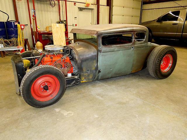

CelticModeler Posted February 27, 2016 Posted February 27, 2016 So beginning the first non box stock build with a 32 ford coupe rat rod. Have a reference pic of what id like it to roughly resemble but have not done any customizing work what so ever with modeling before. I am very green( this being my third build). Was looking for help and ideas on what to modify and how to set things up. I know i want to do a chop top and think i can do that with my skills. My main thing i need help with is lowering the car. I want it to basically lay frame on the ground. Also looking for design ideas to make it look "ratted" i tried looking for rat rod builds but couldnt see to find any using the search bar. Anyways any help would be appreciated and i will update the build as i go. Wish me luck

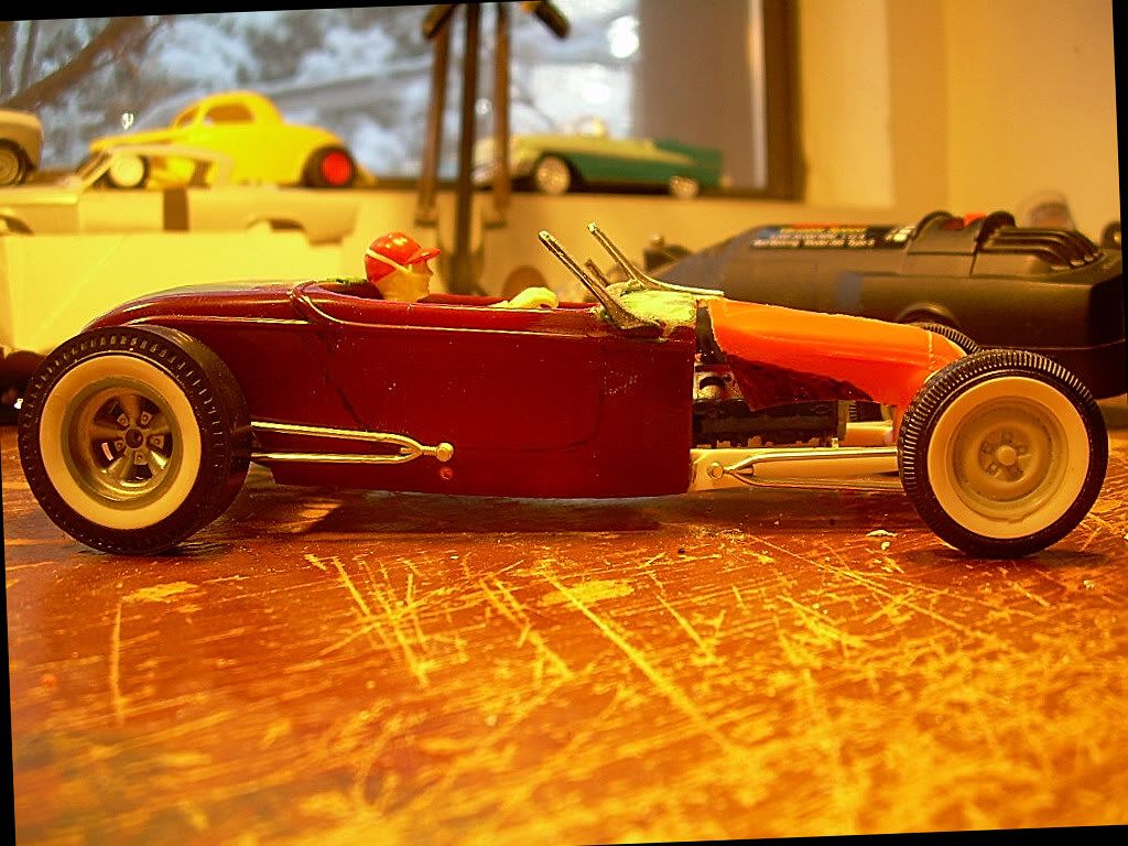

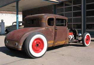

CelticModeler Posted February 27, 2016 Author Posted February 27, 2016 Also this will be my first model using an airbrush. If anyone can give me tips or ideas on how to paint the body of the car and frame. I want a mix between the reference car above and this one below. I have never used an airbrush before so go easy on me. Thanks again guys

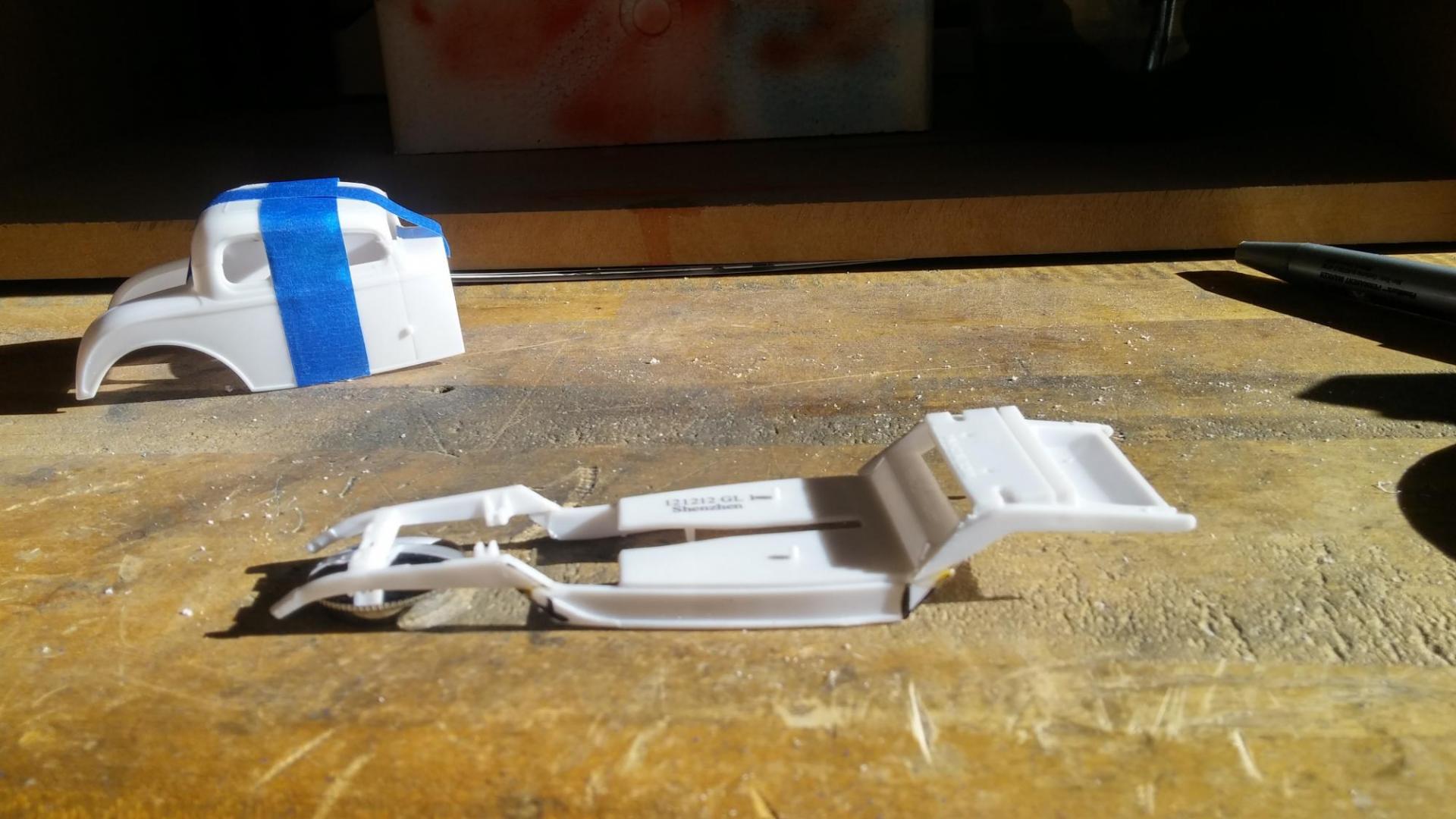

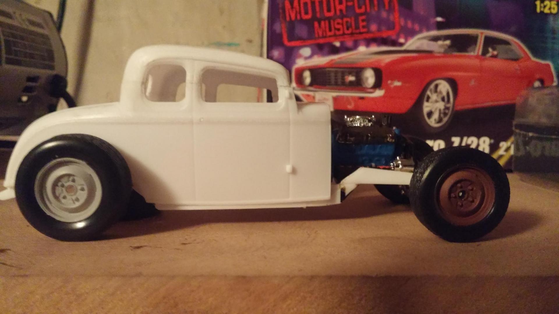

CelticModeler Posted March 2, 2016 Author Posted March 2, 2016 (edited) So finally got around to working on this build. Im doing two at the same time. But anyway. Zeeing and chopping the top sounded alot easier than what it turned out to be and yes i can see this is going to be alot of dry fitting on this one. First car i have built requiring mods like this so deff a learning curve. Also tried to get the chop lines to smooth out with putty but wasnt working to well. Glad im going for a rat on this one and not a polished show car haha. Edited March 2, 2016 by CelticModeler .

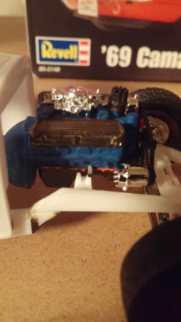

CelticModeler Posted March 2, 2016 Author Posted March 2, 2016 Worked some more tonight. Got most of the motor done. Trying different little things like "orange gasket" on the oil pan. Also painted the wheels and tried to get an idea of where it will sit at ride height. Think i need to dechrome the rest of the motor parts. Might keep the carb chrome tho. And yes i know the window gaps dont line up great on the front. Going to have to work with it some more.
crazyrichard Posted March 2, 2016 Posted March 2, 2016 yes you see the lines match , but not on the front , what you can do is ad a piece on top at the front , maybe a visor will help also .. i like the rake of the roof
CelticModeler Posted March 2, 2016 Author Posted March 2, 2016 I havent figured out what exactly im going to do to fix it yet. It is exactly the chop and rake i wanted but now i have to deal with that haha.the other side isnt as bad as this side tho. Not bad for my first chop tho i think. Will work on it some more tonight and post an update. So far its been tougher than i expected but still fun
