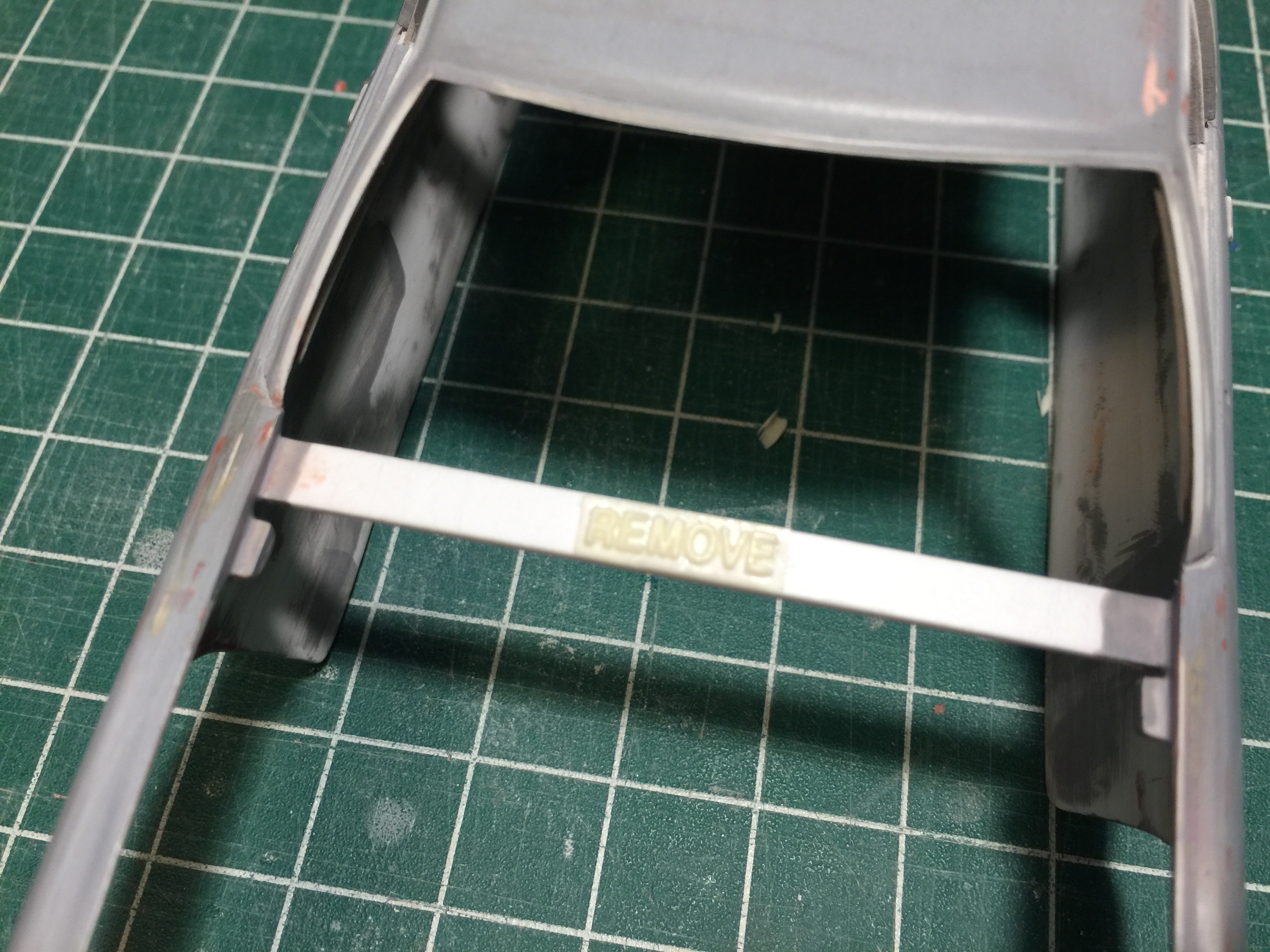

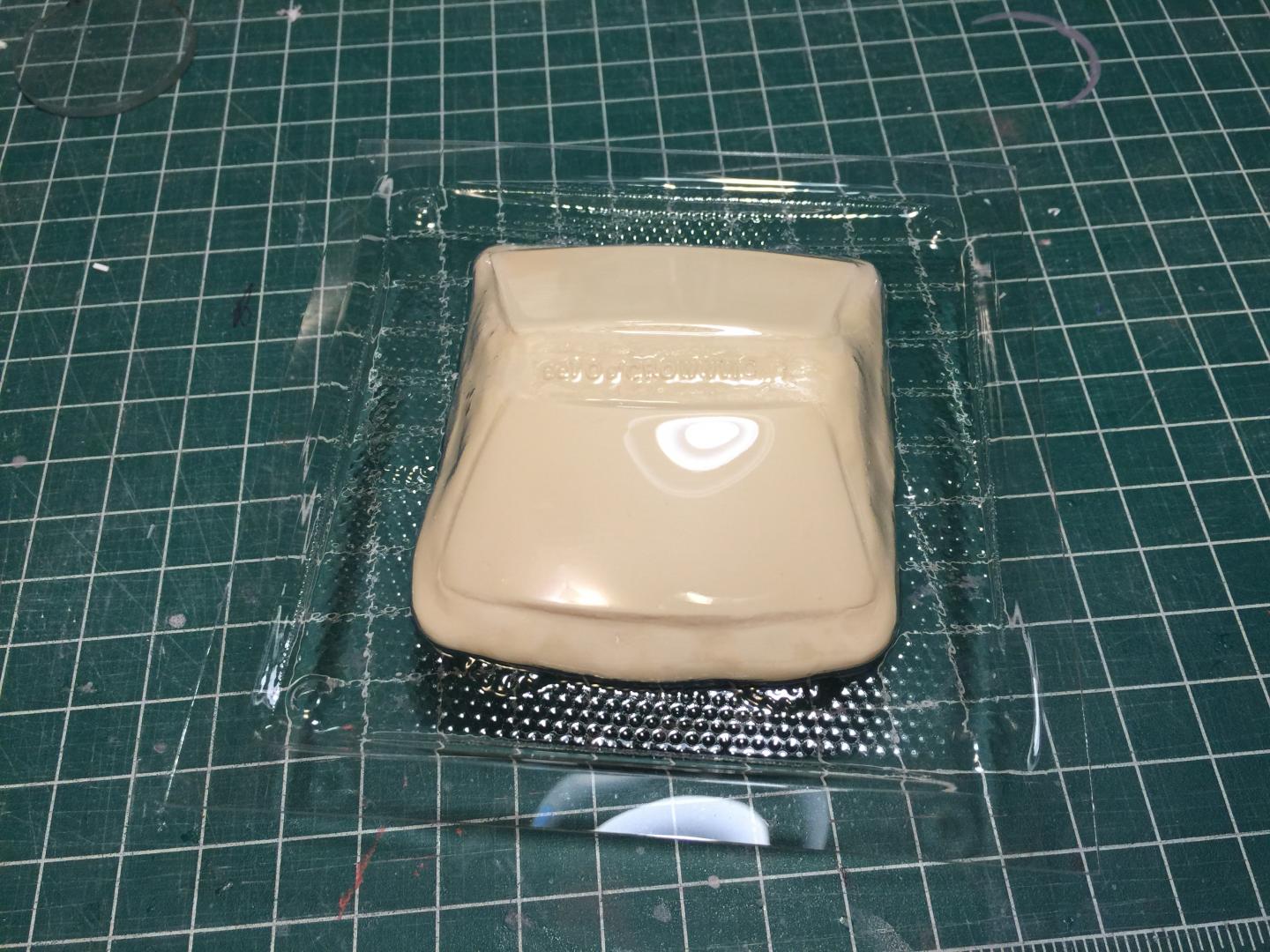

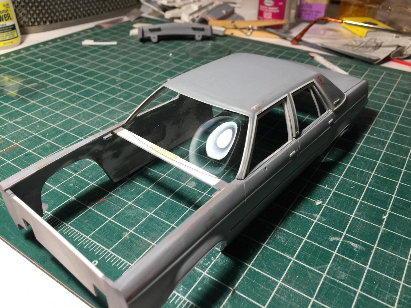

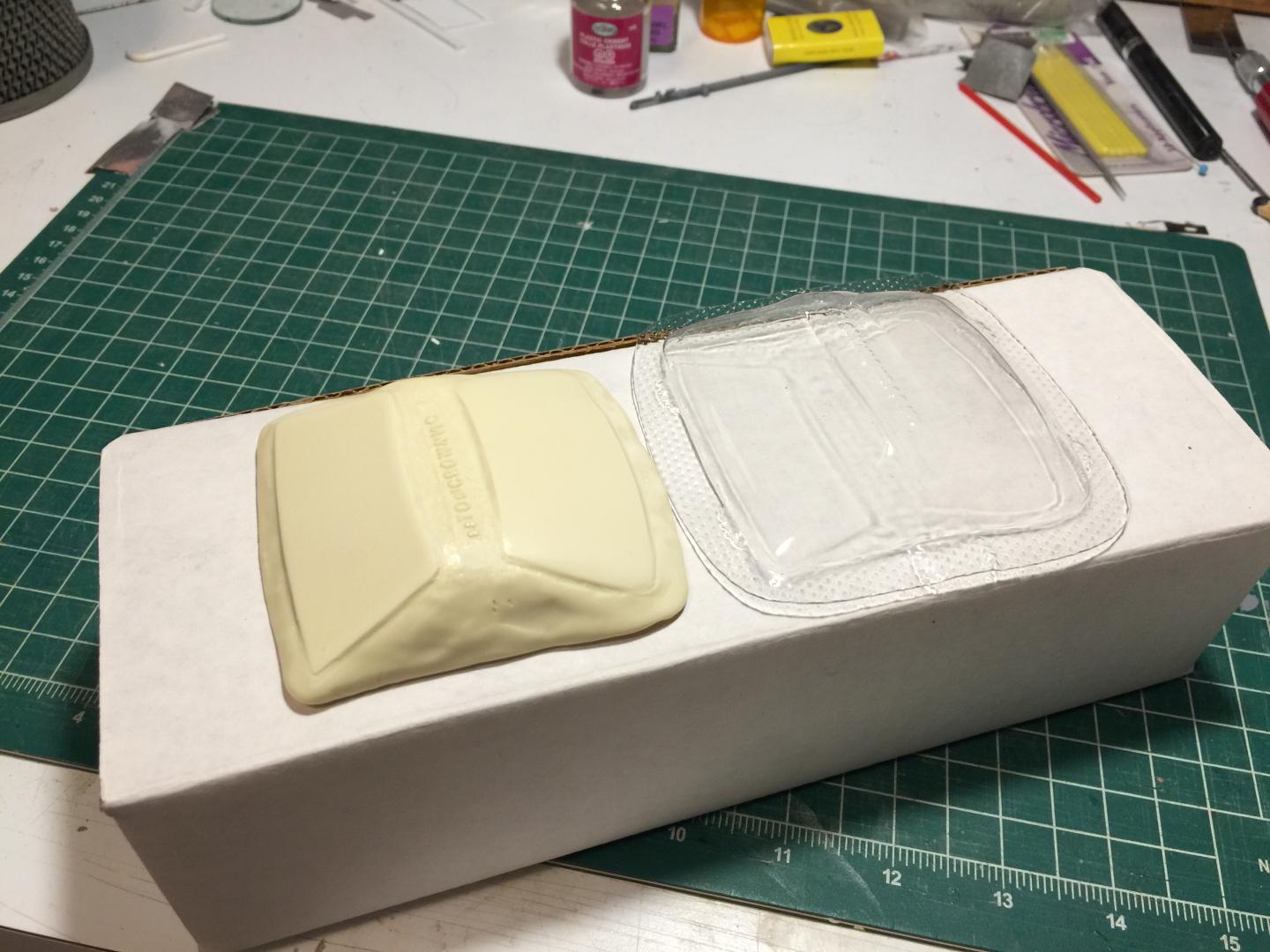

Greg came by last night with the glass buck. I dressed it up a bit and pulled down glass set #1. Cut them out and test fit to the master, perfect fit, front and rear.
I also added a REMOVE bar for casting purposes. This keeps the sides of the car from spreading under pressure.
And with that, Greg took the master home to start letting the clay fly. Officer Baker - there may be a body ready for the DSC, we'll just have to see. Cutting it close, though.

Link to comment
Dwayne, It's vacuformed, as are all the Master Caster glass sets. WAY more clear than clear resin. I use a professional dental vacuform machine that was designed to do impression or bleaching trays, and .020 PET-G plastic, same stuff used for water/soda bottles. I buy a 4' x 6' sheet of the stuff at a time.

Gorgeous work guys!  Mike, you're right.  That PetG is better for the glass that I think even clear styrene would be.  Virtual perfect optic clarity!  Now.. if you could just figure out how to put the shaded blue at the top and dot matrix around the bottom... KIDDING!!  It is beautiful.
