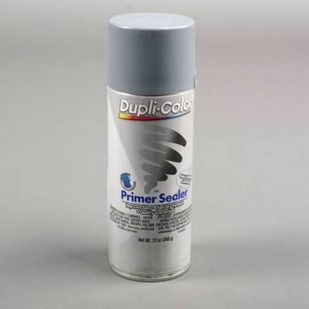

Suzier Posted March 7, 2016 Author Posted March 7, 2016 If you use the right primer, paint for real cars can be used with little trouble. Duplicolor is the popular brand, and can be found at any car parts store. Some department stores also carry it. Duplicolor also makes a primer that is very model plastic friendly.Sounds good! Is this the right primer? http://www.walmart.com/ip/48341703?wmlspartner=wlpa&adid=22222222227035925324&wl0=&wl1=g&wl2=t&wl3=57112021418&wl4=&wl5=pla&wl6=89244605138&veh=sem

Longbox55 Posted March 7, 2016 Posted March 7, 2016 Yes, the primer sealer will work very well for models. Duplicolor also has a sandable primer, as well as a high build primer/filler that can come in handy if you get into doing heavier body alterations.
StevenGuthmiller Posted March 7, 2016 Posted March 7, 2016 Duplicolor primer? Yup, should work fine. I usually use the "sandable" primer myself, but either should work. As a matter of fact, I may give the "sealer" a try again in the future. The Duplicolor sandable gray is very dark & there are times when a lighter gray would work better. You can use the Duplicolor primer regardless of what brand of paint you will be using. Word of caution though, Duplicolor primers are "hotter" than hobby primers & can "craze" the plastic if applied too heavily on the first couple of coats. So light coats for the first couple are a good idea. Steve
