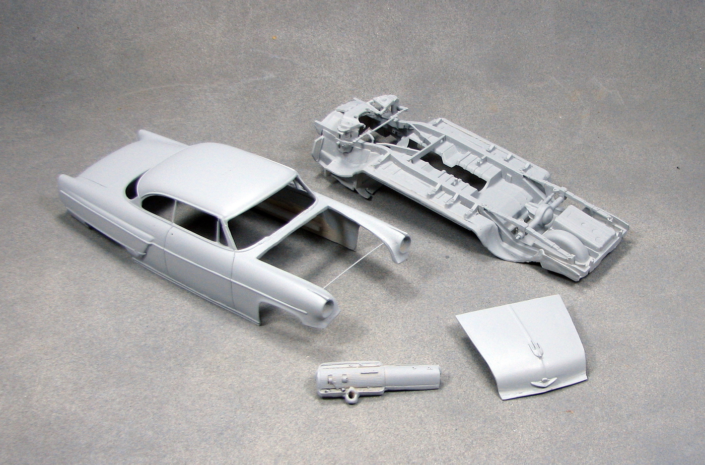

curt raitz Posted March 7, 2016 Posted March 7, 2016 (edited) This is going to be a 1/25th scale model of the 1954 Lincoln Capri Ray Crawford raced in the 1954 Carrera Panamericana. Ray along with co-piloto Enrique finished 1st in the Stock Car Class. R&R Resins (no longer in exists) produced a resin curbside model of both the 1953 and 1954 Lincoln Capri. I was not able to locate the 1954 kit but was able to find a 1953 kit. No big deal, how much difference is there really! Definitely found out the difference when the kit arrived, more on that later. Instead of doing just a curbside of Ray's Lincoln, I decided add chassis and driveline detail to the model. I used the Lindberg 1953 Ford Victoria kit for the chassis, wheels and tires and the Monogram '57 Ford Del Rio Ranch Wagon kit for the engine. I found a set of decals for the car from "Platto's Place" and my buddy Steve filled in with a couple of extra decals. Now on to the difference between a 1953 and 1954 Lincoln Capri. The chrome trim on the sides and the front and rear bumpers are completely different. I removed the hood, firewall and chassis side panels from the resin body. To be replaced with the same parts from the 1953 Ford. Also removed the '53 trim from the body. After removing the '53 trim from the body, I used really small half-round plastic strip for the '54 trim. More to come...the NNL West is calling! Edited March 7, 2016 by curt raitz 3

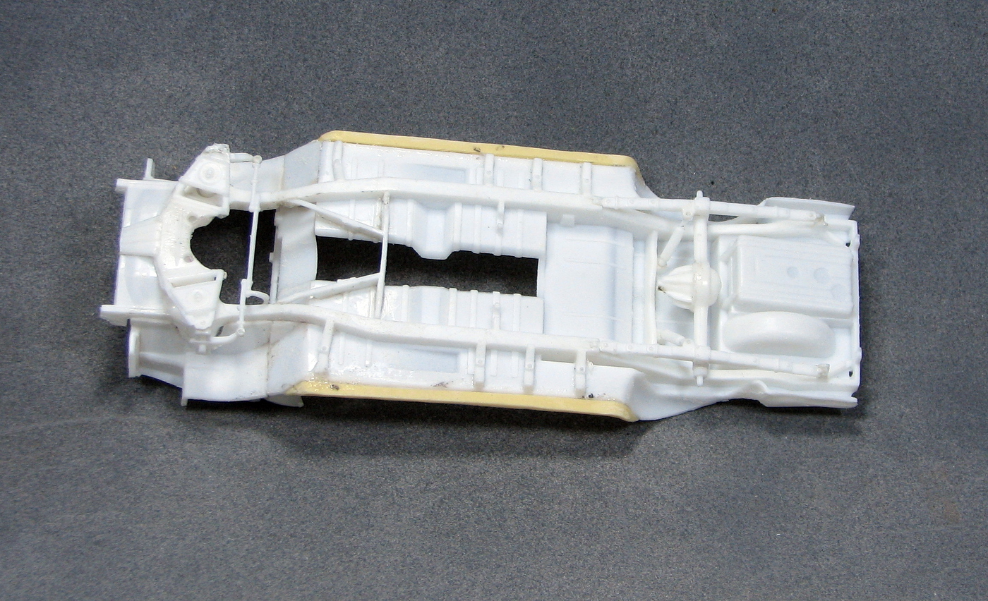

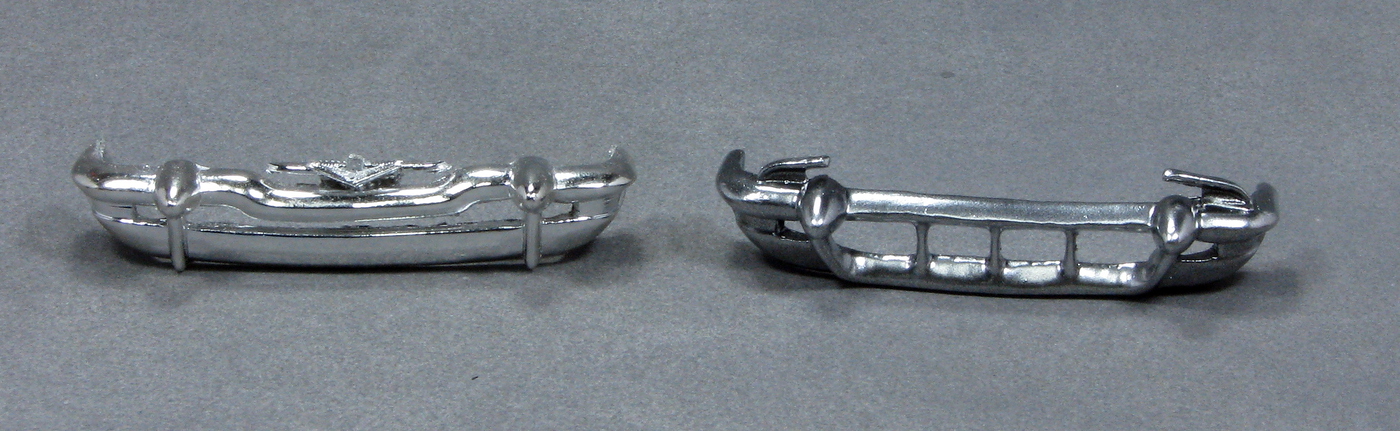

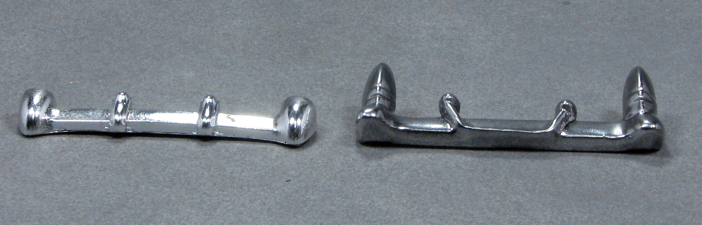

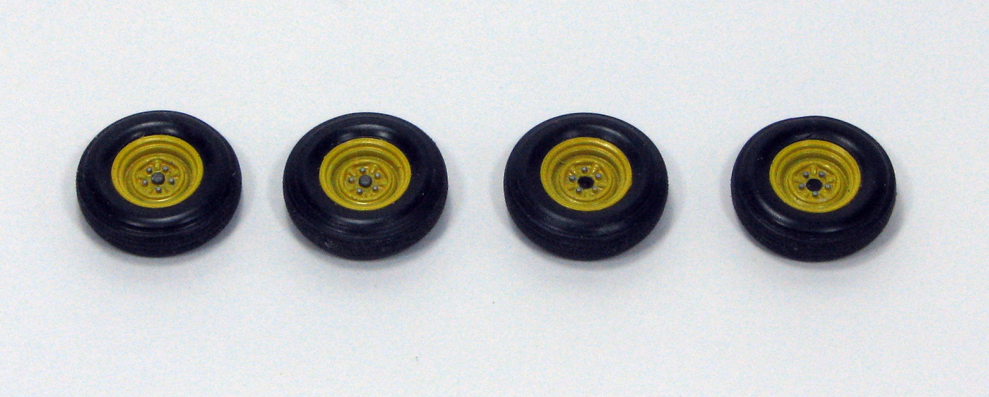

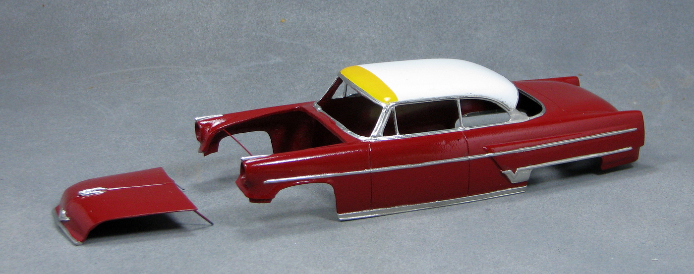

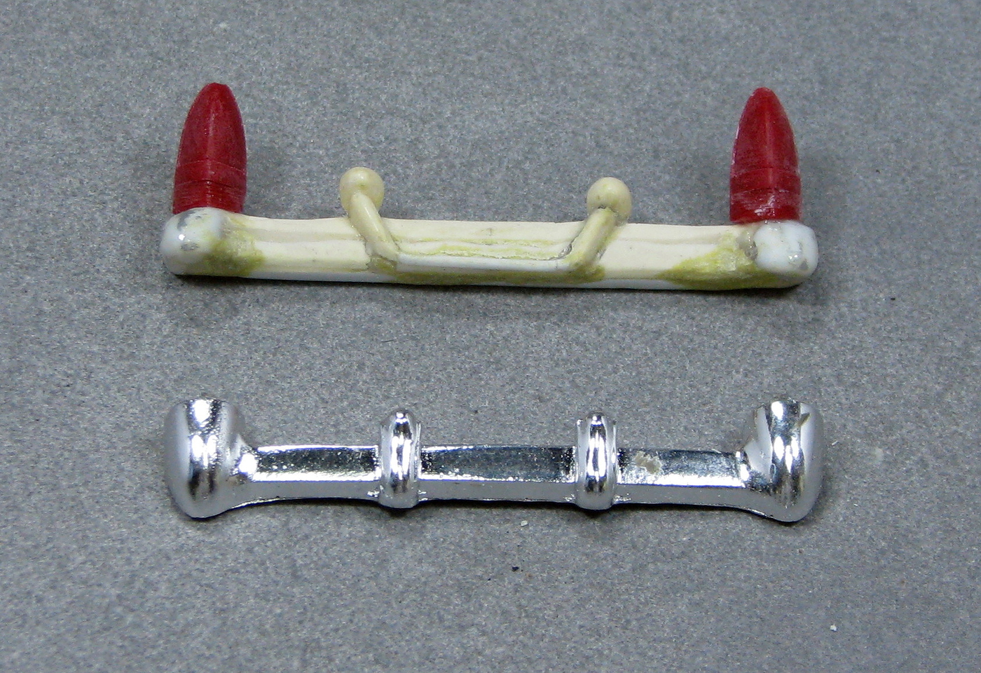

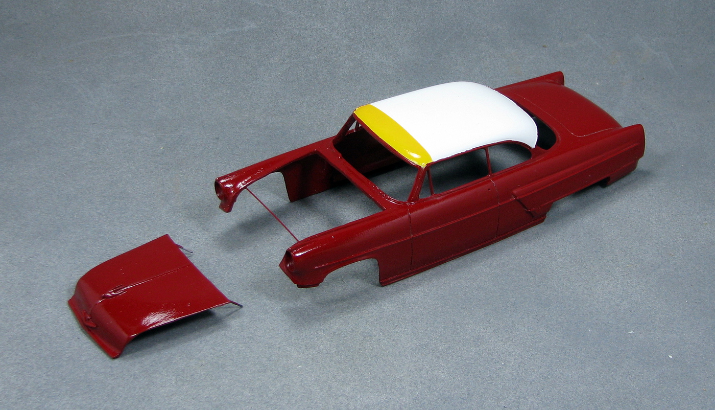

curt raitz Posted March 9, 2016 Author Posted March 9, 2016 Thank you for the positive responses on this model. I was able to squeeze in some time to finish a few things on the Lincoln. First I had to tackle the bumpers, very key parts to make this model come to life. I made resin copies of the 1953 front and rear bumpers. I added the red resin taillights to the rear bumper. Here is the completed '54 rear bumper (right) next to the '53 bumper (left). The Chrome finish is provided by Alclad. Also here is the completed '54 front bumper (right) next to the '53 bumper (left). Next was modifying the '53 Ford chassis to fit the resin body of the lincoln. The body, chassis, hood and dash primed and ready for paint. The body and hood painted ready for some bare-metal foil work. The foil work is done... Wheels and tires painted and mounted. Now onto finishing the interior, engine and decals... c'ya

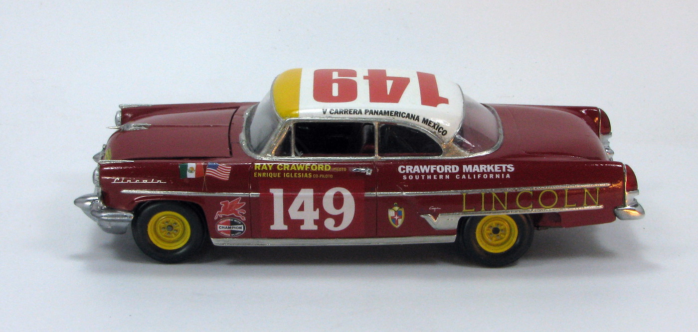

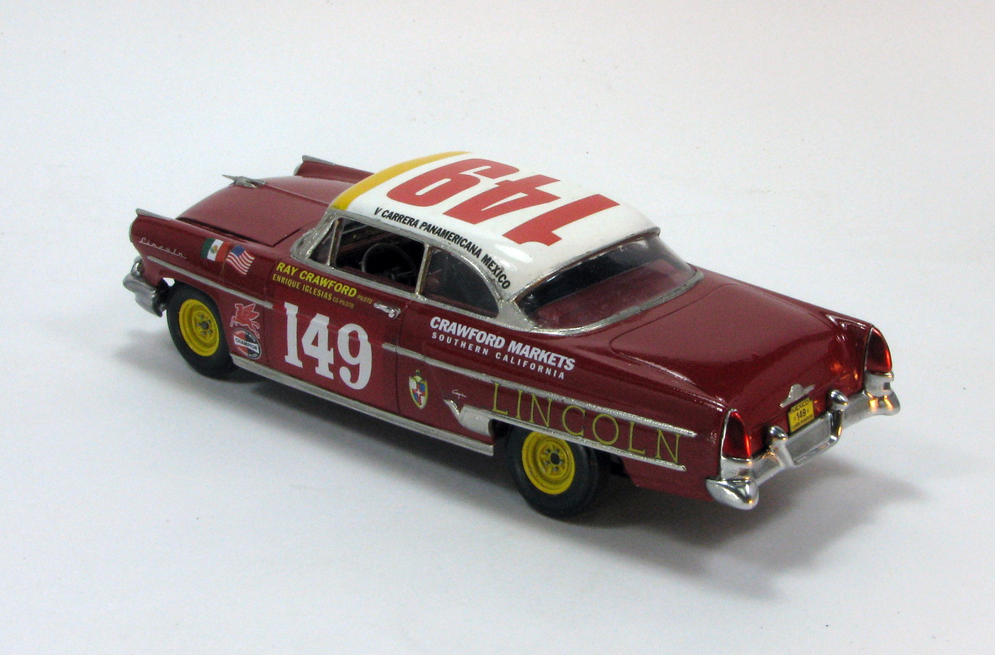

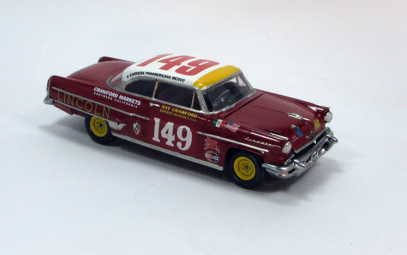

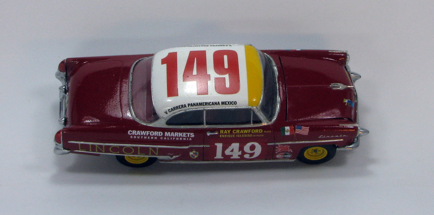

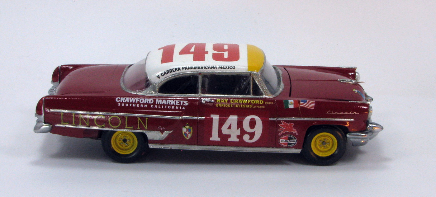

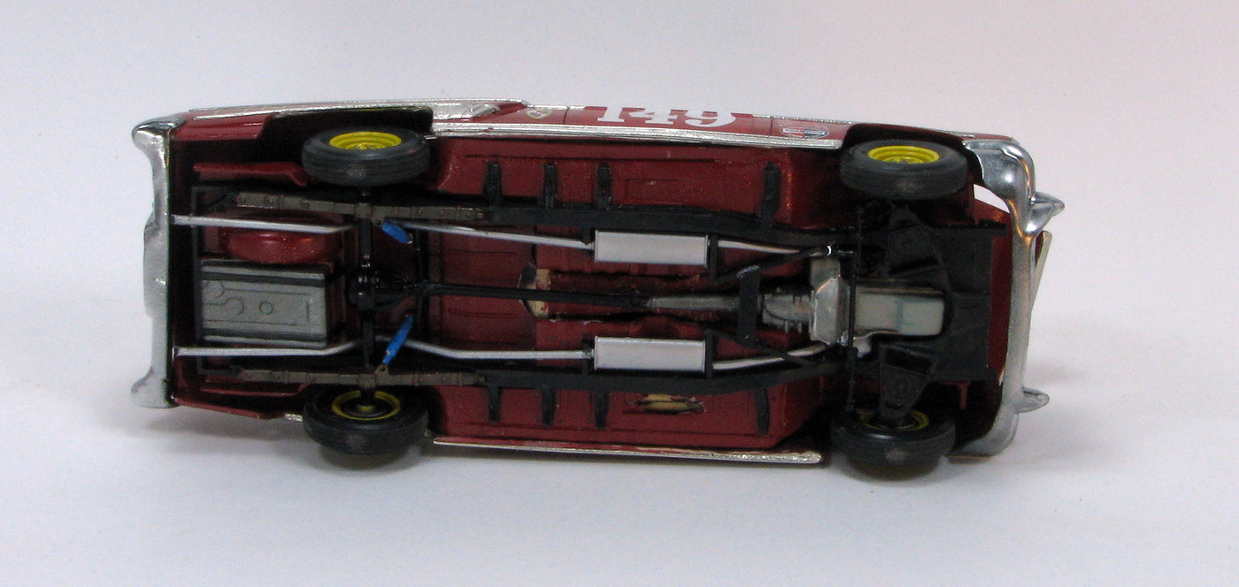

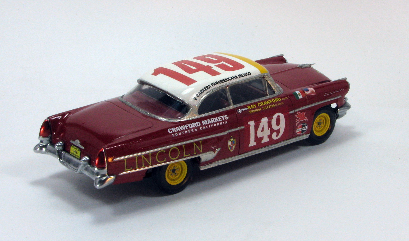

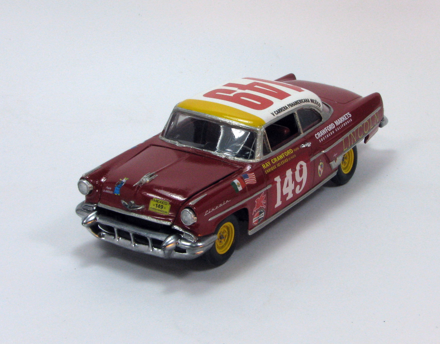

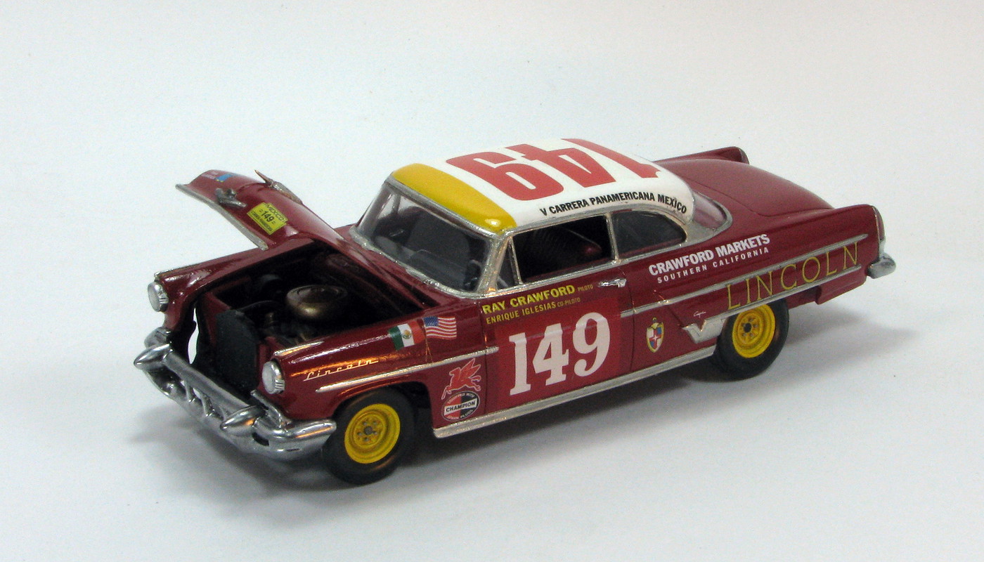

curt raitz Posted April 12, 2016 Author Posted April 12, 2016 I was able to complete the car for the NNL West, just got back from the Desert Classic in Phoenix. Thought I should post photos of the finished Lincoln. Thank you for your comments, etc. 1
