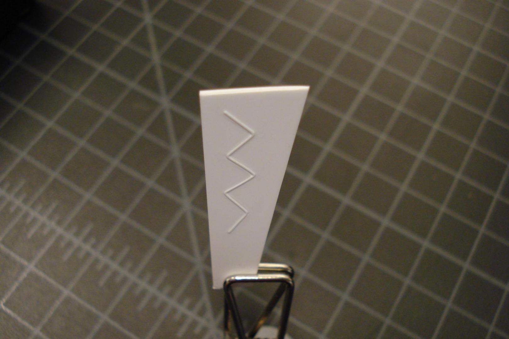

STYRENE-SURFER Posted March 12, 2016 Posted March 12, 2016 I am trying to add some detail to a mostly scratch built chassis, just to make it more visually interesting. Putting some bead rolling on the firewall and underside. Did some testing on scrap styrene ( .010 x .020 strip glued w/ thin cement). I then laid 1 layer of masking tape around the glued strips and sanded till they where even w/tape. This left a square top edge so I scrubbed the whole thing w/cleanser as an aggressive pollishing agent. At this point I was fairly happy w/how things looked. However under scrutiny, there are irregularities caused by the solvent based cement that show through. Perhaps I am going about this all wrong. Any help or ideas would be appreciated.
Ace-Garageguy Posted March 12, 2016 Posted March 12, 2016 Great idea! It looks like you're almost there to me. At this point, I'd try cleaning up anything you don't like with riffler files, the edges of sanding sticks (cut to shape to ease getting into corners), or the corners of folded-over sandpaper. Real bead-rolling is difficult to do with sharp corners because of the way the sheetmetal has to be turned in the dies during rolling, so it might be wise to try to round them somewhat during application of the stock. It might also ease your work if you started with half-round stock, but I see the wisdom of sanding the top straight after forming the bead, as you did here, too. What you have looks very good, just needs a little fine tuning to be great.
STYRENE-SURFER Posted March 15, 2016 Author Posted March 15, 2016 Ace... Thanx, I think it looks just OK, but like you say it needs fine tuning.I ordered some Plastruct half round .030 to try. My biggest problem is glueing such small pieces without the solvent glue damaging the surface of where it is attached.Is there some other type of glue that might work better?

Foxer Posted March 16, 2016 Posted March 16, 2016 (edited) I've been working on installing chrome trim on a promo that was lacking it using the .03 round. First, I would say that what you have looks really good! When you paint it will smooth everything out a touch so I would leave it as is. At most maybe just sanding with fingers over the whole piece will round out the top corners a bit.The half rounds are tougher to get smooth that rectangular because the thin edges react to the solvent more. I'm a bit sloppy and go back and smooth everything out the way Ace suggests. I've been using old brushes the find one that puts the minimum glue down trying to minimize the plastic squish out the sides as the solvent really melts these thin pieces. I have gotten aggressive with the glue since the 60 year old plastic doesn't melt as well as the newer stuff, so it has gotten messy but still working, just more cleanup. On the curves I have to brush over the length of the half rounds and it softens and bends to the radius very well if you do it while it's flat to the body surface.And Bondic won't work well for this. The light can't penetrate the solid plastic to cure the material directly under the piece and will only stick as the Bondic squished out cures ... as you don't want. Edited March 16, 2016 by Foxer
Misha Posted March 16, 2016 Posted March 16, 2016 Interesting topic! I would also try using half round stock and then proceed with the sanding. For gluing with little mess and for quickness I usually use Tenax 7 R, a great glue that cements plastic nearly instanously. Over the years it's been difficult to find, yet Hobby Depot in Tempe stocks it and I usually keep a couple of bottles on my bench.Cheers Misha
Foxer Posted March 16, 2016 Posted March 16, 2016 Interesting topic! I would also try using half round stock and then proceed with the sanding. For gluing with little mess and for quickness I usually use Tenax 7 R, a great glue that cements plastic nearly instanously. Over the years it's been difficult to find, yet Hobby Depot in Tempe stocks it and I usually keep a couple of bottles on my bench. Cheers Misha Yes, Tenax is what I use, it's even quicker than super glue and accelerator ... apply, hold10 seconds and done and fixed in place. My LHS stocks it in the mountains here. just had to go for more ,cause I forget to put cap on and it evaporates.
Art Anderson Posted March 16, 2016 Posted March 16, 2016 Yes, Tenax is what I use, it's even quicker than super glue and accelerator ... apply, hold10 seconds and done and fixed in place. My LHS stocks it in the mountains here. just had to go for more ,cause I forget to put cap on and it evaporates. There are a number of fast-drying liquid cements out there that are similar, if not exactly the same as Tenax 7R--currently I find Flexi-File's liquid cement at Hobby Lobby. For long "runs" of joints, such as making these bead-rolled or stamped ribbing details, I have used what's called a "Liner" paintbrush. Those are brushes with very long bristles, and come in sizes down to 10/0, again at places such as Hobby Lobby & Michaels. I simply hold the strip of styrene (preferably half-round stock) in position, and very quickly brush a "streak" of this type of liquid cement right along the joint, first on one edge,then on the other edge of the strip. This lets the liquid cement flow quickly into the joint (it's so very thin in consistency that it penetrates most any joint between two pieces of Evergreen or Plastruct). Within a few minutes, the strip stock is very strongly attached, and with practice (experience) almost never a trace of anything from the liquid, nor any blobs of melted styrene along the joint. Art

STYRENE-SURFER Posted March 20, 2016 Author Posted March 20, 2016 I got my order from Tower w/.030 half round and did some experimenting. It looks quite convincing especially if the ends are carefully sanded to a radius.This works fine for straight bead rolls, but for making rounded corners it is difficult.By the way that "W" pattern I am trying to replicate is found on a 1940 ford fire wallsort of a inverted double "W".With rectangular stock you can bend it easily, w/half round not so much. I did find out one real problem I was having with the .010x.020 Evergreen strips.Under a loupe I can see that one side is very rough from apparently however they cut them.Good luck sanding these little things.:(The liner brush idea I will have to look into, but even w/a regular Tamiya bottle brush theresults are looking better w/practice.
