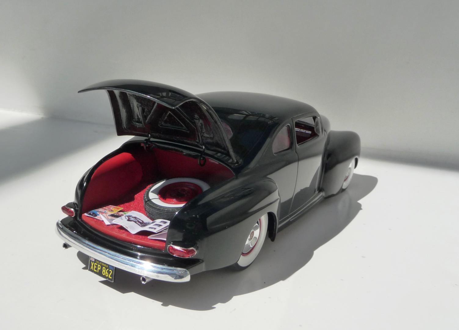

dino246gt Posted September 12, 2018 Posted September 12, 2018 I did a period custom, using Revell's chopped '48, and kept Revell's front fender to door intact, otherwise the AMT'41 will droop to the front. So here it is in a nutshell!

Greg Myers Posted September 12, 2018 Author Posted September 12, 2018 Why the zig zag cut on the front fenders ?
Jon Haigwood Posted September 12, 2018 Posted September 12, 2018 The 48 back end looks very close other than the tail lights and bumper. The bumper in the 41 kit will work but the tail lights are different.
espo Posted September 12, 2018 Posted September 12, 2018 6 hours ago, dino246gt said: I did a period custom, using Revell's chopped '48, and kept Revell's front fender to door intact, otherwise the AMT'41 will droop to the front. So here it is in a nutshell! That is a beautiful conversion. I would think you could do the same thing with the stock '48 Ford coupe just as well.

alan barton Posted September 13, 2018 Posted September 13, 2018 Thanks Dennis, for showing us a beautiful model and a great way of doing it. I don't know that I would have thought of the zig zag cut but it is so obvious when someone else has already done it! Not only do you overcome any proportion issues that you mentioned, you also have a much easier area to prepare for paint, rather than trying to clean up the join between the back edge of the fender and the front edge of the doors - that would be a nightmare! I had already cut the front off the woody for such a project and was also intending to graft a 41 Plymouth front clip onto the remaining woody body. Your great work here has got me thinking about it all over again! Cheers Alan

dino246gt Posted September 13, 2018 Posted September 13, 2018 Yes I think using the stock Revell '48 would be the same as what I did with the chopped version. Have you, or anyone else, tried that '41 Plymouth front clip? I have the woody body that I've been "playing" with, don't have front fenders for it yet and using '48s seems silly because there IS a '48 woody already. Oh, for my custom I used stock '49 Merc tail lights and I think they're perfect, considering that "back then" they used parts from other cars for customs.
