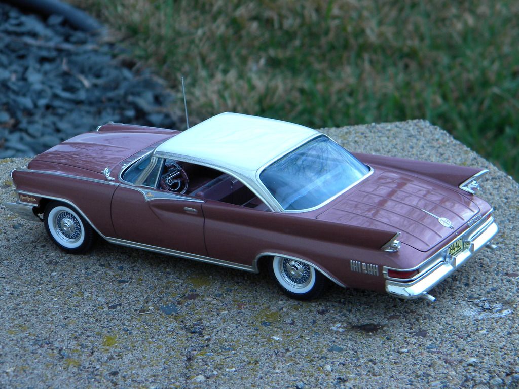

Ace-Garageguy Posted March 22, 2016 Posted March 22, 2016 No reason not to do it. Pluses include less total paint thickness and fewer opportunities to get trash in the finish material. Steve Guthmiller used clear over white primer for the roof of this beautiful model, and you can't beat Steve's work. Good enough for Steve, good enough for me.

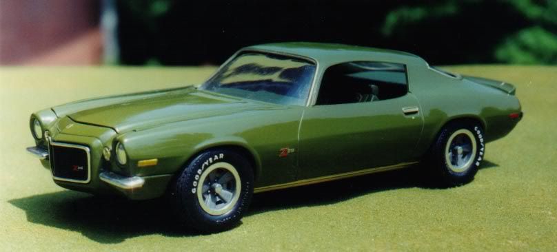

Snake45 Posted March 22, 2016 Posted March 22, 2016 Yes, you can shoot gloss over a (flat) primer and end up with a nice finish. I did that on a lime green '71 Camaro once.With white, though, you always have to worry about your clearcoat yellowing with time. For white, I'd always rather go ahead and shoot a gloss white paint, preferably Model Master Classic White, which has given me good results.

Snake45 Posted March 25, 2016 Posted March 25, 2016 Yes, you can shoot gloss over a (flat) primer and end up with a nice finish. I did that on a lime green '71 Camaro once. And here it is. Model Master 34151 Interior Green playing the role of Citrus Green, which I didn't realize was metallic at the time.
