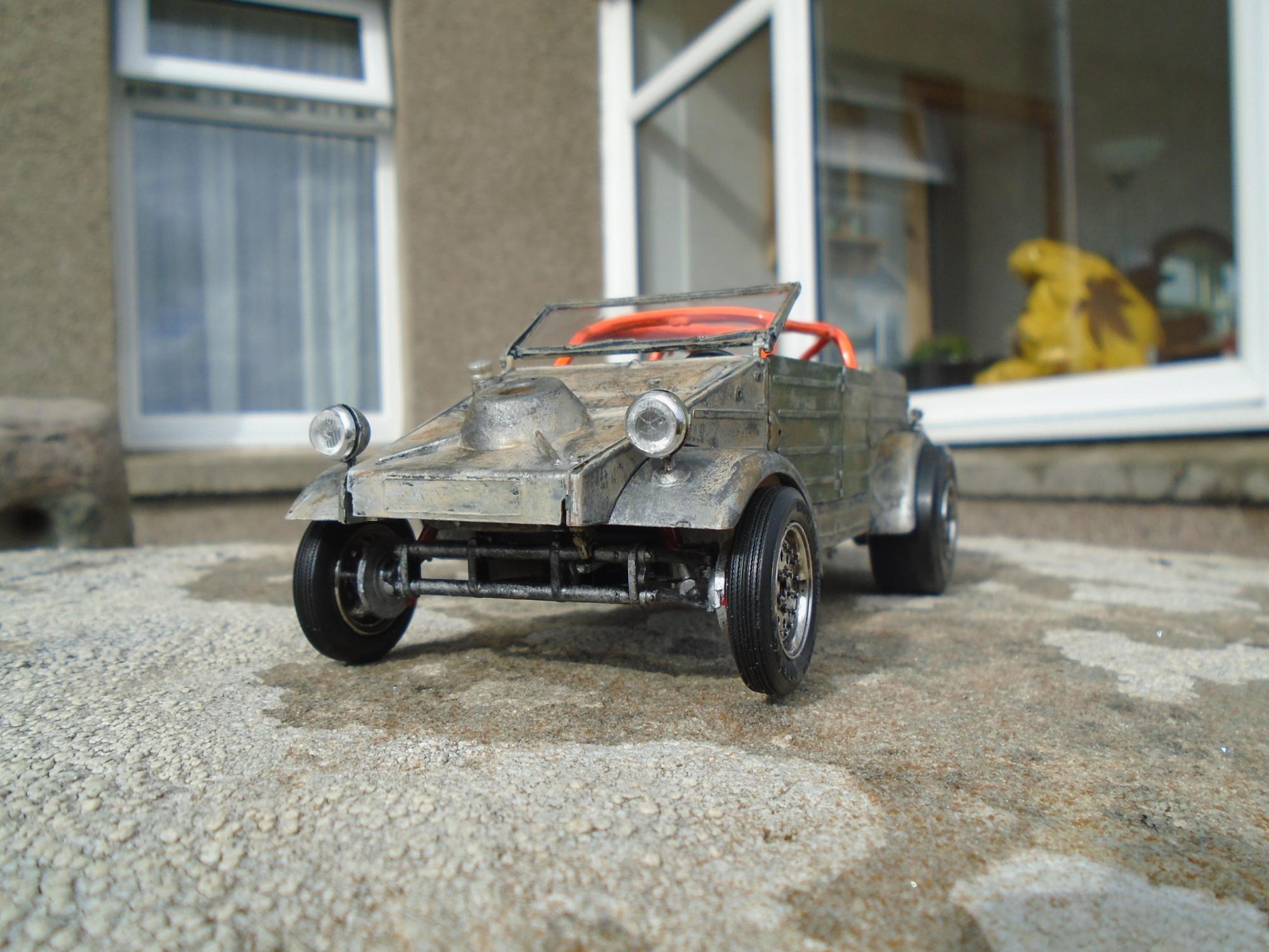

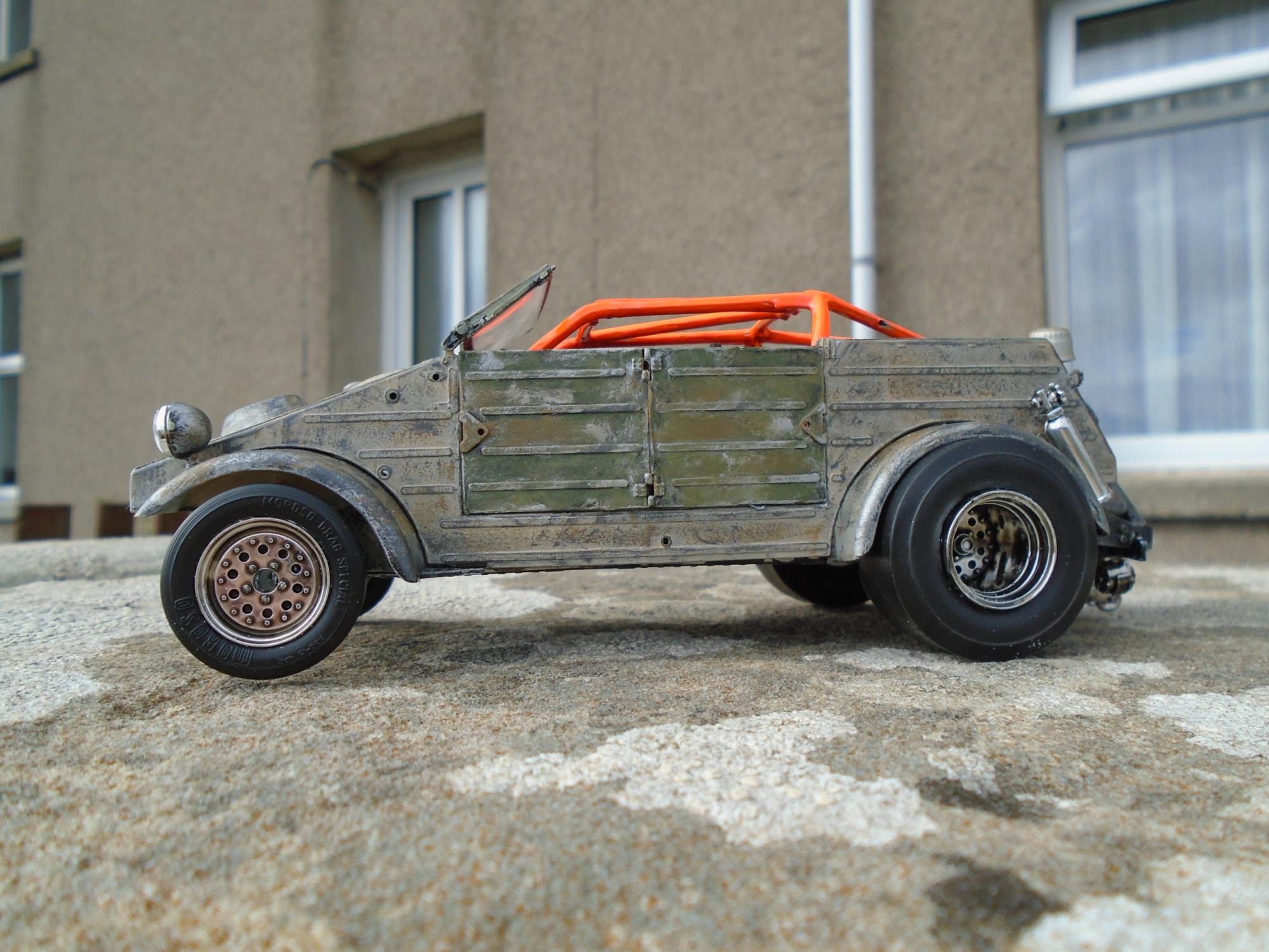

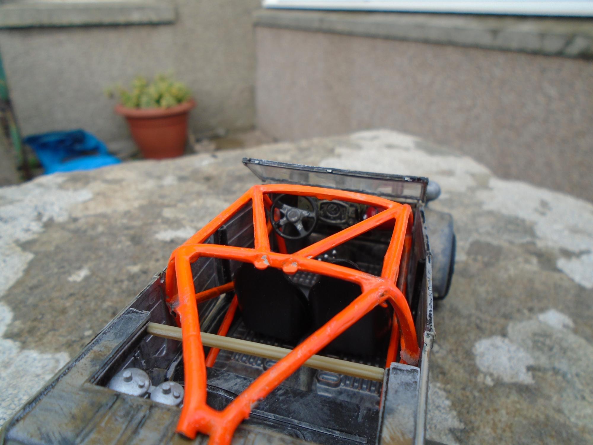

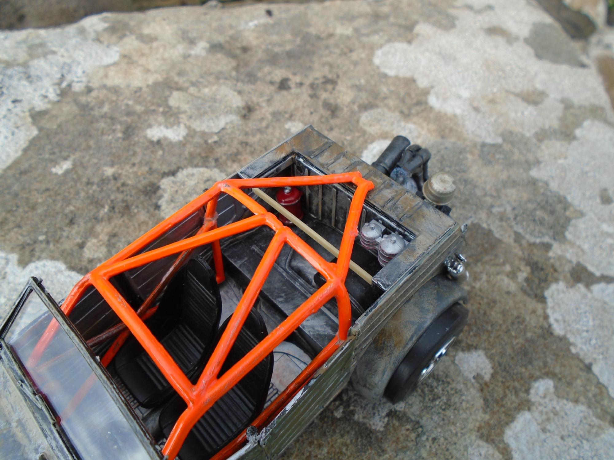

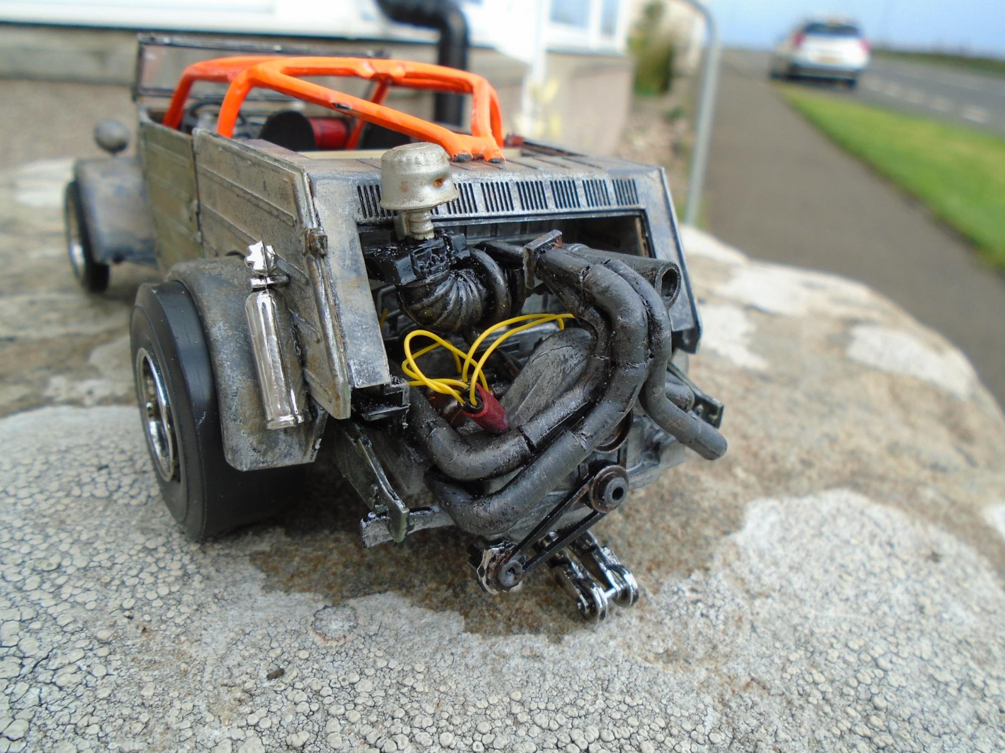

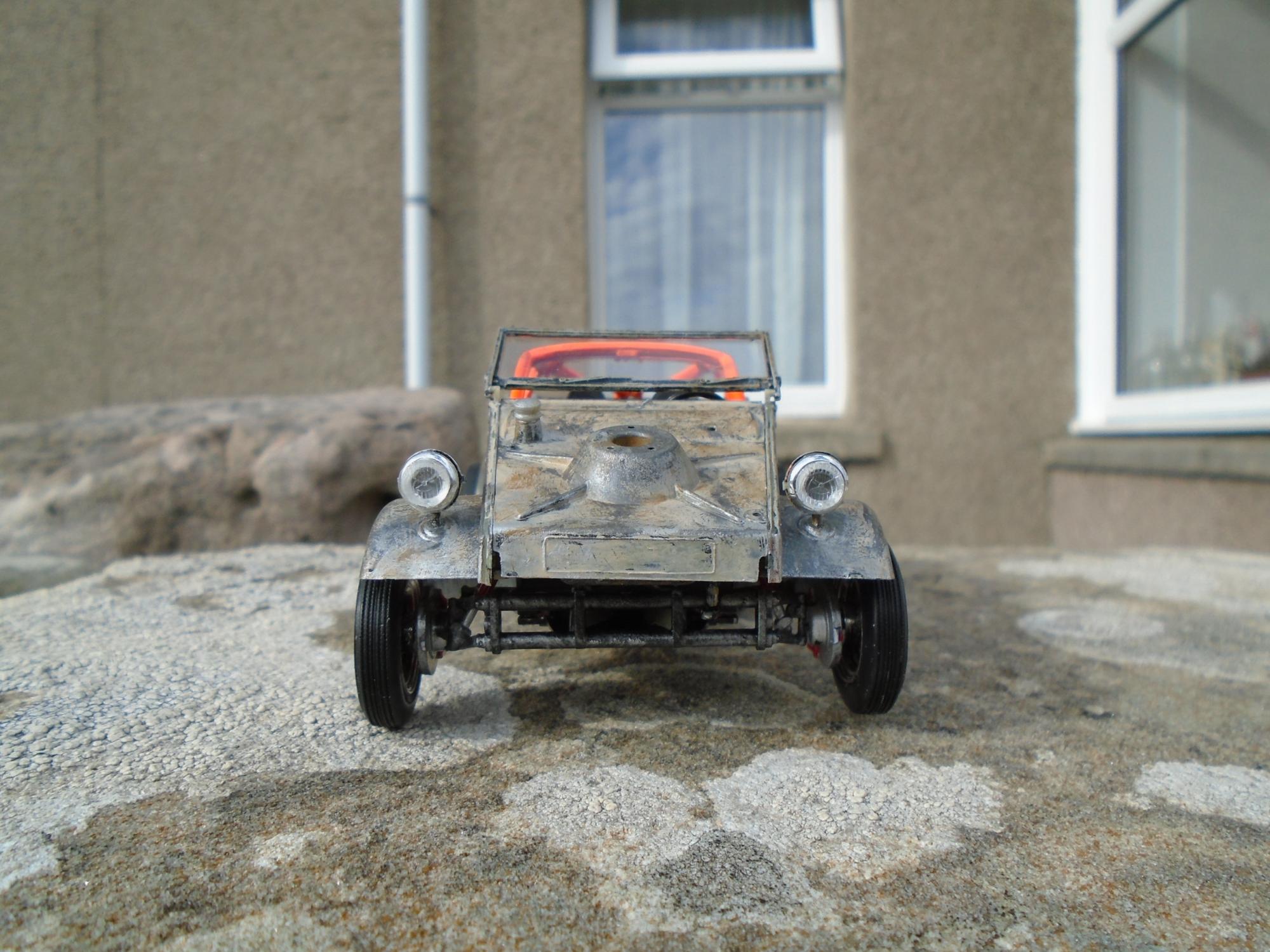

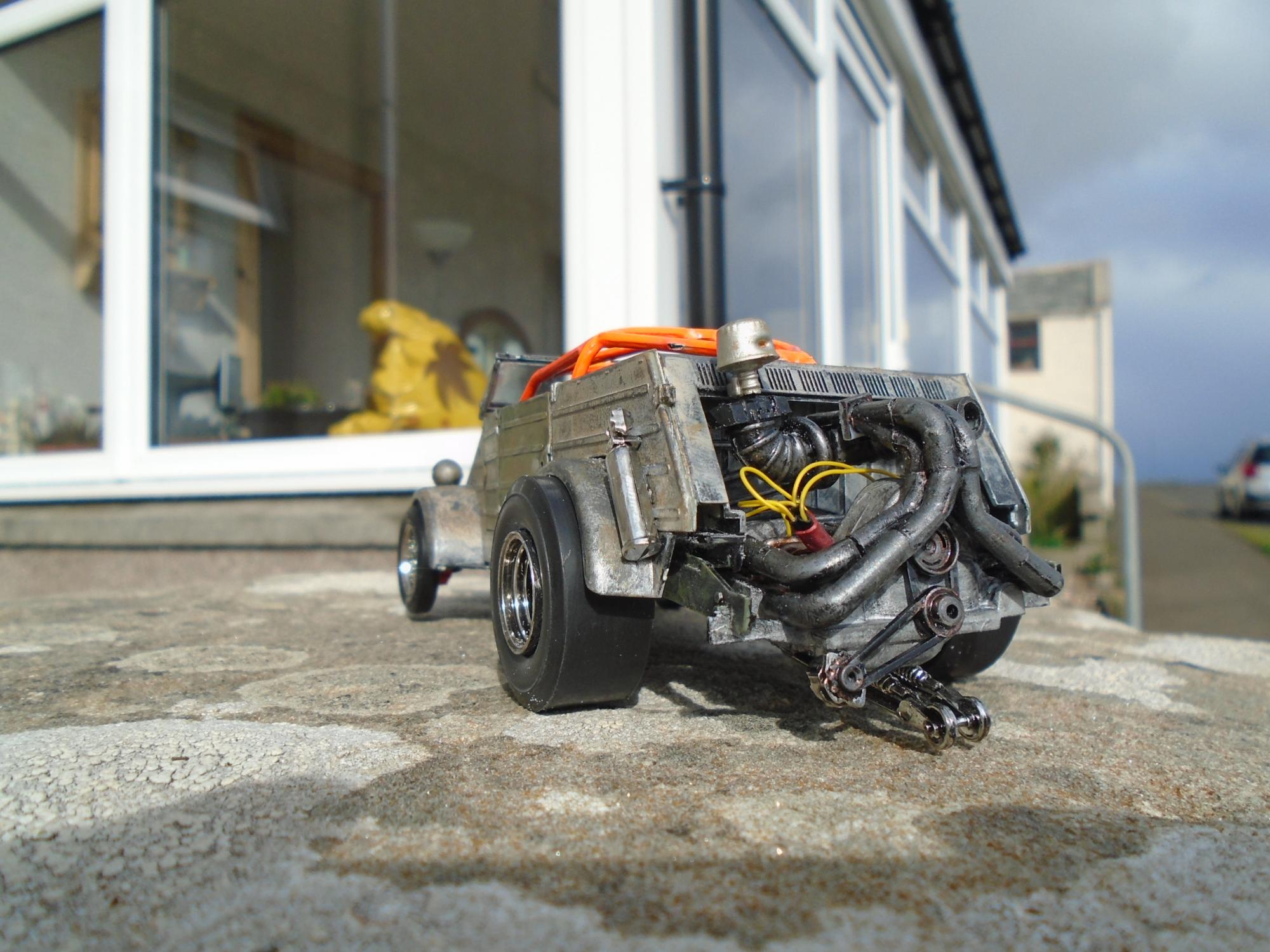

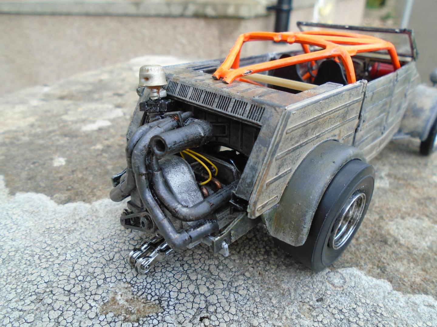

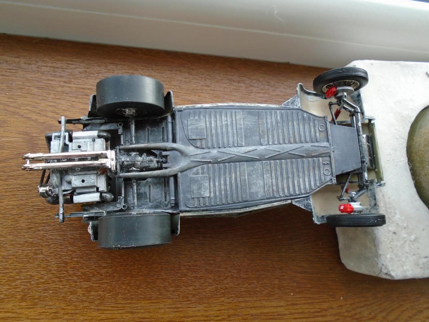

stitchdup Posted March 24, 2016 Posted March 24, 2016 (edited) Here's a little bit of a different build of mine. I started with a hasegawa kubelwagen kit 1/24 scale, but since I'm not a military builder I went for a rough drag style and left the army stuff in the box. The engine block is from a revell t25 UN van kit but the rest is mostly scratch built from scraps and the part box. The cage is from a revell beretta pro street, as is most of the drag parts. I wanted it to look like the body had been pulled from storage in good condition, but left as it was put away. The whole thing was painted by multiple layers of dry brushing with various matt and metal paints over a satin black base. The only mod to the body is I leaned the windscreen back to line up with the cage which was done in flourescant orange to get just a little colour into it. I'll try to add pics again later as it isn't letting me just now for some reason. I'm only getting the spinning arrow when I try to add them, so here's a link for now. Edited March 24, 2016 by stitchdup finally got pics to work

Harry P. Posted March 25, 2016 Posted March 25, 2016 Cool! I like the concept, love the weathered look. Well done... A few observations, though. The thickness of the exhaust pipe is way out of scale, much too thick. You should have drilled it out to get the thickness closer to scale. The huge sink mark on the air cleaner should have been filled. Looks to me like the roll cage is much too low... only a headless person could drive the car! And finally, the front brake calipers are magically floating in space... they aren't connected to anything! Same with the "magic floating" alternator. I only point out these things because it looks to me like you have quite a bit of talent... you just need to pay closer attention to the details, and your models will be that much better.

da Speedinger Posted June 1, 2016 Posted June 1, 2016 a Kübelrod - a genius idea.i think you should re-do the rollcage and the exhaust - can be done on the finished model and will improve the result a lot!
GTJUNIOR Posted June 2, 2016 Posted June 2, 2016 a Kübelrod - a genius idea.i think you should re-do the rollcage and the exhaust - can be done on the finished model and will improve the result a lot!I agree. Very cool concept, just needs a little refinement.
