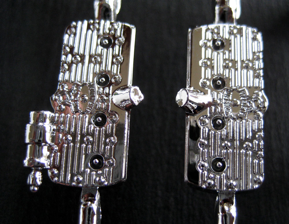

Casey Posted March 13, 2018 Posted March 13, 2018 On 3/27/2016 at 3:52 PM, Ace-Garageguy said: The Revell '48 Ford convertible also has the stock engine plus period speed parts (finned heads, etc.) and can be found quite cheaply too. Just a note regarding the cylinder heads in the Revell '48 Ford Convertible kit. While they are aftermarket performance parts, the cylinder heads are Motor City Flathead branded parts, so technically not '50s or '60s era vintage hot rod parts. They do look the part, though, and most people's eyesight is probably not good enough to make out the MCF logo cast into the head, but for the sake of accuracy, they are not true period speed parts...unless the early '90s is the period your looking to replicate. These are from the Revell-Monogram Pro Modeler kit, but as Bill mentioned, the more recent reissues of the Revell '48 Ford Convertible still contain these parts, but Revell's '48 Ford Custom Coupe and '48 Ford Police Coupe 2'n1 kits do not: The Revell '48 Ford Custom Coupe 3'n1 does contain some nice Navarro period speed parts, pic of which can be viewed via link here: The Revell '48 Ford Police Coupe 2'n1 kit contains only the stock engine option, and zero aftermarket/speed parts.
Ace-Garageguy Posted March 13, 2018 Posted March 13, 2018 (edited) 8 minutes ago, Casey said: Just a note regarding the cylinder heads in the Revell '48 Ford Convertible kit. While they are aftermarket performance parts, the cylinder heads are Motor City Flathead branded parts, so technically not '50s or '60s era vintage hot rod parts. They do look the part, though, and most people's eyesight is probably not good enough to make out the MCF logo cast into the head, but for the sake of accuracy, they are not true period speed parts...unless the early '90s is the period your looking to replicate... MY MISTAKE, and good to know. I never actually LOOKED at the engraving on the heads...just ASSUMED they were oldies. A lesson in why assuming and posting WRONG info isn't the wise move. I should know better. Edited March 13, 2018 by Ace-Garageguy
