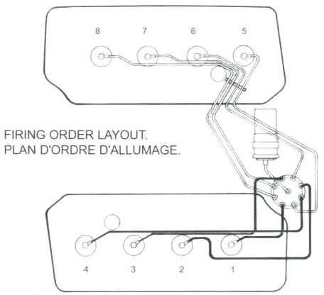

what i ment was how tthey physically run from the distributor to the plugs. This Is the 1st himi I've ever done. Thank you for your reply..i guess i can take a look at another himi in the forum.. I'm not too bad at building ,, I don't have a whole lot of experience on wired distributors though..
FYI, the above pic is not correct.
#1 cylinder is drivers side front, not pass side on ALL mopar V8 engines . All even # cylinders are on the pass side . and all odd # cylinders are on the drivers side ( #1, 3, 5, 7 are drivers side + #2,4,6,8 are pass side )
These might help .
And yes the Hemi is 18436572,,Actually all Mopar V8s are the same
These might help .
http://www.bing.com/images/search?q=426+hemi&id=C7D9E05474EF4C233CC23F201355B8139856C058&FORM=IQFRBA
Thats a google image i downloaded just to help the guy out.... I didnt take the time to confirm anything much less study the pic to see which sides were bank 1 or bank 2... It was rhe clearest image possible for me to download onto my phone at the time. And FYI ALL V8 domestic engines are 18436572 until the mid eighties or so when ignition systems became more dependent on computer control than actual mechanical ignition timing, and ALL right banks are bank 1 with cylinder 1 being the first cylinder on that side... Just trying to help the guy out bro... :)
All Mopar big blocks ( includes Hemi )  Distributor is in the front and wired up counter clockwise on all B / RB Mopar engines.
http://i.fixya.net/uploads/images/d59cc15.jpg
Actually i think you better look again.... The actual firing order as numbered is wrong BUT the wires from the distributor go to the correct places. Its just numbered wrong. Which wouldnt mean anything in 1:25 or 1:1. #5 is actually #1 and goes to #1 on the distributor. Following the firing order, not the numbers, you will see that the pic i posted IS correct :)
