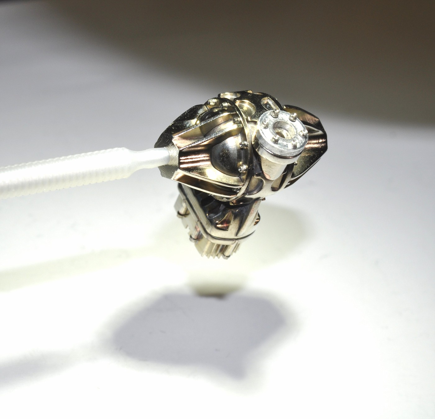

Codi Posted June 3, 2016 Author Posted June 3, 2016 I was on a roll with the plating. As Chris has discovered, it can be "hit or miss" with the Caswell system. The more experience I get at it, the more frequently I get it right.....shocking, right? Anyways, I plated the rear today but first I used their "acid copper" before putting on the nickel. It plated VERY quickly. When applying the nickel, or any of the solutions I believe, you have to very aware of certain parameters or you start to get "shmutz" on the finish. It doesn't polish out from my experience. So when doing this, less is more and it's better to err on the side of just enough, than my typical attitude of "if a little is good, a lots gotta be better". I'll add the bolts to it and the pinion collar. I'm just glad the plating went well because having to remove it and starting over isn't fun. cheers

gasser59 Posted June 3, 2016 Posted June 3, 2016 Exceptional piece of plating Tim, very impressive. Looks like in order to get results anywhere close to this, I'll need more experimentation with the Caswell system.Can you hook up a GoPro on your shoulder and relay the imagery right to my computer?

Mooneyzs Posted June 4, 2016 Posted June 4, 2016 Tim.... WOW.... I am so impressed by this rear end and at how great the plating turned out on it. Man does it look every so nice . I think I am going to have to break out my Caswell plating kit and play with it some. Just hope I can get some results as good as you, since my first attempts were not very productive....lol. This model is sure going to be a beauty. I look forward to the next part of this build.

Mooneyzs Posted June 5, 2016 Posted June 5, 2016 Tim... Fantastic work!! That looks top notch. I love the contrast between the plated assembly and the Aluminum ring where the drive line coupling will be. That looks great. Now this is only a suggestion I am wondering if you were to take a black wash just to the areas of the bolts to give a slight contrast and make the bolts pop even more. Hopefully you understand where I am coming from. It would just be at the head of the bolt and the body using a really thin black wash to get it in the little crack between the bolt head and the body of the part.
