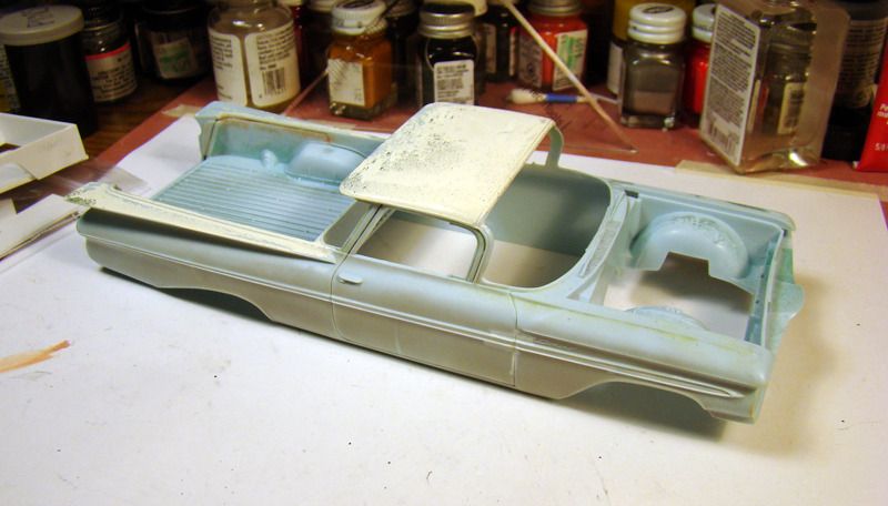

Lunajammer Posted April 11, 2016 Posted April 11, 2016 (edited) In the discussion about removing chrome plating, general paint removal is touched on in places. I followed some of the suggestions when attempting to remove paint from the '59 El Camino. The body, painted by a friend around 1990, had test shots of automotive primer on part of it, dark green lacquer on the left side, light green engine enamel on the right and white on the roof and fins, which I think is lacquer. This photo shows how it looks after it had already sat in Purple Power (the purple pond) for two days. Most of the engine enamel was lifted but barely any lacquer. Admittedly, my Purple Power is a couple years old and I know it weakens over time. Also mentioned on the plating thread was the product Totally Awesome, which I picked up at the dollar store. The body was immersed at 9:30pm At 4pm the following day I took it out and scrubbed with a firm toothbrush. A little more enamel was removed but otherwise disappointing results. I put it back in the bath. 24-hours later I removed and gave it another good scrub, including with fingernails. There was no substantial difference so I didn't take pics. Then I tried Toner283's recommendation of spraying with Easy Off and inserted into a plastic bag (and another squirt into the bag). It sat for 20-minutes, then scrubbed. More paint came off, but as you can see, what appears to be remaining is the lacquer that is mostly etched into the plastic itself. My last effort was to use STP DOT3 brake fluid. It sat immersed for about 36 hours. At one point, a hint of green paint was bleeding off the model. I don't know what the white paint is but it's bulletproof and nothing phases it much. I would say I had the most success with brake fluid but it comes at a small price... The surface of the plastic gets dried out and fine parts can get brittle. At this point I don't care to subject the model to any more abuse as the surface is getting rough and dry. I think the only the white areas remain stubborn and I'll sand those. Overall: I was disappointed with the efforts to remove lacquer and automotive primer, and you'll need more than a stiff toothbrush to scrape and scrub. But the enamel was gone early in the process so I have no doubts that the many testimonies endorsing various products on enamel are truthful. Edited April 11, 2016 by Lunajammer
935k3 Posted April 11, 2016 Posted April 11, 2016 simpleLacquer- 91% AlcoholEnamel and primer - Purple Power. LA Awesome, Easy Off (yellow can)

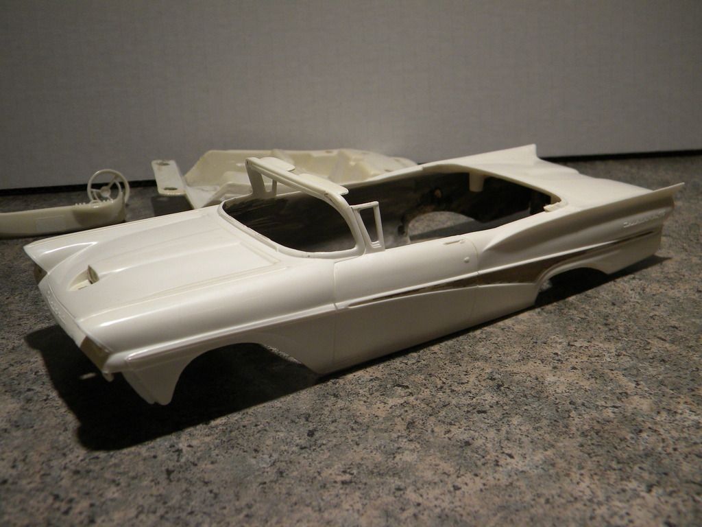

StevenGuthmiller Posted April 11, 2016 Posted April 11, 2016 A mixture of paints like this can be very confusing.You never know what was used & some of these old paints can be God knows what!You have to be really patient sometimes depending on the paint techniques & paint used.Get some fresh purple stuff & try some "Super Clean" this time if you can find it.My local auto parts store carries all of these cleaning products.Put it back in the soup & leave it alone for a few weeks.I have a '64 Pontiac Grand Prix that's been soaking for well over a month & it's coming clean, but slowly.The previous painter used lacquer paint without adequate primer & the paint etched the plastic making it very difficult to strip clean.I suspect you may be having the same issue with some of yours.Luckily, you're dealing with an easy to find kit.You may be better off not wasting your time & just get a new one.I've got a brand new '59 Elky body that I could send your way if you need it. Steve

Lunajammer Posted April 11, 2016 Author Posted April 11, 2016 You may be better off not wasting your time & just get a new one.I've got a brand new '59 Elky body that I could send your way if you need it. SteveActually, I do have an unbuilt kit. This was going to be for a project where I only needed the body and I had this spare. Once I started using strippers I just decided to share my experiences with pics.There are a lot of threads and even more opinions about what works better than what, but very few pictures to help visualize, or even validate those opinions. This is just a glimpse at what I did and what the results were. I'd love to see before and after photos and documentation of more stripping products. Especially as they apply to specific paints and under what conditions.
StevenGuthmiller Posted April 12, 2016 Posted April 12, 2016 Actually, I do have an unbuilt kit. This was going to be for a project where I only needed the body and I had this spare. Once I started using strippers I just decided to share my experiences with pics. There are a lot of threads and even more opinions about what works better than what, but very few pictures to help visualize, or even validate those opinions. This is just a glimpse at what I did and what the results were. I'd love to see before and after photos and documentation of more stripping products. Especially as they apply to specific paints and under what conditions. I hear you Mike. I could post a couple of pictures on how Super Clean works on enamels. I'm very careful when I buy built kits to try to do my best to only get ones that are painted with enamel paint. The photos you will see are all kits painted with enamel & soaked for a couple of hours in Super Clean. Lacquers are a different subject altogether. Super Clean is a "degreaser" and has little effect on the lacquer paint itself. It gets under the paint & degrades it's ability to adhere causing it to come off in sheets. I've had the paint on an entire hood or top come off in one sheet! A good thing to try when you're ready to strip a lacquer paint job is to scratch the paint up, all the way down to the primer before submerging. This will give the Super Clean places to get under the paint to begin the lifting process. Just as with anything else, this product is not fool proof. It was never designed to be a paint stripper & will not work on everything. I've had the most issues with some flat black paints & some primers. One of the nice things about it is that it's safe for pretty much all plastics & resins. You need to be careful with alcohol & brake fluid depending on what you're stripping. Another member just posted a thread about a destroyed resin body after attempting to strip it in alcohol. Any way, all of these were stripped in Super Clean in less than 4 hours. As a matter of fact, I just received a heavily painted body in the mail this afternoon @ 3:00. I dropped it in the purple stuff immediately, & by 5:30 this evening, when I returned home from work, it was 99% crystal clean. Dropped it back in & will let it finish getting out the few small bits left in some tight areas over night. By tomorrow it will look like a brand new kit. Steve As you can see on this '58 Ford, The Super Clean would not remove the gold paint in the side spear. I have no idea why.
Lunajammer Posted April 12, 2016 Author Posted April 12, 2016 That's amazing! Clearly, Super Clean on enamel is a confident way to go and the plastic underneath actually looks pristine. Thanks for the pics.

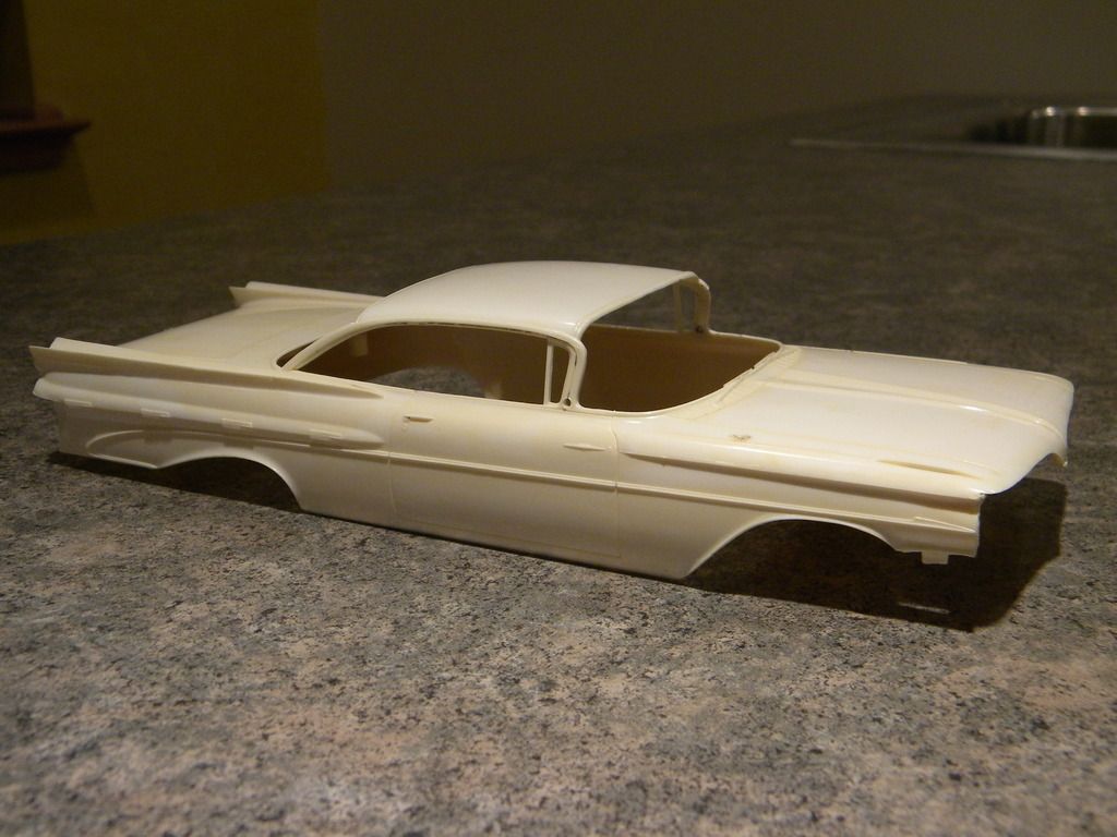

Zippi Posted July 17, 2021 Posted July 17, 2021 I have the lower hood section off my 1960 Chevy pickup soaking in 91% isopropyl alcohol and it's been in the drink for about 8 hours and nothing. I used a stiff tooth brush on it and nothing so far. I"ll leave it there to see if it may take longer.
peteski Posted July 18, 2021 Posted July 18, 2021 10 hours ago, Zippi said: I have the lower hood section off my 1960 Chevy pickup soaking in 91% isopropyl alcohol and it's been in the drink for about 8 hours and nothing. I used a stiff tooth brush on it and nothing so far. I"ll leave it there to see if it may take longer. What brand/type of paint did you use? Most 1-part lacquers can be removed with 91% IPA. Also, warming up the stripper will increase its potency. 80-90 deg. F that is. You being in Indiana, that is probably not a problem (hot summer). Also, 99% IPA is sold in hardware stores as a solvent in gallon cans (in the paint thinners section). It is usually called IPA99 or Isopropanol 99. If they don't have it, they should be able to order it for you. I get it at the local Ace Hardware. Not sure if large home improvement centers carry it.
Zippi Posted July 18, 2021 Posted July 18, 2021 3 hours ago, peteski said: What brand/type of paint did you use? Most 1-part lacquers can be removed with 91% IPA. Also, warming up the stripper will increase its potency. 80-90 deg. F that is. You being in Indiana, that is probably not a problem (hot summer). Also, 99% IPA is sold in hardware stores as a solvent in gallon cans (in the paint thinners section). It is usually called IPA99 or Isopropanol 99. If they don't have it, they should be able to order it for you. I get it at the local Ace Hardware. Not sure if large home improvement centers carry it. Thanks for the info Peter. The spray paint is Tamiya lacquer.
