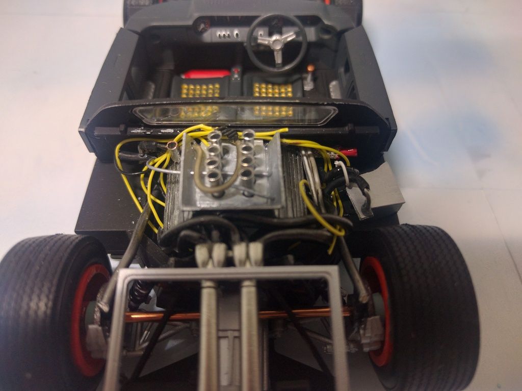

Could you share with us any engine detail pictures?
General, its a good kit, i had some problems with the fitting of the rear cowl to the front body parts(its came in 2 pcs) so i superglue it to the chassis, i also has ro cut the metal shaft of the rear wheels because its has too long and the wheels hit the body.

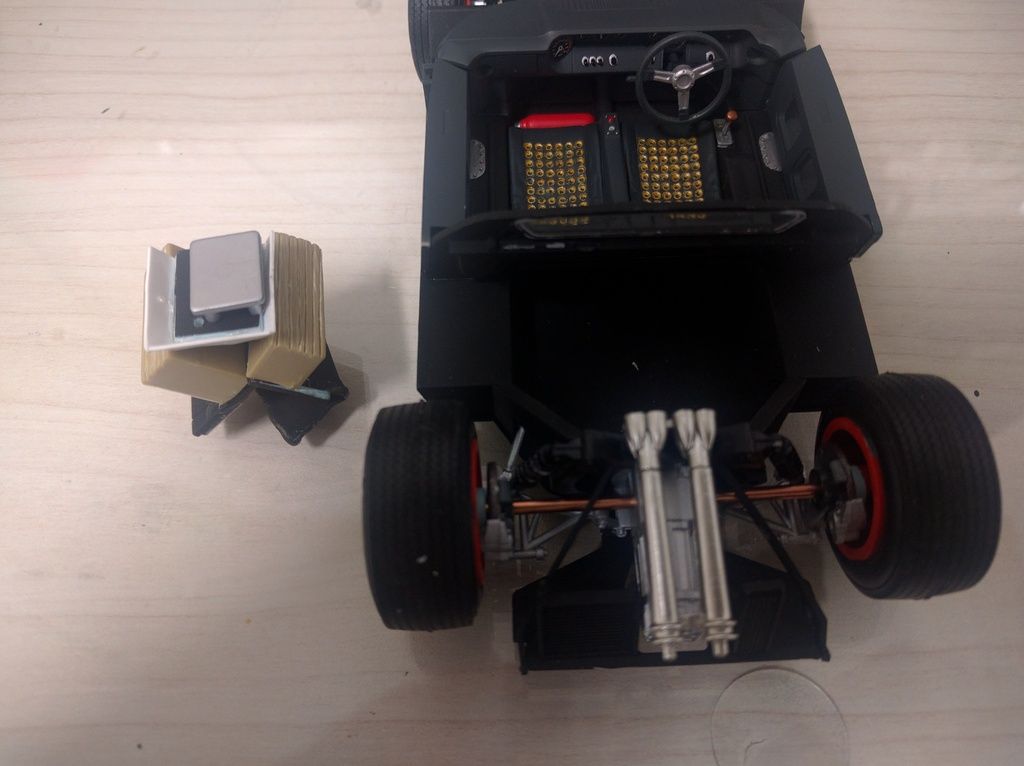

About the engine, this is how its look like in the original kit: (You also can see the metal shaft that I had to cut)
This is what i did:
This is what i did:
Great job with the engine man!
