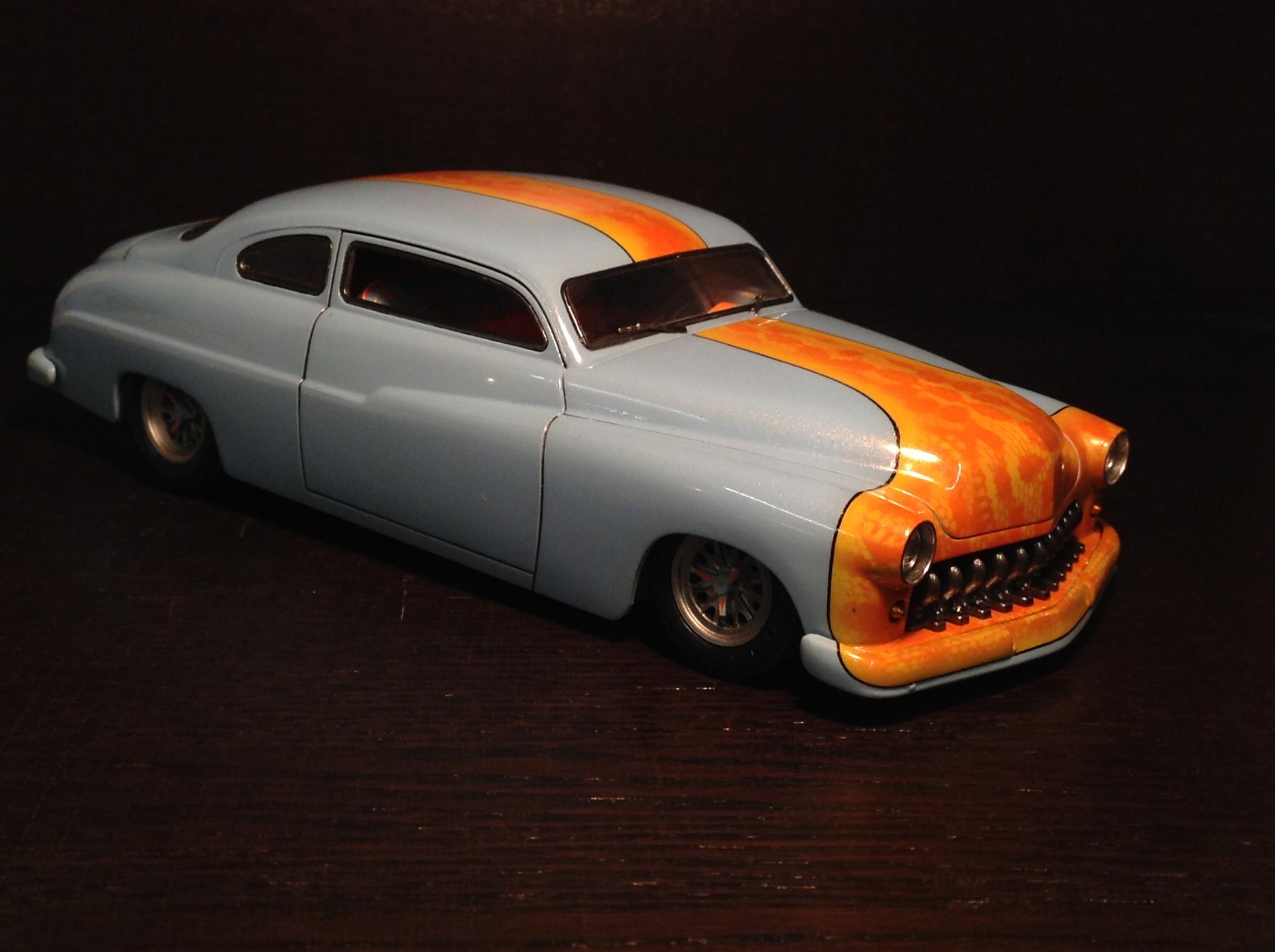

Rider Posted April 15, 2016 Posted April 15, 2016 Looking for actual experience advise. I am not new to crisp bleed free tape lines. I am how ever very very new to using the new to me narrow .4mm masking tape and pin stripping a multi lay/colour paint job. Heres's my question. When doing a multi layer/colour job where the pinstripe mask will be down for most of the coats how do you stop the edge from building up so much that when it is wet sanded the edges break and you loose that crisp line. This is my first crack at a multi colour/layer paint job and as you can see the black pin strip is not all that crisp. I understand these pics bring out the flaws but I did that so I can show what I am asking about. My limited experience says I should be wet sanding between every coat, and the coats need to be very light, am I correct? If so what grit should I use? I really want to learn how to do this correctly. Thanks for the help.

astroracer Posted April 15, 2016 Posted April 15, 2016 What I see in your close up pic is the edges of color are breaking down into your pinstripe. Leaving the tape on to long is the problem. Remove the pinstriping tape after you get the first color down then back mask over the stripe AND the first color.This will eliminate the buildup of paint and also allow you to remove the tape in a timely manner so you don't get sharp edges from the covering colors drying to long.Also, wet sanding between coats with 600 or 800 grit will knock the edges down to eliminate the build up. And, like you said light coat,s with just enough paint to cover, will keep build up to a minimum.Mark
Rider Posted April 15, 2016 Author Posted April 15, 2016 Thanks Mark for taking the time to read and respond to my question.The breakage you see is not from pulling up the tape, it started breaking off as I was wet sanding. I will try your suggestion.

Mike Chernecki Posted April 16, 2016 Posted April 16, 2016 Something I tried that worked well. Lightly airbrush your pinstripe color first, spraying only where your stripe will be. Then layout your pinstripe tape. Fog your tape with clear to seal the edge. Then mask one side of the pinstripe and spray lets say your blue. Then pull the masking tape off leaving your pinstripe tape intact. Then mask off the blue and spray the orange. In the end your pinstripe tape has only ever had one color sprayed against each side. Each time mask to the center of the pinstripe tape. If you are brave and have a steady hand, you can put masking paper over the pinstripe tape and cut directly on it to simplify masking.
