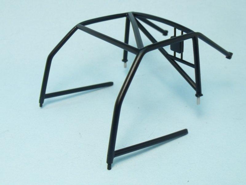

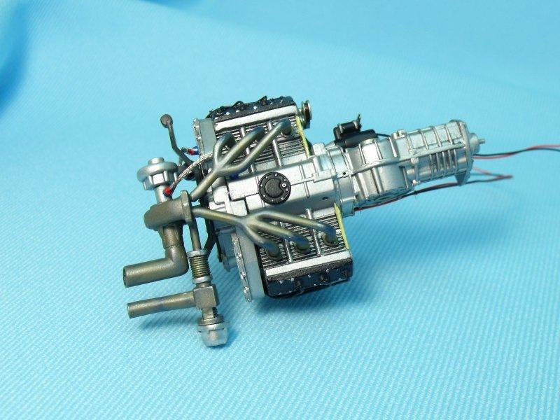

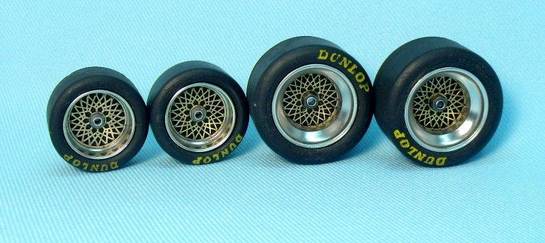

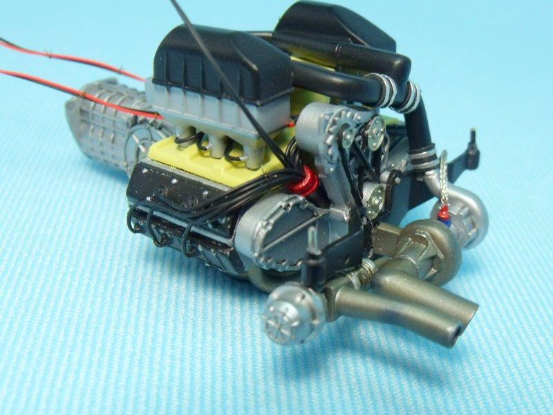

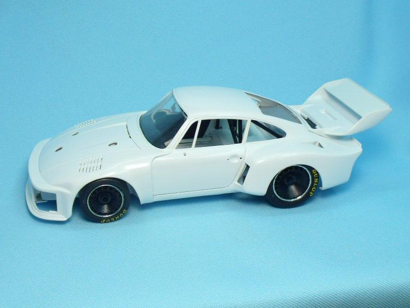

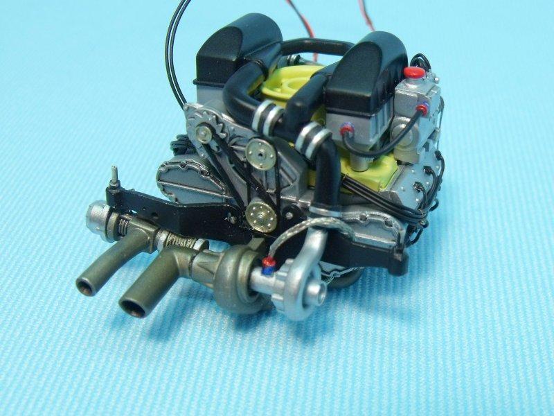

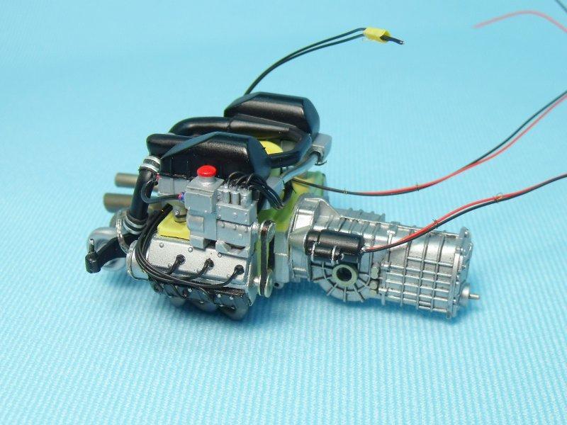

935k3 Posted April 26, 2016 Posted April 26, 2016 (edited) I had to start a new thread for this wip because I can't find the original. This the 1/20 scale Porsche Martini 935. I still have some touch up etc. on the engine. The front half of the roll cage is scratchbuilt and a few other things including the foot rest in front of the pedals and the puke tank on the rear shelf. . The wheels were de-chromed and painted with Alclad Pale Gold and Spaztix Chrome. The distributor is scratched and has 14 wires going in thanks to the dual ignition for the flat six. The tires are from an old build, they will be cleaned up and the lettering redone. Edited May 23, 2016 by 935k3

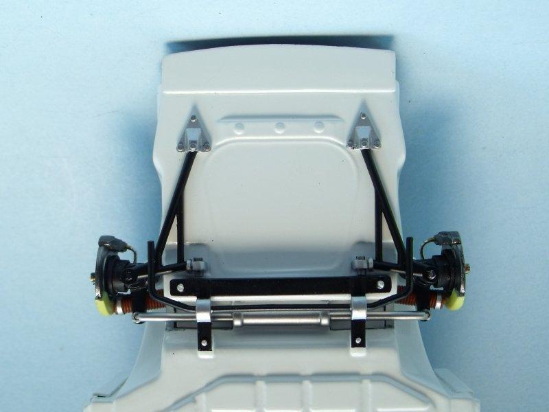

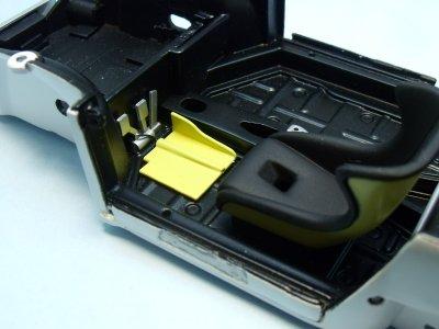

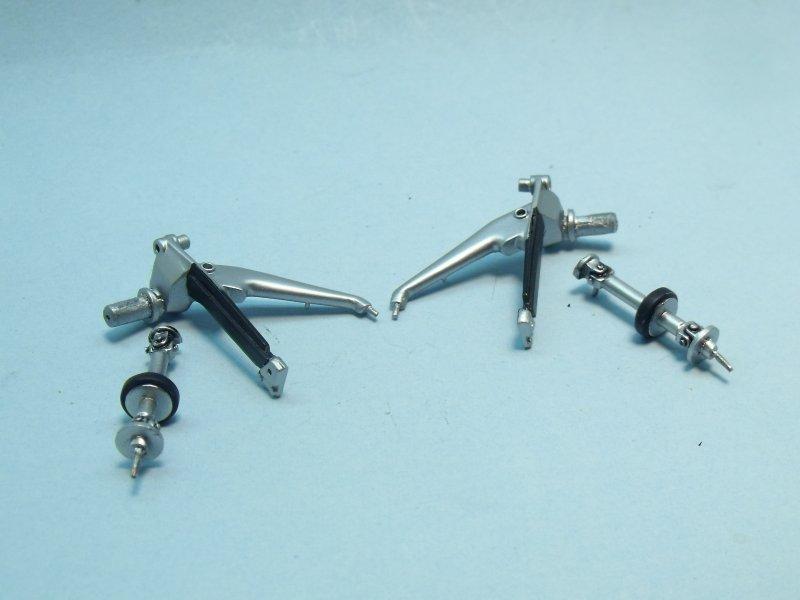

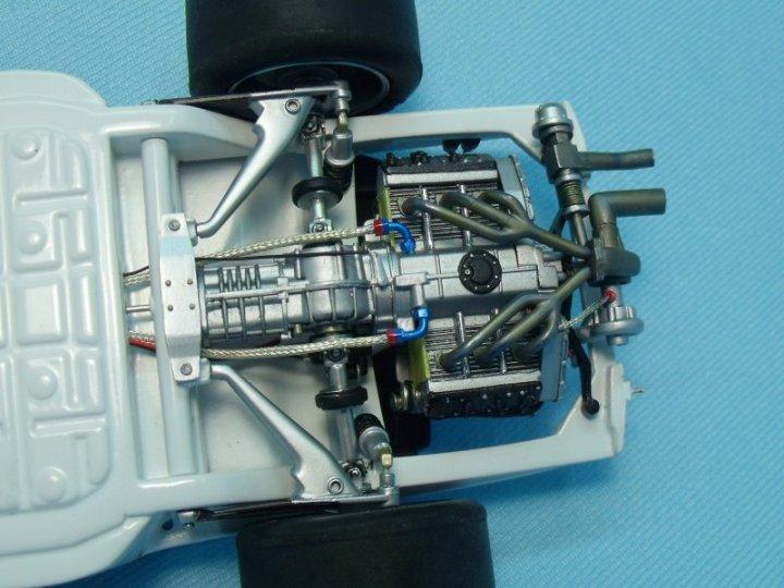

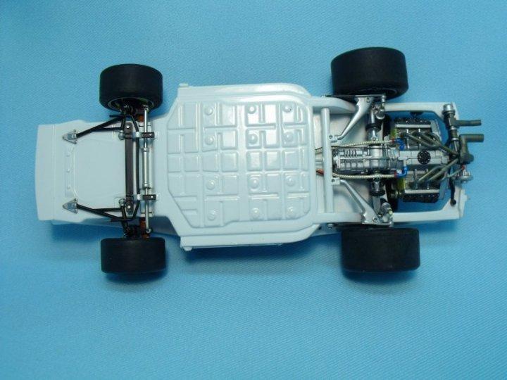

935k3 Posted April 27, 2016 Author Posted April 27, 2016 (edited) Got the front suspension done. This area took allot of rework due to suspension parts and cutouts for a motorized version. There were no brakes, added parts box brakes and scratch built brake cooling duct and tubing to brake. Edited April 27, 2016 by 935k3
Dann Tier Posted April 27, 2016 Posted April 27, 2016 VERY NICE!! Q:How did you scratchbuild your air ducts?
935k3 Posted April 27, 2016 Author Posted April 27, 2016 (edited) VERY NICE!! Q:How did you scratchbuild your air ducts?The duct hose is sprue wrapped with .015" solder from Radioshack then painted brownish orange mix of Tamiya Acrylics. The ducts are shaped plastic glued to the brake disks. Edited April 27, 2016 by 935k3
Dann Tier Posted April 28, 2016 Posted April 28, 2016 The duct hose is sprue wrapped with .015" solder from Radioshack then painted brownish orange mix of Tamiya Acrylics. The ducts are shaped plastic glued to the brake disks.Very cool -Thnx!

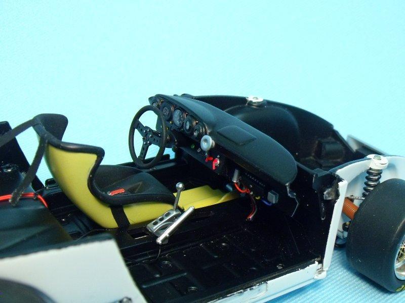

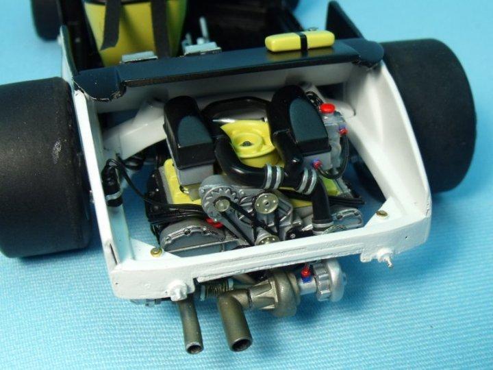

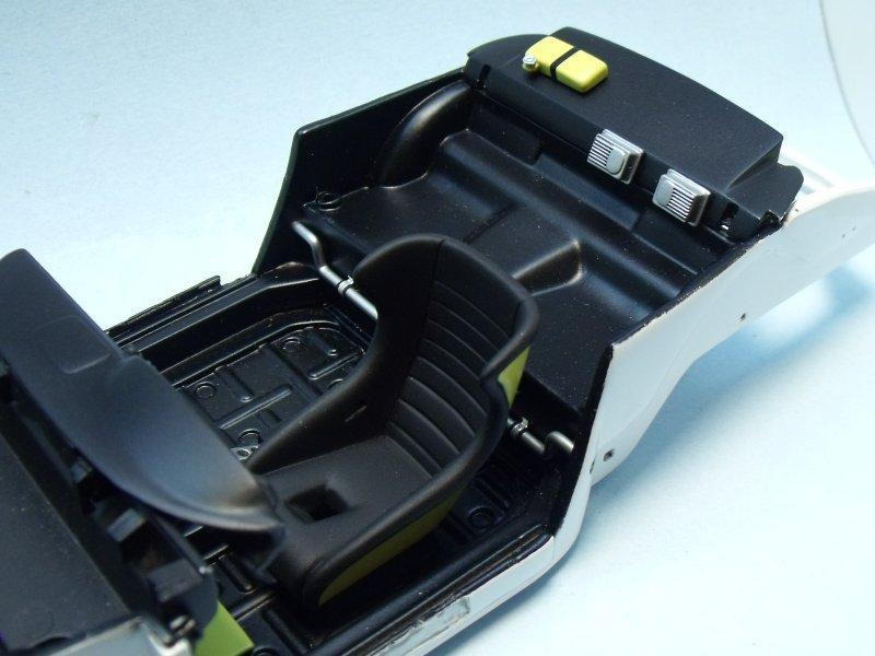

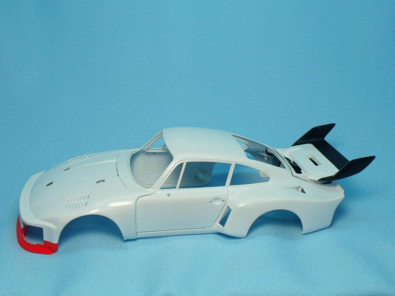

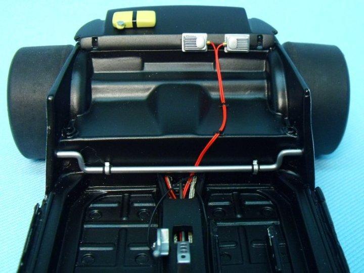

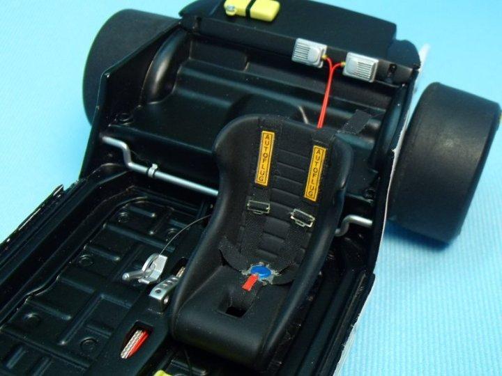

935k3 Posted May 8, 2016 Author Posted May 8, 2016 Engine in chassis and seat and interior work. Starting to work on dash. I can see by pics I need some touch up and dusting.

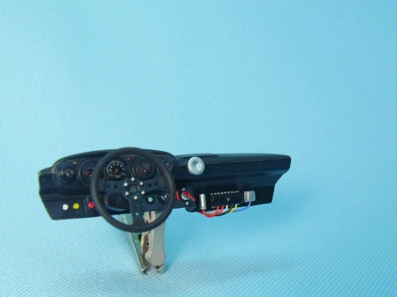

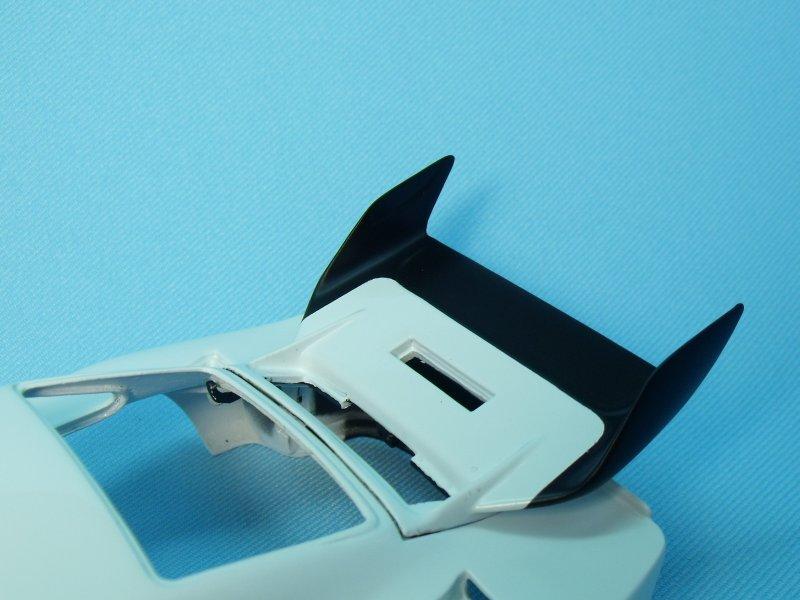

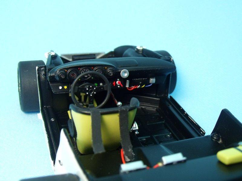

935k3 Posted May 23, 2016 Author Posted May 23, 2016 (edited) Dash and interior done except putting the roll cage in. Got the semi-gloss black on the wing. I had to make the gauge decals and put a clear disk over them. The electronics boxes on the lower right and the boost knob are made from scratch. Edited May 23, 2016 by 935k3
