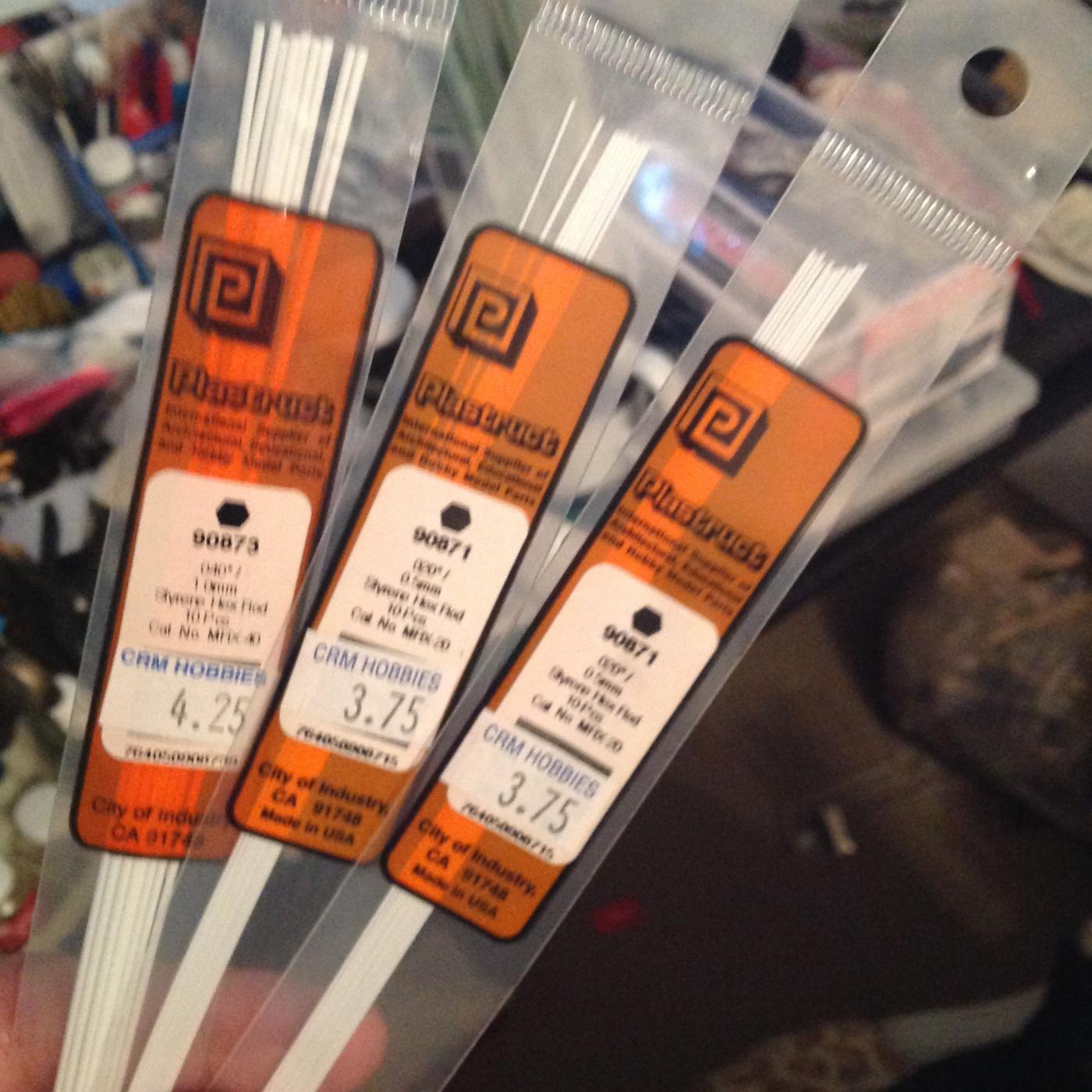

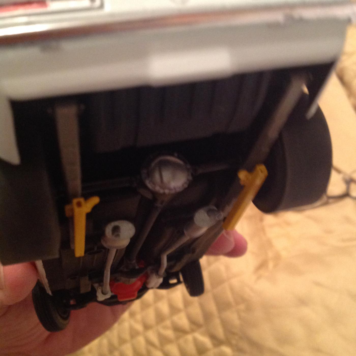

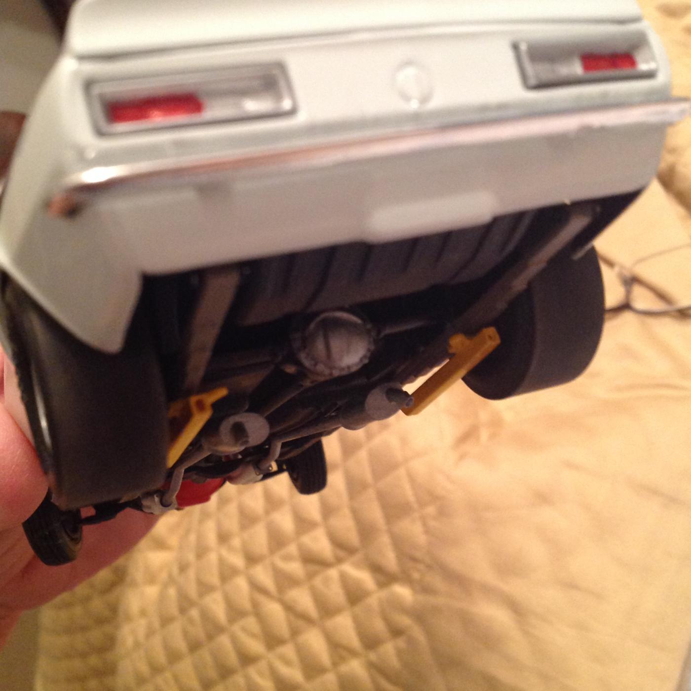

dragcarz Posted April 27, 2016 Posted April 27, 2016 Hey Chris, I ran into the same problem and ended up making my own. I was building the AMT 67 Camaro. I started with the kits rear axle. The factory covers have what I would call an eyebrow across the top portion of the cover. I've included a photo of a typical 12 bolt rear cover. I took a strip of plastic and glued it to the axle and filled and sanded it to the correct shape. At the time I just made bolt heads" 12 of them" and added them to the outer edge. There a little big here. I just tried to evenly space them apart according to the photo. I have since found Plastruct hex in really small sizes that I now use to recreate bolt heads. Hope this helps.
AC Norton Posted April 27, 2016 Posted April 27, 2016 Hey Chris, I ran into the same problem and ended up making my own. I was building the AMT 67 Camaro. I started with the kits rear axle. The factory covers have what I would call an eyebrow across the top portion of the cover. I've included a photo of a typical 12 bolt rear cover. I took a strip of plastic and glued it to the axle and filled and sanded it to the correct shape. At the time I just made bolt heads" 12 of them" and added them to the outer edge. There a little big here. I just tried to evenly space them apart according to the photo. I have since found Plastruct hex in really small sizes that I now use to recreate bolt heads. Hope this helps. .......very, very trick, Roger....you have more ambition than I have these days...lol.........great work and detail action there.......the Ace.....
Nova-ss Posted April 27, 2016 Author Posted April 27, 2016 Hey Chris, I ran into the same problem and ended up making my own. I was building the AMT 67 Camaro. I started with the kits rear axle. The factory covers have what I would call an eyebrow across the top portion of the cover. I've included a photo of a typical 12 bolt rear cover. I took a strip of plastic and glued it to the axle and filled and sanded it to the correct shape. At the time I just made bolt heads" 12 of them" and added them to the outer edge. There a little big here. I accurateried to evenly space them apart according to the photo. I have since found Plastruct hex in really small sizes that I now use to recreate bolt heads. Hope this helps. Ues...I like it!!!...I think I'm going to try that.I can make that.thank you for the idea a thoughts,parts.you did a great Idea.I'm building a rear axle for a 75 76 caprice.I took the rear axle out of a 72 nova kit..modded it to fit.but the rear axles which is suppose to look like a gm bolt... [ and does ok..I think]..but the rear cover is far from right.I also used the rear member only.the axle tubes are evergreen and kns tubing for the bushing.but like I said needed a better..more accurate rear axle cover...thank you....Chris

dragcarz Posted April 27, 2016 Posted April 27, 2016 Ues...I like it!!!...I think I'm going to try that.I can make that.thank you for the idea a thoughts,parts.you did a great Idea.I'm building a rear axle for a 75 76 caprice.I took the rear axle out of a 72 nova kit..modded it to fit.but the rear axles which is suppose to look like a gm bolt... [ and does ok..I think]..but the rear cover is far from right.I also used the rear member only.the axle tubes are evergreen and kns tubing for the bushing.but like I said needed a better..more accurate rear axle cover...thank you....Chrisglad I could help, post pics when you get it done!
louie Posted April 27, 2016 Posted April 27, 2016 Hey Chris, I ran into the same problem and ended up making my own. I was building the AMT 67 Camaro. I started with the kits rear axle. The factory covers have what I would call an eyebrow across the top portion of the cover. I've included a photo of a typical 12 bolt rear cover. I took a strip of plastic and glued it to the axle and filled and sanded it to the correct shape. At the time I just made bolt heads" 12 of them" and added them to the outer edge. There a little big here. I just tried to evenly space them apart according to the photo. I have since found Plastruct hex in really small sizes that I now use to recreate bolt heads. Hope this helps. that is great. I also want to say thank you for the great tip on the 12 bolt. Looks really good under that camaro. All good stuff on this thread. Thanks. Jeff

dragcarz Posted April 28, 2016 Posted April 28, 2016 I just realized I missed the drain plug......oh well?
