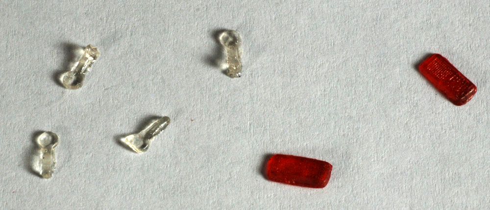

Foxer Posted April 28, 2016 Posted April 28, 2016 (edited) It sounds like you are asking about a lens cast into the body. I would just paint the lens with a regular silver paint, like Testors, as this is the easiest to do with a sharp edge and covers excellently. Then us a fine Sharpie in red and orange for the color. This is still an easy job as my hands get unsteadier. I have also cast the shape in Bondic, sometimes in a rubber mold off the body. This would let you sand off the body smooth. These are some side lights from a GMC van and some door winders in Bondic. Edited April 28, 2016 by Foxer
