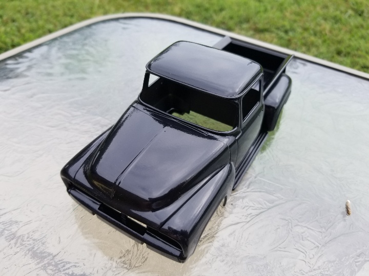

I wasn't going to post this but a good buddy of mine here on MCM said and I quote "looks darn good enough to me" so I thought what the heck.  I have been testing and struggling with paints, clear coats, airbrushing, rattle cans for a pretty long time and could not get a paint job that was to my liking.  I have a 56 Ford body I airbrushed with Testors paint and not sure what went wrong but I decided to sand it down and go back to basics with what I started with about 6 months ago.  Yup....craft paint.  I got a fairly decent paint job with my Paasche H was on a 56 Ford body but I didn't get enough clear on it to make it shine.  The black 56 body is my most recent and was painted with Delta Ceramcoat acrylic paint and clear coated with Rust-Oleum Clear lacquer.  I then wet sanded (very slow and a lot of sanding) and then polished it with Meguiar's Mirrow Glaze and Novus 2.  I believe for me this is about as good as it's going to get so this is my Fave paint job.

Yep "looks good enough to me"??     Really tho, it looks great my Friend?
Thanks buddy.

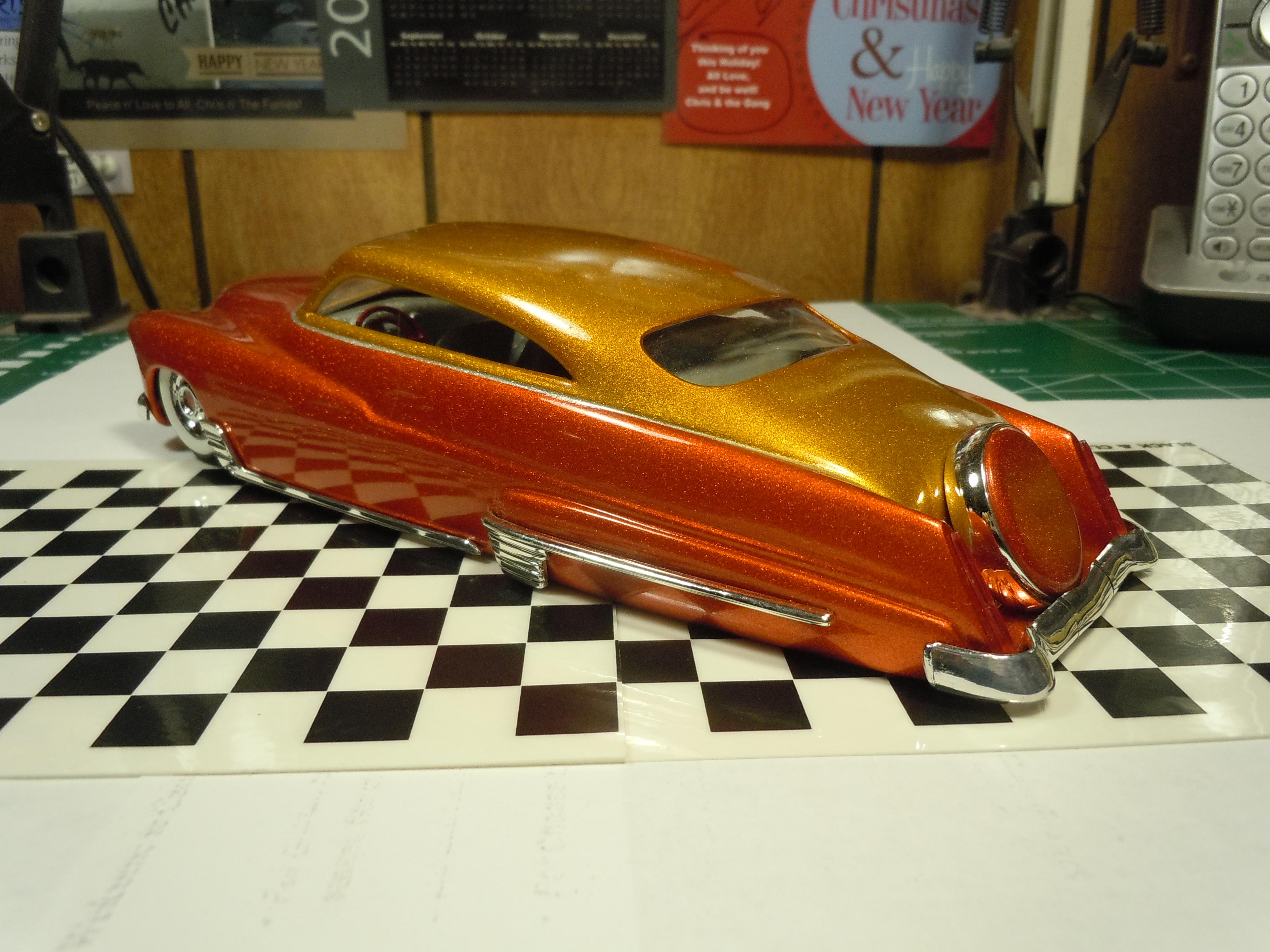

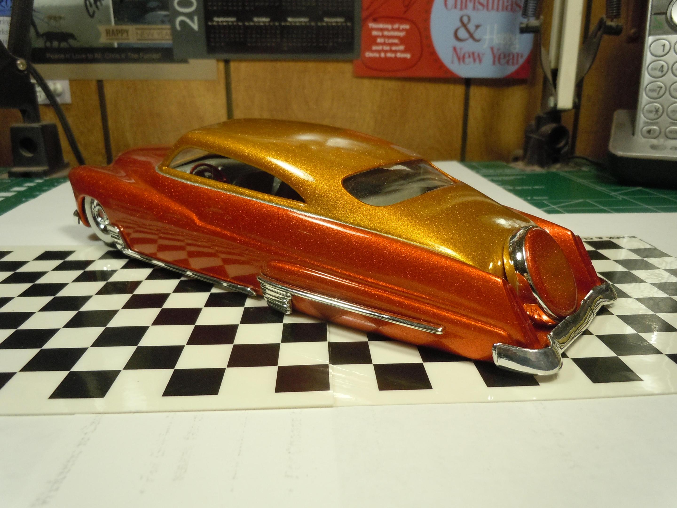

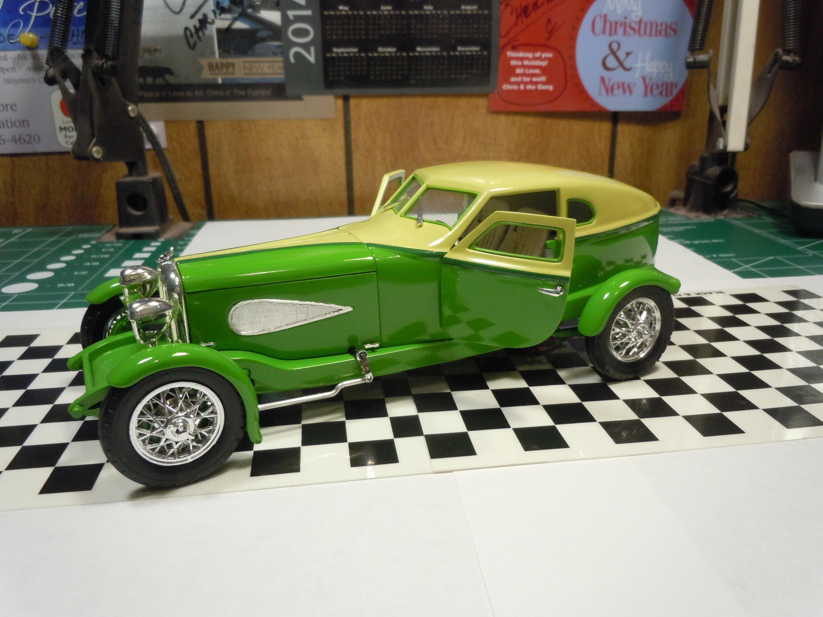

Hey TJ @JollySipper
Thank you much.
This ol' girl was built long ago. All plastic, and body filler, and no resin. No Jimmy Flintstone back when I built this.
This was my first House of Color metal flake and candy paint job in auto urethanes.
This was just a styling study, and has no body lines, like door lines and so on.
Glad you like 'er.
Dave
Edited by carbuilder1950
Man oh man Dave.  Those pics looks bodacious.  One H*ll of a paint job on those cars dude.
  • Like 1
Well Bob, @Zippi my friend, I sure do appreciate your kind words.
One at a time, down the road, I will post these ol' girls, if nobody minds.
They were all a lot of fun to build, and I even managed to collect a few awards. Model clubing was a lot of fun back in the day.
All the best  - Dave

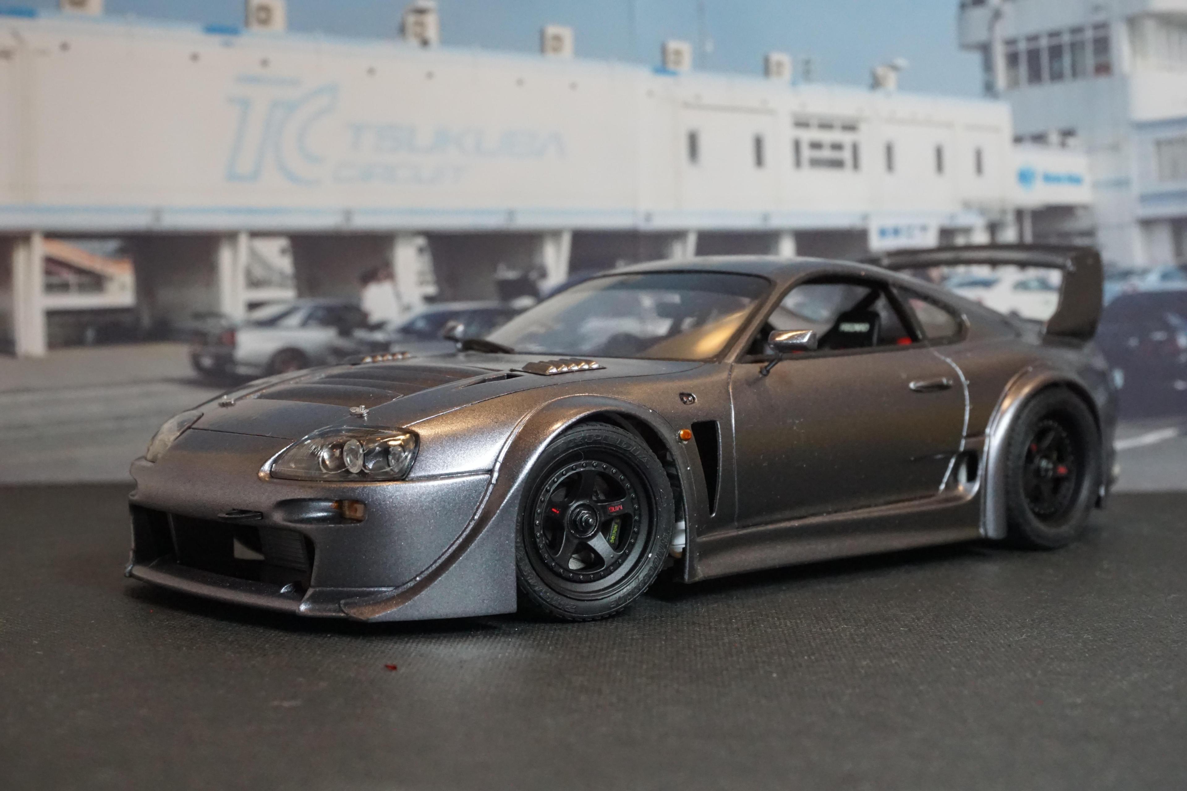

Thought i post my best paint job to date, only my third since starting over.
Decanted Tamiya TS38 Gunmetal shot with my H&S Evolution, no clear because race car CBR Ruse.
  • Like 1
Excellent job!
I'd keep that in a nice display case. Without clear its as risk for scratches and chipping.
12 hours ago, DiscoRover007 said:
Excellent job!
Thanks for the warning! I will keep that in mind!

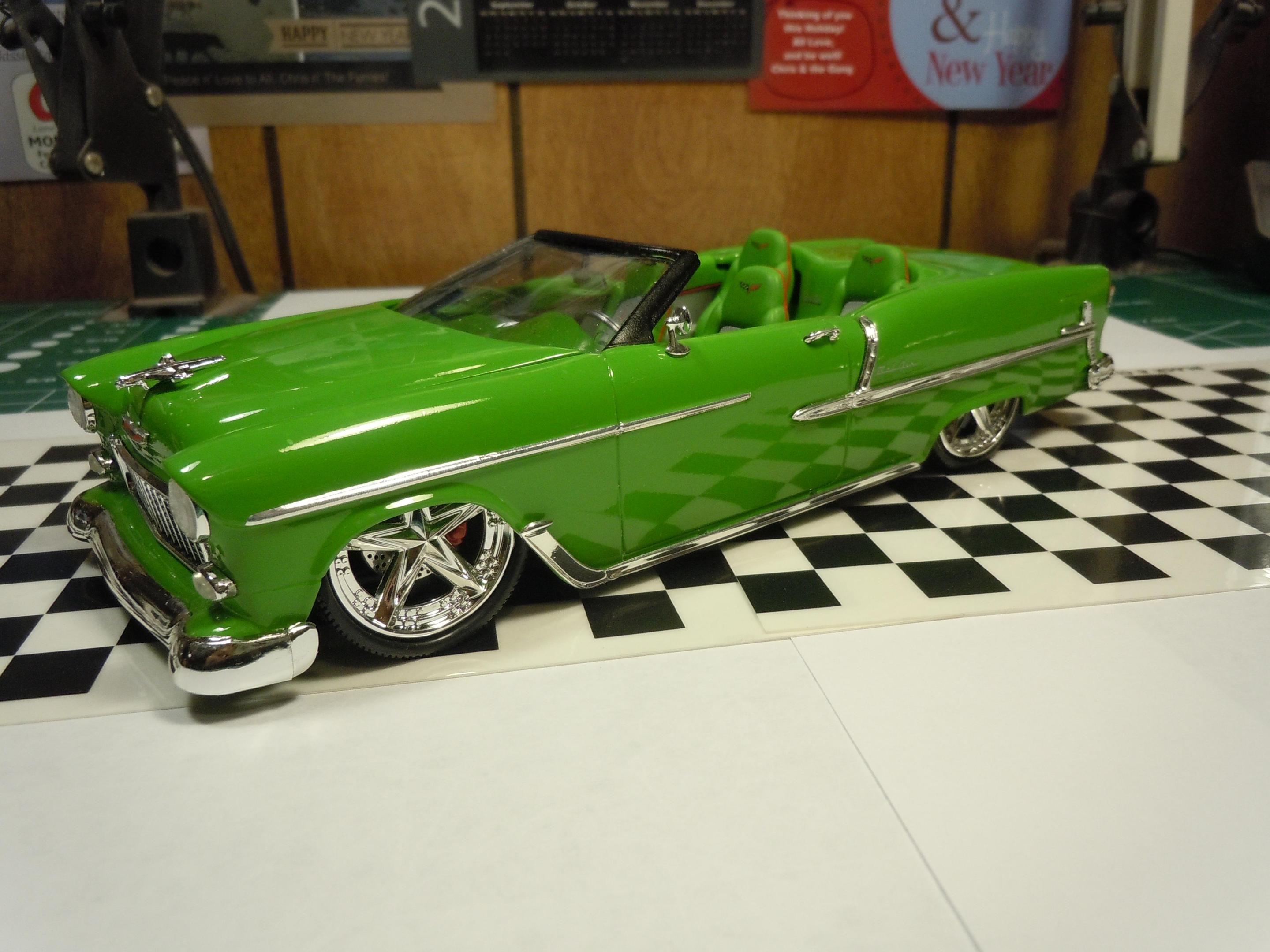

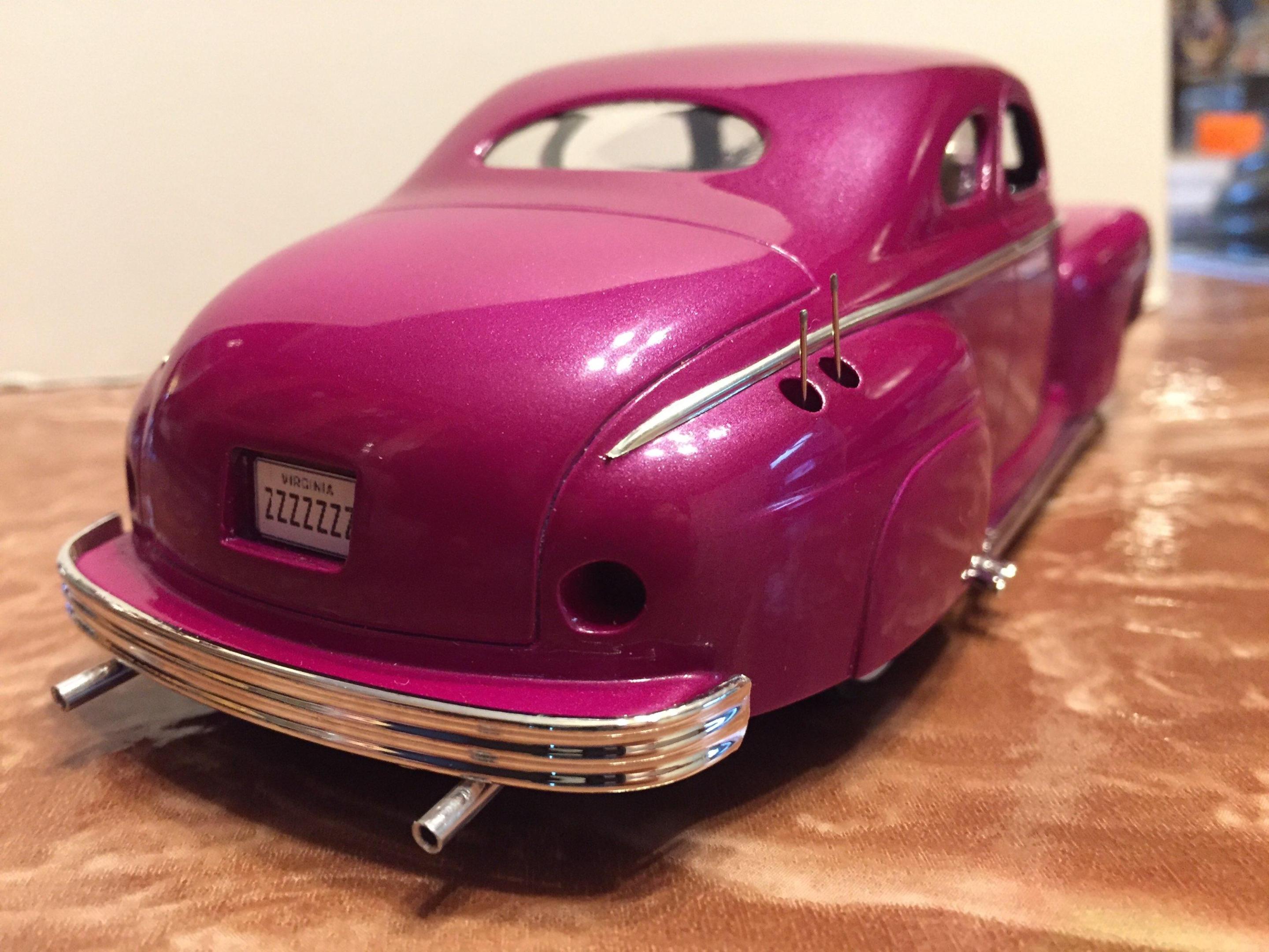

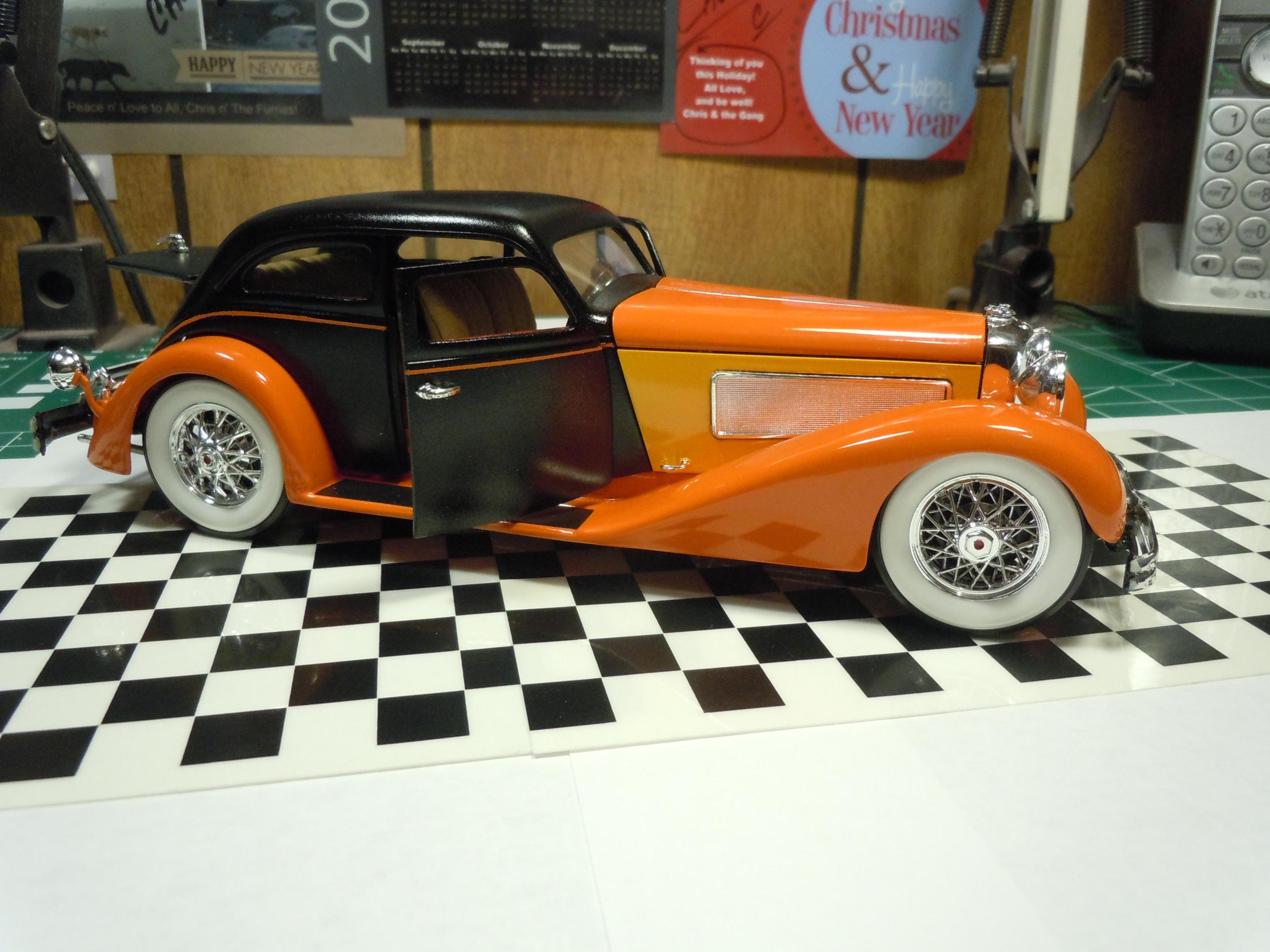

Most of my paint jobs are flawed somehow, even though the overall finish is good. I don't use clear gloss very often because it's an unnecessary step since I want a more "in scale " look. I would micro-polish it anyway, to flatten out the orange-peel. I have not taken many staged shots; they are all indoor, sometimes before completion and until I do a real photo shoot of everything I've done, this suffices for now.  The best I can find are here. Thanks for looking.IMG_0603.jpg.06867176eb67d4f9cd4946d7c3d55057.jpgIMG_0671.thumb.jpg.cf7ffa2ce9d230753288941125024912.jpgIMG_1154.jpg.9a76220f7011dbac6cf62b75dbb18427.jpgIMG_1155.jpg.75634d616b8af8bd3f65f5a7520aa680.jpgIMG_0205.jpg.42486acba020432e536c43093177c40c.jpgIMG_0231.thumb.jpg.c7167c531a605b229f86b7cb3ab163f3.jpgIMG_0470.thumb.jpg.26719566cd429e9e00f2f816c27abf31.jpg

Those are nice paint jobs Jim....you didn't mention what the paint is.

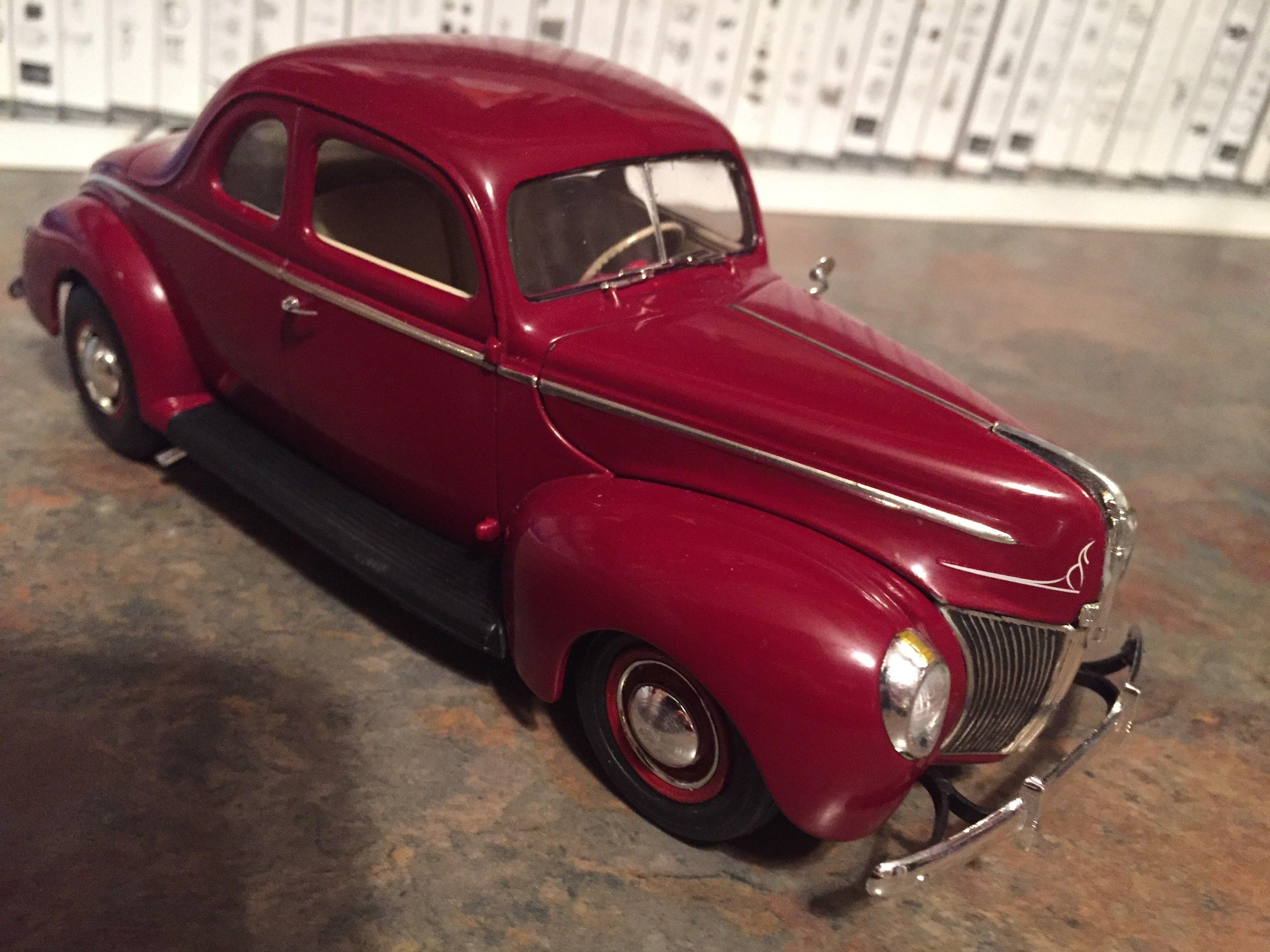

I wish I could remember ?.  Hmmmm.....the Cameo is Testors (1/4 oz bottle) green metalflake, '48 zzzzzzz is Boyd's (model master) purple pearl (?), the sectioned ford is Testors extreme lacquer purple metal flake rattle can, the '34 is also rattle can extreme lacquer( gold metal flake, I think), High & Mighty is Ace hardware Premium rattle can ( I highly recommend this paint), the Olds is Krylon ivory (probably), and I think the '40 is Krylon burgundy. I really like Testors bottle paint thinned with cheap lacquer thinner for air brush and micro polish on everything after it's cured. No clear for me, thank you. Not if I don't  need to.
Below is Testors Arctic Blue on the Chevy and good ol' sub-lime green from the spray can on the GTX. I think the deuce coupe is Dupli-Color with clear (maybe Krylon)over it. The altered '34 is Testors 1/4 oz, purple of some description . The pickup is Krylon metallic gold, as is from the can. Not a great finish but a kinda weird color, yes? When I started spraying I was expecting something completely different ?. IMG_1550.jpg.c8dfec6bc05548a76b642ddc5f449339.jpgIMG_0380.jpg.29354a27733cf11039594f4c2a284b34.jpgIMG_1557.jpg.d07a96807e8eab2e1a0938d9ebd233b9.jpgIMG_1559.jpg.24b338ec65ac864768ba35c3a675fd23.jpgIMG_2638.jpg.2495ca9e7a8745eb30c7c8dda50e48bb.jpg
