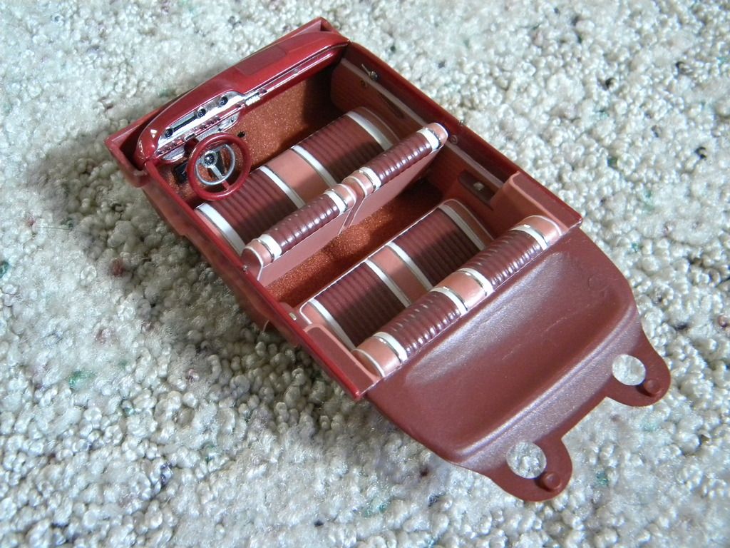

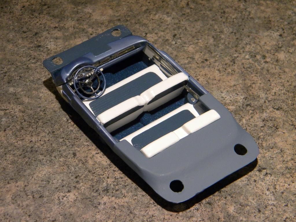

MrObsessive Posted May 14, 2016 Posted May 14, 2016 Embossing powder is all I use for carpeting anymore. Like others have said, to my eyes it's much more in scale appearing than flocking, especially for 1/24-1/25 scale. Flocking is OK for larger scales say 1/16 on up, but it still has that "fuzzy/hairy" look to me although not as much in those scales. Here are a few pics of embossing powder on recent models I did.............. '59 Chevy...... '67 Mustang........ IMO, I think the embossing powders give you a much wider scale of colors to choose from than flocking, and I've not found it to shed/flake much if at all once it's fully dry on your paint/white glue.

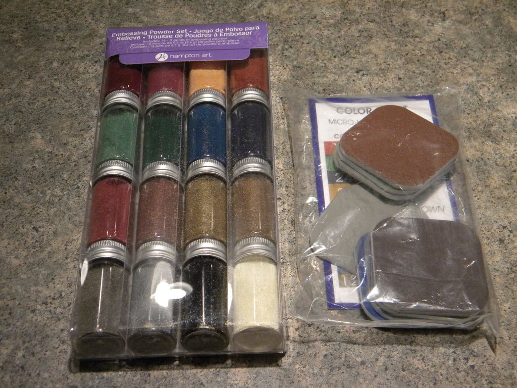

StevenGuthmiller Posted May 15, 2016 Posted May 15, 2016 Embossing powder is all I use for carpeting anymore. Like others have said, to my eyes it's much more in scale appearing than flocking, especially for 1/24-1/25 scale. Flocking is OK for larger scales say 1/16 on up, but it still has that "fuzzy/hairy" look to me although not as much in those scales. Here are a few pics of embossing powder on recent models I did.............. '59 Chevy...... '67 Mustang........ IMO, I think the embossing powders give you a much wider scale of colors to choose from than flocking, and I've not found it to shed/flake much if at all once it's fully dry on your paint/white glue. I agree! Great stuff & so easy to use. Looks absolutely realistic & you don't have to paint it. It comes in a wide variety of colors. I bought this set on ebay for $14.00. Comes in other colors too. These are the metallic colors. They look especially realistic to me. Steve
