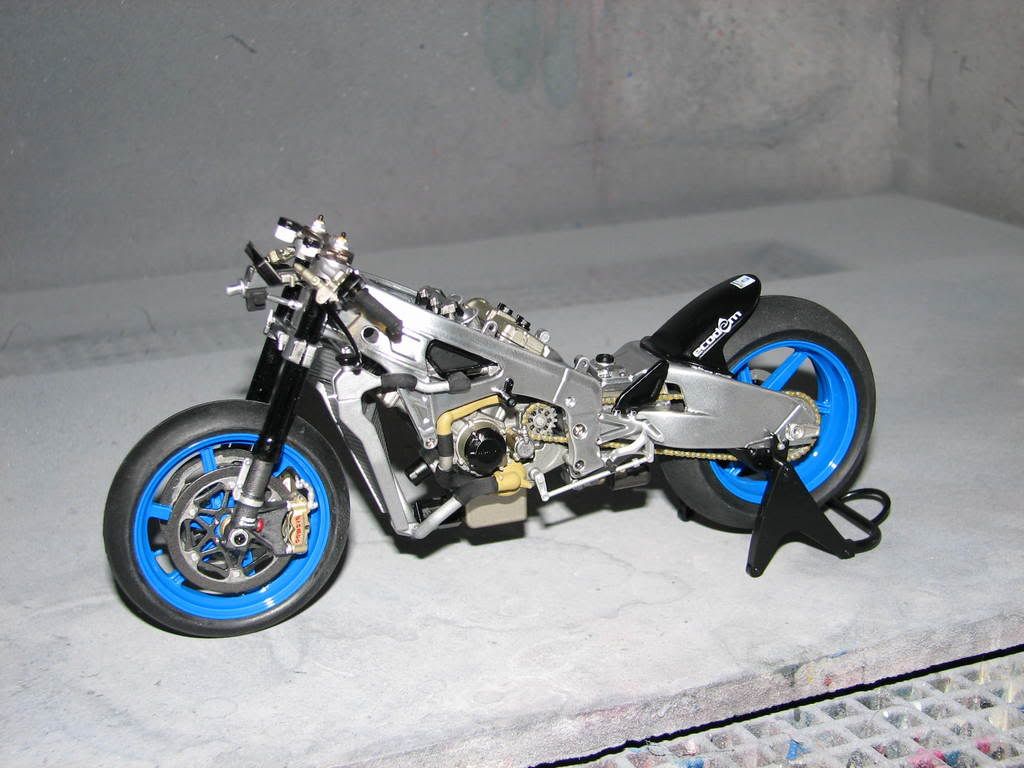

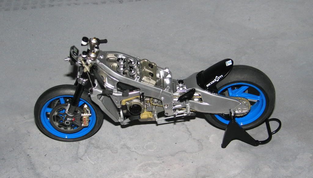

Brendan Posted April 30, 2008 Posted April 30, 2008 Milt, Here's some pictures of a bike that I did with Duplicolor Chrome. It's only on the frame. It's decent but it won't be replacing Alclad any time soon. The main thing I dislike is that it is an enamel. It took over two weeks to completely cure. Other than that I would use it again for covering large areas, especially for the price.
m408 Posted May 6, 2008 Author Posted May 6, 2008 Milt, Here's some pictures of a bike that I did with Duplicolor Chrome. It's only on the frame. It's decent but it won't be replacing Alclad any time soon. The main thing I dislike is that it is an enamel. It took over two weeks to completely cure. Other than that I would use it again for covering large areas, especially for the price. Seemed to work out well Brendan. Couple of questions. How well would a dehydrator aide in drying time? How to get added gloss? I tried Duplicolor clear over a spoon test and it turned the sample grey. Milt
Brendan Posted May 17, 2008 Posted May 17, 2008 Seemed to work out well Brendan. Couple of questions. How well would a dehydrator aide in drying time? How to get added gloss? I tried Duplicolor clear over a spoon test and it turned the sample grey. Milt I'm not a big fan of using a dehydrator on metallic finishes. I've seen them dry in patches before. It makes the paint look bad. But I also know people who have had good luck with it too. As for making it glossier, the only thing I can recommend is Future Clear Acrylic. There's something in the enamel paints in their metallics so if you put a clear over the top it ruins the finish.
