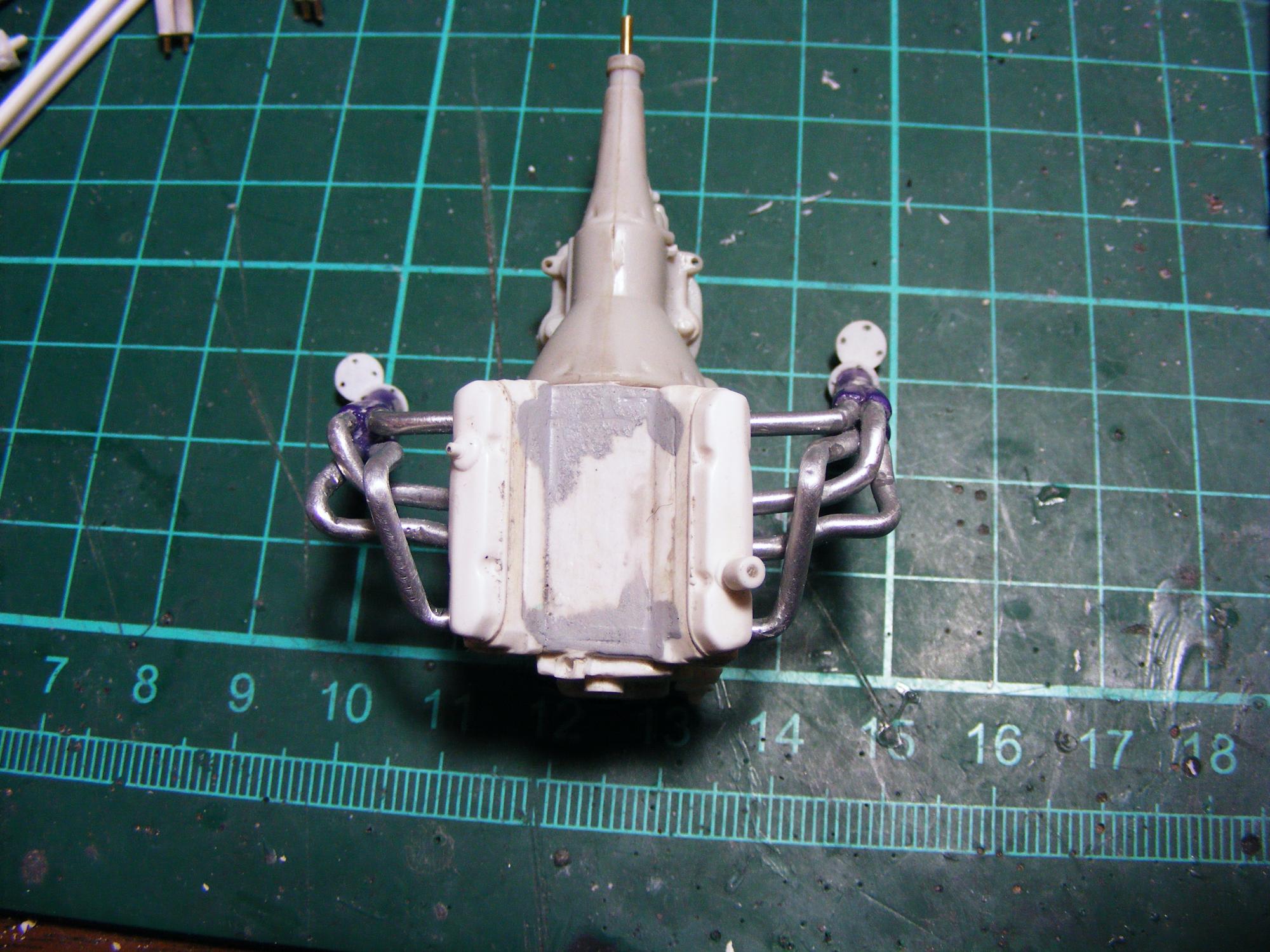

DR JAY Posted June 15, 2016 Posted June 15, 2016 I bent up these fender well headers from K&S aluminum tubing by hand...I straightened some paper clips and inserted them inside the tubing 1st to prevent kinks
