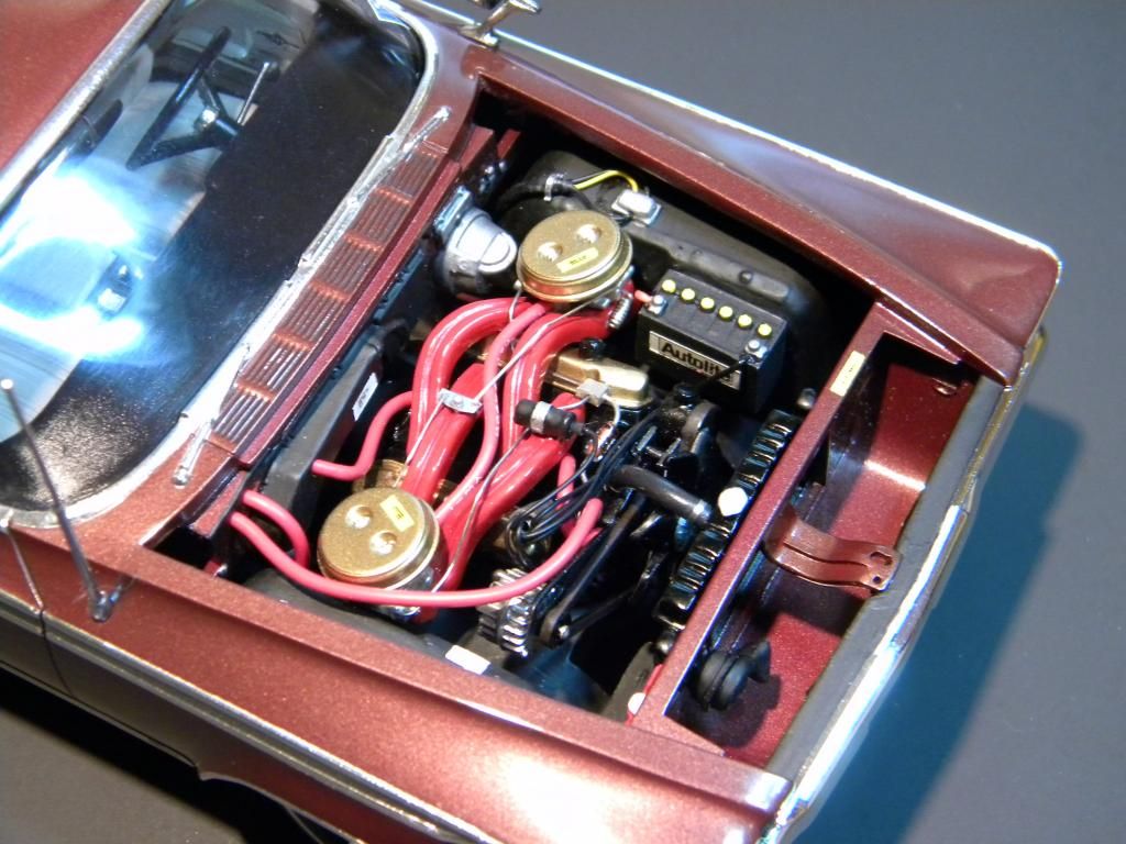

keyser Posted June 22, 2016 Posted June 22, 2016 (edited) Tim, I think the runners were really similar, but the 30" ones ended up with the carb outboard the valve cover, and the 15" ones were closer to V edge of valve cover. That said, I don't see 15" diff between the two. Now I have to figure that out. Pretty close at a glance though. I learned stuff looking for this. Best part of boards. Edited June 22, 2016 by keyser
StevenGuthmiller Posted June 22, 2016 Author Posted June 22, 2016 Tim, I think the runners were really similar, but the 30" ones ended up with the carb outboard the valve cover, and the 15" ones were closer to V edge of valve cover. That said, I don't see 15" diff between the two. Now I have to figure that out. Pretty close at a glance though. I learned stuff looking for this. Best part of boards. Just from the appearance in your photos Christian, I'm assuming that all of the manifolds included in the Johan kits were the "Long Ram" variety. I'm pretty sure that they all looked like the ones I used on my '64. Steve
keyser Posted June 23, 2016 Posted June 23, 2016 Yes, all long ram. The short ram looks different, as it is flat where the runners are siamesed, and the long ram is separate from plenum to port. It'd be pretty easy to box off the runners from base of carb to 1/2 way down length. There has been notes about the short ram being narrower, and it did look shorter in a couple albeit poor pictures, with carb more inboard. This is consistent with smaller engine compartment of Plymouth and Dodge, vs. the Chrysler, where the wheelbase changed, but front end was pretty much unchanged.Wish someone would cast another 61 300 letter car. Love those things. 62 close, but the fins just Exner.

keyser Posted June 24, 2016 Posted June 24, 2016 Well, I can't get to my JoHan Cross Ram manifolds I have, but if someone can throw a caliper on them, I'd guess length from bottom of plenum to port should be 30"?? I cannot find dimensions of the B motor, but has to be 30" from base of carb to port, and short ram basically siameses half that, as you can see the separate round runners start halfway from carb plenum to port. I did not see anything about 18" looking. Pic came from All Par. 63 motor, but same manifolds. ,
