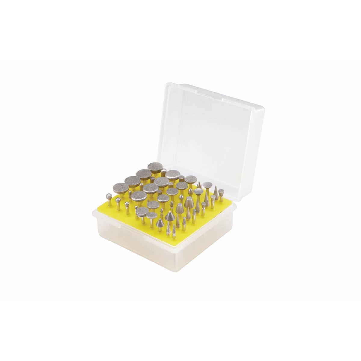

935k3 Posted June 25, 2016 Posted June 25, 2016 The diamond rotary set from Harbor Freight is what you need. You can get a 20% off coupon. http://www.harborfreight.com/50-pc-diamond-rotary-point-set-69665.html

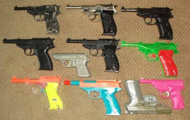

Snake45 Posted June 26, 2016 Author Posted June 26, 2016 Thanks for the advice and ideas, fellas! Here's what I'm trying to do: I have a number of solid aluminum or solid resin dummy guns (acquired when a local holster maker went out of business) that have the entire trigger guard areas molded solid. I want to lay some model-fu on some of these and turn them into nice-looking wall-hangers for my man-cave. Two of them are this picture, the solid aluminum Walther PPK and the gray resin P5 (lower right). I suppose the best way to do this would be to drill a series of holes on a drill press, knock out the main chunk, and then clean up with a file (which I'll do in any case), but I don't have access to a drill press.
1930fordpickup Posted June 26, 2016 Posted June 26, 2016 An 1\8 in drill should fit an 1\8 collet just fine Snake or just drill with a hand drill. .
Snake45 Posted June 27, 2016 Author Posted June 27, 2016 A jeweler's saw is the ticket for thatIt would be if I could find a strong enough blade. Or several such, as I'd anticipate breaking a number of them in the process. You know, a coping saw might work fine for the resin ones if I can find a suitable blade. Thanks for the idea!
