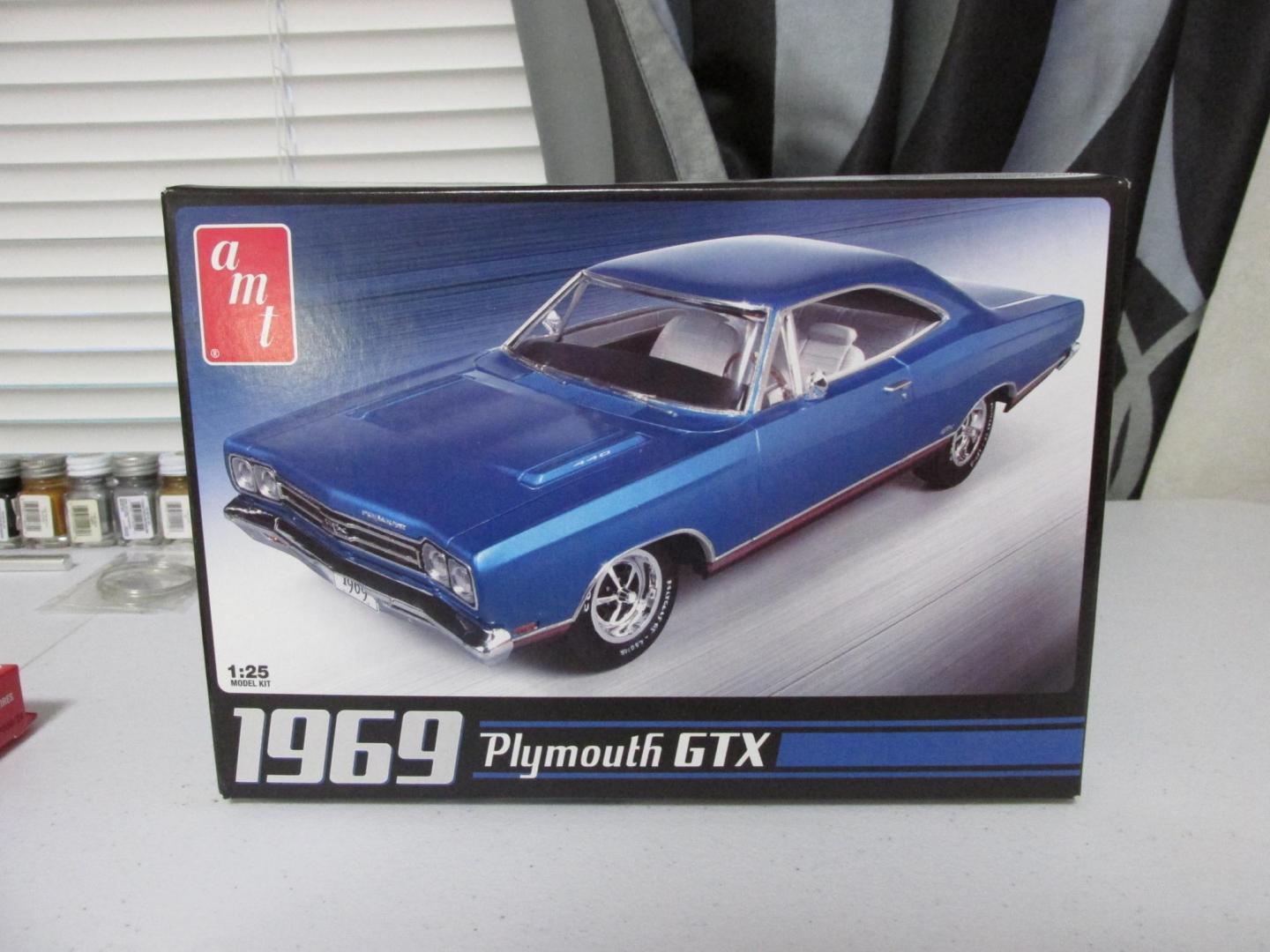

A 1969 GTX kit. For our build, we will be using the 440. Normally, I'd shove a Hemi into this in a instant, but again, we want a fully restored car on a budget. Since most of these cars came from the factory with a 383, or a 440, we're gonna go with the more common motor.

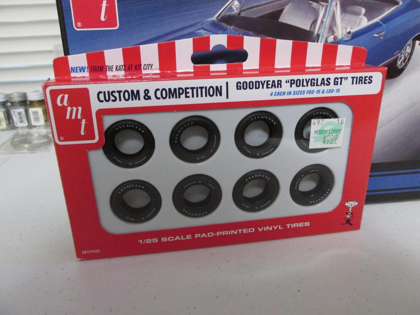

I see that AMT is now including the pad-printed Goodyear tires in the newer kits, but mine doesn't have them. So, I went and picked up one of their supplementary parts packs to give me the tires.

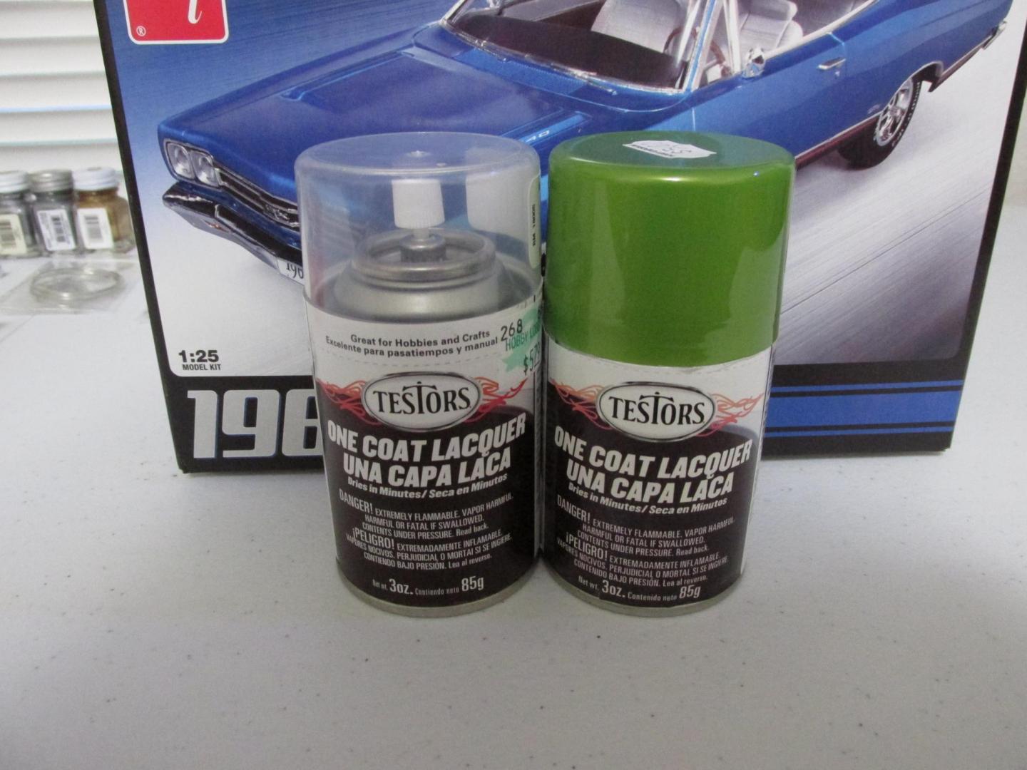

For our paint system, I've decided to go with a unusual color. I've chosen Testors Lime Ice, which is not a factory Plymouth color, but I like it, and it will be one more step towards liberating myself from the B5 Blue craze that I used to have. I'm topping the Lime Ice with Wet Look Clear.

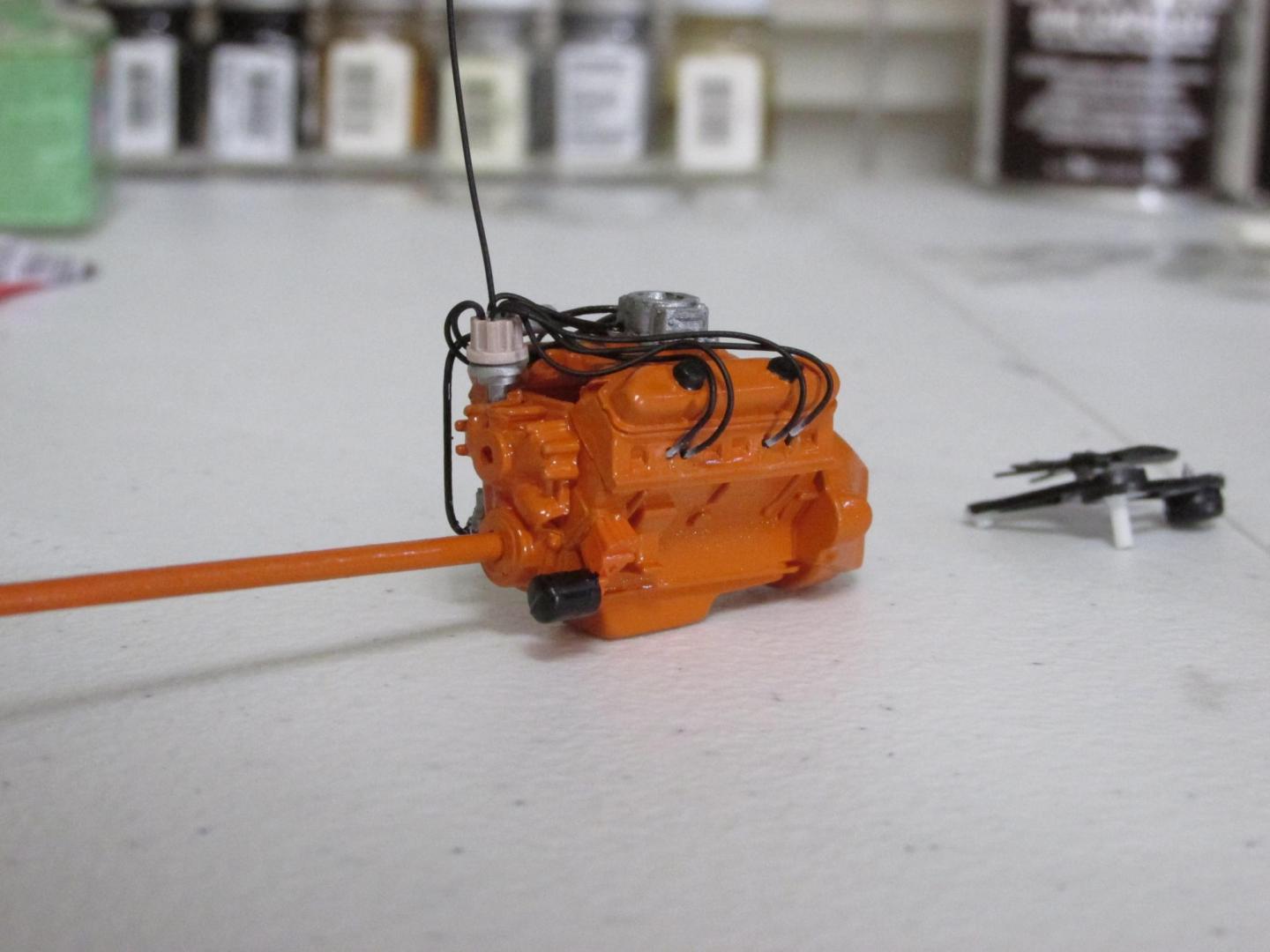

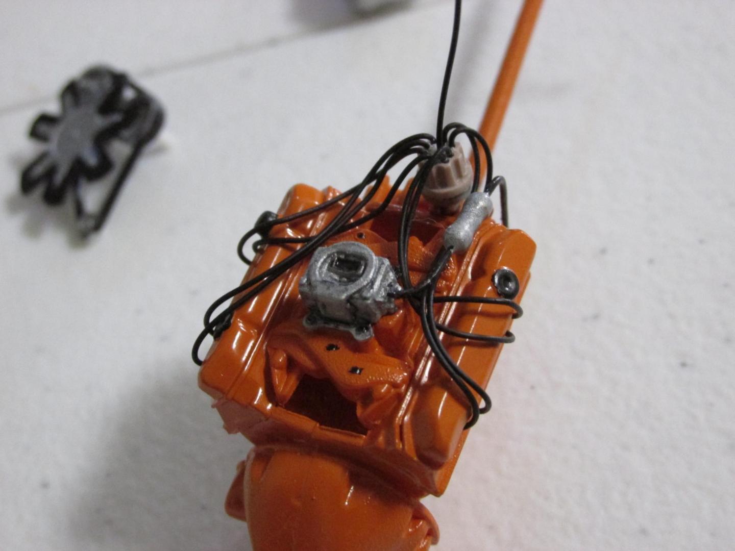

Thanks for all the comments guys! Today, I put in some marginal progress to the GTX. I don't really want to rush it along, so I've just kinda piddled with the engine. Now, I want to point something out for you stock 440 builders out there.
This engine as it sits would run just fine, because EVERYBODY knows that the 440 left the pushrods and all its guts exposed under the intake. (Sarcasm level 10). For some dumb reason, AMT has decided to leave out the plate that goes between the block and intake. I'm not sure what it's called, I know on my real life '98 Ram, it's called a "plenum" with some parts catalogs calling it a "valley cover" or "top plate". I only know this because I've replaced the dern thing twice. (not fun) At first, I thought this was a simple one kit issue, but it appears that it's not, because even the box art model is missing it. Oh well. Anywho, so I assembled the block and painted it. There was some internal debate about the color, all of the reference cars I looked at were Street Hemi Orange, while the Mopar guidebook I have shows all 1962-71 B/RB big blocks being painted in Chrysler Turquoise, with the "High Performance" option on the 440 being the only exception. I could not find any difference between a "regular" 440 and a "high-performance" 440, so I sprayed it Street Hemi Orange. Carb was done with aluminum and a black wash, a fuel line was added by using a electrical resistor as the line/filter, and then the MAD distributor was put on and wired up.

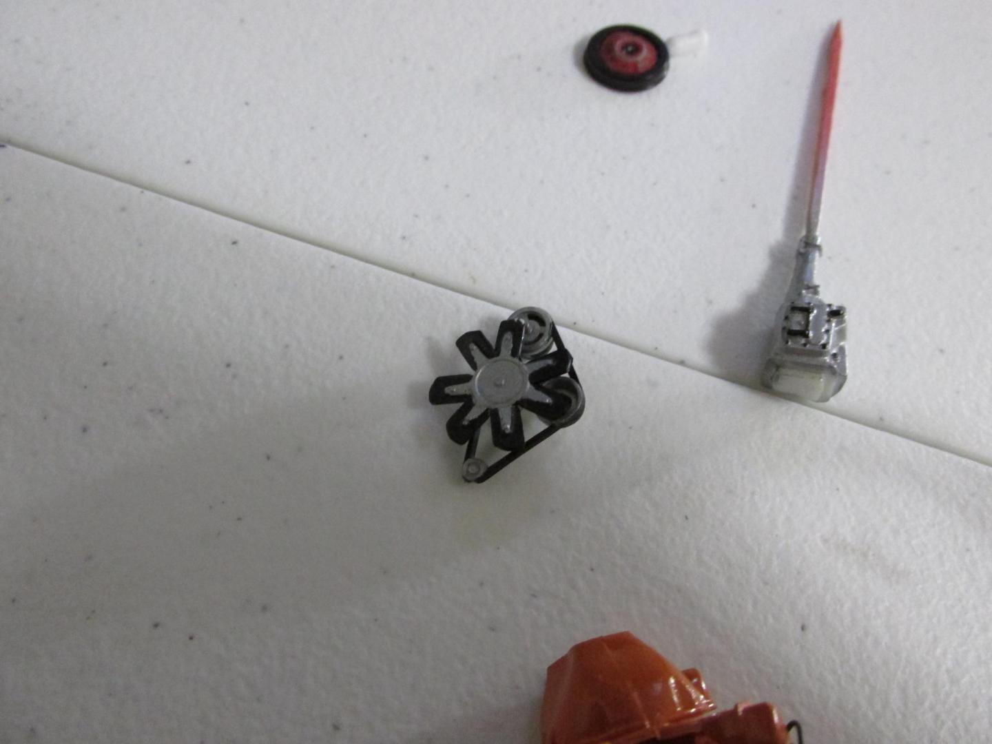

The fan belt assembly coming together. Still need to add the alternator and do some touch up to the belts/pulleys.

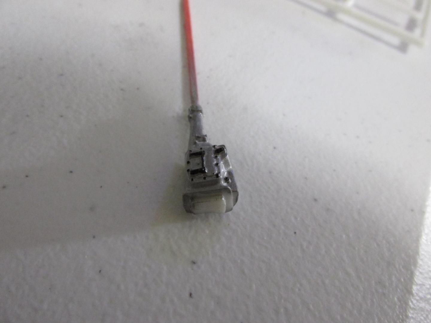

I've also painted the transmission and detailed the linkage.

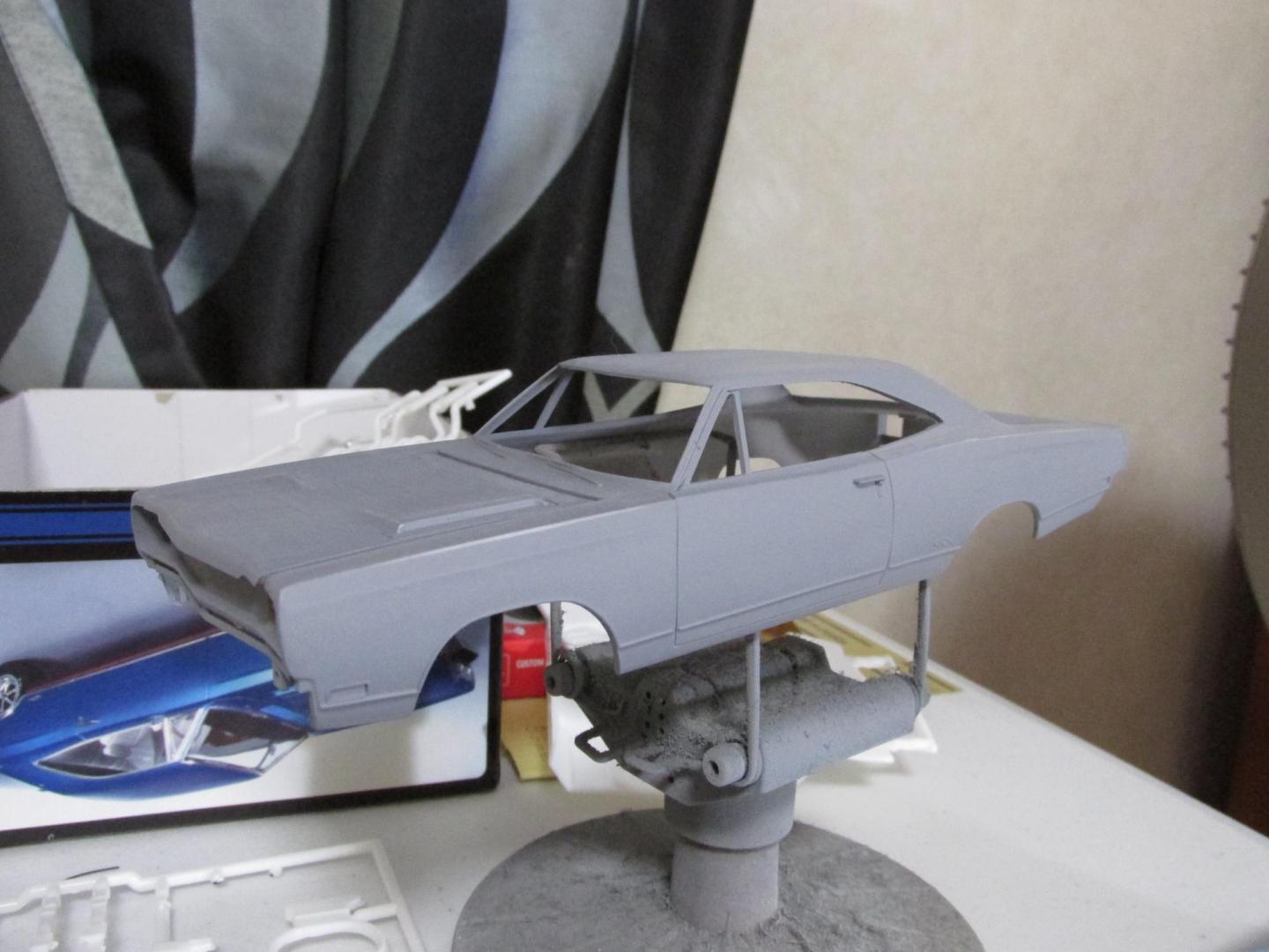

I started on the body, because I like my paints to gas out for a good two/three days before I start handling them. So, I shot the body with two coats of Duplicolor auto primer, and then sanded down the rough spots. Another two coats tomorrow, and if it looks good, I'll let it sit overnight and then shoot color the next day!

Cool car! Will be keeping an eye out for this one Brandon. That Wet Look gloss lays down a really good lookin' gloss but don't freak out when you're spraying it on because it will horrify you to look at all the bubbles that'll pop up. My current build looked like it had the dang measles at first! I thought sure I was going to be throwing the whole body in brake fluid to strip the paint job. I went back to my paint drying booth with my head hung low about 5 minutes later and every thing had leveled out and it looked perfect. Just a heads up that whatever disaster it looks like after the initial coating with that stuff that it'll end up being ok.

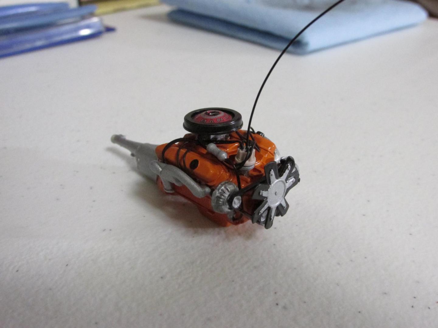

Brandon, your GTX build is very exciting for all to see, and thanks for posting all. .....one thing I would like to point out, if you don't mind,,,you may find it a little tricky to install your exhaust manifolds now, as your ignition wiring blocks the way to mate with the ports. big inch wedge Mopar engines have the plug wires routed under the manifolds and then up to the cap......not being a critic here, just thought that may help......the Ace....:D

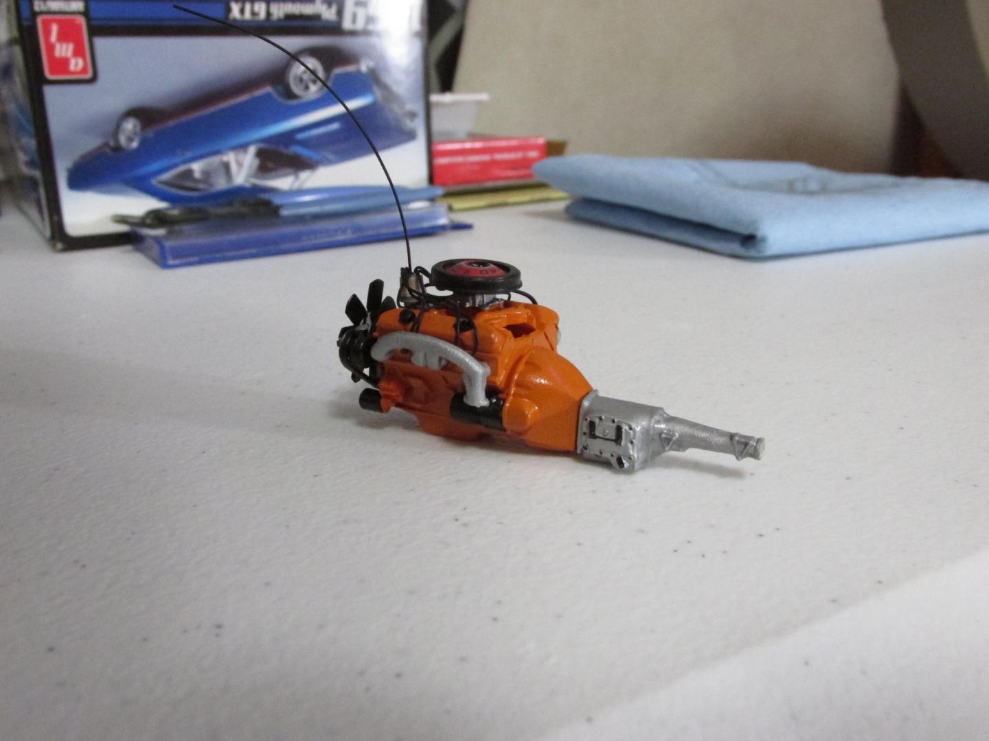

Well, the paint has been flying today and progress has been made.
I started the morning off by finishing up the 440. I'm rather pleased, as this is probably the nicest engine I've built. For those wondering, yes, the coil wire will eventually get connected. I'm gonna mount a MSD coil on the firewall somewhere.

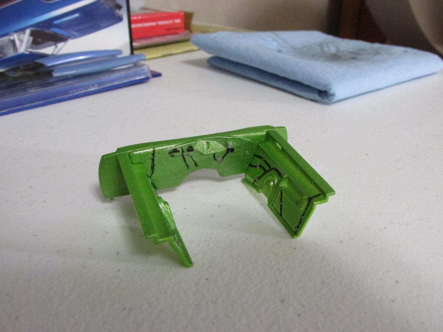

I moved on to the "doghouse", hitting it with the body color and then picking out the molded in lines with various blacks and some aluminum for the straps. I still need to paint the backsides of the fenders semi-gloss black.

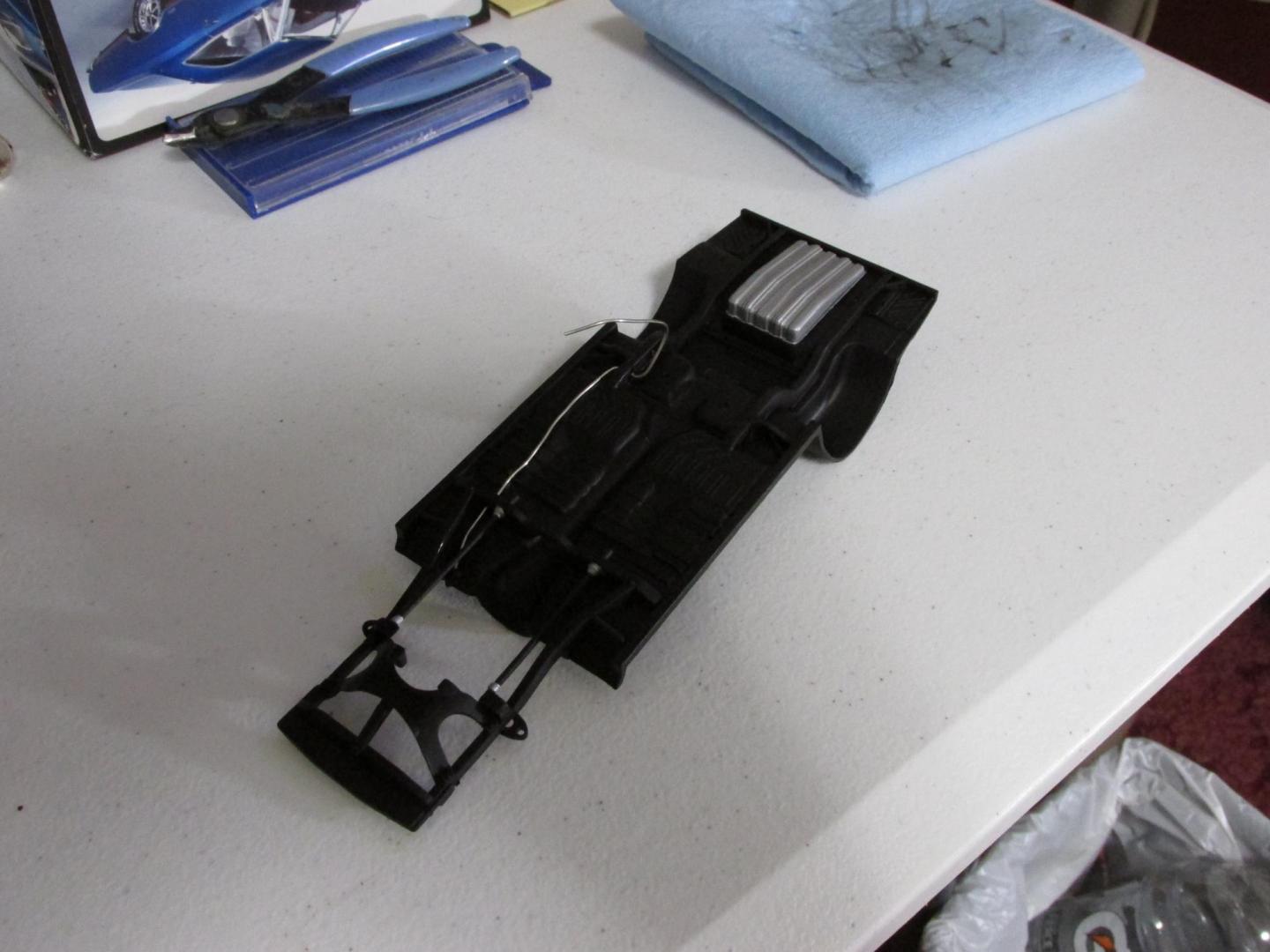

I started on the chassis. Normally, I'd hit it with primer and then simulate the "factory overspray", but since this is supposed to be a replica of a "diy resto" car, I went for semi-gloss black. I drilled out my spots for the brake line, and ran it. This will eventually just terminate at the rear axle.

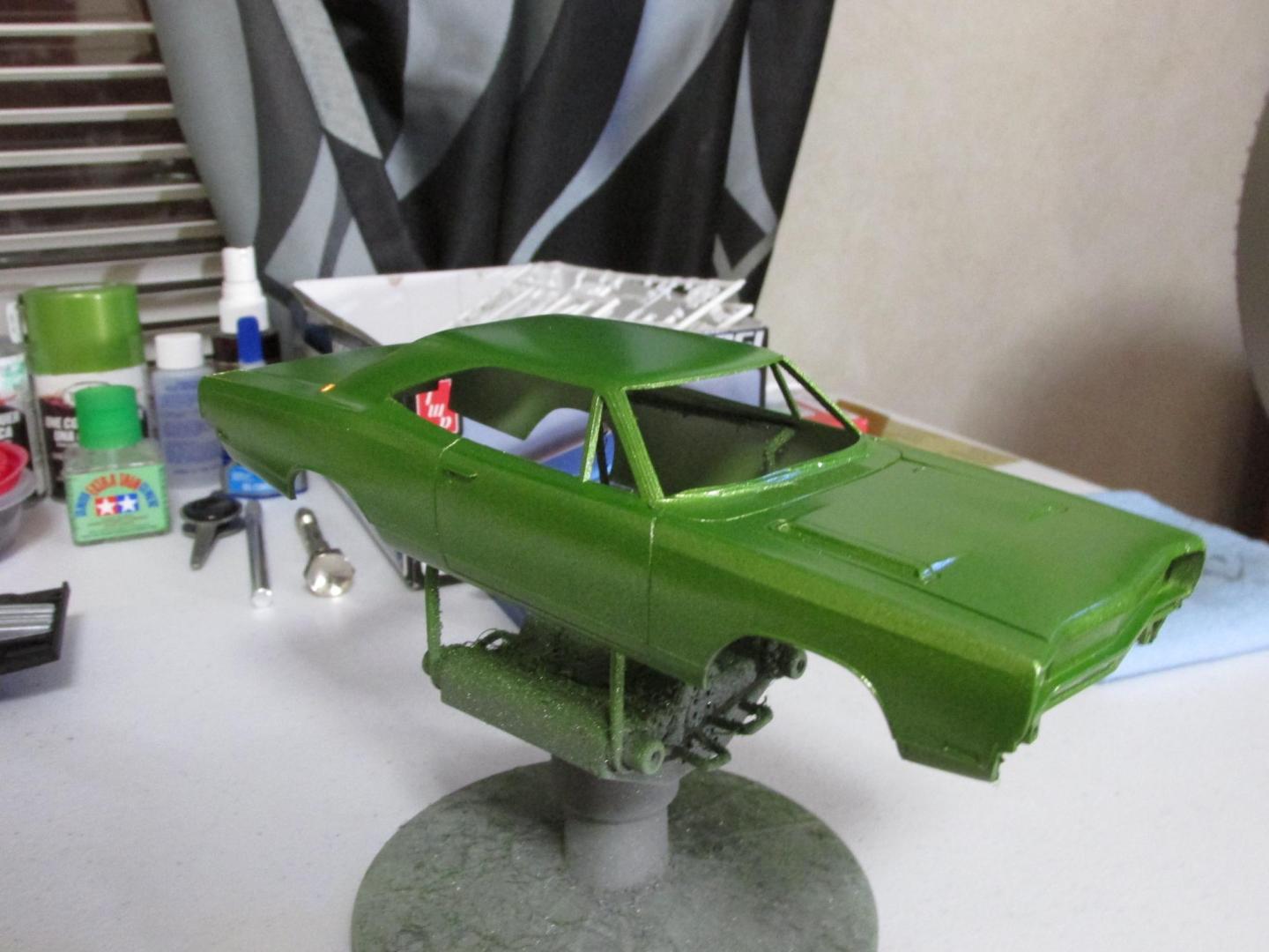

The color is on! I hit the body with two final coats of primer, let it sit for about 3-4 hours, and then shot it with three coats of Lime Ice.
IMG_0786.thumb.JPG.fb0e0795a314b81a97f7f

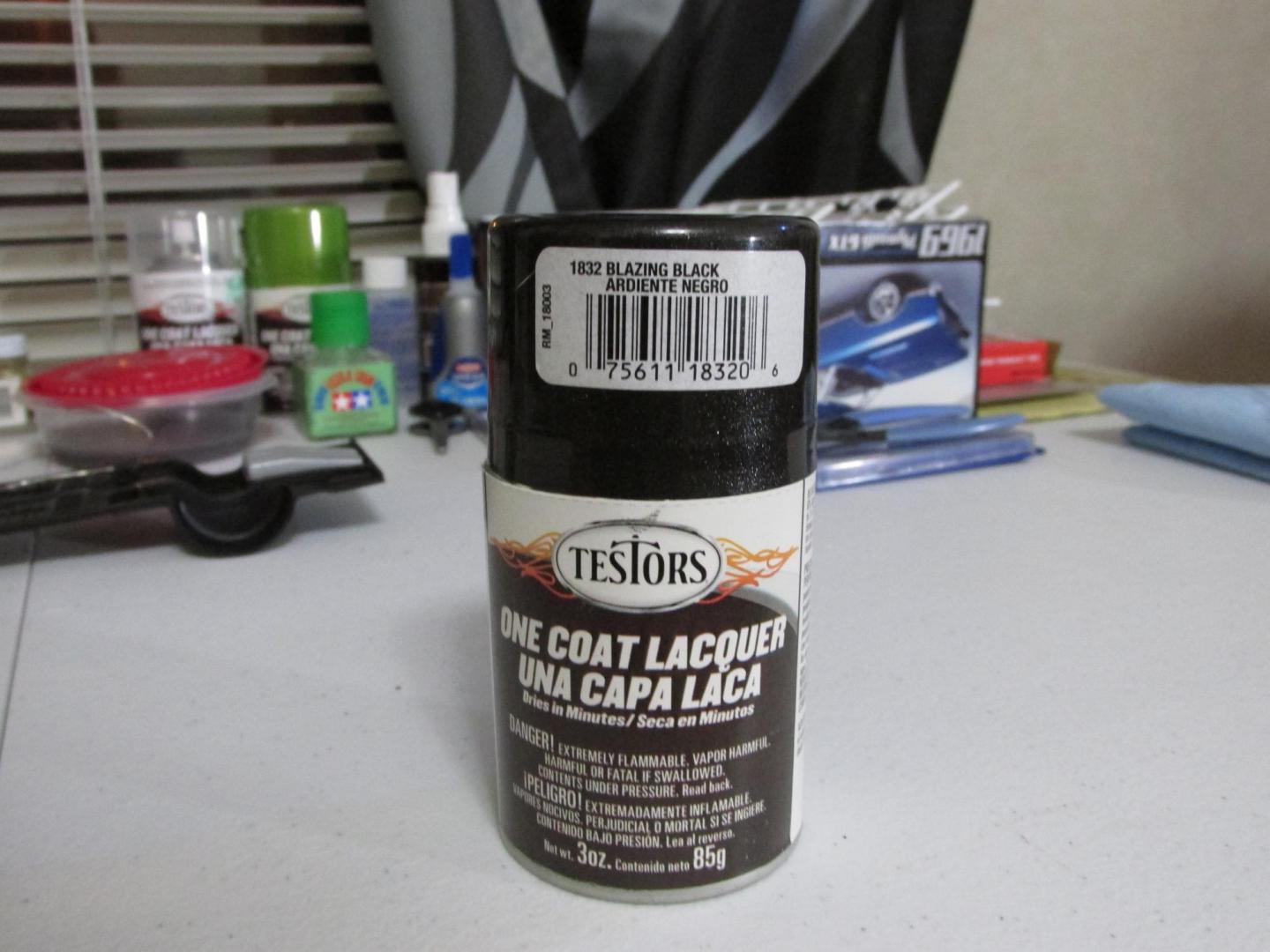

Tomorrow, I will mask off the lower parts of the fenders and hit them with Blazing Black, for a cool two-tone look, then clear the car with my usual three coats of clear. The factory option for the car would just be flat black after clear, but I'm saving the flat black for the tops of the fenders and the hood.

Looks good Brandon! Can't wait to see it with the clear on it! That Blazing Black is a lighter shade of black than I'm used to but given the metal flake paint you're using it should work good.

Nice start, but please don't put L 60 tires on the front.
Did the car not have L60's all the way around? I just went off of what was included in the kit, which was four L60's

I think the car came with F 70s all around , Ls were an up grade to get more traction,  here's a copy of the tire information sticker.
I'm in the "whatever fits the wheels used" camp here, Brandon, but that's just me.
