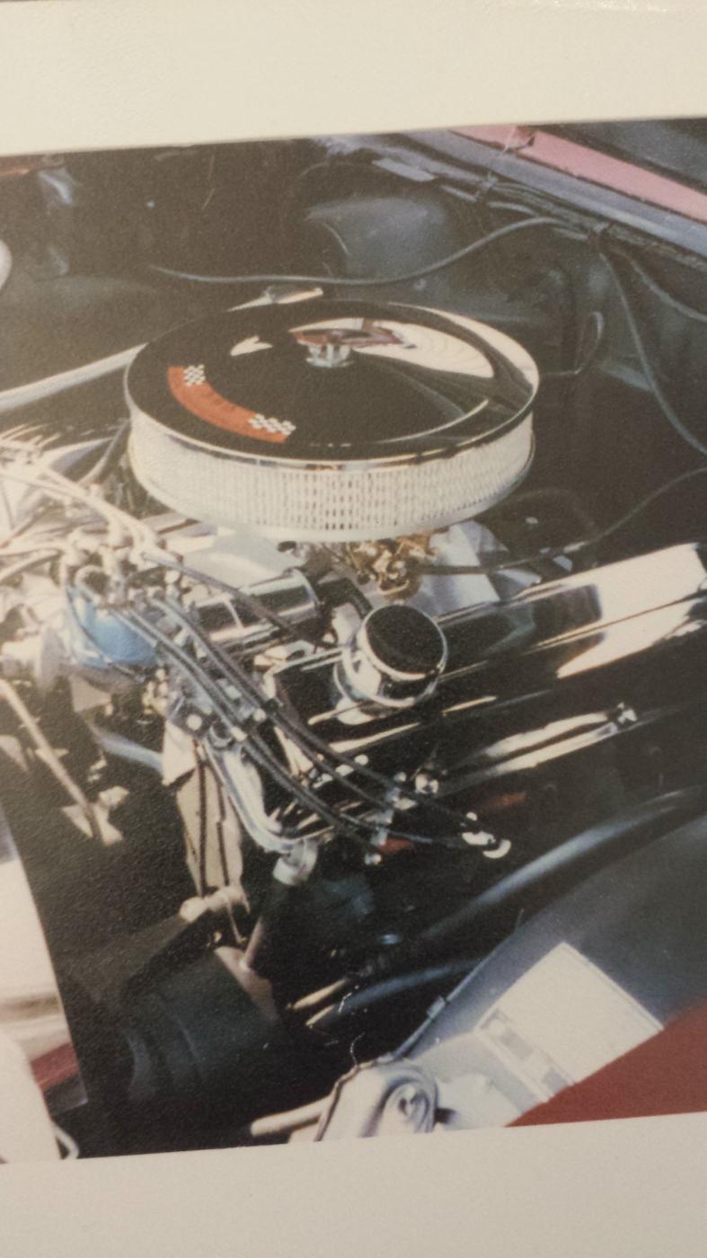

Perspect Scale Modelworks Posted July 3, 2016 Author Posted July 3, 2016 You are going to need the "Powered By Ford" valve covers from the Revell '68 CJ Mustang or '69 Mach 1 to make an accurate '67 FE engine. The stock LTD air cleaner will be a problem too. You may have to scratch build one or modify something to replicate it. The valve covers are not stock on my dad's car and it looks the air cleaner is the same in the Cyclone kit. Here's a picture of a picture of his engine.
Rodent Posted July 3, 2016 Posted July 3, 2016 The 67 Cyclone kit has,the powered by ford valve covers in it. The 66 fairlane kits have two completely different engines. The gta has the 390, the 427 has a 427 engine. Im pretty sure that the engine blocks are the only thing they share.the fairlane 390 also has the pbf valve covers.You are correct. My foggy memory was picturing the slightly older style with the sharper peaks. Odd thing is that the valve covers aren't plated in the GT/GTA kit.
