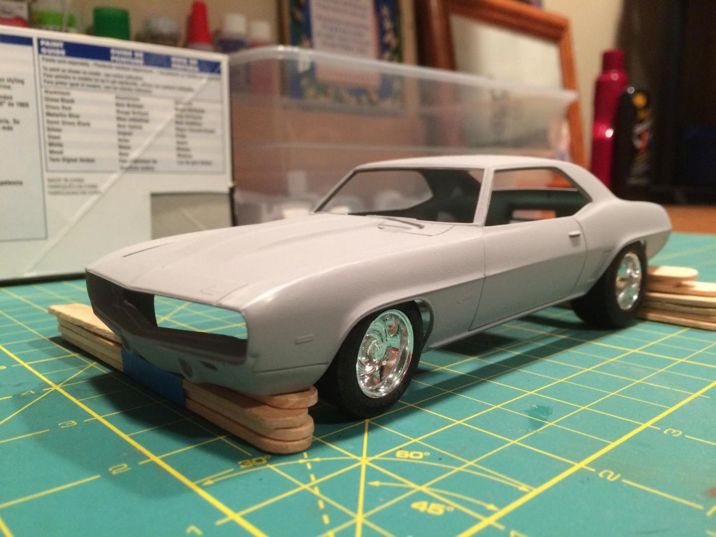

carcrazy19 Posted June 29, 2016 Posted June 29, 2016 (edited) This is going to be tribute build and birthday gift of a 69 Camaro SS that my brother restored about twenty years ago. This is the REVELL 69 z/28 kit. I'm think that I will replace the 302 with a 427 from the COPO kit. The color of his Camaro was black exterior on black interior. This will be my first time painting black so wish me luck cause I know its a tuff color. Right now not much is done, I am just in the mock up stage but this is the look I want to achieve. It will be mostly out of box stock except for the tires and wires. Edited June 29, 2016 by carcrazy19

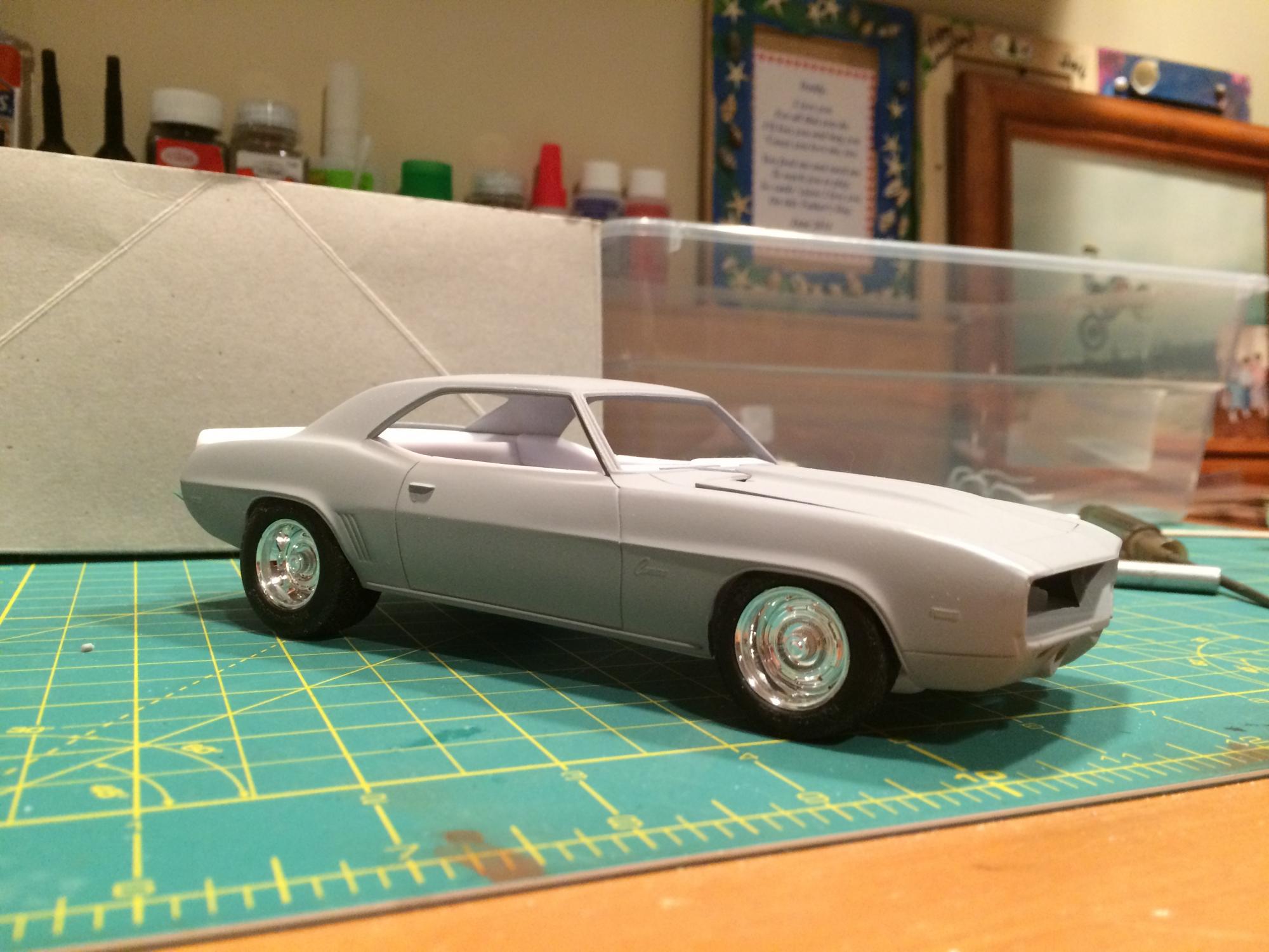

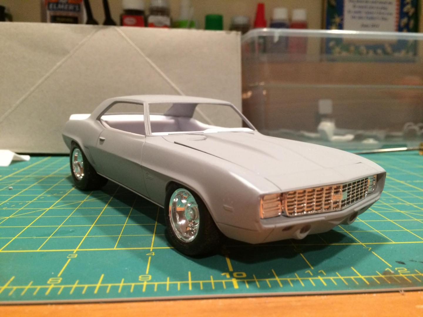

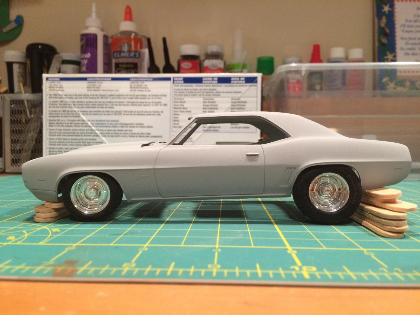

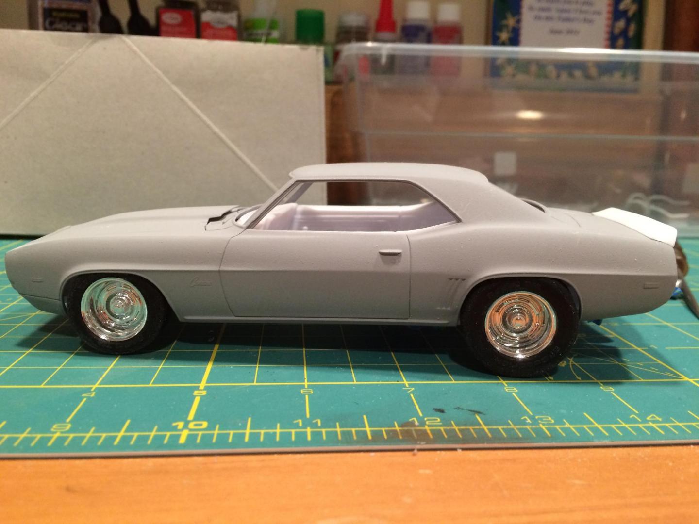

carcrazy19 Posted July 16, 2016 Author Posted July 16, 2016 (edited) It's been slow going. I'm not able to get too much bench time. Much of my time is spent with my kids so maybe one or two hours during the week after they go to bed. It is still in the mock up stages but I did finish setting the stance that I wanted. Next I'll start working on the engine but for now here are some pics of what I got. Not a lot of progress but a little something is better than nothing. Also going to try to open up the grill so I was thinking the best and fastest way would be with a dremmel. It will be my first time attempting this so any tips are appreciated. Thanks Edited July 16, 2016 by carcrazy19
mikemodeler Posted July 16, 2016 Posted July 16, 2016 Love the stance on the car, looks great! As far as opening up the grille, be careful using the Dremel! I have used some coarse sandpaper (150 grit) on a block of wood so I can control the amount of material being removed, make sure you take your time unless you have a spare grille!
disconovaman Posted July 16, 2016 Posted July 16, 2016 This is my favorite kit to build, I use 220 grit sand paper to open the grill on mine takes me about two hours. I like to be in control so as not break the grill and hand sanding seems for me the best way. It's time consuming but the safest way. l'm scared the dremmel would get away from me quickly.
Can-Con Posted July 16, 2016 Posted July 16, 2016 I do that kind of stuff with my Dremmel all the time and have in fact done that grille in the past.Just go slow. using a barrel sander, make light passes over the back . Don't try to take it all off at once, light passes will get you there.You'll be able to tell when you get close to being through. You'll be able to see the pattern of the grille where you're sanding.You can stop before you're completely through and finish opening the holes with a sharp #11 X-acto .Good luck.

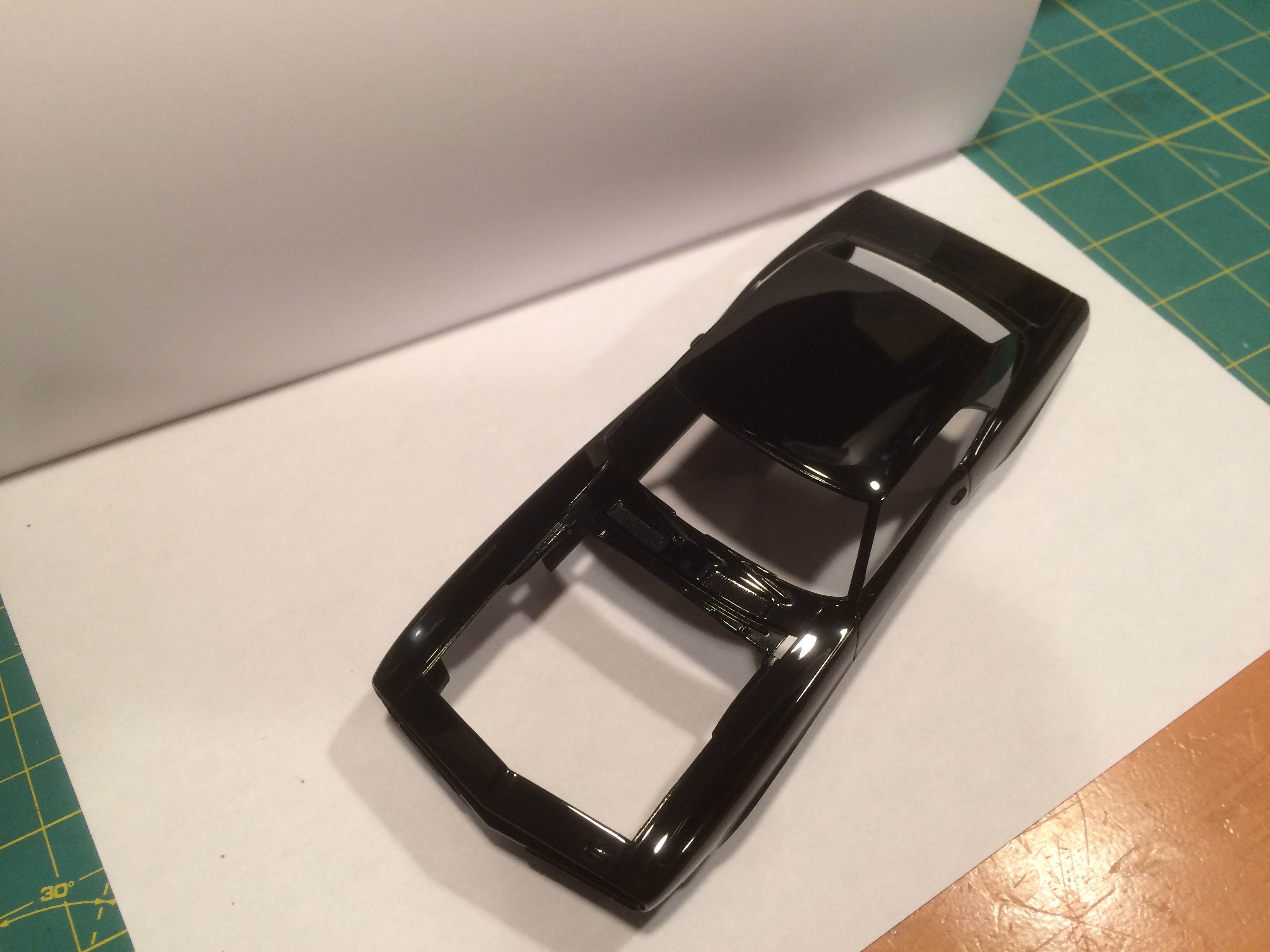

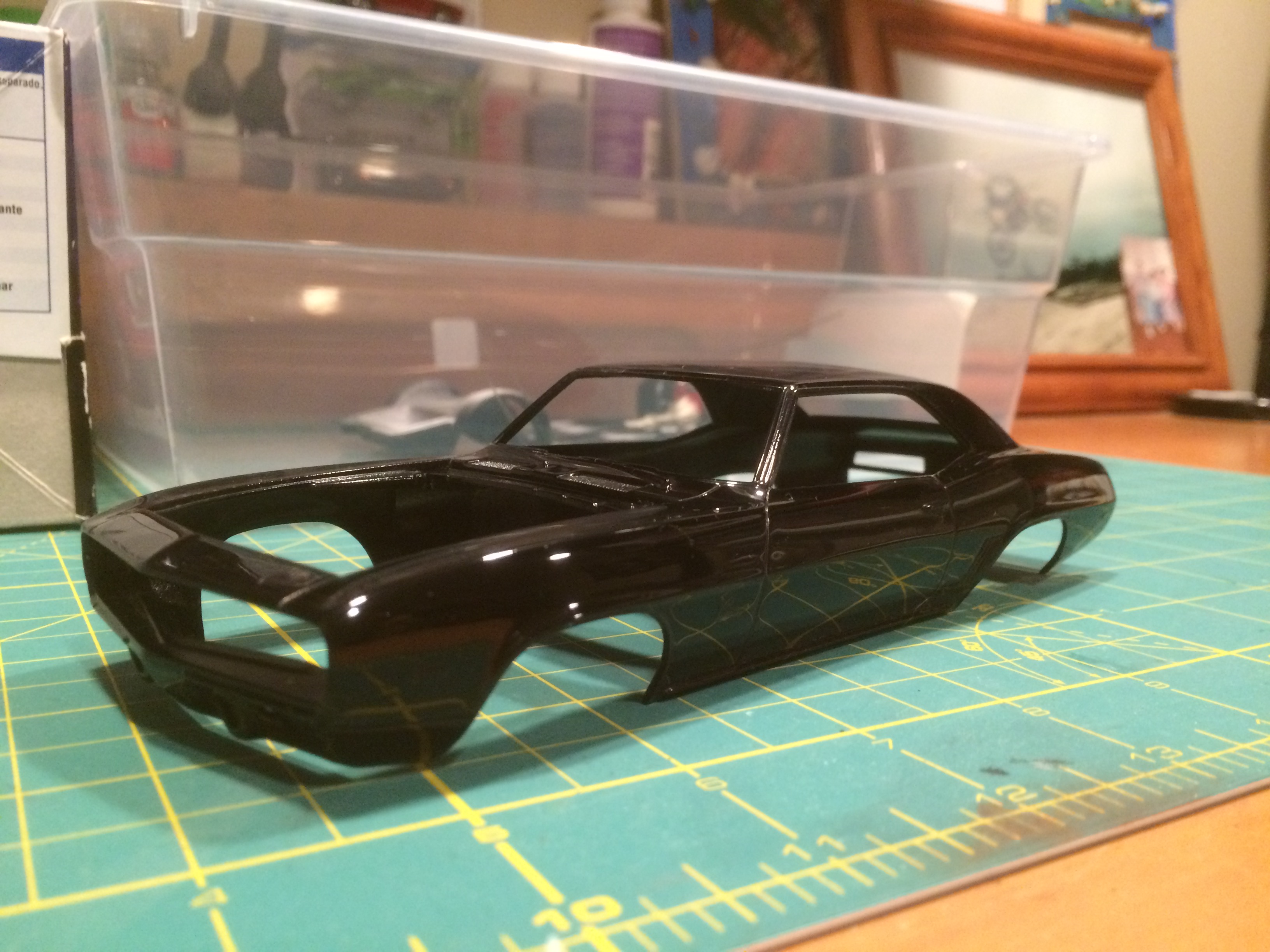

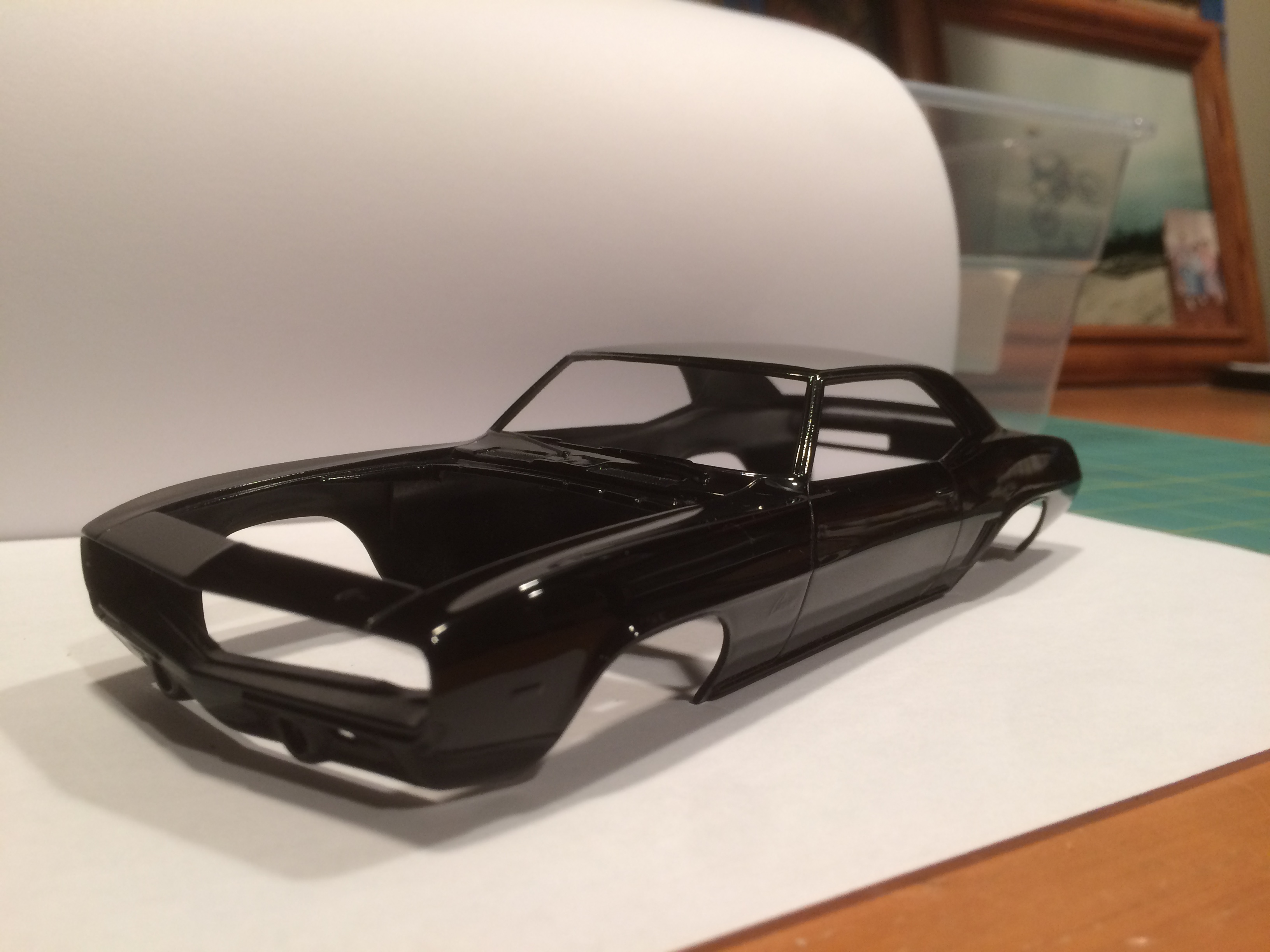

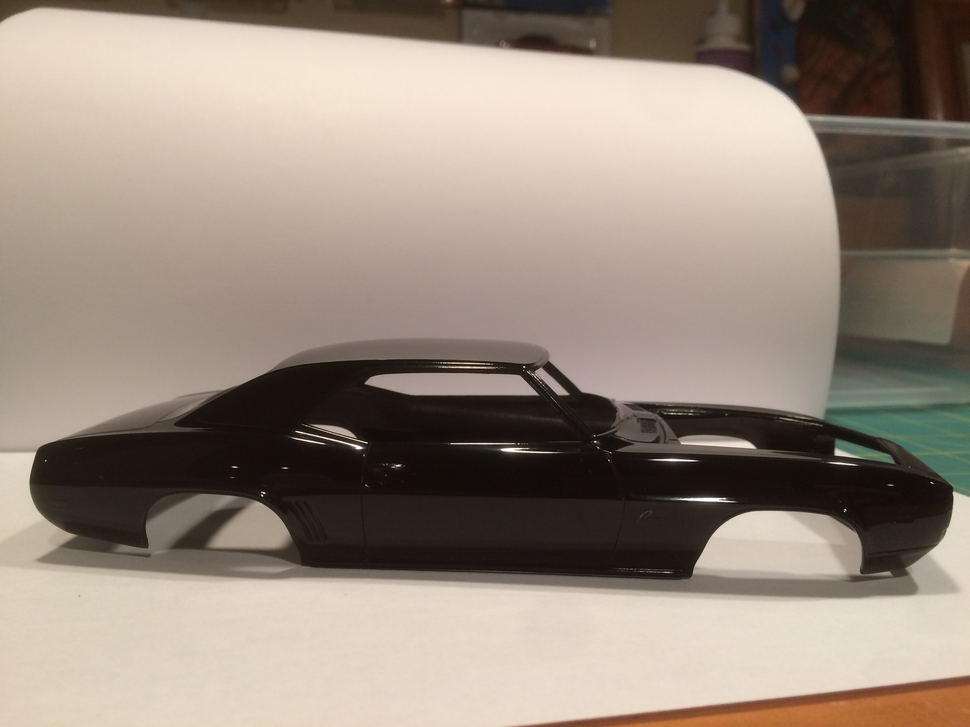

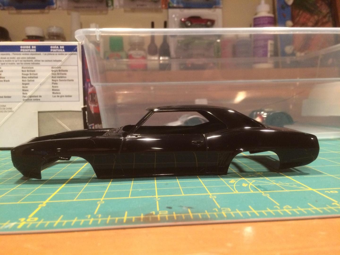

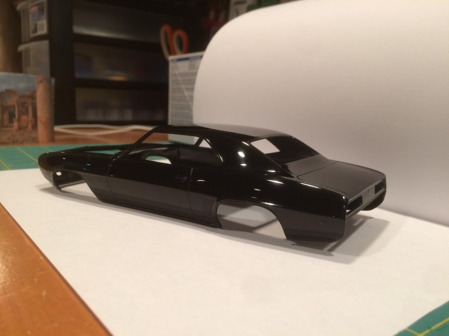

carcrazy19 Posted January 27, 2017 Author Posted January 27, 2017 I haven't been doing much work at the bench lately and this project has been sitting for a while. I started getting the itch again to do some building so got back to working on this again not much is done. Before the cold weather started and I took a little brake I was able to get the body painted. The past couple of nights I been sanding and polishing it. For my first black paint job it came out pretty good not perfect but I think acceptable. Thought I share a couple of pics, let me know what you think. Thanks.
Jhedir6 Posted January 27, 2017 Posted January 27, 2017 Looks pretty good to me. I'd love my black paint jobs to come out that nice.Looking forward to seeing more.David
NY Modeler Posted January 27, 2017 Posted January 27, 2017 Stop second-guessing yourself Anthony - that black paint job is killer! Better than any of mine have ever turned out.Keep up the great work. I'm enjoying following this build.-Ken

mustang1989 Posted January 29, 2017 Posted January 29, 2017 I know many modelers who have painted black using Model Master Classic Black (rattlecan) and I don't think I ever saw a paint job using that that wasn't spectacular.Looks like it turning out to be just that..................spectacular!!
