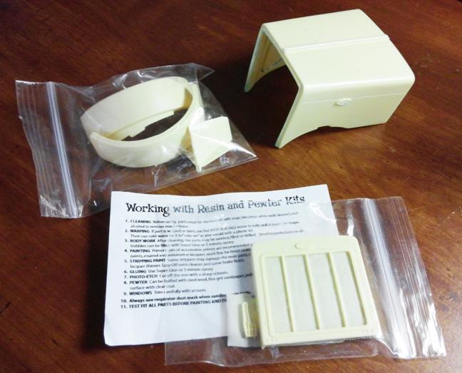

Mike77 Posted July 3, 2016 Posted July 3, 2016 I picked up a Peterbilt 379 hood conversion kit on Ebay. Can anyone tell me if this is a Bill Drennen hood, and if so, if it made for AMT or Revell Petes? Thanks!
Petetrucker07 Posted July 3, 2016 Posted July 3, 2016 Mike, I'll have a look at mine. Yours looks different, if my memory is workin right. I'll post a pic of mine. I believe, from what Bill told me, it was one of the last 379 hoods of his. Oh, and it's for Italeri kits.
Superpeterbilt Posted July 3, 2016 Posted July 3, 2016 That looks like a Revell snap 359 hood stretched to a 379 Mike.
Mike77 Posted July 3, 2016 Author Posted July 3, 2016 That looks like a Revell snap 359 hood stretched to a 379 Mike.Hmmm...I wonder who made it. It's all resin and it's well-done. The resin is smooth, not grainy like a lot of resin parts are. it includes the 4 extra grille bars which is what led me to think it might be a Drennen conversion.
chuckyr Posted July 4, 2016 Posted July 4, 2016 (edited) Without seeing it close up, it could be. Or a very good re-pop. I have an original Dreenan kit, cast by Clint Freeman in a tan-ish vinyl resin. Your item looks to be cast in a cheaper material. But I think there were several castiers later on that used different materials. You are missing the cab and a few other items that came in the original kit. Edited July 4, 2016 by chuckyr
Mike77 Posted July 4, 2016 Author Posted July 4, 2016 Without seeing it close up, it could be. Or a very good re-pop. I have an original Dreenan kit, cast by Clint Freeman in a tan-ish vinyl resin. Your item looks to be cast in a cheaper material. But I think there were several castiers later on that used different materials. You are missing the cab and a few other items that came in the original kit. I know it's hard to tell from a photo but this seems to be pretty good material as resin goes. I've had a lot of resin parts that are gritty and grainy and these are nice a smooth. Besides the cab what other parts does the original Drennen kit come with?
Petetrucker07 Posted July 4, 2016 Posted July 4, 2016 I have the hood conversion for the Italeri 378. The fenders and lower cab panels are cast together, with extra grille bars. It is a nice piece. I want to use it, I just can't decide what.
kwt950 Posted July 16, 2016 Posted July 16, 2016 It could be a knock off of my hood, hard to tell. Can you post pics of the underside of the hood and fenders Bill
kevjoh Posted July 16, 2016 Posted July 16, 2016 (edited) The Pete hood you're showing is the Clint Freeman 1/24th scale hood. MS-10 You'll notice that it's got the narrow hood strip which is the same as the 1/24th Italeri Pete 378 kit This hood is to convert the Italeri 378 to a 379. Just checked mine, bought it way back in 2002 for $35.The Bill Drennen 379 hood is 1/25th scale, it's to convert the Revell Pete 359 to a 379. It's got the wider hood hood strip the same as the Revell kit. Edited July 17, 2016 by kevjoh gramma
Mike77 Posted July 17, 2016 Author Posted July 17, 2016 The Pete hood you're showing is the Clint Freeman 1/24th scale hood. MS-10 You'll notice that it's got the narrow hood strip which is the same as the 1/24th Italeri Pete 378 kit This hoods to convert the Italeri 378 to a 379. Just checked mine, bought it way back in 2002 for $35. The Bill Drennen 379 hood is 1/25th scale, it's to convert the Revell Pete 359 to a 379. It's got the wider hood hood strip the same as the Revell kit. Thank you very much for that information Kevin. I was trying to decide what to do with the hood and at least I know now what it'll mate up to. I might try to hunt down a resin Ultra cab or just stick with a regular kit cab or make a 379 wrecker or, or, or...
kevjoh Posted July 18, 2016 Posted July 18, 2016 Glad I was able to help. I reckon the ideal kit for this 379 extended hood would be the Italeri Pete 378 # 3857 Long Hauler kit, it's got the same big sleeper as the Italeri 377 kit. There's a heap of info on Google about this kit.
