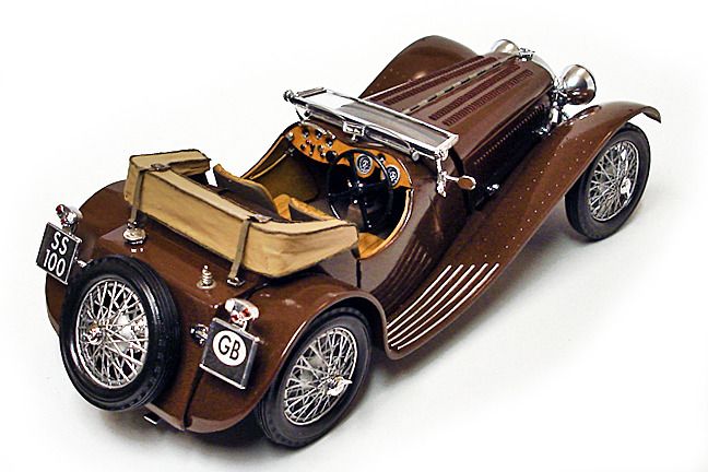

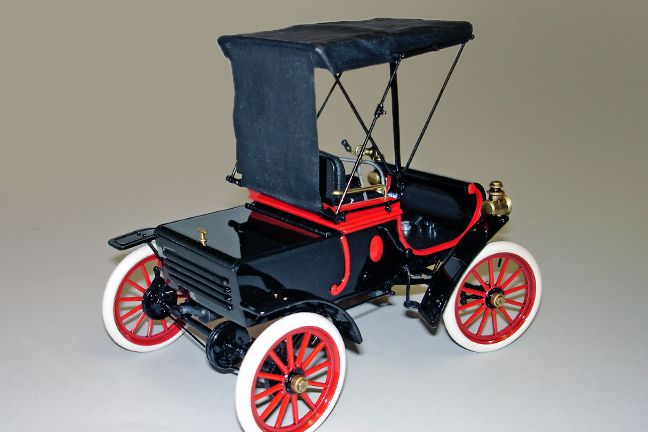

Harry P. Posted July 4, 2016 Posted July 4, 2016 Pledge Floor Care (sold previously as "Future") is nothing more than clear acrylic. Some people, like Bill Geary, for one, use it as a barrier between the kit's bare plastic and the color coats, to prevent any bleed-thru. It certainly can't hurt. And since Pledge Floor Care is simply clear acrylic, you don't need to wait a week for it to dry. It'll dry a lot quicker than that. I actually use it as my final clear coat on top of the paint. I brush it on. Works great (for me, at least!). All of these models feature a Future clear coat...

Harry P. Posted July 4, 2016 Posted July 4, 2016 Harry, those are some great builds! How about showing one on a nice wooden base (hint hint)? Ray... not sure if this is the one you made for me, but in any case... Pocher on a base! And yes, Future clearcoat...

Harry P. Posted July 5, 2016 Posted July 5, 2016 A few more, all clear coated with "inferior" Future...
