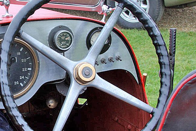

peteski Posted July 12, 2016 Posted July 12, 2016 On 7/11/2016 at 7:50 PM, Harry P. said: My reference photos show four switches on the right side of the dash, not three... so I was going to sand the dash face smooth anyway and scratchbuild the four switches. But still, ejector pin marks on the face side of the dash is inexcusable. This to me looks like a perfect candidate for a natural-brushed-metal dash. I would sand the plastic dash smooth then take some real aluminum duct tape (not the cheap stuff). Use something like 400 or 600 grit wet/dry paper (before you apply it to the dash) and using same-direction strokes make it look like brushed aluminum. Then stick the tape onto the dash and trim it. It will look just like the 1:1 in the photo above.
