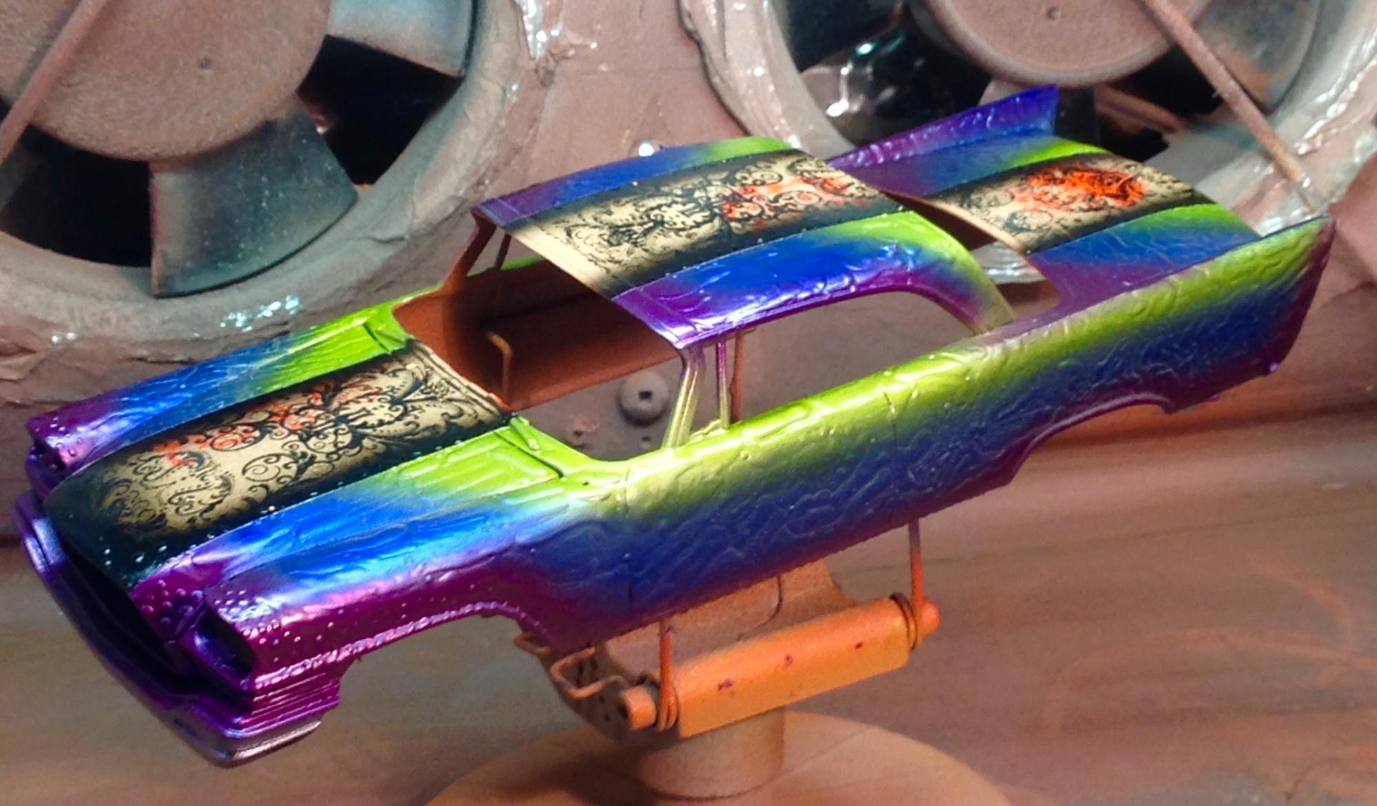

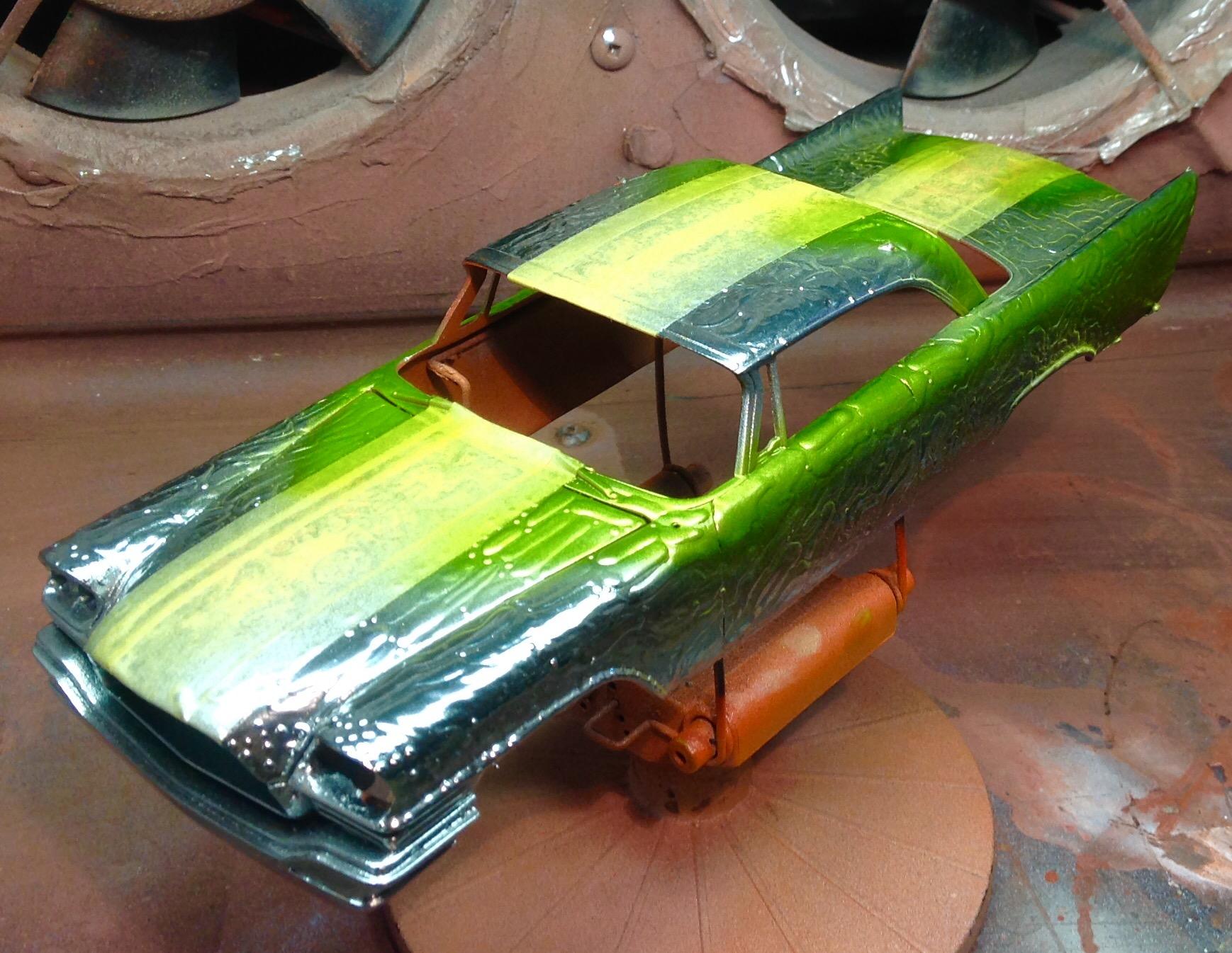

Rider Posted September 27, 2016 Author Posted September 27, 2016 j Lots of BLAH_BLAH_BLAH_BLAH in the paint. Totally forgot to clean/vacuum the booth. Meh, nothing wetsanding and clear coat can't fix. Well that didn't go so well. I'll give it another go once I get it stripped. Finally decided to go with a Monarc butter fly inspired design. The colours seem fitting given it's Autum and Halloween is on the way. The base colour, Zero Florecent Orange, over Zero paint Gulf Orange. I messed around a bit today. I added on some watch bits as stencils, looks like I need to come up with a better method of attaching them. I used tiny bits of blue tac. I didn't put too much effort into a solution in to how to attach them as they are only be an under lay. They will be covered with a black lace transfer. I think if I were to use them as a detail feature I might attach them with fish glue then remove it with water when it was time to remove them. 3hrs in total to apply all the latex. Tried the lace transfers for the first time. They have some great potential.

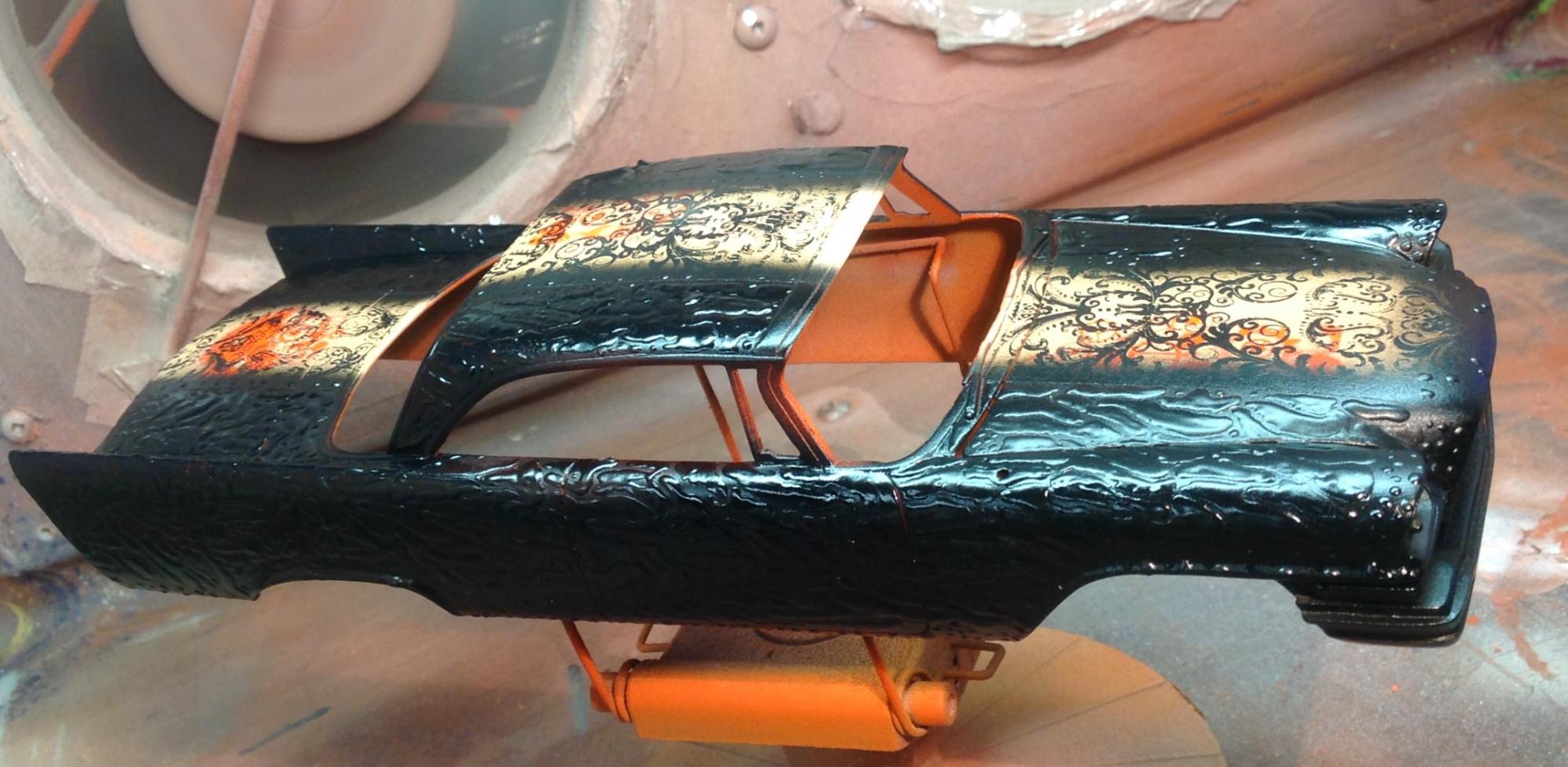

Rider Posted September 27, 2016 Author Posted September 27, 2016 Black Tamiya Acrylic, sealed with 3prt poly. Next will be Spaz Stix Chrome. Then a pearlescent fade of three to four colours topped with a holographic clear.
DumpyDan Posted September 27, 2016 Posted September 27, 2016 Very cool, like the custom. Really like you putting the gears on the body, how did you hold them in place? Did you make it to the Toronto model show last weekend?

JollySipper Posted September 27, 2016 Posted September 27, 2016 Hey, Friend....... This is gonna be cool when done! Can you tell us more about the lace transfers? Where you got them, are they dry transfers or stickers? What clears can you use over them?Thanks!

Rider Posted September 28, 2016 Author Posted September 28, 2016 (edited) Dan, I used tiny,tiny bits of Blue Tac to hold on the gears. Sorry man missed that question. Thanks Jolly. I got the transfers of eBay, I just searched nail transfers. As for what clears can go over them, no idea, I used 3prt poly. Given it is meant for nails I would imagine it can handle some hot lacquers. To transfer them you first have to apply a liquid adhesive. Once it sets up, becomes tacky, you apply the transfer. Thanks John, it's only one car, the purple/silver combo failed, so I stripped it in brake fluid. No real plans other then redo the paint, and reassemble it, the engine is what ever Hemi that came in the kit, which I believe is a 392. Your build sounds fantastic John, feel free to post up a link or pics up here. So so this is where I am for now. Have to wait a few days for the paint to gas out and completely dry before the latex can be removed without concern of any flakes sticking to the underlying paint. Going to very interesting to see how it all looks once the latex is removed and the clear goes down. Edited September 29, 2016 by Rider
