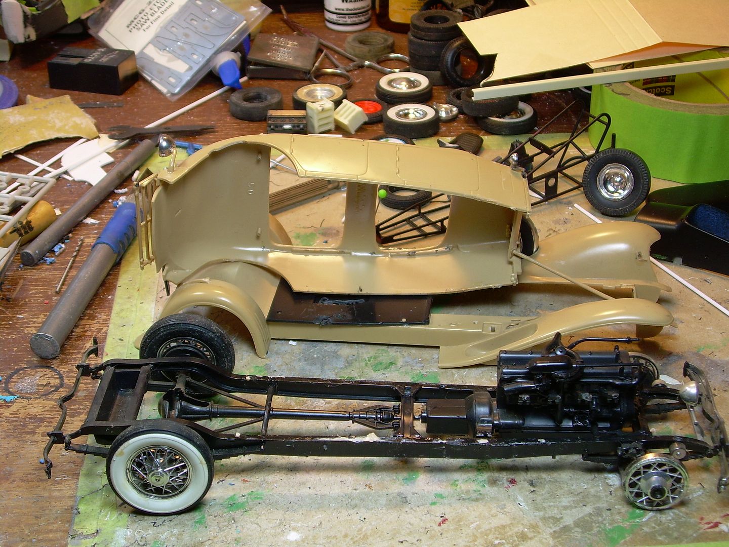

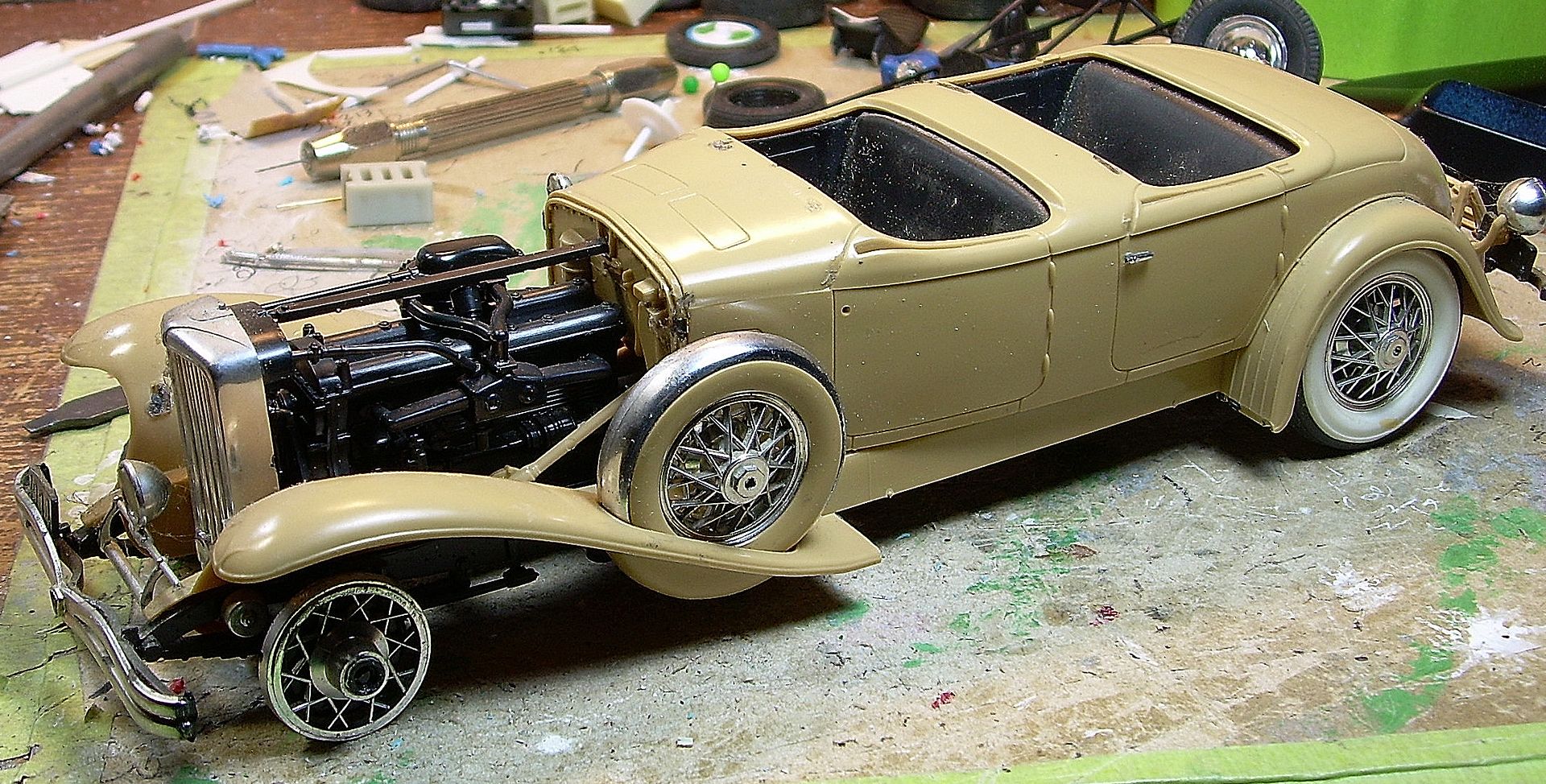

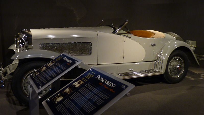

Ace-Garageguy Posted July 17, 2016 Posted July 17, 2016 (edited) I fell in love with Gary Cooper's SSJ many years ago when it went through a local vintage and exotic dealer's showroom that I did occasional work for. Since then, it's been in the back of my mind, and having acquired several built-up Duesenberg models cheap over the years, I decided to see about doing one in scale. Far as I know, only two 1:1s were ever built, and they're on a 125" wheelbase, much shorter than the standard 142.5" and 153.5", and a lot more nimble. It was expensive back then, but nothing like the crazy money it's worth now...and I got to drive it. Not far, but enough. I like the stronger color separation of this one better though, and will probably go that route, with some other not "correct" mods for Coop's car, including disc wheel covers. The starting point is a not-too-bad g-bomb dual-cowl phaeton I picked up at the last local NNL thing for a very few bucks. It's this kit. First order of business was to get the body and fenders off the frame, and separate them with minimal damage. Then, to measure the wheelbase and decide how much to cut out of the chassis and where. Edited July 17, 2016 by Ace-Garageguy

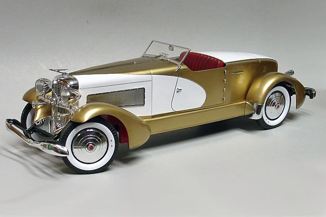

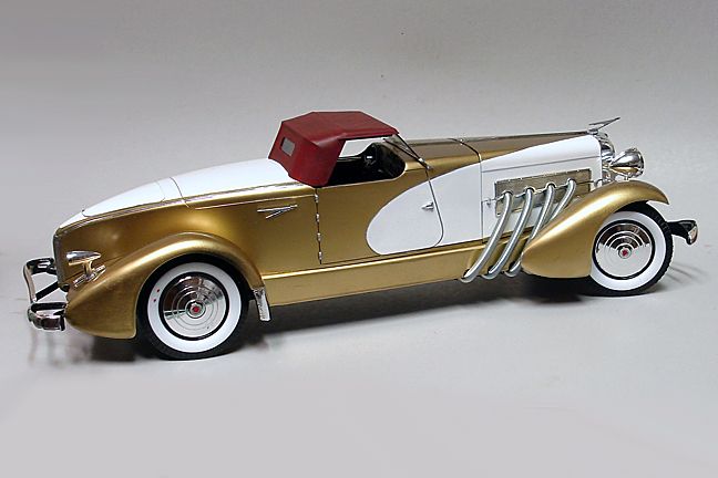

Art Anderson Posted July 19, 2016 Posted July 19, 2016 I kitbashed the Gable "SSJ" back about 1979-80 or thereabouts, and yes, the Weymann Torpedo Phaeton's rear "deck" combined with the forward "cockpit" of the Torpedo Phaeton is a great place to start on the project! I also have a couple of Danbury Mint's SS-J's, which are the Gable Car (Gary Cooper's car has more "bobbed" rear fenders). FWIW, the engines in those two 125" cars were the same as Augie Duesenberg built up for Ab Jenkins' 'Mormon Meteor--having a two-stage supercharger coupled with dual carburetors on "rams horn" intake pipes---for a HP rating of 425hp from 420cid, making the two SSJ's and the Meteor (which was streetable with fenders, bumpers, lights and windshield installed) the first production automobiles with engines producing more than 1hp per cubic inch--22 years before Chevrolet tried to claim that title for their 283 Fuelie!.Art

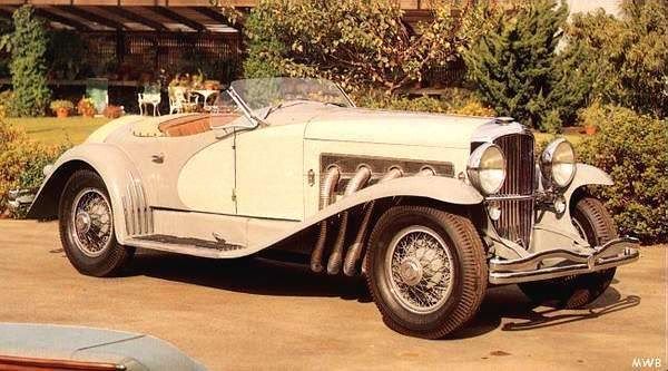

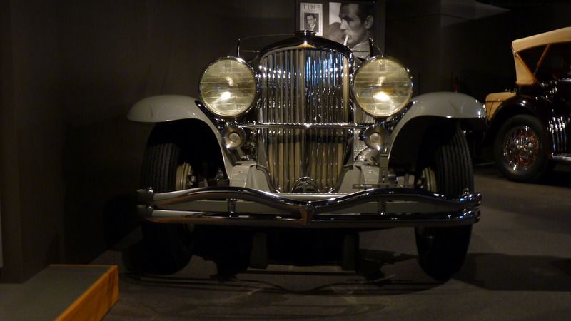

jaymcminn Posted July 20, 2016 Posted July 20, 2016 The Cooper car resides locally at the Revs Institute, formerly the Collier Automotive Museum. It is breathtaking in person. Note the lack of any sort of ropes or barriers to keep you away from the cars. You can really get up close and personal with some of the most important performance cars of the last 115 years. Cant wait to see how this one turns out... great start so far!
