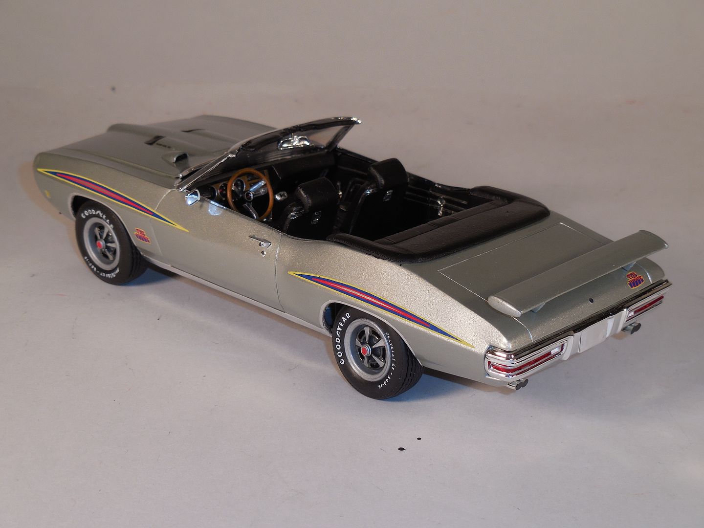

Sport Suburban Posted July 20, 2016 Posted July 20, 2016 It might fit the original '70 GTO body better. It won't fit the current '72 body any better. See the link I posted above for detailed measurements. The issue you need to look into is this kit. I have 4 of this kit and it's bumper is smaller and fits the bodys very nicely! For comparison I have two original issue 1971 GTO's, and 4 of the 72 issues, oldest one is red and molded in the 80's, two grey ones from 2004 and a new one in orange. I don't have any original 70 kits and your only reference is from a 70 promo. I'm not saying that you are wrong just that the last 88 issue of the 70 GTO has a smaller bumper. Here is a 70 I just finished. The body is not widened and the bumper is unmodified.

Snake45 Posted July 20, 2016 Posted July 20, 2016 The issue you need to look into is this kit. I have 4 of this kit and it's bumper is smaller and fits the bodys very nicely! For comparison I have two original issue 1971 GTO's, and 4 of the 72 issues, oldest one is red and molded in the 80's, two grey ones from 2004 and a new one in orange. I don't have any original 70 kits and your only reference is from a 70 promo. I'm not saying that you are wrong just that the last 88 issue of the 70 GTO has a smaller bumper. Here is a 70 I just finished. The body is not widened and the bumper is unmodified. Well I checked out my 70 kit and I owe you an apology--you were right and I was wrong. The bumper in that kit IS narrower than any of the others I measured. Didn't even get out the dial calipers, you can see the difference easily with the naked eye. It still seems just a hair too wide for either the '70 or the recent '72 bodies, but not enough that you'd really notice it if it weren't already a known issue, and prolly not enough to modify. The '70 body seemed just a hair wider across the back than the current '72, but I didn't actually measure them so can't say. But you're right, the bumper from that kit would work and look a lot better than what's in the '72s.

Sport Suburban Posted July 20, 2016 Posted July 20, 2016 Well I checked out my 70 kit and I owe you an apology--you were right and I was wrong. The bumper in that kit IS narrower than any of the others I measured. Didn't even get out the dial calipers, you can see the difference easily with the naked eye. It still seems just a hair too wide for either the '70 or the recent '72 bodies, but not enough that you'd really notice it if it weren't already a known issue, and prolly not enough to modify. The '70 body seemed just a hair wider across the back than the current '72, but I didn't actually measure them so can't say. But you're right, the bumper from that kit would work and look a lot better than what's in the '72s. Thanks, but no apology needed. I don't know why that kit has a smaller rear bumper but it looks great to me on the 71 and 72 kits. I don't have any other versions of the 70 GTO to check but I always wondered why that kit was different.
Kmb0319 Posted September 15, 2016 Author Posted September 15, 2016 The issue you need to look into is this kit. I have 4 of this kit and it's bumper is smaller and fits the bodys very nicely! For comparison I have two original issue 1971 GTO's, and 4 of the 72 issues, oldest one is red and molded in the 80's, two grey ones from 2004 and a new one in orange. I don't have any original 70 kits and your only reference is from a 70 promo. I'm not saying that you are wrong just that the last 88 issue of the 70 GTO has a smaller bumper. Here is a 70 I just finished. The body is not widened and the bumper is unmodified. WOW!!!!! That's one amazing GTO!!! I'd love to see some more pics of this baby.
Sport Suburban Posted September 16, 2016 Posted September 16, 2016 WOW!!!!! That's one amazing GTO!!! I'd love to see some more pics of this baby.http://www.modelcarsmag.com/forums/topic/115427-70-gto-judge-convertible/#comment-1666924
