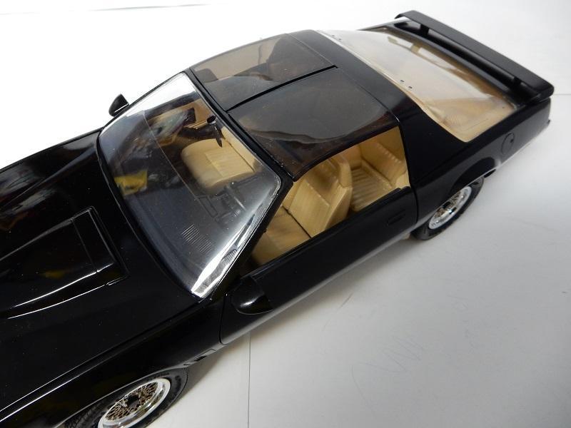

pack rat Posted July 25, 2016 Posted July 25, 2016 The clear T-tops on this T/A were tinted with Tamiya TS-71 (three coats).
