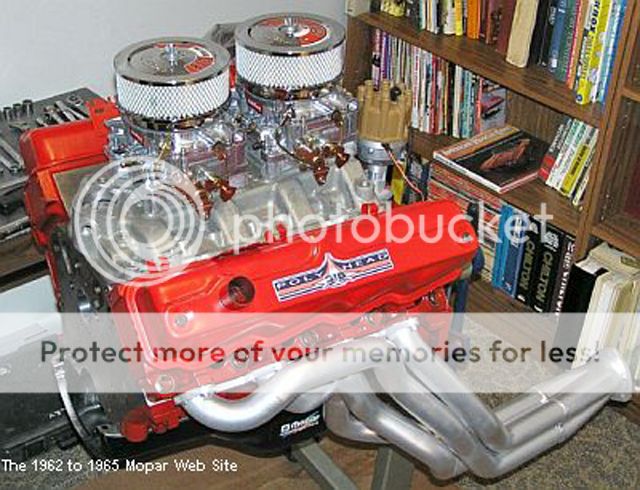

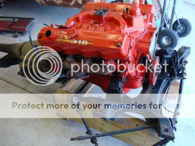

426-Hemi Posted December 30, 2016 Posted December 30, 2016 (edited) Also please note, those Poly-Head heads and valve covers were NOT the "Hemi-version" of the Poly. those were of the following: 241, 259, 270, 301, 315, 325, 331, 345, 354 looks of all the "Poly-Head" engine, which is what these looks like: EXCEPT the 277 and 318. Those 2 engines looked EXACTLY the same as this: ALL of the Poly-Head engines could in fact be fitted with Hemi-Heads, EXCEPT the 277 and the 318, They remained Poly-Headed engines only, from the day they were created. The 392 Hemi was thee only "A" Block to not be fitted with Poly-Heads... As it was a whole "other" engine block casting, as it was a raised Block, and had a higher deck height then the other A block engines, keeping it a Hemi from the day it also was created! Edited December 30, 2016 by 426-Hemi Added content
Force Posted December 31, 2016 Posted December 31, 2016 (edited) Well the Hemi based Poly Head engines were not from the "A" family, they were Hemi blocks with single rocker shaft polysferic heads to make them cheaper than the Hemi's.The Chrysler Spitfire (1955-58) 301-331-354 cu in were based on the Low Deck 331-354 Hemi, there were no poly-head version of the later Raised Deck 392 Hemi as you said.The Dodge Red Ram (1955-56) 241-259-270-315-325 cu in were based on the 241-325 Hemi, they did Poly Head engines both of the Low Deck 241-270 and the raised deck 315-325.The Plymouth Hyfire (1955-56) 241-259 cu in were also based on the Dodge 241-270 Low Deck Hemi's,No Poly Head engines were based on the DeSoto 276-291-330-341-345 cu in Hemi, the few DeSoto's with Poly Head engines had Dodge Hemi based engines.The Polysferical Head (1956-67) 277-301-303-313-318-326 cu in was the "A" family engine and shares no parts with the older Poly Head and Hemi engines and was replaced with the "LA" and "B/RB" allthough they were manufactured simultaneously for a while. Edited December 31, 2016 by Force
