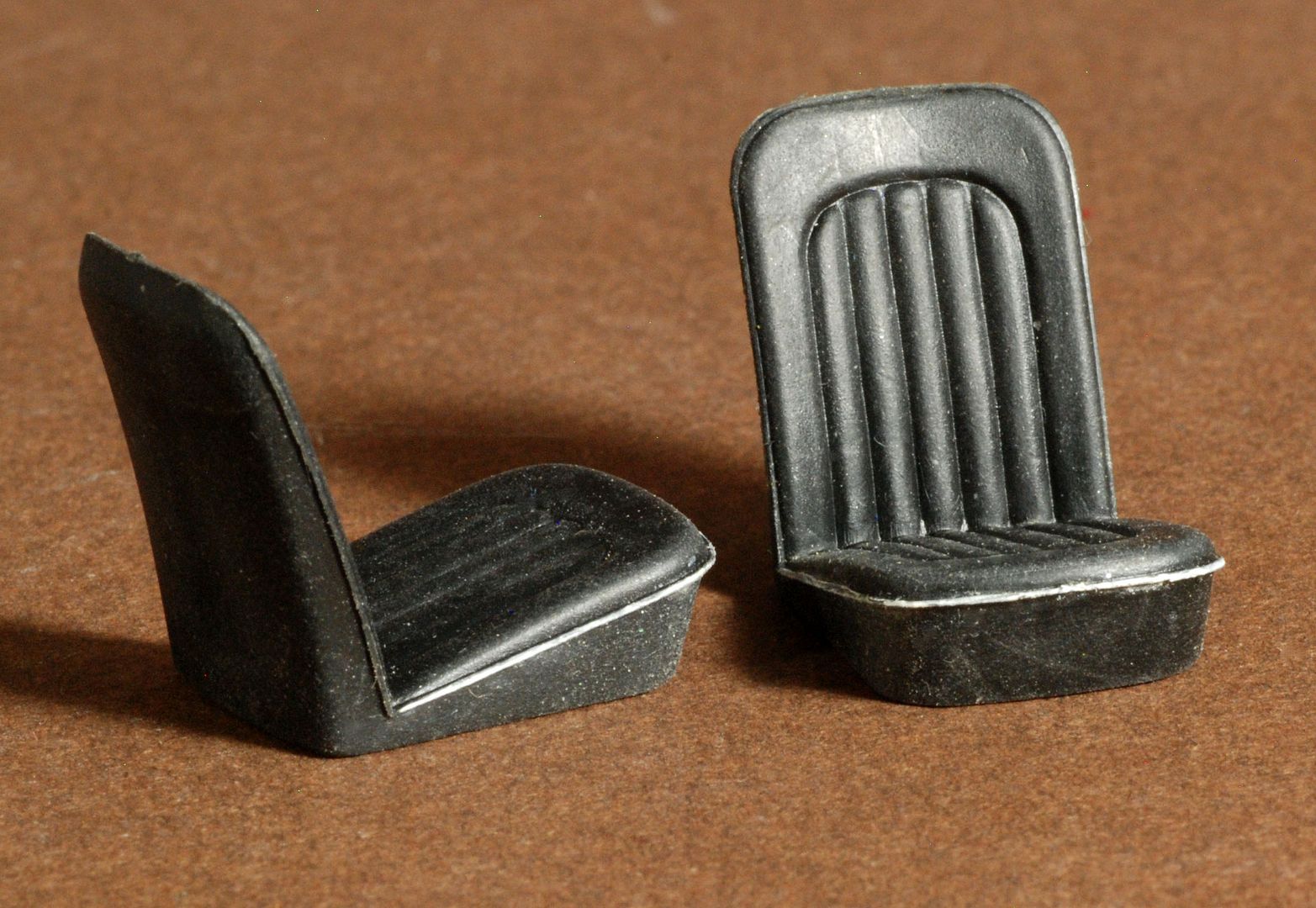

Foxer Posted September 12, 2016 Posted September 12, 2016 I just got back from a long trip to my daughter's wedding, so I'll have to post photos later, but I needed something to paint the white piping around some black rubbery seats and tried a Gelly Roll white gel pen. I could easily draw around the raised thin edge of the molded on seat piping and was very OPAQUE! I was surprised how visible the white gel showed up on the black black seats.I would definitely recommend trying some Gelly Roll gel pens.

Foxer Posted September 12, 2016 Posted September 12, 2016 here's the rubber with one pass with a white Gelly Roll gel pen ...
Snake45 Posted September 12, 2016 Author Posted September 12, 2016 Wow, not bad at all! I'm going to have to try one of those.
