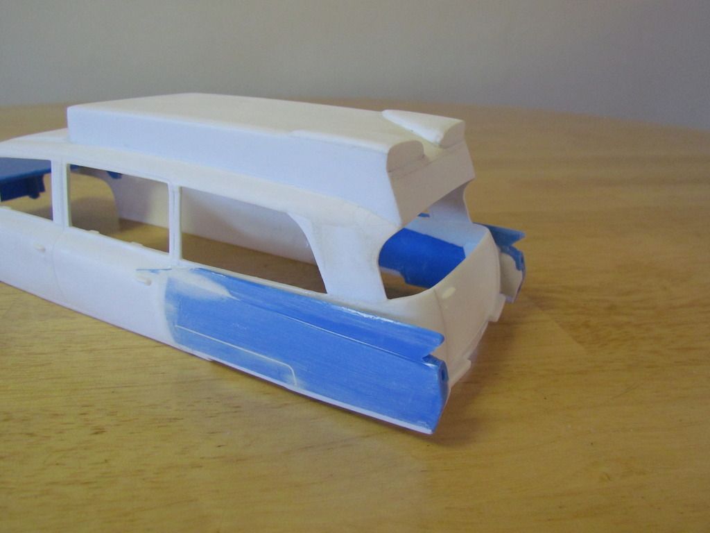

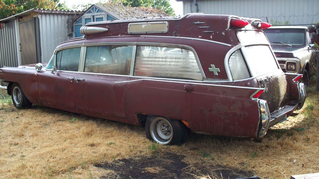

crowe-t Posted August 5, 2016 Author Posted August 5, 2016 (edited) So acetate is tougher than the styrene? I'm building a 1964 Cadillac ambulance using a Polar Lights Ecto-1 and a Jo-Han 1964 Cadillac Deville. The Ecto-1 windshield is OK so I'll use it but the rest of the windows aren't so good and almost act as magnifiers. I want to make the side and rear windows. Most of the windows are flat that I'll be making and the rear window will have a very slight curve. The small side rear windows are curved. The 2nd picture of the rear ambulance shows the small side rear windows. Will clear styrene be better for making the curved small side rear windows? Edited August 5, 2016 by crowe-t
MrObsessive Posted August 5, 2016 Posted August 5, 2016 (edited) No, I'd still use the acetate. That's a simple curve meaning it's not compound.........you shouldn't have any problem bending that. It's best to make some kind of template using perhaps a 3x5 card and then transfer that onto the acetate.And yes, the acetate is a bit tougher as I've found it not to scratch so easily as styrene. IMO, the acetate reflects the light better giving the appearance of actual glass as opposed to styrene.If you need any tips on holding the acetate in place, you can go here. Scroll down a bit, and you'll see what I did to the Turbine Car to get the glass to stay in place. Edited August 5, 2016 by MrObsessive

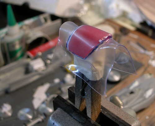

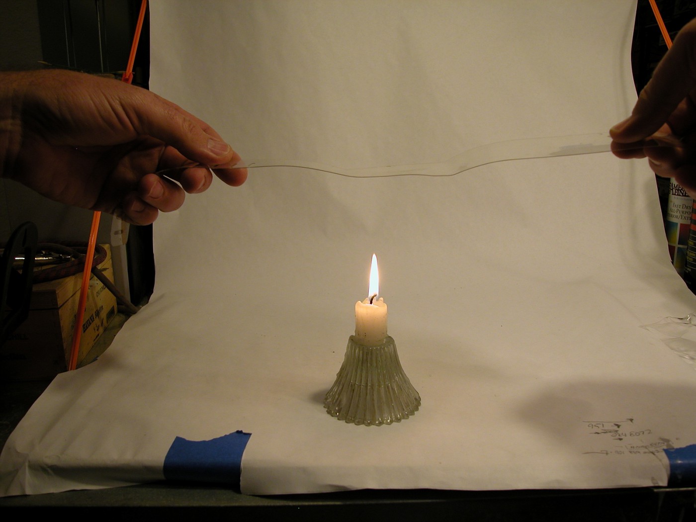

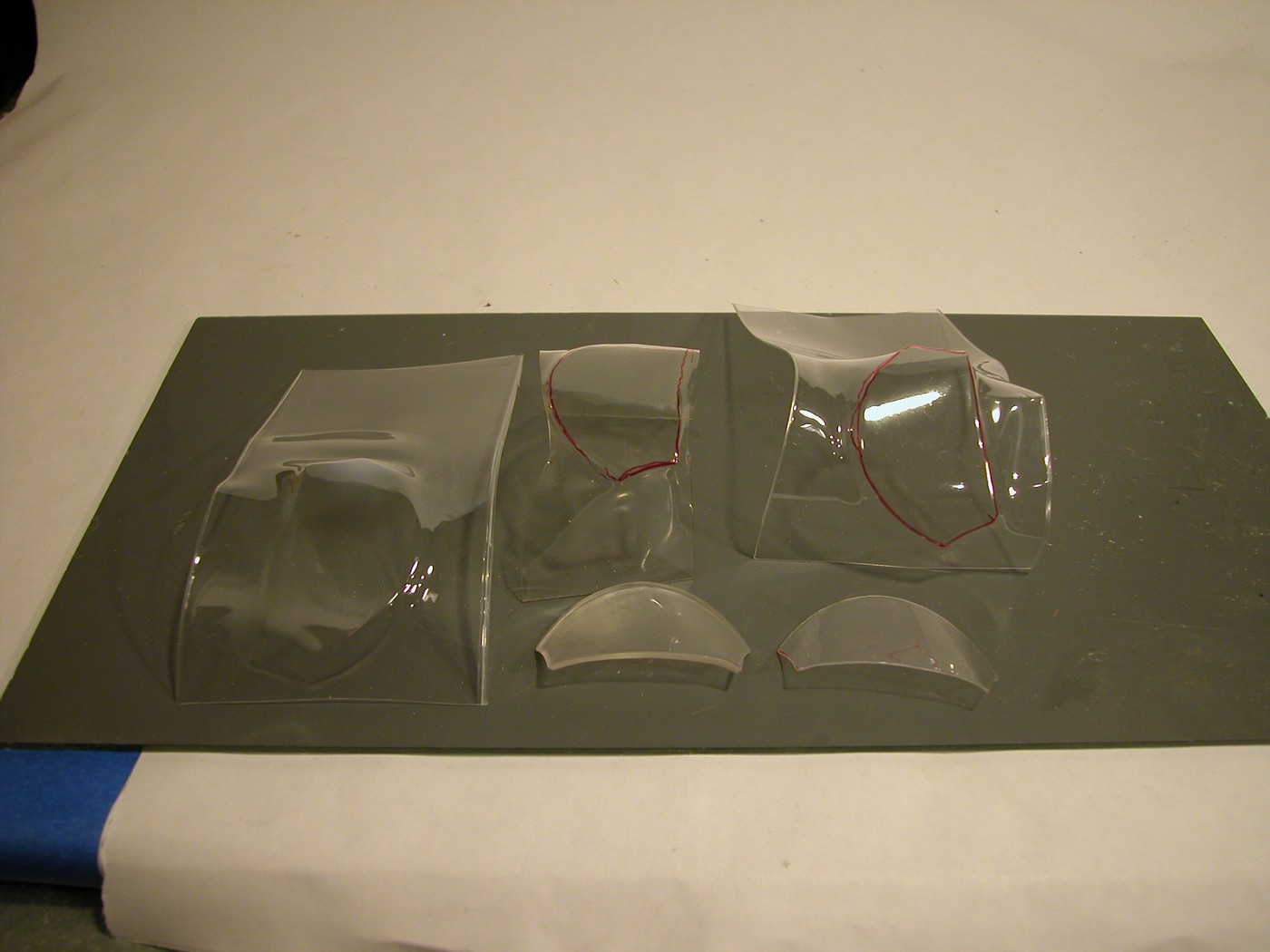

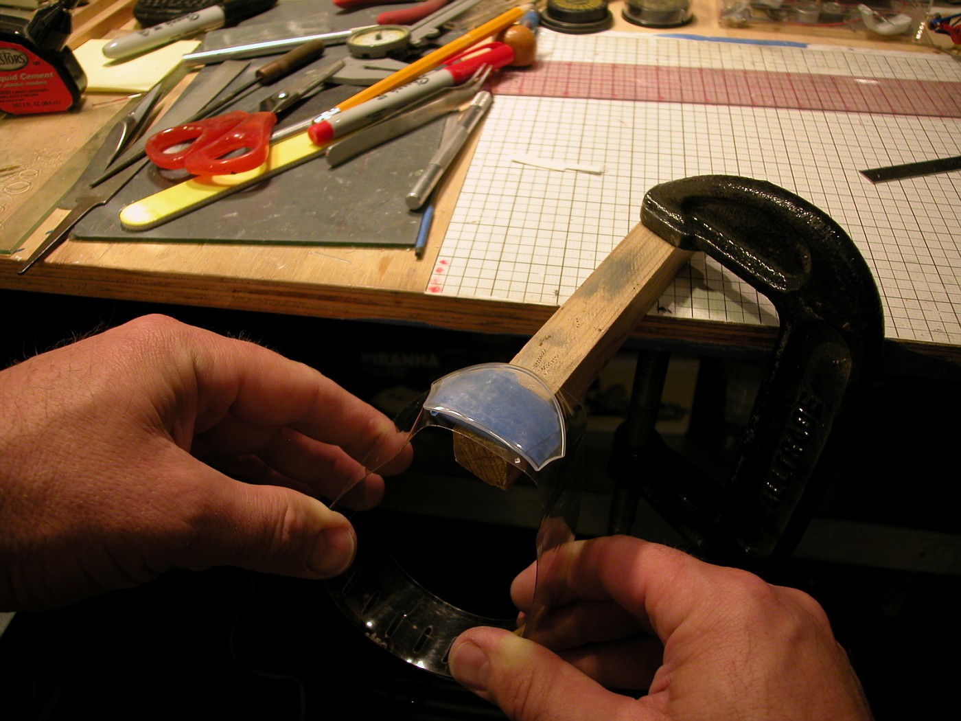

Scott Colmer Posted December 15, 2016 Posted December 15, 2016 (edited) I'm with Mr. Snake. I scavenge clear plastic wherever I can. Right now is the season for clear box covers. The plastic in new shirt colors works well too. If you need a compound shape you can use the original kit glass and form it using heat. I tried using Evergreen clear plastic, but it is too touchy. In the pics below I used plastic taken from a box of christmas cards. Step 1 - Secure your buck. That's what you are going to use to shape the windshield. Step 2 - Heat the plastic over a flame until it sags a bit. You may waste some before you get the right softness. Hosted on Fotki Step 3 - Pull it over your buck. Hosted on Fotki Make a few copies and try to have at least two keepers in case you over trim one when you are fitting it. Hosted on Fotki I've also use this technique to make one-off pieces like this seat that needed to flex a bit to fit in the chassis. Hosted on Fotki Scott Edited December 15, 2016 by Scott Colmer
BigTallDad Posted December 15, 2016 Posted December 15, 2016 Rather than use a candle (which can deposit carbon soot on the plastic) why not build a small alcohol burner or use a soldering iron for heating the plastic?

Snake45 Posted December 16, 2016 Posted December 16, 2016 Scott, great tutorial! I've been hearing about "heat and smash" in Model Airplane World for two or three decades but have never actually tried it myself. I do have a Mattel Vacuform which I've used occasionally for things but have never done car windows on it. I think the heat and smash might work better for that. I'm planning to try it soon, using the clear plastic from common 2-liter soda bottles. Been trying to work out a heat source.
Scott Colmer Posted December 17, 2016 Posted December 17, 2016 Good luck with it, Snake. It's pretty easy. While I like the heating upgrades suggested above, I can say the open flame has worked well for me so far.
