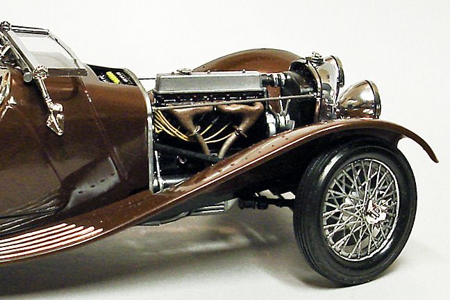

Harry P. Posted August 10, 2016 Posted August 10, 2016 Spaz Stix wheels... All chrome on this model... Grille shell... Grille shell. headlights, and wheels...
