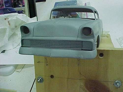

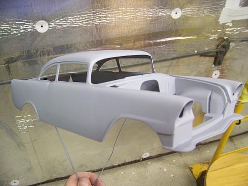

astroracer Posted August 26, 2016 Posted August 26, 2016 Good post! With the 4 door as long as you have the main ingredients there it's definitely getting the point across and probably not alot 4 door savants out there to pick out what may or may not be wrong with it in the end. I do appreciate accuracy but oftentimes it's one's own critical obsession standing in the way of completion. Exactly. I did a '56 2 door post conversion to AMT's 1/16th scale '55 Hardtop. There were so many things wrong with the original body it wasn't funny. I just bit the bullet, did the conversion so it looked good and called it a day. Mark
disconovaman Posted August 26, 2016 Author Posted August 26, 2016 Dang! Thats some awesome work there! Are you adding 56 trim as well? I'd like to see this build when it's done... I assume you glued the doors shut?

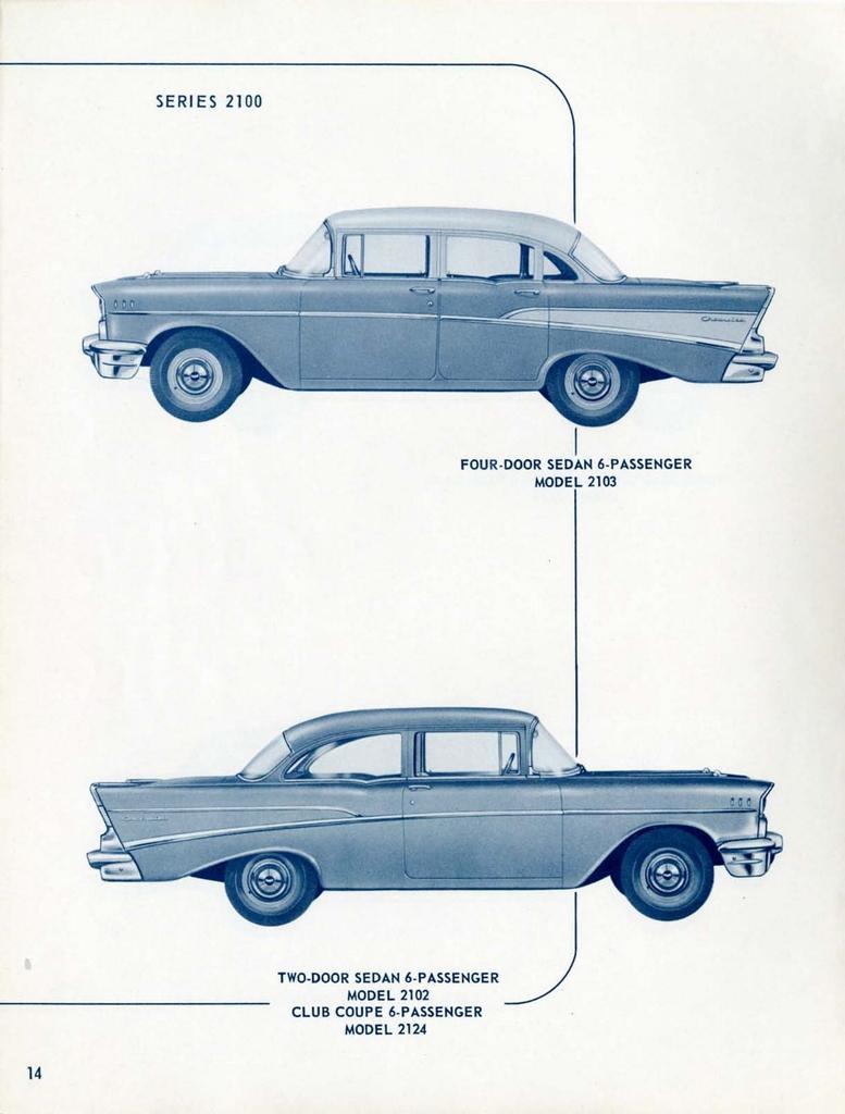

Vietnam Vet67 Posted September 2, 2016 Posted September 2, 2016 From a 57 Chevy brochure is a 4 door and 2 door side by side. This might help.
Longbox55 Posted September 2, 2016 Posted September 2, 2016 https://www.gmheritagecenter.com/docs/gm-heritage-archive/vehicle-information-kits/Chevrolet/1957-Chevrolet.pdfBody dimensions are on pages 7-17.
