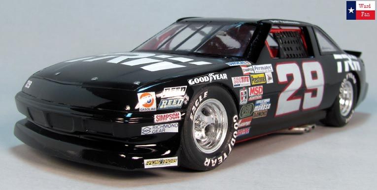

Old Coyote Posted August 31, 2016 Posted August 31, 2016 (edited) I prefer the Revell/Monogram kits over the AMT kits for a trio of reasons. As mentioned, the tires and wheels were more in line with the Bassett and Aero wheels which were being used in Nascar at the time. Second, I felt the Monogram engines were much more representative. And third, AMT never refined its chassis/roll cage to reflect the changes that the cars were going through. There's nothing really wrong with the AMT kits, they build up rather nicely (with the exception of the rear window on the Olds Cutlass }. I just feel the Monogram kits built up into a better looking representation of a time period Nascar. MarkJ has a good idea on blocking paint and color bleed through. I'd give that a try if I were you. Monogram AMT Just my opinion, I think the Monogram looks more realistic Edited August 31, 2016 by Old Coyote
