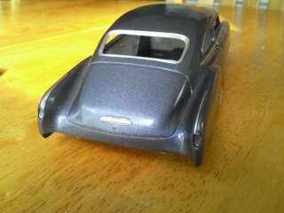

It's not to bad to do if you drop the trunk area with itThis was my first try at a chop top and it didn't turn out to bad. I had read an article in Ol'Skool Rods with Bill Hines choping a 51 and decided to try it in scale the way he did it.
And a couple with paint. I still havn't finished it yet. Maybe I'll pull it back out and finish it up.post-9652-0-44402700-1351359882_thumb.jppost-9652-0-31308700-1351359912_thumb.jppost-9652-0-93947600-1351349982_thumb.jppost-9652-0-79618500-1351350002_thumb.jppost-9652-0-83583300-1351359901_thumb.jp

Here's how it came out after a little bodywork.
