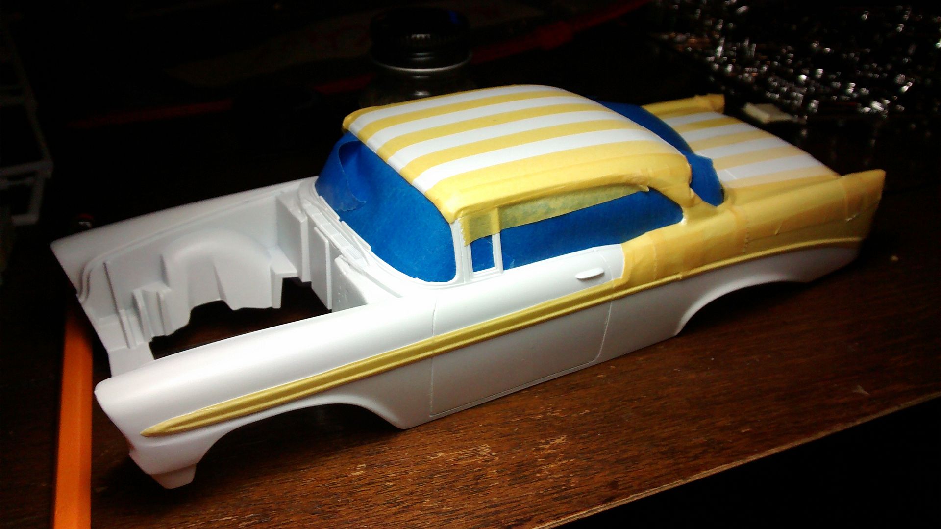

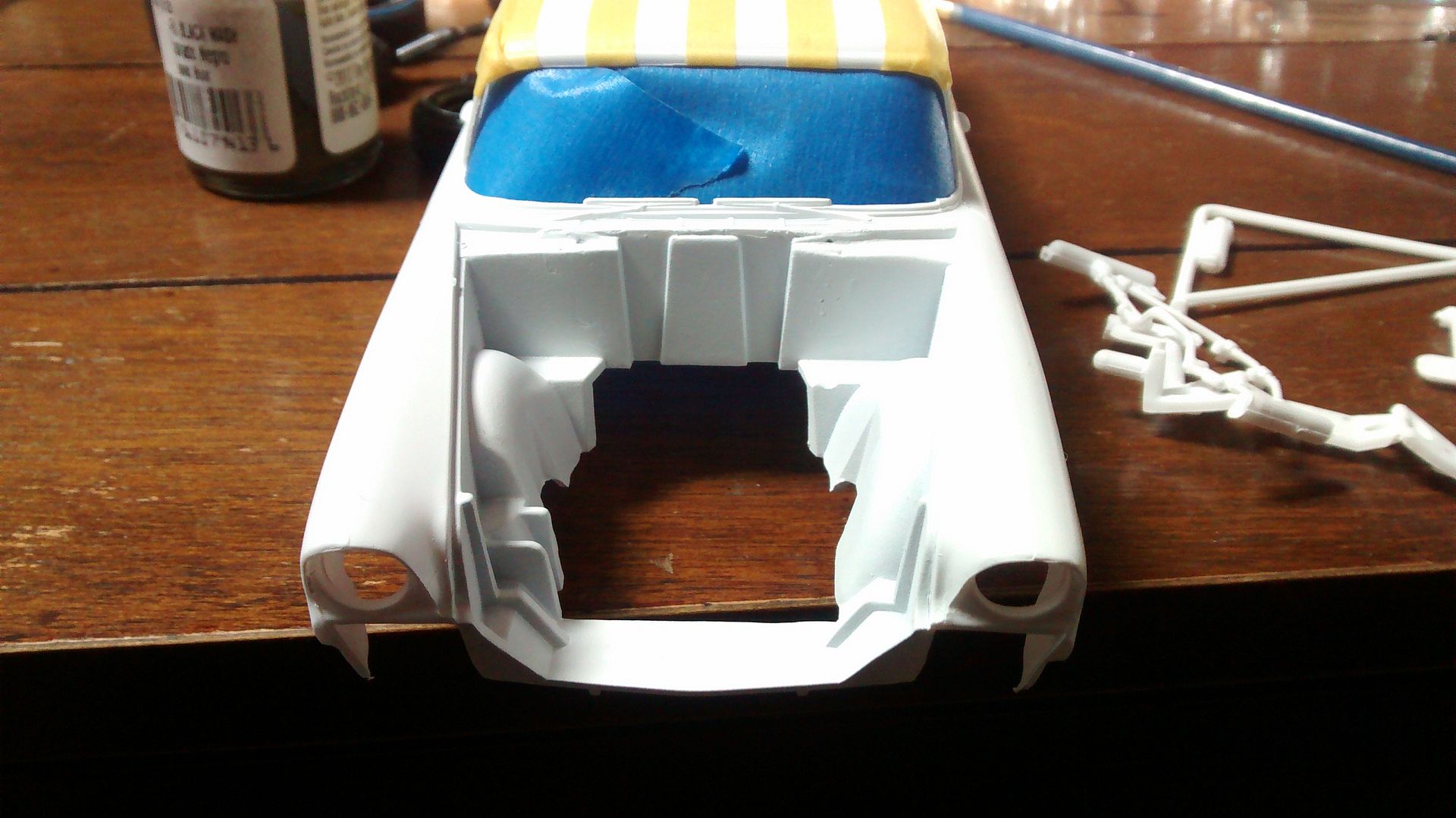

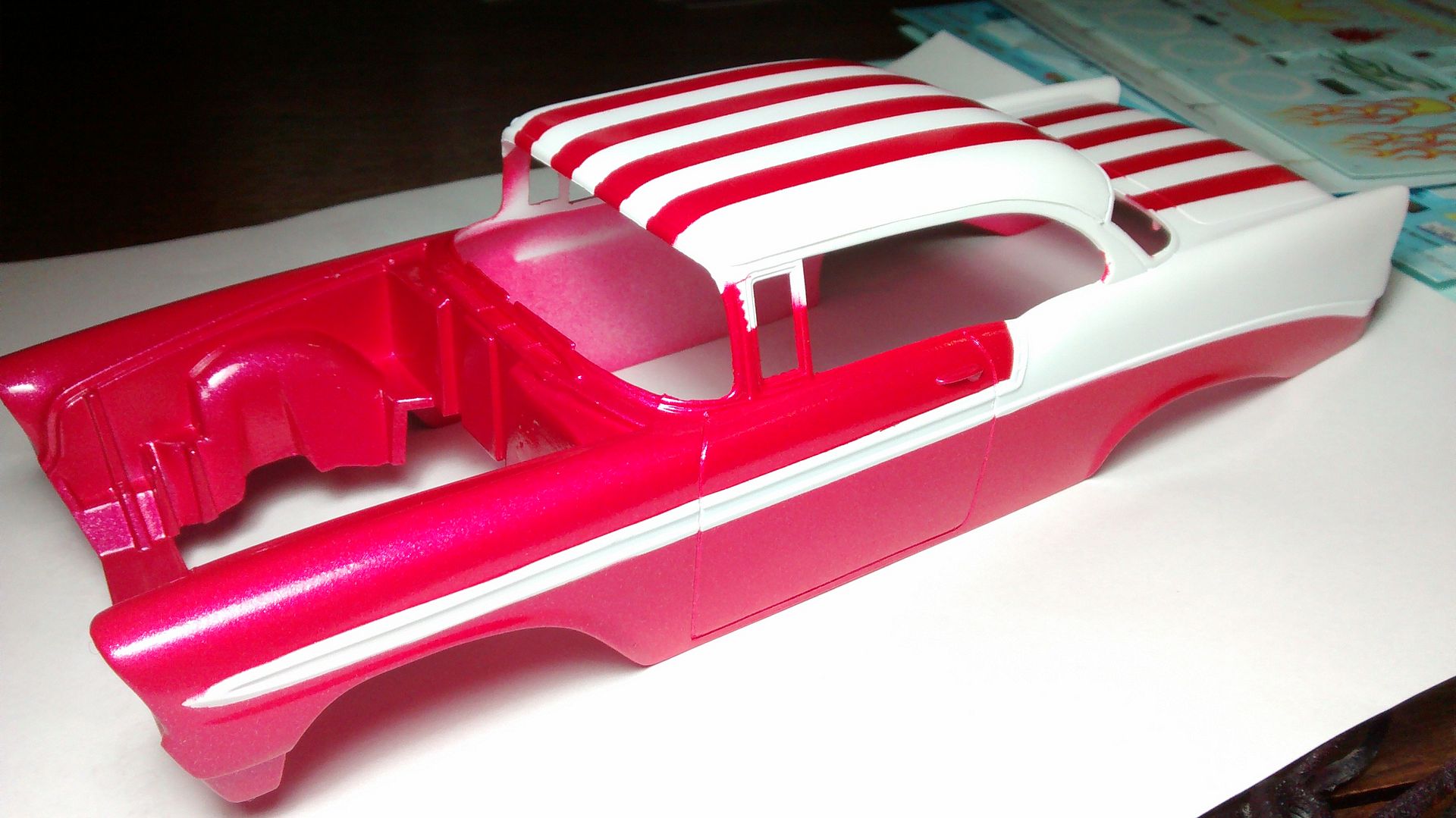

The first thing I did was cleaned up the mold lines and deepened the almost non-existent body/panel lines. After that, the huge holes for the hood hinges (say that 5 times fast lol) were filled in. After a coat of Tamiya primer, I taped off the paint theme I'm going with. To save time, I intend to just clear over the Tamiya primer. The stuff lays down so nice it's almost glossy anyway.

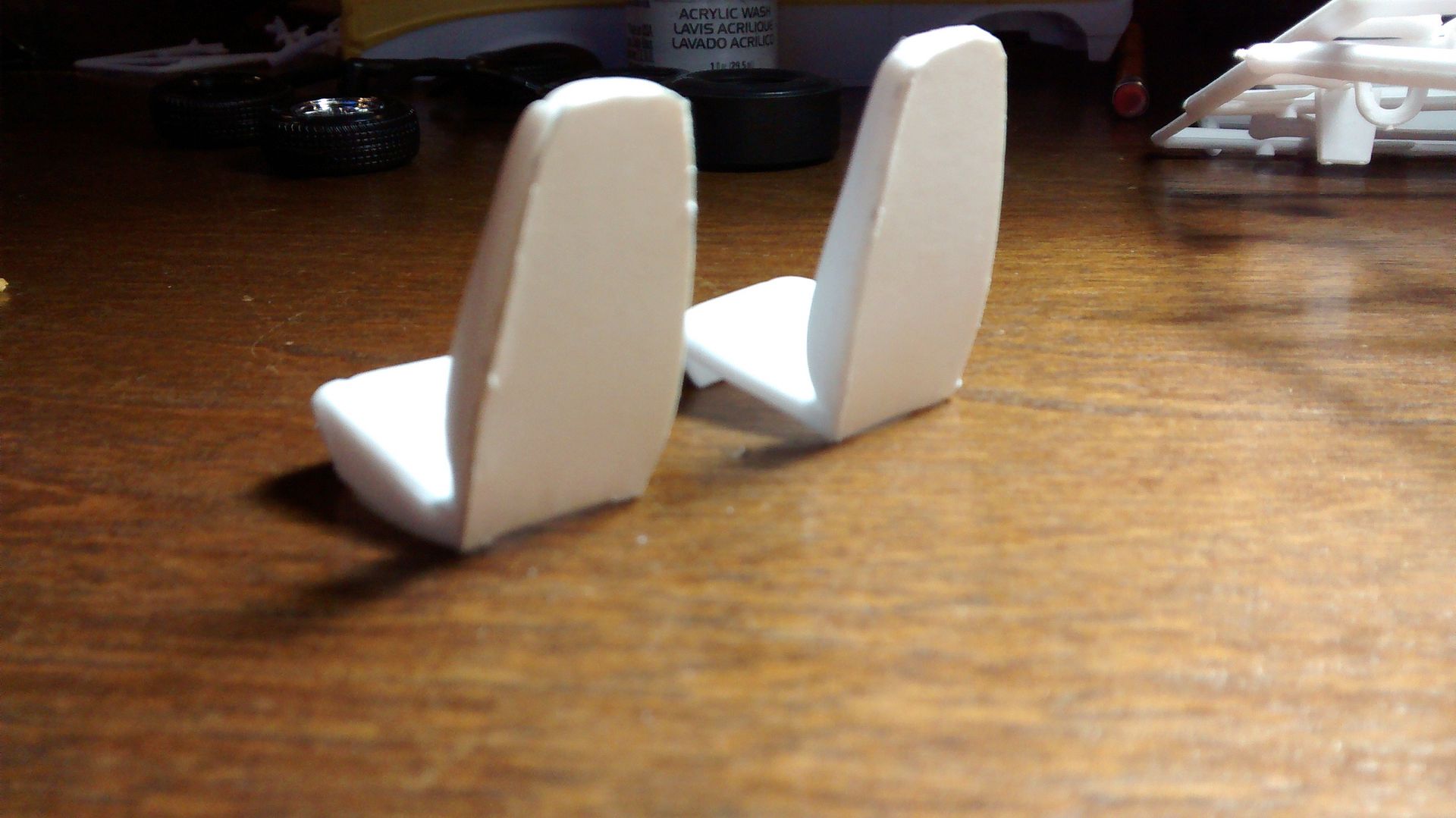

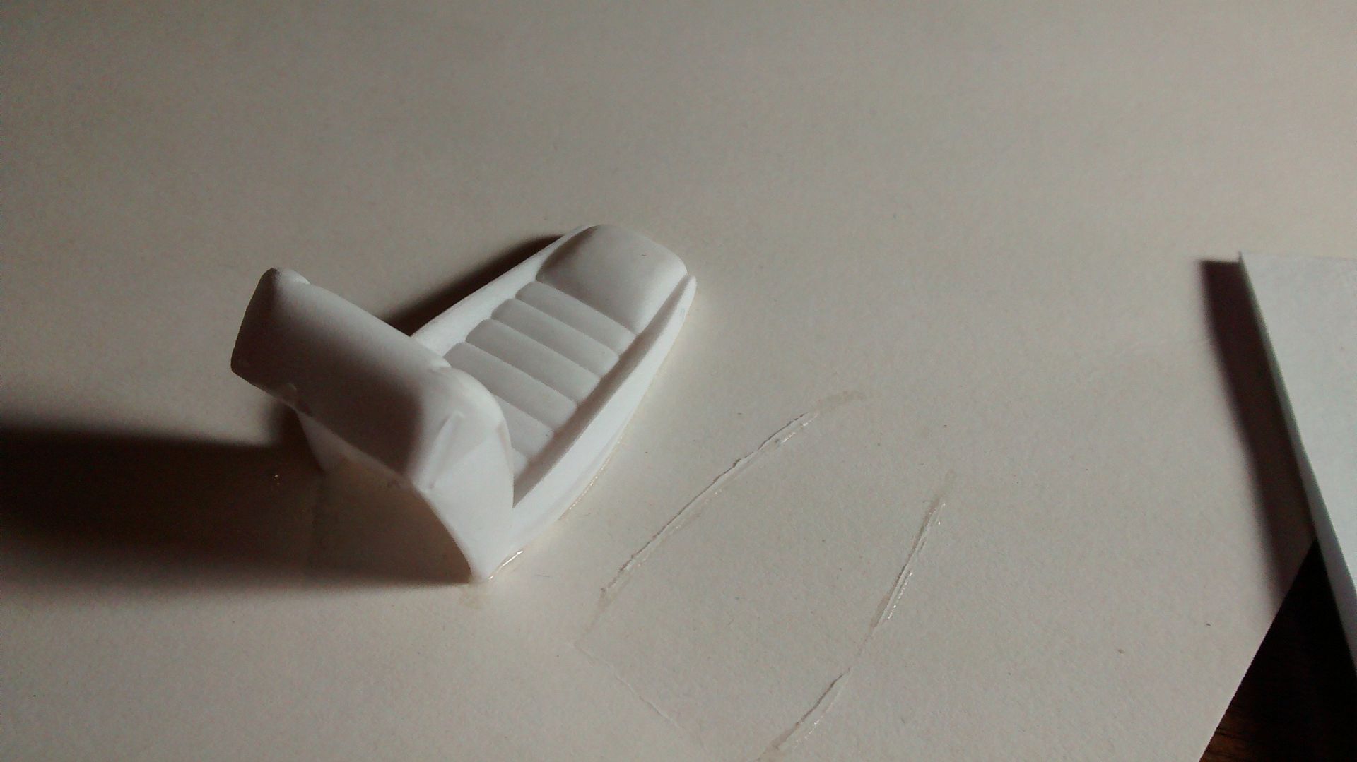

Now for those buckets. I've never encountered a problem like this, but I think I came up with an ok solution.
It was pretty simple, actually. I just glued the seats to some card stock...
Then cut them out. It's not perfect, but for someone with limited materials on hand at the moment, it'll do just fine. At least they're not hollow anymore lol

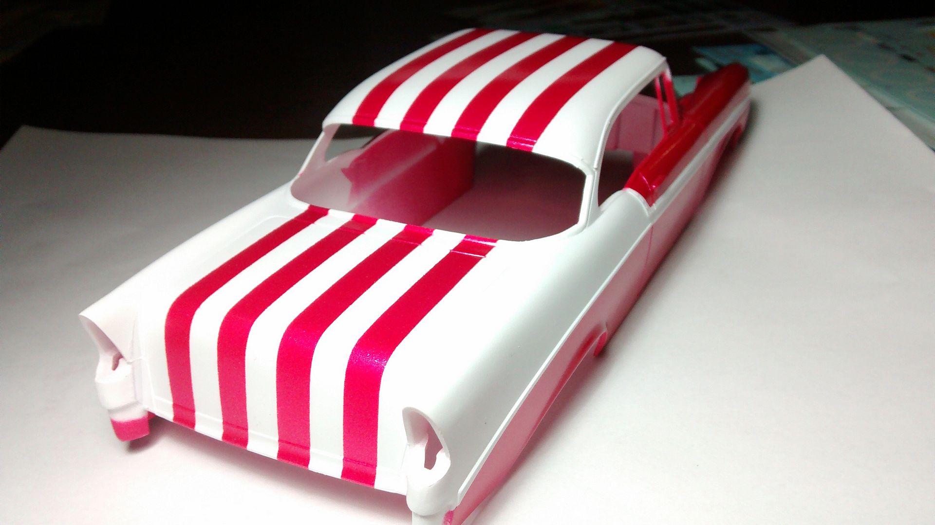

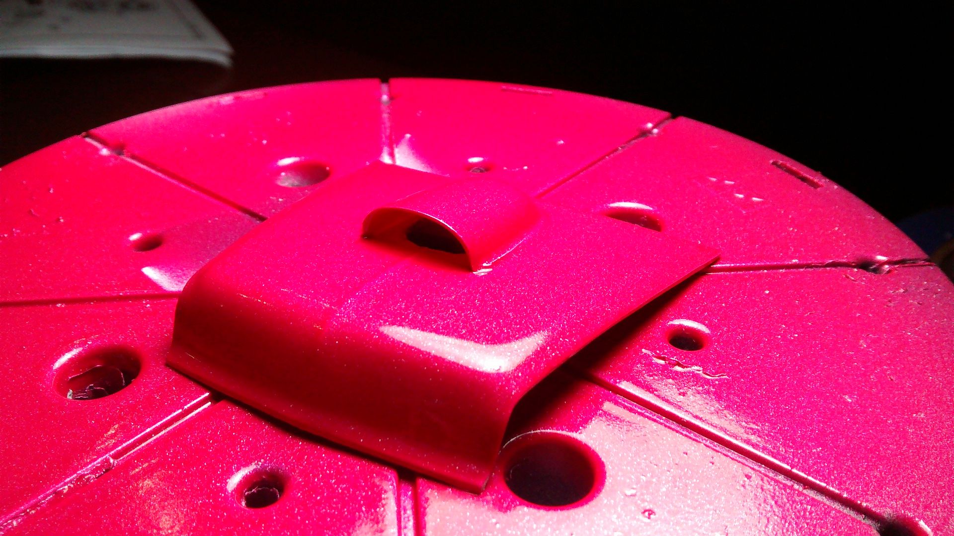

Funny you should ask, that's why I came here to post lol. The build is for a pink car themed build off due for October. My guess is for Breast Cancer Awareness Month. Anyway, I was going to go with a 50's style pastel pink, but I want this one to be kinda flashy. That's where the Testor's Electric Pink Lacquer came in. It's so bright it fools the camera into thinking it's red.

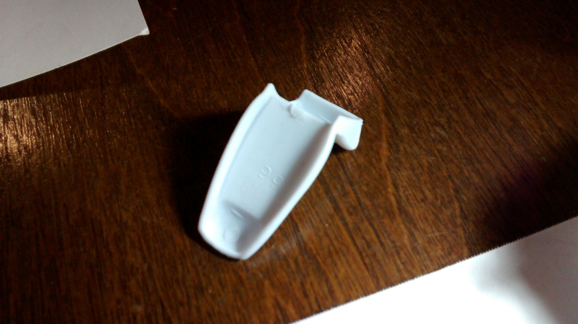

I also robbed the clear hood scoop from the 55 Chevy Street Machine (Badman) kit. I wanted to go with a flat hood, but the dual carb topped blower was acting like a hood prop. I would've loved to use the prostock style scoop included in the kit, but go figure I had to lose it. The snorkel one, also in the kit, just wasn't doing it for me.

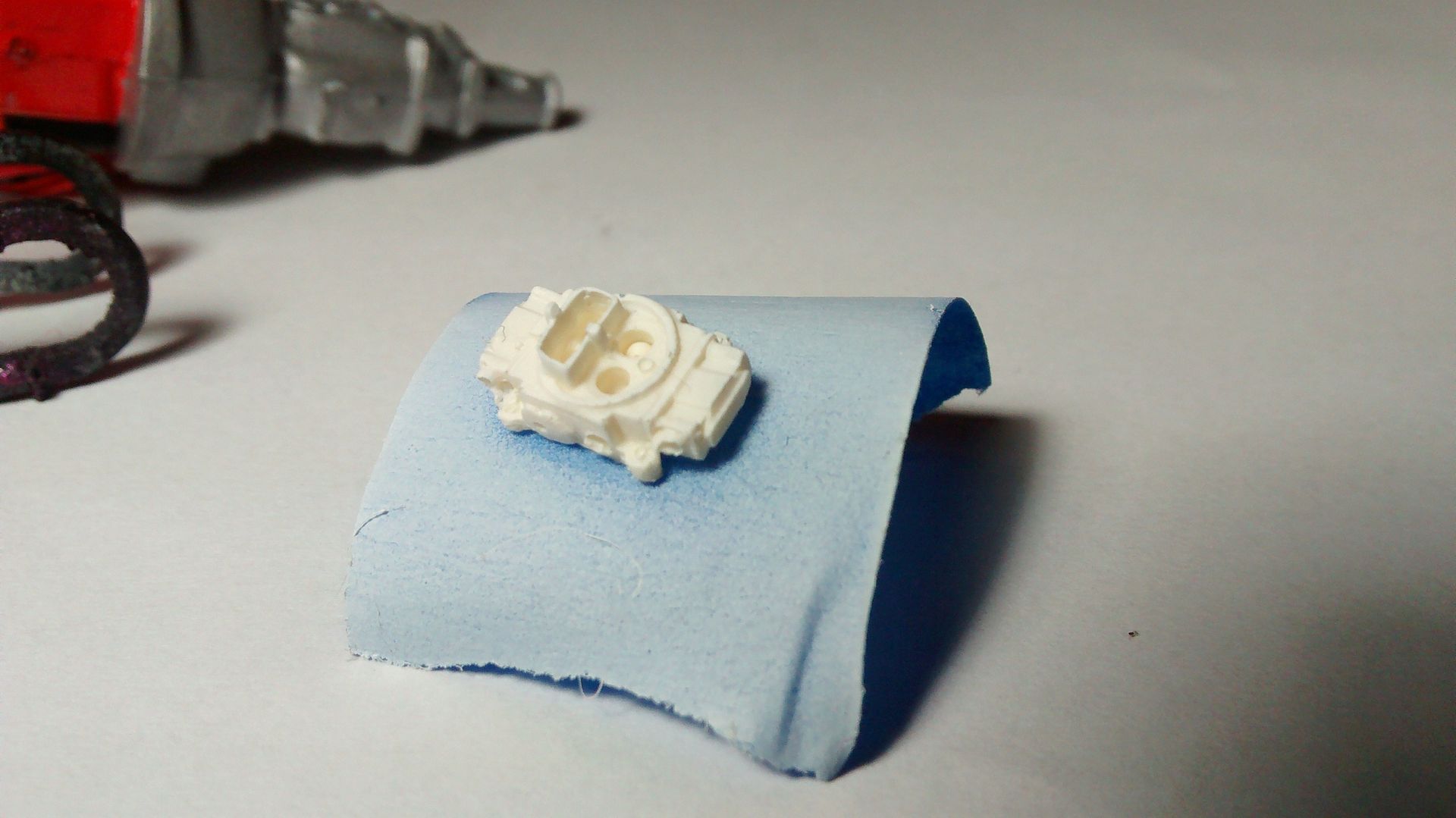

Thanks guys. Call me spoiled by newer kits, but one of the things about this kit that I don't like is the simplicity. A lot of the parts have a cartoonish appearance that just doesn't do anything for me, but it was an $8 kit so I won't complain too much lol. The biggest headache is sourcing parts since this is a 1/24 scale. At least I have a solution for these ridiculous carbs.

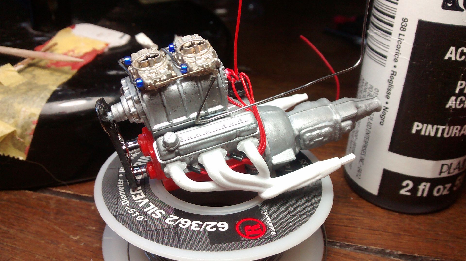

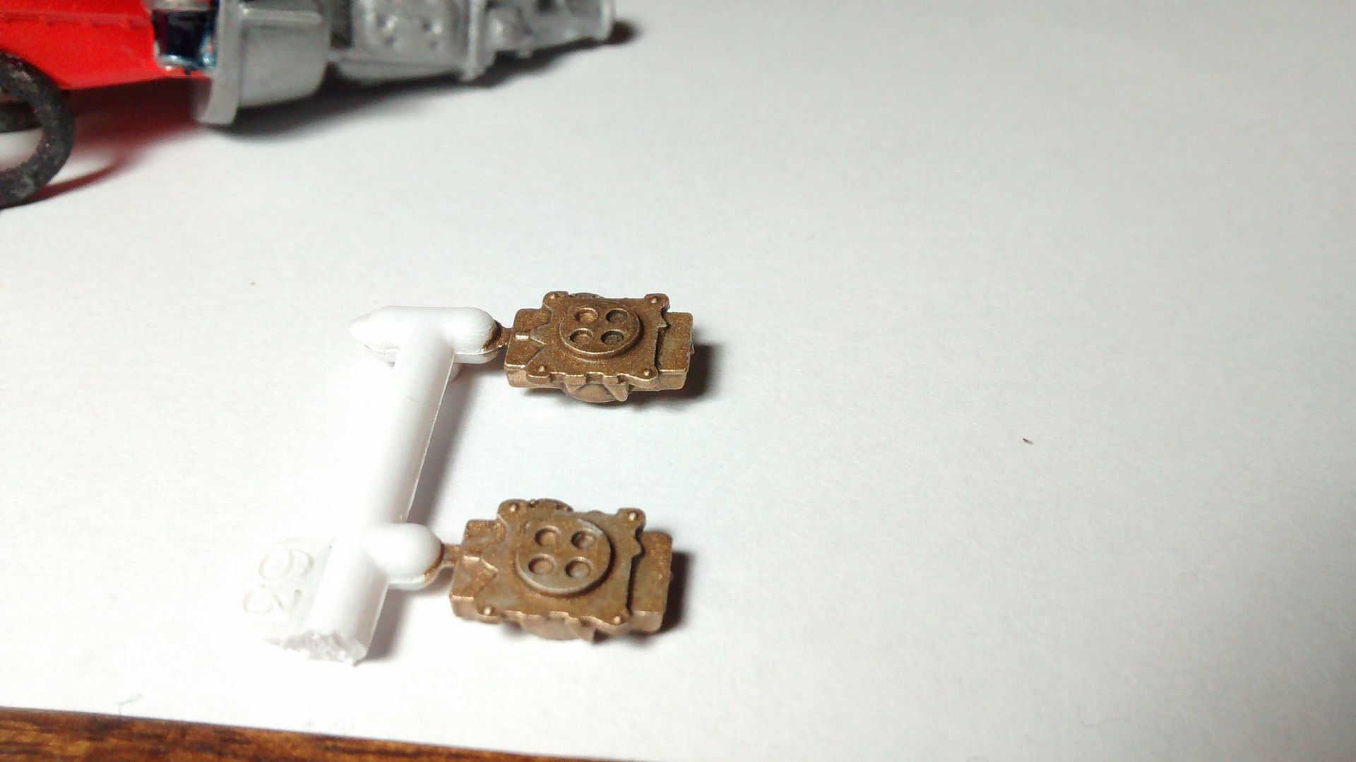

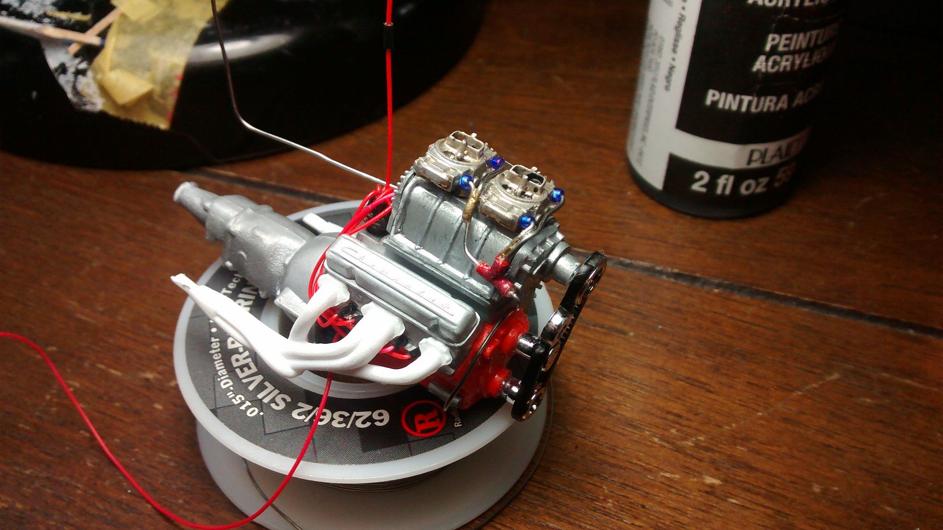

These replacement Holley's from VCG Resins will be a nice replacement. They're very nice, detailed castings and pretty decently sized, solving every problem I had. Now to paint and plumb them.
Aside from scavenging for parts, I got some build time in. This is the engine so far. I added a MAD distributor and cut the the kit oil filler neck up to make a breather cap for the valve covers instead. Those Holley's are gonna look awesome up on that blower.

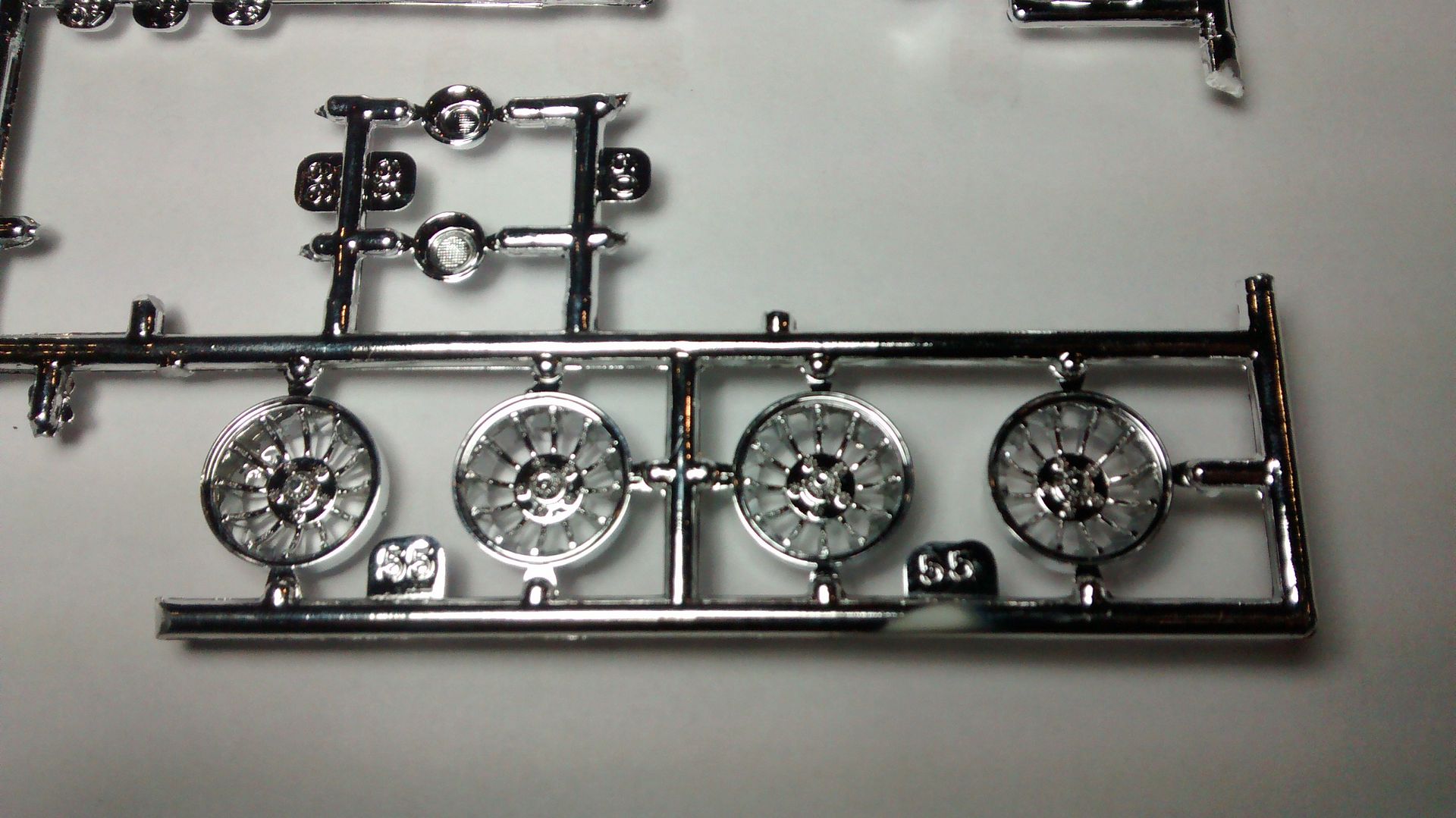

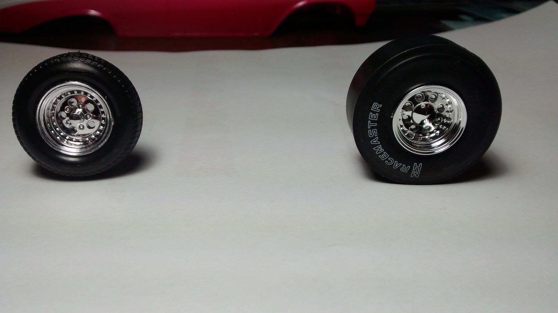

Not too much to report on, but after raiding every parts bag I have, I finally have a wheel set to use. Like I said, this being a 1/24 scale really limits the amount of parts that will actually look halfway decent. The fronts are the kit tires with wheels from the Monogram 39 Chevy. Rears are one of the many spare wheels from the AMT Lil Vicky kit, mixed with some of their big MH slicks. I think they'll look much better than the kit turbine-looking wheels.
I assume you have all the "Champ 500's" or ("Gamblers"as they're sometimes called) you're using for the front? If so, you might consider sanding the backs off the "crager" 66 chevy II wheels and gluing the dish to the Gamblers to give them the deep pro street look to the rear wheels. The wheels would all match too. Just a suggestion, love the paint!
Thanks man. Unfortunately I used them as the rears on my 39 gasser build, leaving me with these two. I've always had a thing for mismatched wheels, though. I'm weird like that lol

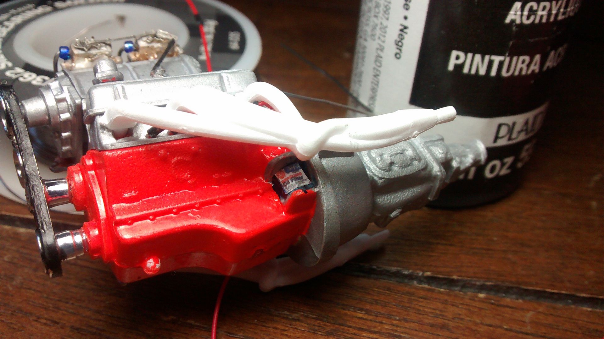

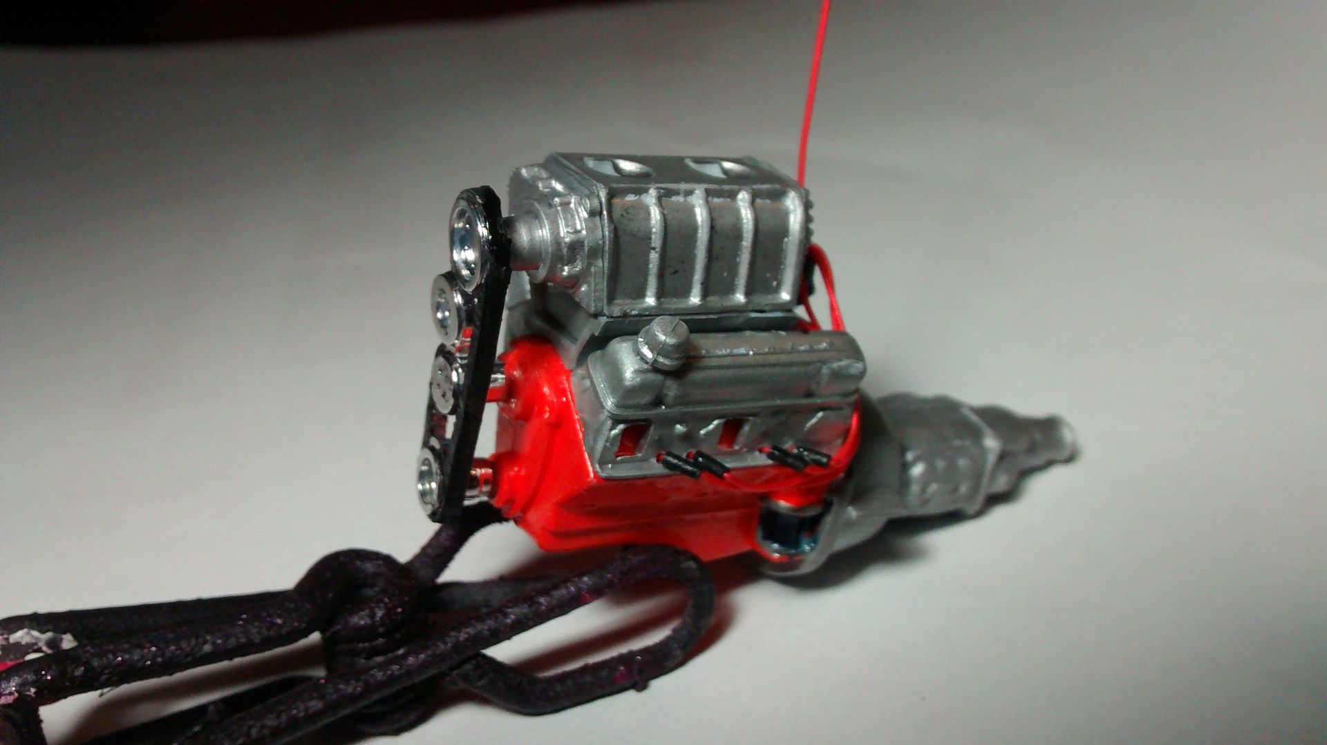

After scrounging up the parts, I finally have the engine done. This kit has a lot of very simplified parts, and the engine is no exception. After a bit of work, I think it's going to look fine now. I substituted the kit carbs for a beautiful set of Holley's from VCG Resins and plumbed them with solder and seed beads for fittings. The T fitting was made from two pieces of styrene rod. This one lacks the fuel pump on the lower passenger side, so a simple piece of rod to imitate a modern mechanical pump was added. With the addition of a MAD distributor, some throttle linkage and a image off of Google for the molded in oil filter, I now have an engine I won't regret stuffing down in the car.

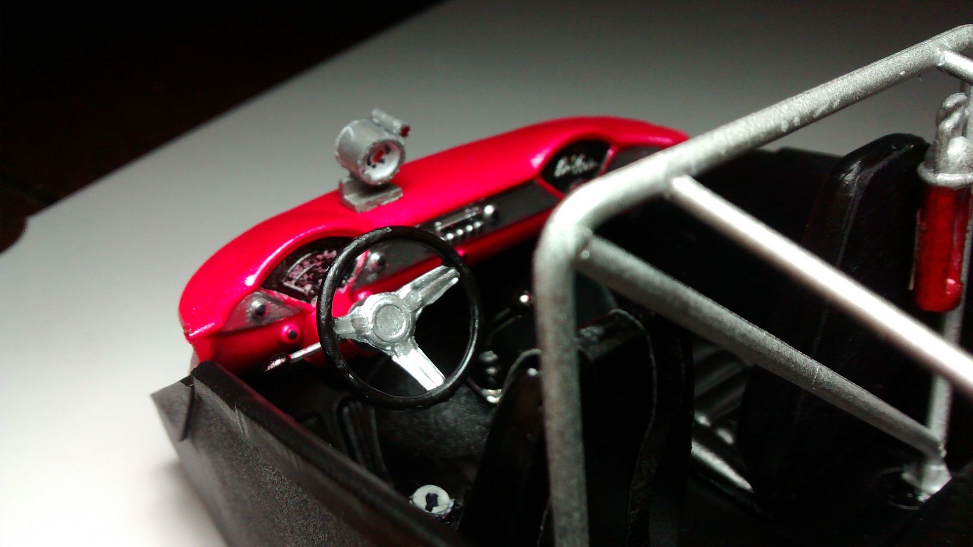

No drag car is complete without a tach. After raiding every parts bag I had, I turned up nothing, so out came some scrap plastic rod/tubing I had laying around. It's a bit big, and the base didn't clear the windshield so it had to be removed, but with the body on it looks fine. Well, good enough for me anyway lol. A spare steering wheel from a Revell 32 Ford was added to give it more of a race ready look.
The kit also supplied a 2 point roll bar that didn't sit well with me. Once again, out came the same scrap plastic used to make the idiot light on the tach. While the paint was drying on that, I decided to make a harness out of masking tape and some plastic sheet. After the extra two bars were glued into place for the roll bar, a bit of heat shrink tubing to simulate padding finished it off.

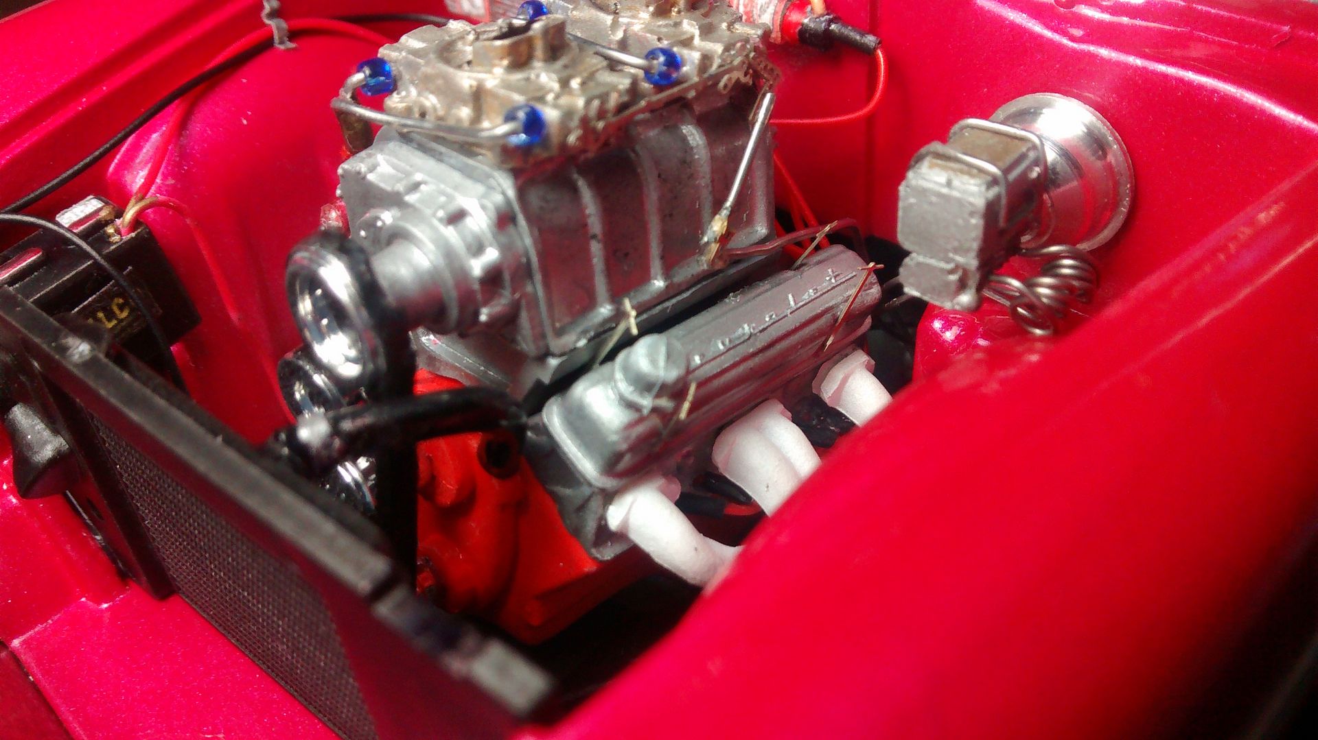

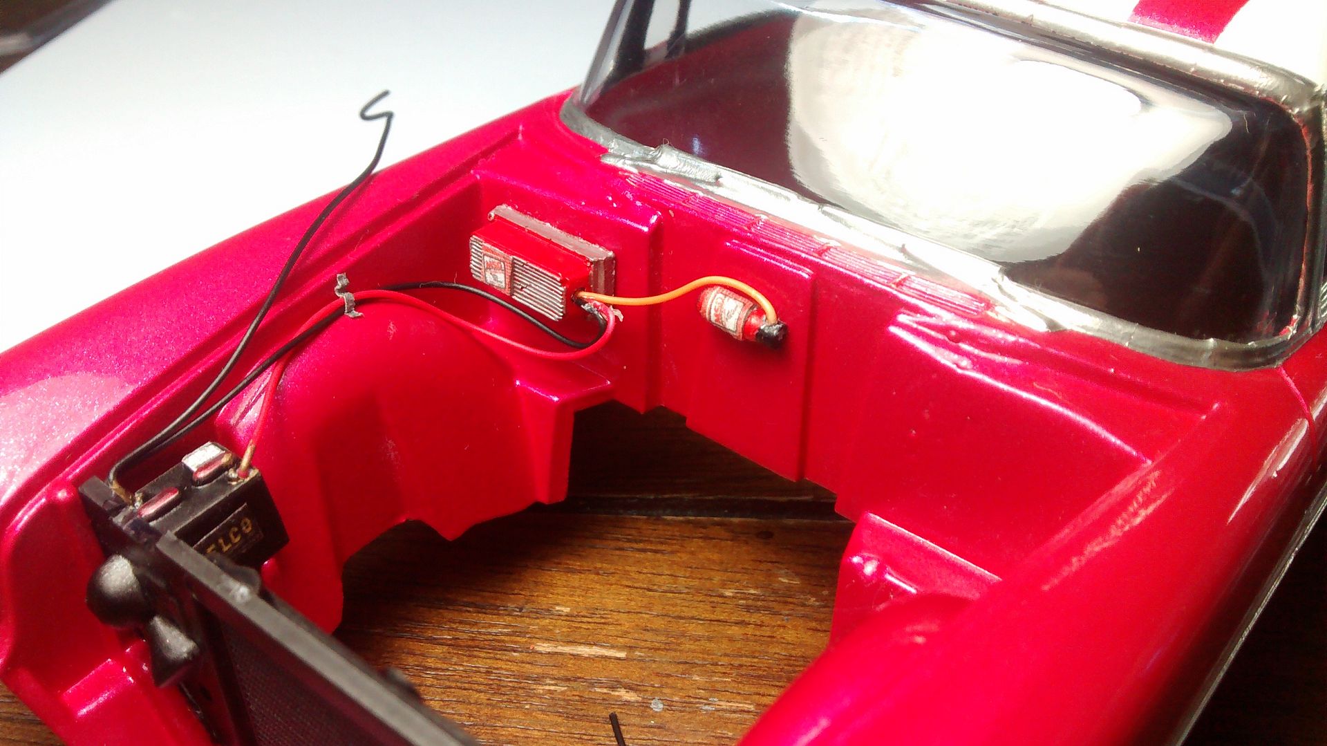

I decided the engine bay had to be spiced up, so an MSD box was added along with a coil made from a piece of spare radiator hose. Everything was wired and dressed up with some reduced images from Google. A brake cylinder will be added later.

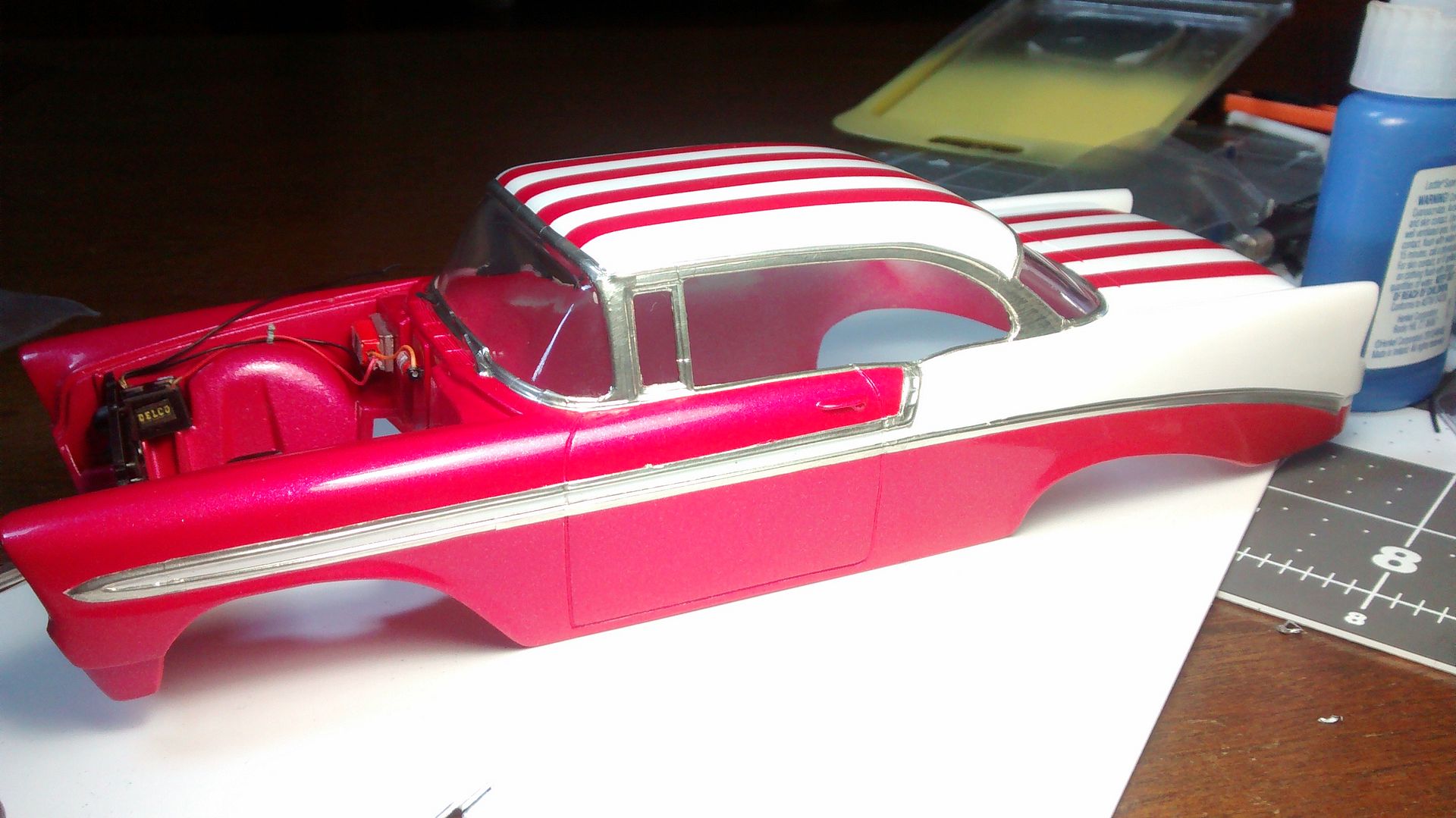

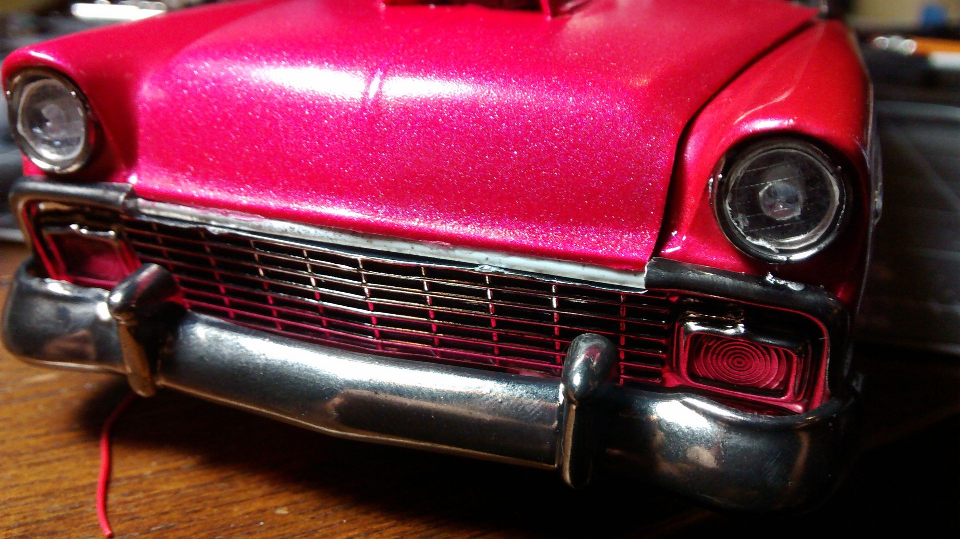

I also got the paint polished out and the BMF applied. Well, mostly anyway. I still have to do the door handles
You have to love when you get so far in a build, only to find a crucial piece missing. The chrome hood trim closes a big gap between the hood and grill, so something had/has to be done. I decided a piece of plastic stock will have to do. It's not perfect, but after some BMF it shouldn't be TOO noticeable. I hope not anyway as I'm really liking the way this build is going.

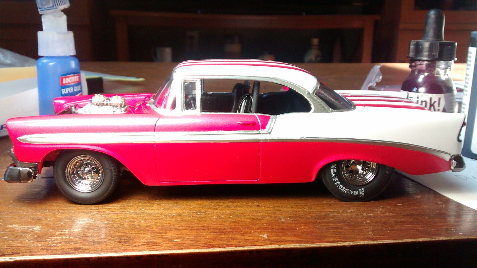

So I got a bit more done last night. Most of my time was spent sanding and polishing the hood and fixing that missing trim piece. Aside from that, I got the brake cylinder and some T bolts added and the final mockup done. Aside from a few small details, the BMF on the door handles and the decals, this one is almost done.

What is that fourth pulley on the drive belt that looks like it's not connected to anything?
You know, you got me there. I always manage to overlook something. Maybe I'll throw an alternator there if I can find one and fit it in. I'm too far in to tear it all apart now
