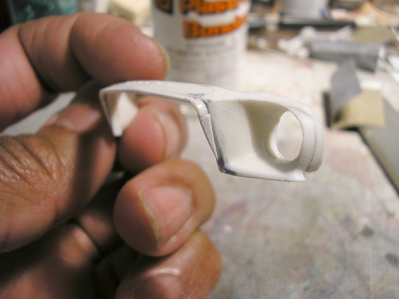

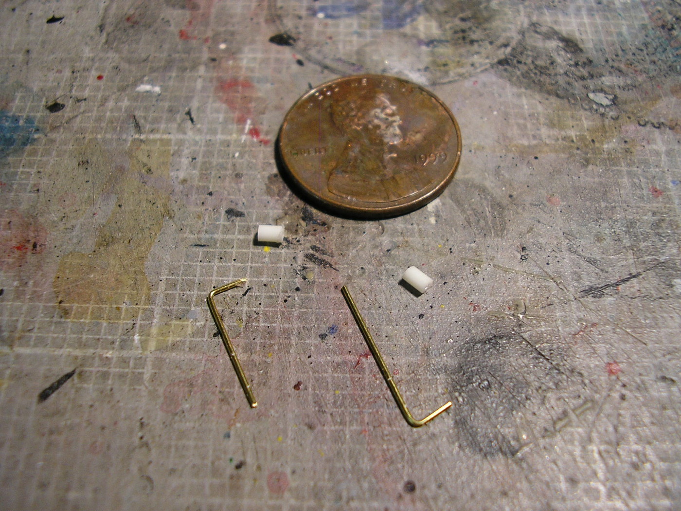

MrObsessive Posted December 29, 2016 Author Posted December 29, 2016 (edited) Sorry for the long pauses between updates folks. Between work, holidays, and some days just flat out lack of ambition, there are times when this'll happen! Ok, here's where I am at the moment................ I couldn't put it off any longer, so I knew it was time to make the inner trunk structure. I didn't try to reproduce every angle and bend in the structure, just enough to make a reasonable representation of this when the trunk is open. No latching mechanism here, it'll just open and close on its own. Here's the complete structure epoxied in on the underside of the deck lid. Gooseneck hinges were made with a separate structure put in for the hinges to hang on. Not enough real estate was there on the tulip panel to hang the hinges on, not to mention I wanted the hinges to tuck in a bit more under the rear shelf area, so this was made. Everything seems to swing open and close without any binding so far. The hinges are somewhat generic, I'm going for sturdiness this time around, and don't want to deal with the fragility of the type of hinges I did for the '59 Chevy's trunk. Some more test fitting of the taillight panel is being done here. It looks like it tucks into the body a scooch too much. OK, did some more tweaking, and it sits a bit more flush with the trailing edge of the deck lid as I'd like. One thing I may change but my better sense tells me to leave it alone, is the angle of the deck spoiler itself. It seems a bit too upright compared to pics I have, but on the other hand, I really hate to lose the "Shelby" lettering on the spoiler. No one makes a PE set unfortunately (yet) so I'm gonna have to leave this as is. I may make the spoiler and end caps just a smidge taller. Now it's time to replace the vent window on the driver's door. Like the passenger side, this was made out of bent H-Channel brass (Special Shapes), and formed to my liking. I then superglued the frame to the door, and epoxied .010 x .020 styrene strip to replicate the chrome trim on the frame, and to also make the fit a bit more flush against the shoulder of the door. I thought while it was on my mind, to double check the fit of the chassis while I'm doing the bodywork. Stance will be important to me on this one as I'll have to practically scratchbuild the entire rear end due to the IRS it has. This chassis is out of the '67 Shelby kit......... Profile is looking good so far...........note the added rocker trim------will have to tackle the fender well trim at some point. Here's the vent window complete and sitting on the door........... The driver's door is still opening and closing without binding. This'll be important as I don't want any surprises when it comes time to paint and final assembly. BTW, I NEVER paint anything on the body till everything (chassis, interior, glass) fits the way it should without any drama. That's it for now everyone.......I don't go back to work till next Tuesday, so I can at least get some more done hopefully. Next major hurdle to tackle is fixing that front end.........yikes! Some surgery is definitely needed! Thanks for tuning in! Edited December 30, 2016 by MrObsessive

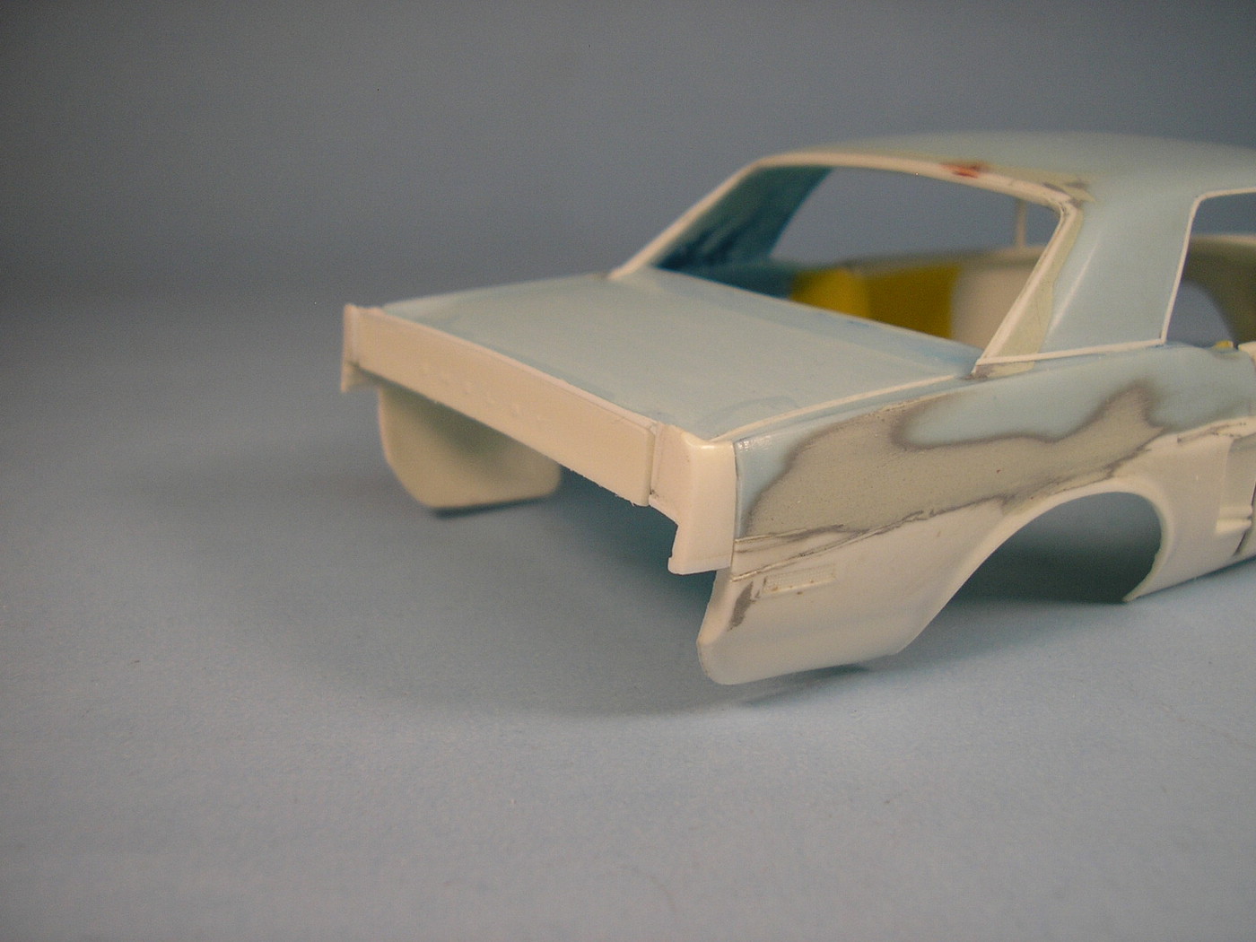

MrObsessive Posted January 22, 2017 Author Posted January 22, 2017 (edited) Slowly but surely still plugging away at the bodywork on this one. My focus for the last couple weeks or so has been mainly on the front end. While not totally terrible for someone just wanting to build it, to my view it needs some tweaks to make it more accurate to my eyes. Here's a head on shot of the front-------the grille to my view is too tall and "blocky", and the bumper sits too far down below the headlights. Looking at 1:1 pics of the car, the bumper should sit just below the headlights without all the real estate as seen here. To make things easier for me to modify this, I figured it's better for me to entirely cut away the front end, and reattach it later on. You can see here the whole front end sawed away.............in my haste, I should have made more of an angular cut along the leading edges of the front fenders. In later pics, I did add some plastic back to those areas for a more accurate appearance. Here's the front clip------I took a flat file and got rid of the excess below the headlights. It seemed to me that the angle of the grille wasn't quite right either from the side view, so some plastic was added here. Originally I thought I would need to change the radius of the leading edge of the hood opening in the clip..........later on looking at my reference pics from other angles, this step here wasn't really necessary, and in fact, I ended up grinding away a bit more than what was originally on the clip. I wanted to take a break from bodywork for a spell, and take a look at the wheels. The wheels I'm going to use are the 10 spokes that were once available separately in 1/24 from GMP. While they are not 100% accurate (spoke shape a little off and too bright IMO), they look MUCH better than the kit wheels in the AMT '68 Shelby kit! You can see why those wheels were difficult to get on and off. I didn't want to take the chance and cut off the excess on the wheel----these wheels are pretty much unobtainium, and a GOOD set of these are high on my wanted aftermarket items! If you see these turn up on eBay and you're interested, get set for a bidding war as these are very much wanted until someone casts as good a set. OK! Just a preliminary mockup of how this'll sit with the wheels. Of course, this is not the final stance--------I just want an idea right now how I want the track to sit and how the tires appear in relation to the body. Back to the front end, I got the headlight doors and outer grille shape pretty much the way I want it, and as you can see, defined the Shelby headlight "eyebrows" a bit more-------another '68 Shelby signature. I cut away the middle part of the header, and reattached it later for a better fit. Well! Aside from some small details to clean up, this is pretty much it! To me, much better than the kit body originally had, and I had to do some wrestling with the hood as it was a bit warped out of the box. To cure that, I put the hood in the dehydrator at 140 degrees for about 15 mins. Bent it to shape while it was toasty and so far it's keeping its shape as I type this. I'll have to remember NOT to wash the hood in hot water for final cleanup before painting as its memory will come back and it's warped again. Same for drying the paint-------no dehydrator for this one for the same reason. While I had the ambition, I did reshape the spoiler and end caps to a different angle. The appearance to me previously was a bit too upright, so I changed it to have bit more slant. Before................. After............. That's as far as I've gotten..........now to go back and tweak the grille trim so that when it comes time for BMF, there won't be any major gaffes. Also, try to get the wheel well trim on. There's still the vinyl roof seams to get on, and then hopefully by the beginning of next month, I'll get started on the engine. Long ways to go just the same, but so far, I'm happy with how this is turning out. Thanks to all that are tuning in! Edited January 23, 2017 by MrObsessive

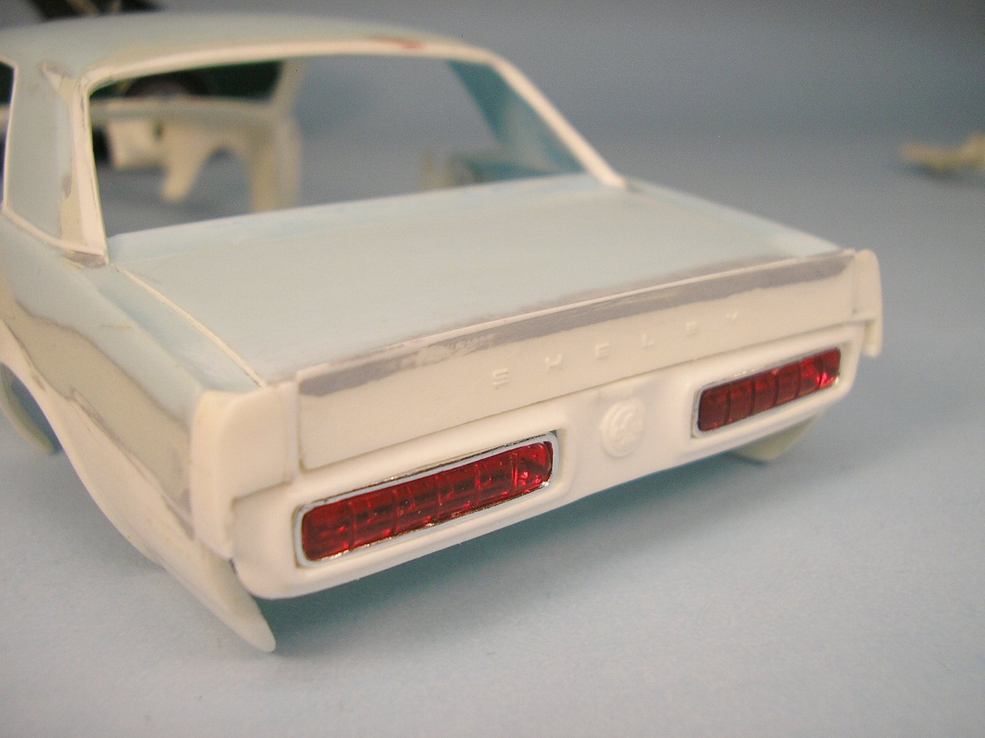

MrObsessive Posted March 12, 2017 Author Posted March 12, 2017 Before I forget and get too far along, I want to put in more correct inner fenders and such. The ones in the original '68 Shelby kit are woefully inaccurate, so a donor kit '67 Shelby gave up its inner fenders, chassis, and i firewall. I just used the back of an Exacto Blade to cut things out. I had to shim the inner fenders somewhat as there was a bit of a gap trying to get things to fit. I won't add the firewall till later as I want to get some other things done, but it will be put in before the body gets totally painted, which won't be till near the end. Another item needing attention is the wheelwell trim. I just used .010 x .020 plastic strip which was bent slightly to suit the contours of the wheelwells, and liquid glued in. Well, I'm done pretty much done with the body work for now, so it's high time to move on to the engine. The Green Hornet used a electronic fuel injected 428 backed by what looks to be a C6 automatic. I used the 428 out of a junker '69 Shelby kit, and the automatic came out of the AMT '67 Mercury Cyclone kit which gives you the choice of either the 4 spd, or the C6. If I ever decide to build the Cyclone, I'll be using the 4 spd anyway, so this works out well. One chore was to cut away the four speed that was molded into the engine block. Then line up the trans with the block and minimize any gaps with plastic and epoxy. The fuel injection unit used what looks to be a "tuned port setup" which was cutting edge for 1968. What I'm making here that you see on my fingertip I believe is the air intake which'll sit on the top of the manifold. At first I thought this was a throttle body, but pics I have show injectors for each of the intake runners, with "fuel logs" running parallel with the valve covers. Just some pics here showing the bodywork that's now done------about 98%. I ruined the original hood trying to open up the vents------wrong move! While I was successful getting the vents open, the bottom edges of the vents ended up looking jagged and a bit raggedy to my eyes, and I couldn't get them symmetrical enough for my tastes, so eBay to the rescue! I happen to do a search for AMT '68 Shelby hoods, and there was a seller that had just the hood among other things, and I snapped it up. I don't mind the odd color------everything will have a barrier coat and primer in the end, so it's no big deal. Also take note of the roof seams for the vinyl roof. Some .010" x .020" Evergreen strip was used once again for this. I did knock down the height of the seams somewhat to blunt them, and also the insides of the seams were blended in a bit to represent where the fabric overlaps per the 1:1 Here's the engine with the air intake mocked up for now. I had to change the intake manifold to the one out of the '68 Shelby kit as the one in the '69 made the engine much too tall, and the hood wasn't closing properly. This intake has a more accurate shape per the 1:1, so it's just as well. Yes, those are tiny brass tubes angle filed and placed inside the neck of the body. Also, take note of the PE linkages pinned in with tiny brass bolts for the throttle later on. The 1:1's intake manifold.................. Well, that's it for the time being. I'm not sure how long it'll be till the next update, and I may switch up things and do a quick builder (maybe a 1/43) as a bit of a breather. The bodywork alone has proven to be tougher than the '59 Chevy as there's just so much more involved with trying to make this right. Thanks for tuning in, and thanks for all the compliments!
